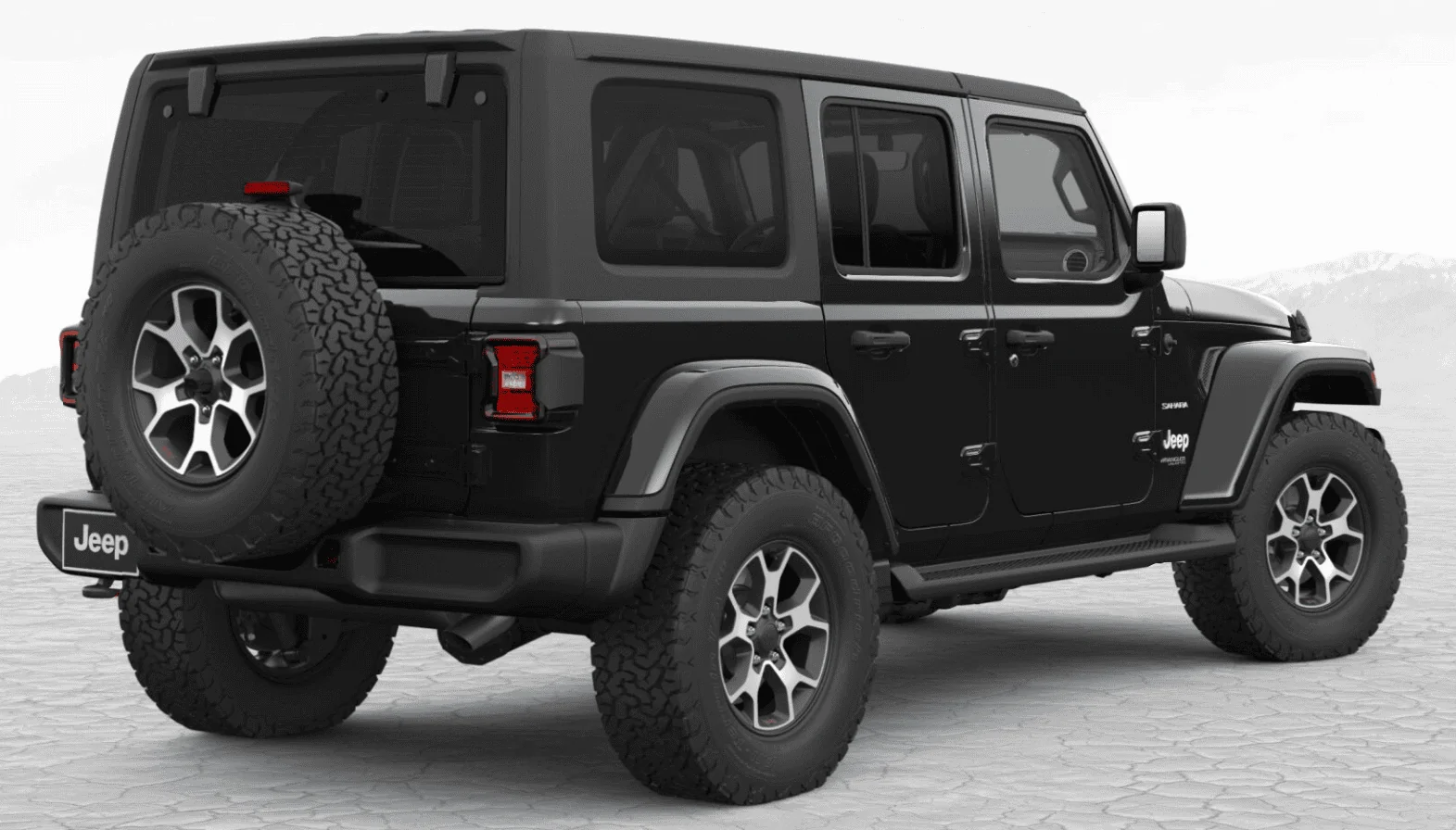

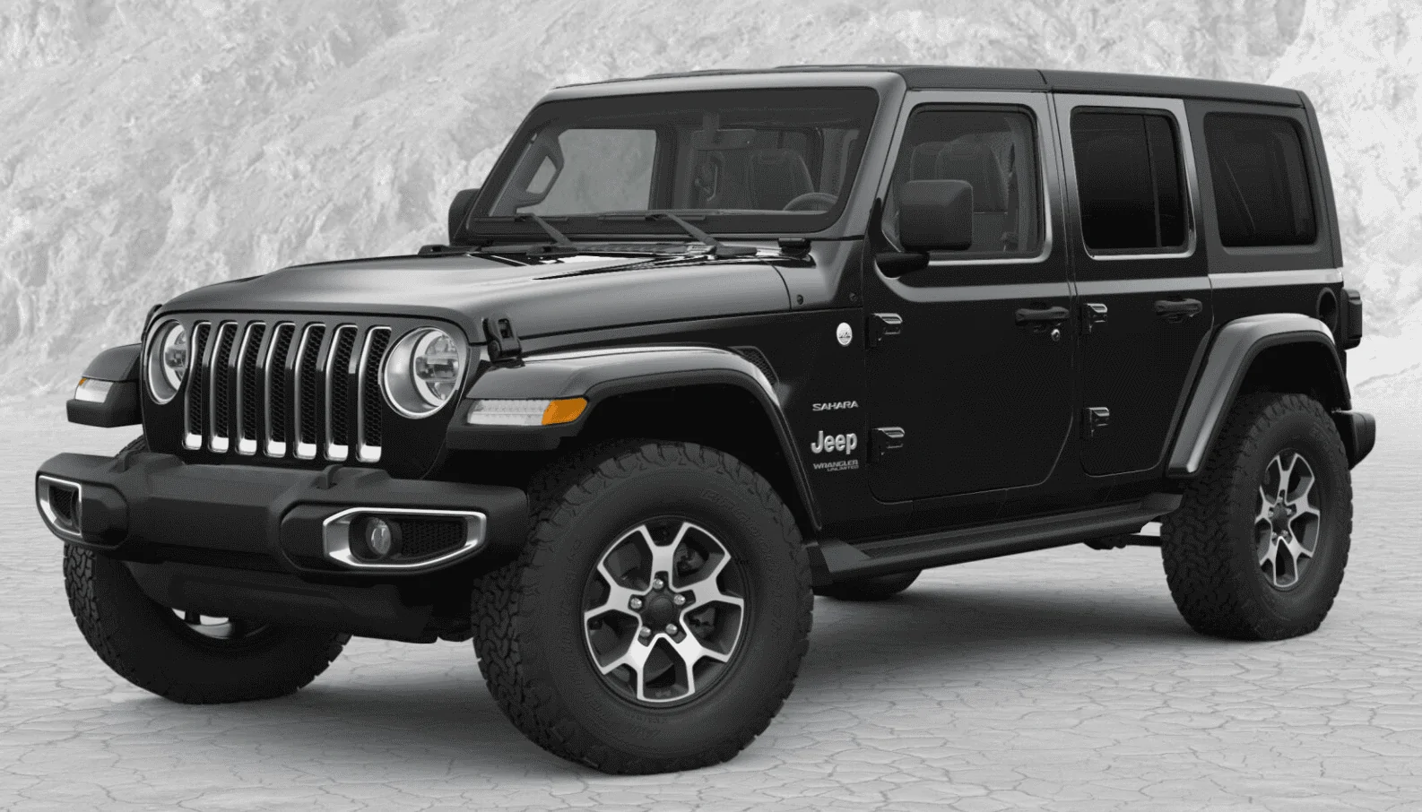

Made my own pics and posted to another thread but applicable here as well. I think I'm going this route:
Jeep Wrangler JL KO2 size question Sahara w: Rubicon Wheels:Tires
Jeep Wrangler JL KO2 size question Sahara Rear with Rubicon wheels:tires
