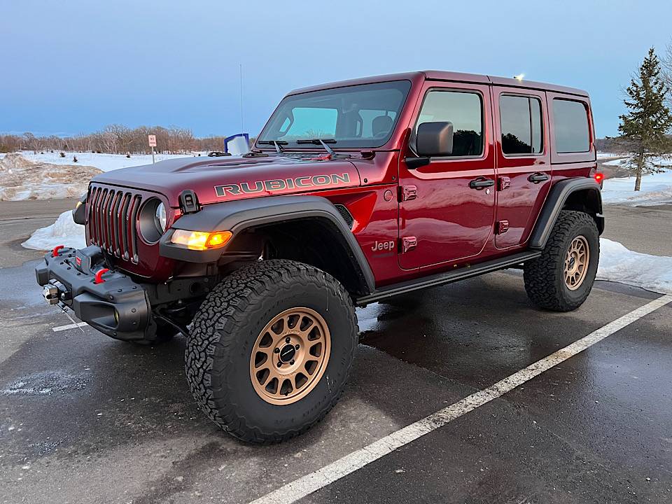

Sure - I get that. I had to adjust (I used JScan) for the 35's i'm running now. But curious if you have decent clearance with 35s (315/70R17 in my case), can these BFG 37s - which run a bit smaller than other "37s" - be used without further lifting or modding.
Here's my JLUR with 35s now...

Ah...I missed that. So the 37" BFGs are 35.375" installed and the 35's (Kanati Trail Hog AT-4) that I had were about 34.5" installed. My guess is the BFG 35's you have are shorter than 34.5"?
I would think for "normal" driving, you could probably get away with the 37's though with some articulation they would likely rub. I had a MC 2.5" lift on mine when I initially installed the 37's (now 3.5") so I did not have any rubbing.
They are supposed to be 34.4" so they run closer to size than the 37's do. I had to set my JScan to 34.75" to get accurate GPS speed.
But good to know that probably would need a bit of extra lift.
Not to mention probably good idea of beefing up track bars, tie rod and drag link. I don't think I'd be comfortable going any bigger than 35's with stock components.
What do they actually measure? Their advertised diameter is 34.4" and I would be surprised if they are anywhere near that unloaded, much less loaded. The 37's are advertised at 36.5" and measure 35.75" unloaded for a difference of 3/4". On my Jeep, they are 35.375" loaded or 1-1/8" difference.
I agree on the suspension components. They are not robust enough for long term use with larger than stock tires.
