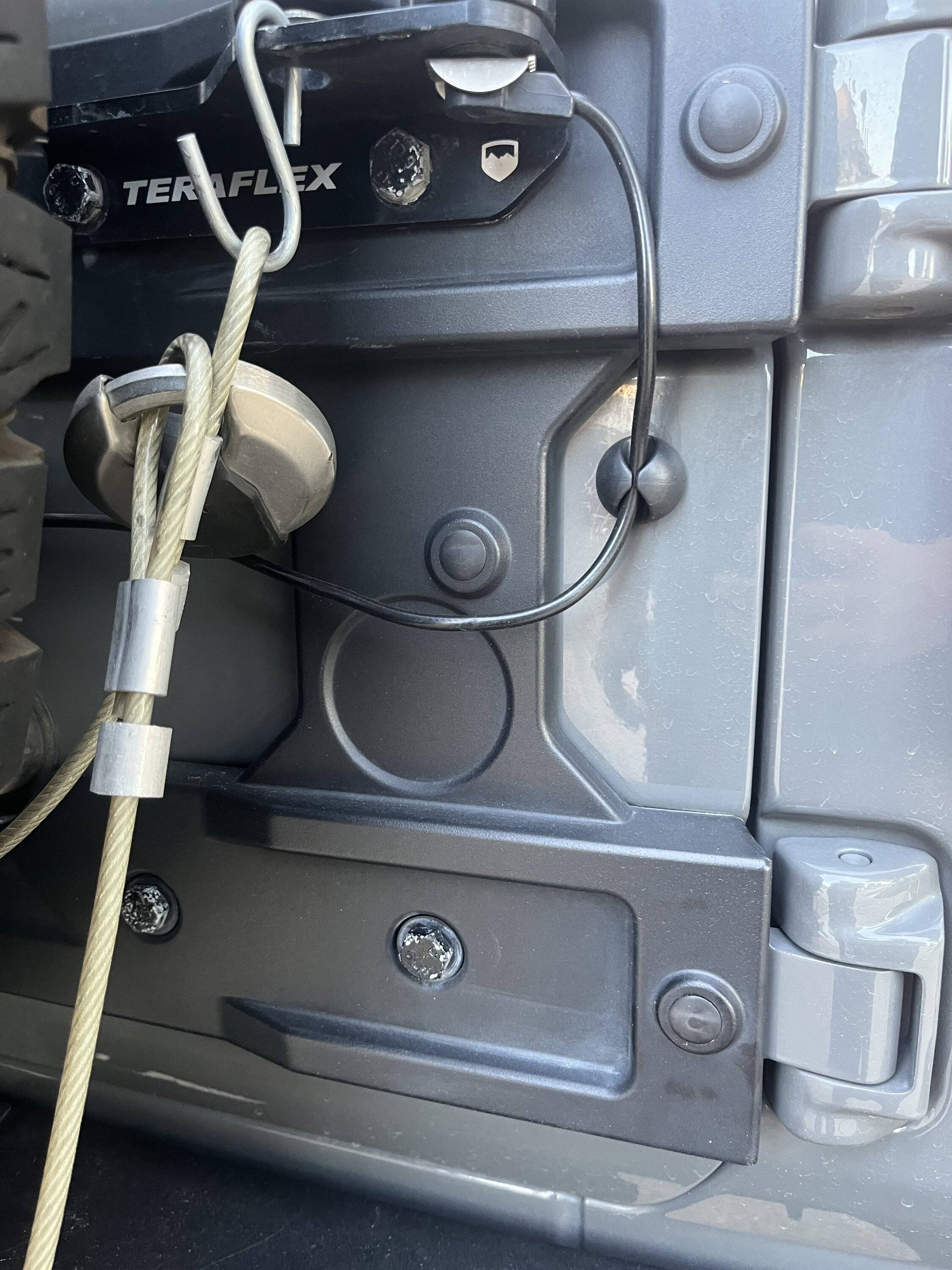

Jeep Wrangler JL Knock Off Tailgate Reinforcement Bolts IMG_1754
Does this help? I know I did not special order any bolts for it. But can’t remember if I maybe picked some up somewhere? Knowing my cheap ass, they are the ones supplied. Anyhow, no problems with the cheapo amazon reinforcement kit. I did paint the hex heads black with a touch up pen though.
