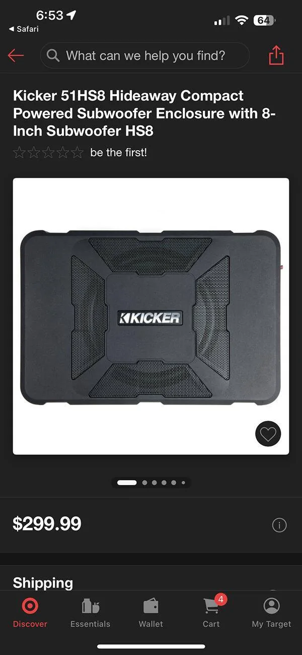

Does anyone have instructions or a video on how to wire and install this sub? Called kicker and they said they don’t provide instructions to customers. I got a JL sport and wanna install it w a stock head unit
