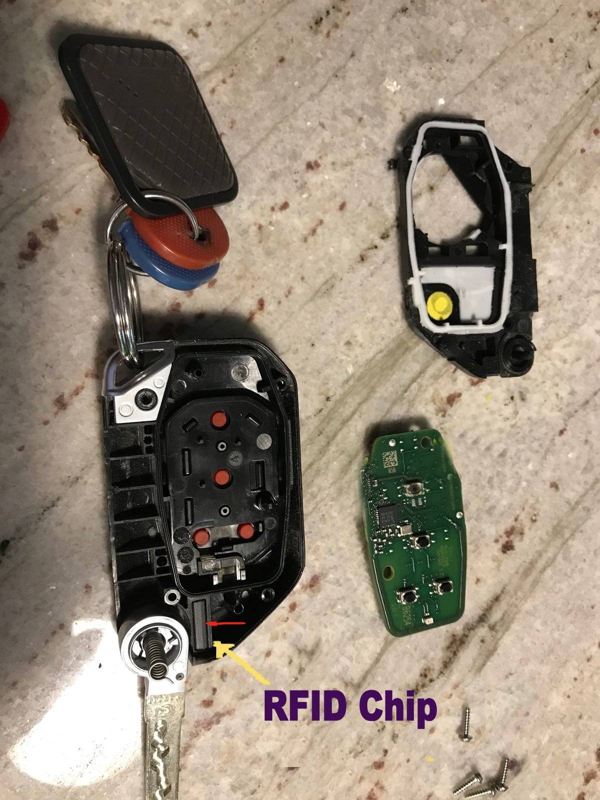

I received my model m 4 button fob. I can’t seem to get the rfid chip out. What are you all using to pry it out? I watched the video and I have a pick tool set on order that I hope works but thought I’d poll the group. I’d prefer not to cut if I can avoid that.
@wrigleyville29
The chip as you can see is surrounded by plastic sides.
I find that if I take a very very small blade flat tip screwdriver, I can drive / force it between the chip and one of the longer side walls a bit. Then, you can get in that gap and slowly and carefully pry the chip up. Other guys take a knife blade and cut the side.... that does leave a bit of noticeable damage to the stock fob.
Pic below:
Red arrow points to a very narrow seam/slight gap, between the chip and the side of the enclosure.
Take a very fine tip flat head screwdriver and place it's tip in the seam where the red arrow shows in the pic below.. Now, with a small hammer, tap, tap... gently, the end of the screwdriver and the screwdriver will slowly drive down in between the seam and the chip. The side wall of the chip holder will bow a bit outward.. Now, you will have access to pry the chip out..
Jeep Wrangler JL Keyfob now 30% smaller! chi
The chip is quite sturdy and can handle the side pressure when you pry..

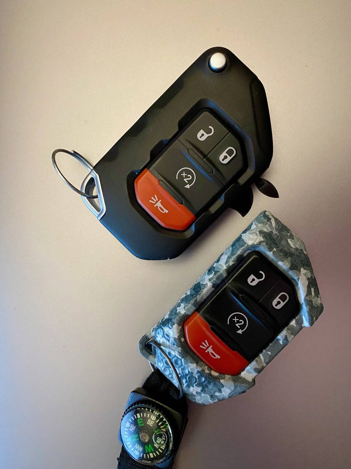

Just got done with mine and watching the instruction video made it a total cake job to switch them over. The only hard part in all honesty was getting the RFID chip out of the factory FOB - took some wiggling using picks, wedges, and really small flat head screwdrivers. Once it was out it popped right into the Threedom FOB.
Only thing I would remind people is to re-use the pin that keeps the key in place in the holder they supply (I bought). I probably overlooked or missed it in the video instructions but overall I would say this new FOB is less than half the weight and size of the factory one. Huge improvement over the factory FOB and worth every cent in my opinion =)
Only con is that now I need to buy one for my wife when her Jeep gets here...

Damn, that Camo Model S, Hex texture, looks great!
Thanks for sharing... YES, with say a bulletin board, push pin, (tiny nail, etc.) push the roll pin out and that frees the key from the stock key holder. Now, stick key in the DI Labs key holder and insert the roll pin into that holder/through the key shank, to secure the key in the DI Labs key holder.
I did this deed, once again last night.... setting up a Model S+ .......I needed another stock key and roll pin for use with the Model S+ ..... The S+ actually holds the stock key in it... the key is retractable.... slick as chitt.. (see pic I posted earlier today in this thread)

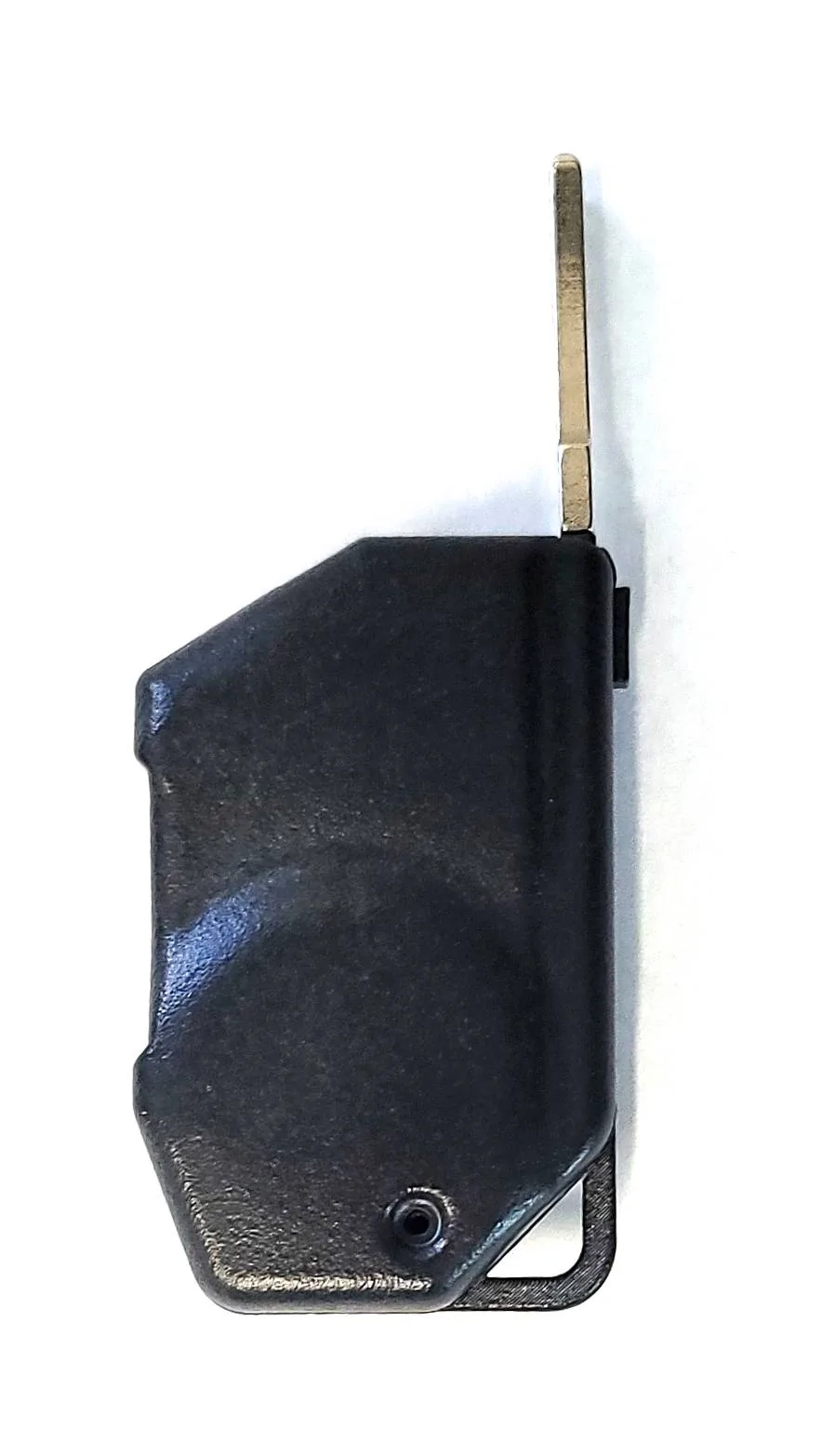

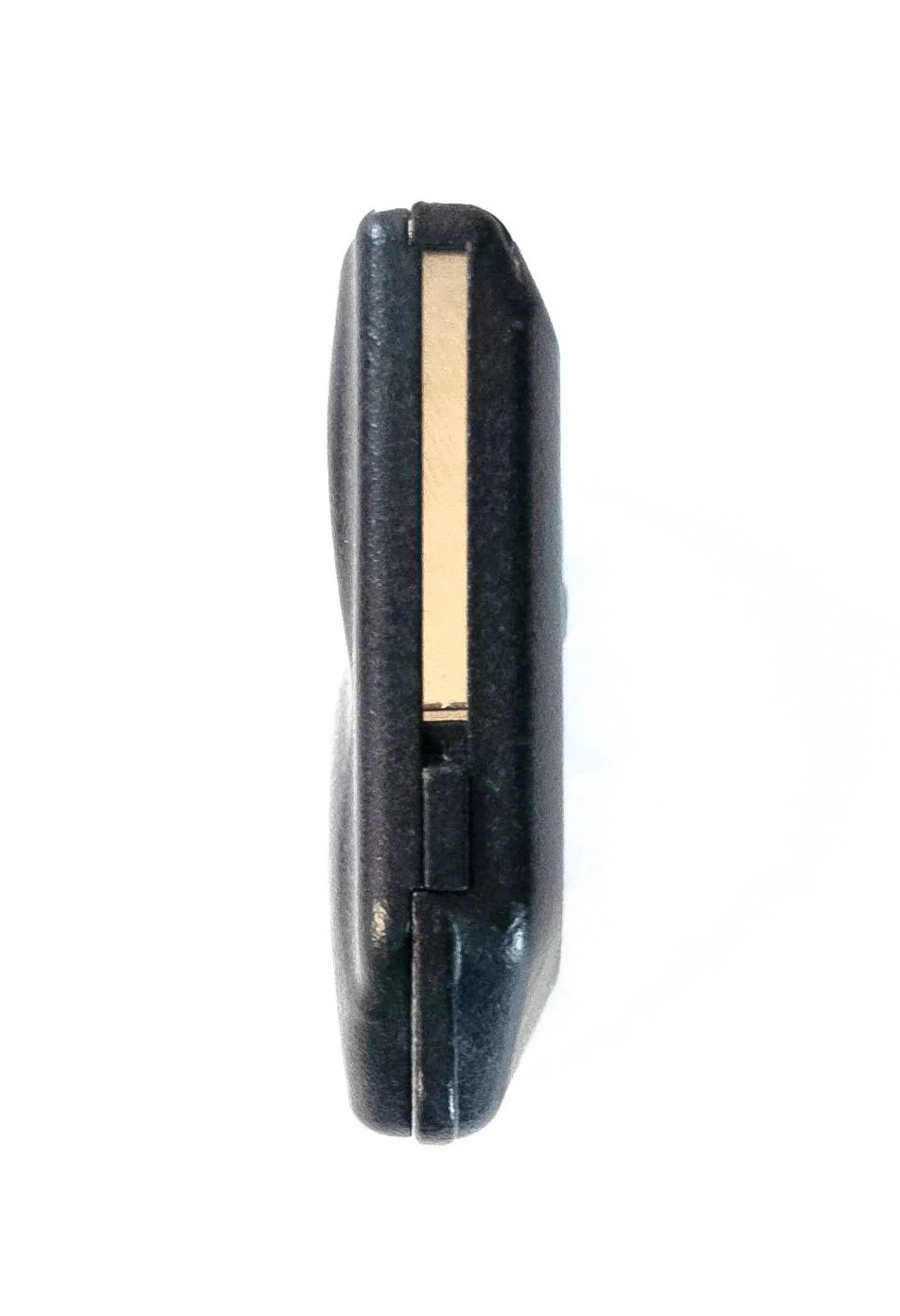

Presently testing the beta, Model S+ that holds the key. Here's a pic. (No, that is not my hand)
So far, testing is going aok... a few tweaks needed (minor tweaks) on some things and the Model S+ will be ready for all to buy/enjoy/use... It's very nice, even in the beat form...

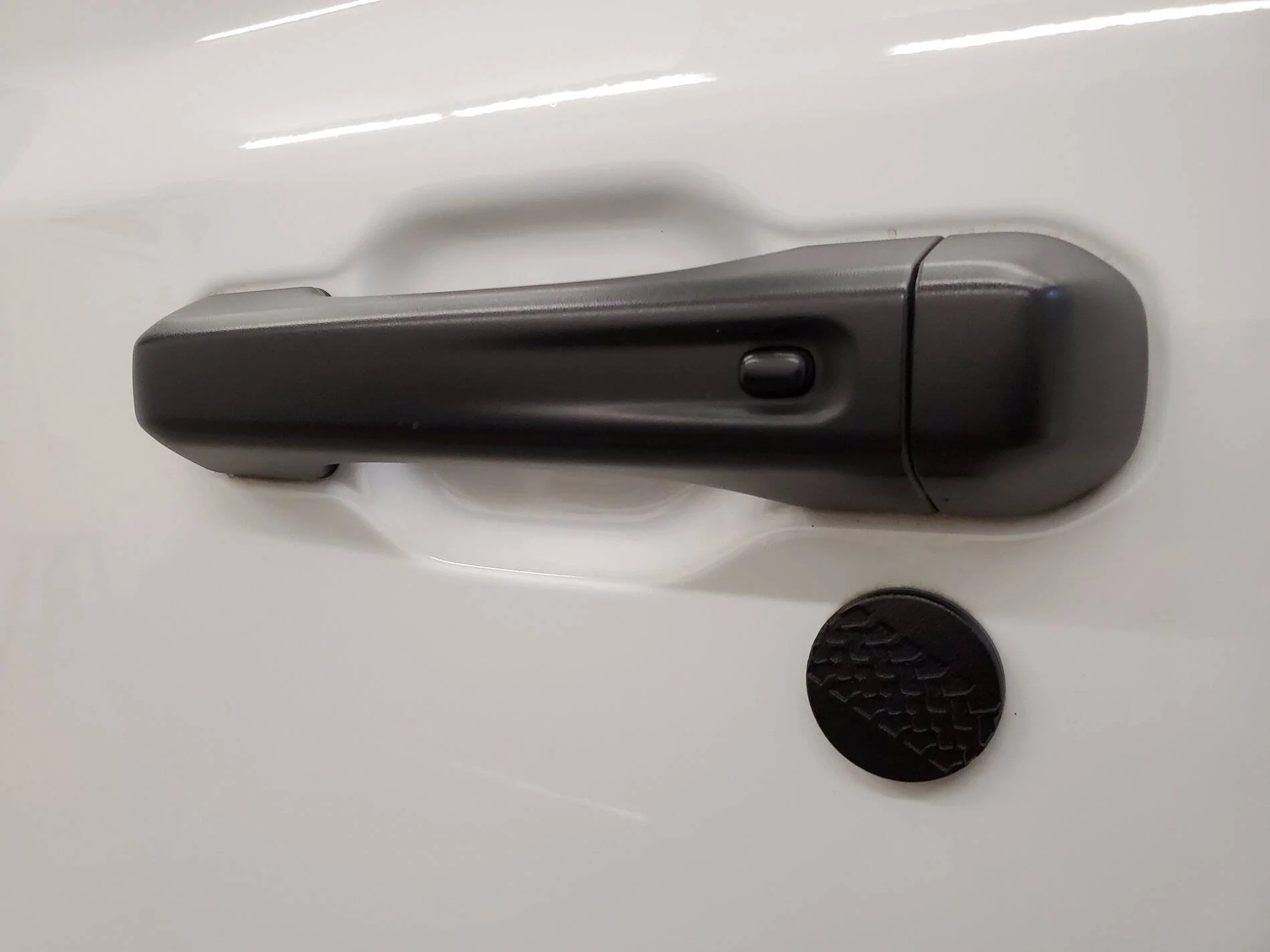

OH, also I'm also testing DI Labs door lock covers... TERRIFIC they are. The one shown is quite plain / has tread ... is one but my favorites. Fit and finish is excellent.. Snap on very firmly..
