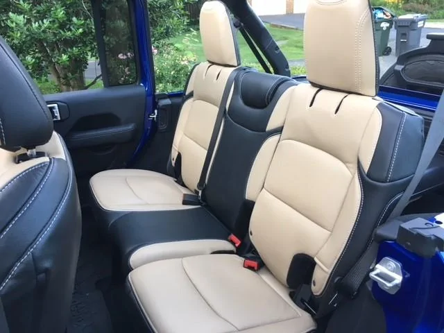

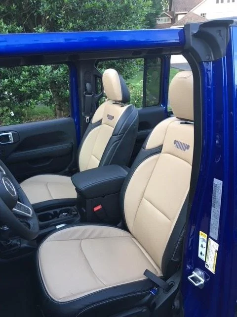

Best option for my jeep was the Katzkin seats. One year later and I smile every time I get in. Super unique seats, I love the black and tan contrast and the price was about the same as the dealer leather. I ordered with cloth then had a local Katzkin installer put them in, no complaints, I've never missed the center drop down in the back
seat.
