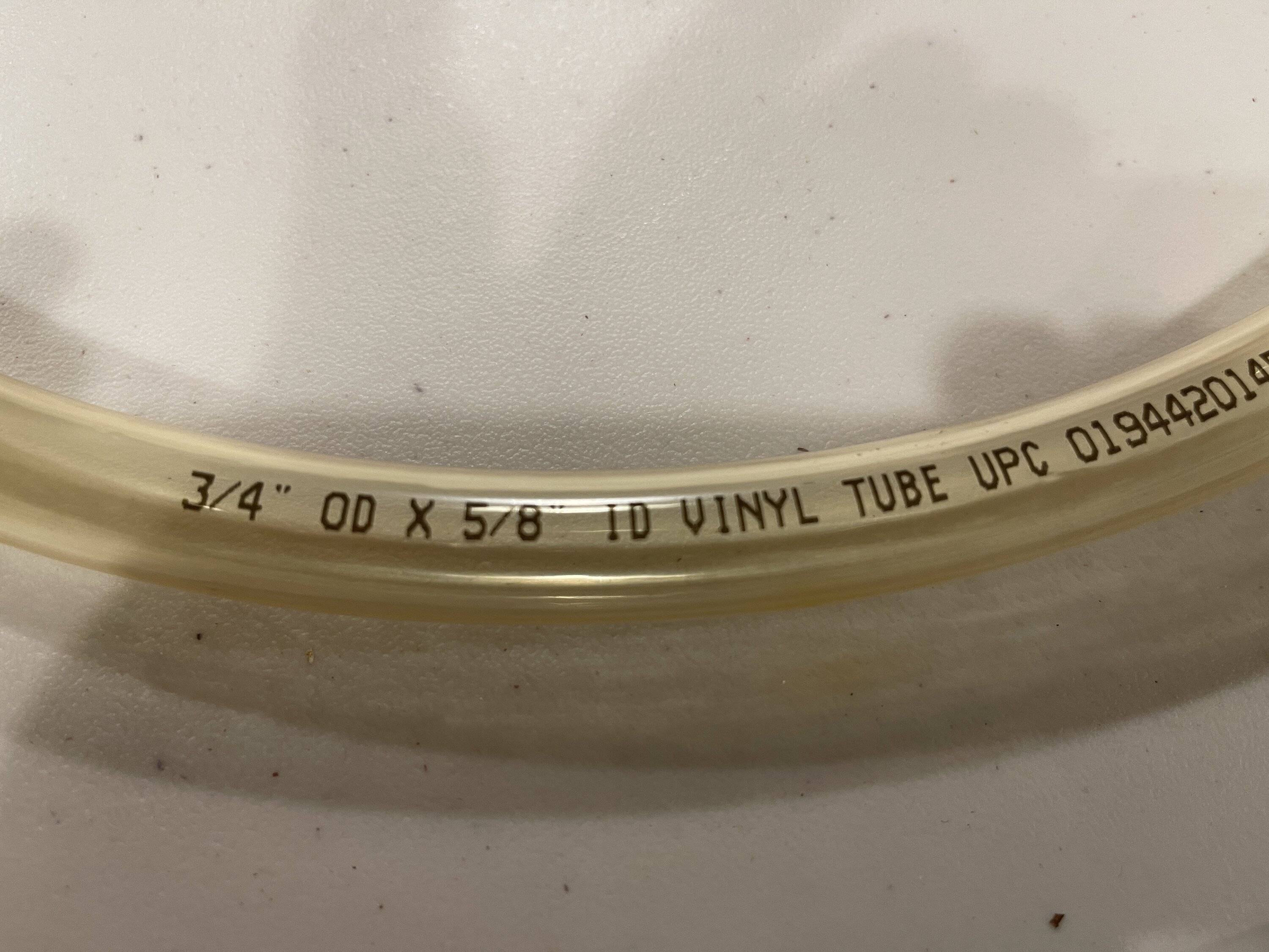

I use a piece of vinyl tubing which isolates cable end and also allows me to slip on the clip from my charger...Deltran trickle charger. Usually charge aux. about once every couple of weeks, takes about an hour to reach full charge.
@Mtrctylarry

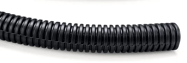

I really like your vinyl tubing method... very clever! ........ another thing you can use is a 5" piece of
Wire Loom Split Tubing/Auto Wire Conduit Flexible Cover. (see pic below) You just slide it down over the disconnected cable connector and when you need the cable end you slide it off the cable connector end of the cable.
