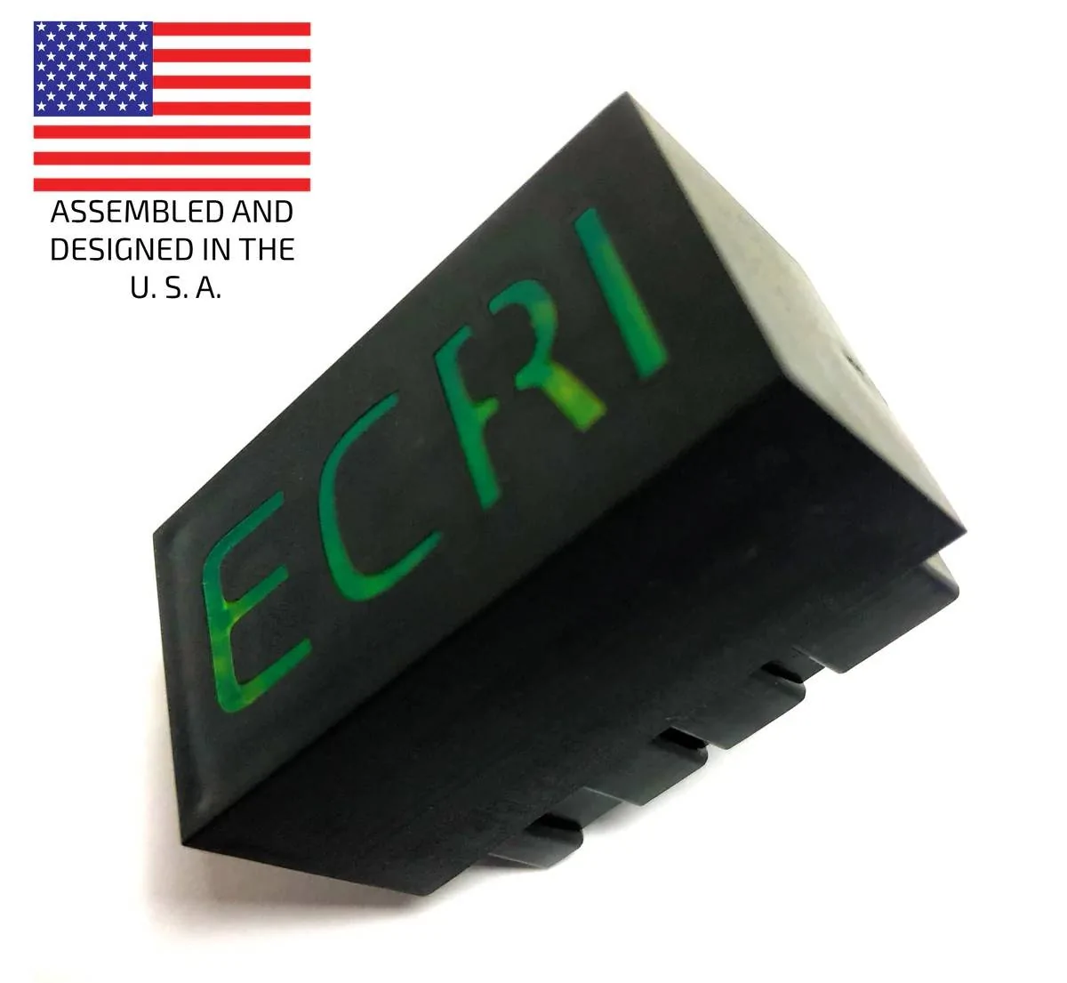

IF, you just purchased your Chrysler 12+8 Programming Cable and can return it for full refund, I encourage you to do so.
There is a far better way to bypass then using an old school/dinosaur, Chrysler 12+8 Programming Cable that aren't that reliable, have big foot print, etc..
Buy yourself a dedicated security gateway bypass module. Smaller footprint and are reliable.
You can leave this security gateway bypass module installed and not have it dangling and being an eyesore. You can buy a plastic holder for it that allows mounting up an out of the way.

Interesting. how does this work? Are you plugging in the two cables that go in the bypass cable to here? But then, how do I connect my vlinker MC+? If you have those cables removed, does the normal port where I plug in the vlinker OBD2 still work?
Sorry for the questions

Vlinker MC+, your BT scan tool plugs into the OBDll port. The ECRI security gateway bypass module connects to the 2 cable you disconnected from the security gateway.
You can leave the ECRI module plugged in 24/7, 365. Just remember to remove the ECRI module and reconnect the 2 cables to the security gateway anytime your JL goes to the dealership service dept.
