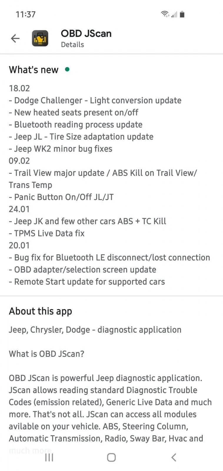

IMPORTANT:
JSCAN updated to version 18.02, a couple of days ago. In the "What's new" notes, it says amongst other things, "Jeep JL - Tore Size Adaption Update"....
SO, do update your JSCAN app if it is not updating automatically.
Jeep Wrangler JL JScan Tire Size Issues [Help] Screenshot_20210221-113741_Google Play Stor
