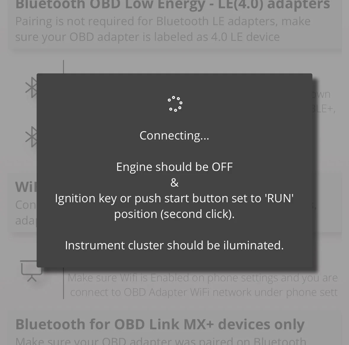

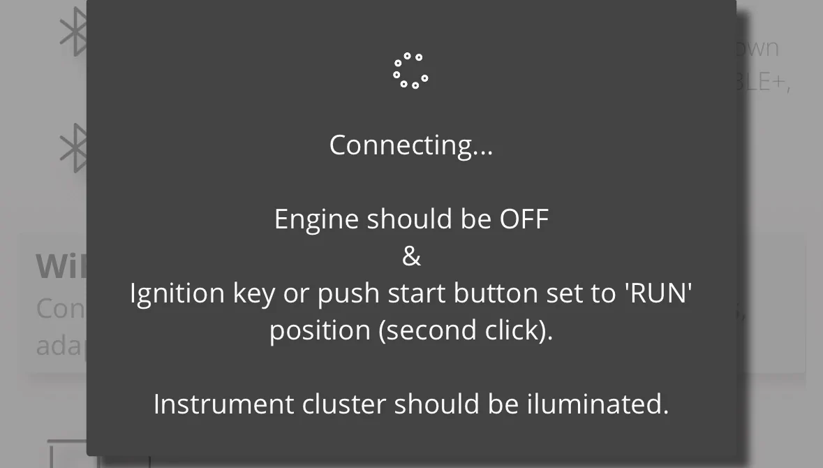

Hello Forum,
I’ve removed any obdii apps to only have jscan with the obdiimx+. I can get one scan or clear codes but if I try again it locks up with this screen, I appreciate Jscan and have got past the connectivity issues would like to resolve this one

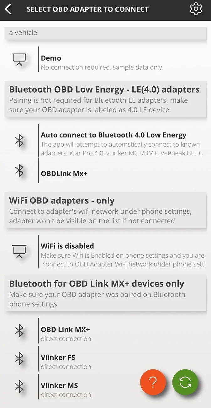

Just to clarify. Have you been using JSCAN and the OBDLinkMX+ for a while without issue and this is a new problem?
In order to run “Quick Diagnostics” then “Advanced Scan” for example…
Are you selecting “Auto connect to Bluetooth 4.0” as you should.
You should NOT be selecting OBD Link MX+

The problem is ongoing and I have not Sir (British accent?). When having problems linking / connecting with jscan the link the 3rd link from the bottom was the only way to connect for me, I can try again as it’s been a while.
I also removed the Mx+ app (which I like a lot) as I was told it caused issues for jscan “competing” to link to Mx+
FYI I had zero issues with Mx+ app

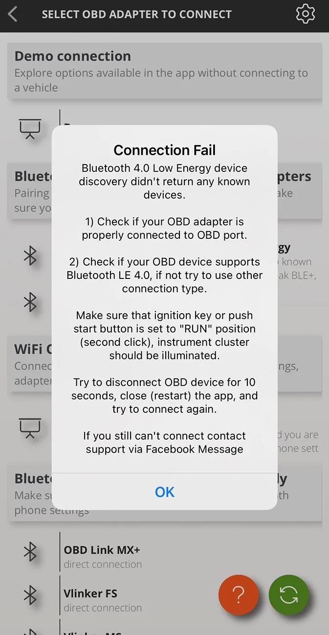

When I select “Auto connect to Bluetooth 4.0 low engery” I get:
OBDII MX+ doesn't have BLE (Bluetooth 4.0) capability. It uses regular Bluetooth connection. You have to pair and connect it to your phone first using your phone's Bluetooth connection manager, and then select it in JScan.
Ok, I’d been connecting “manually” in Bluetooth settings before. I’ll continue to do so.

I have l power cycled (restarted) the phone many times , sometimes that will unfreeze jscan. I,ve unplugged and rebooted the obdmx+ adapter by holding the search button several times. Phone is an IPhone 15 pro
1. iPhone will always connect to obdmx+ via Bluetooth, but sometimes jscan will not connect when selecting an obdii connector. I’ve removed all obdii apps except Jscan and removed “potentially competing” blue tooth connections like uconnect. I still have headphones and such in the Bluetooth list but nothing connected except the obdmx+
2. I run a quick scan or advanced scan and clear codes and try another scan it usually will freeze or if I toggle back screens. I then try rebooting the iPhone and obdmx+ adapter
