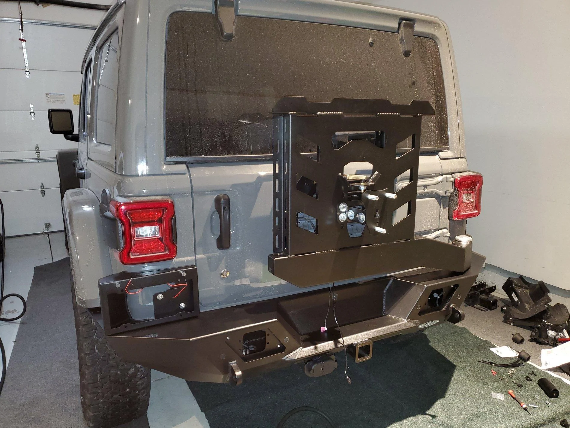

Well first, congrats on getting the diesel after your agonizing wait. So the sensors work perfectly, but . . .
I currently have the 37s mounted as low as possible. Gives great sightlines out the rearview mirror - and sets off the rear sensors. If I mount the tire up another inch or so the sensors work without being set off by the tire. So the tradeoff is, best rear visibility and turn off the sensors (rear camera works fine), or live with a slightly less good rearview, but have sensors ready to warn you of anything back there. I'm currently choosing best rear view and turn off the beeping in reverse.

Cool! I was wondering how they would work...I have been waiting for the AEV bumpers. Thought they would be available last year, then they said they would be available Jan this year...still no bumpers!

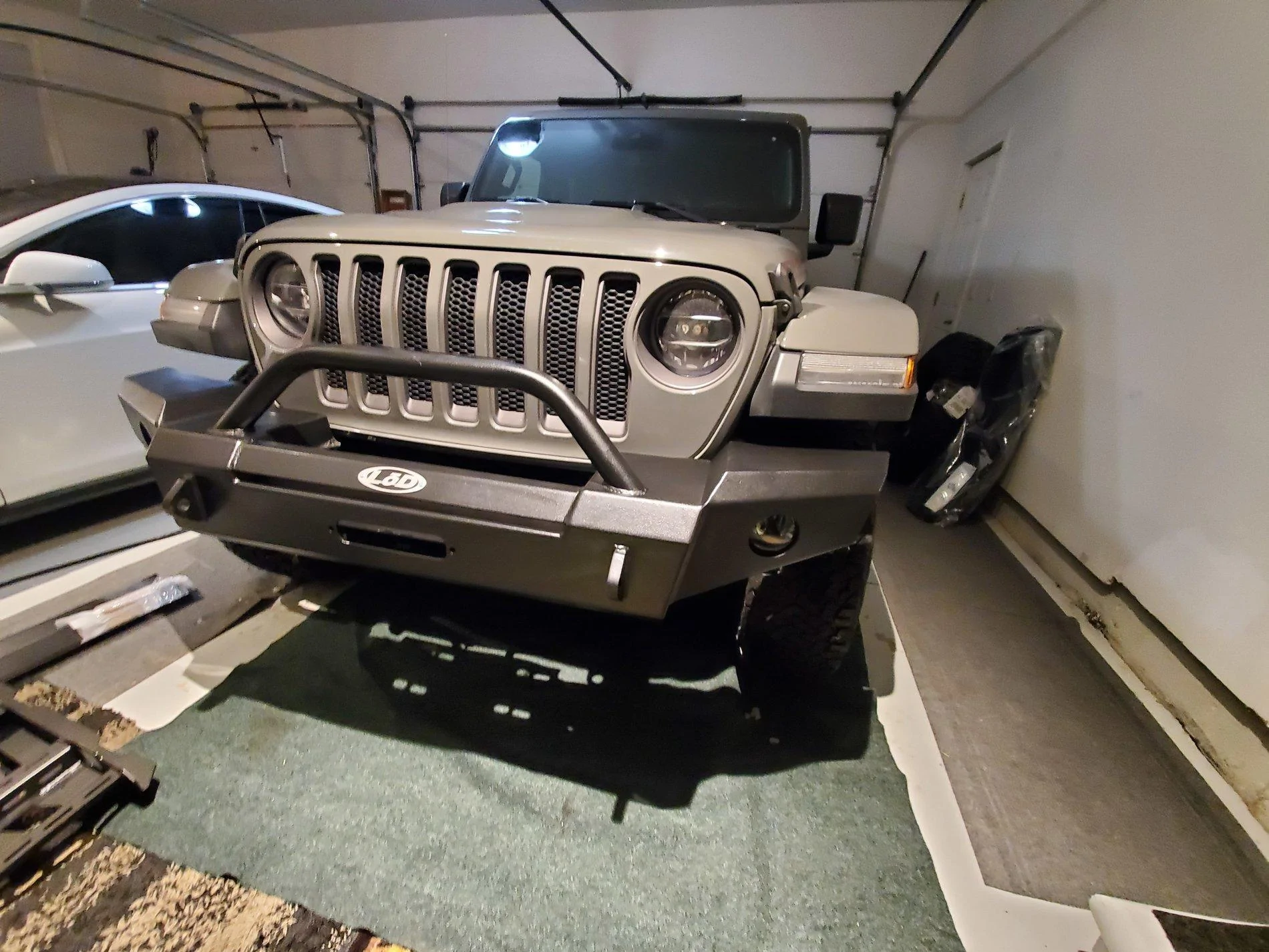

love the color matched wheels and black ring. As far as the sensors, I have Parksense off all the time anyway, but my question is if get a bumper with no provisions for the sensors, can I just leave them unplugged without any reprecussions?
it seems like you could. The 4 sensors are on the same wiring harness as the license plate lights. So I think you would just zip tie them out of the way somewhere and use the switch on the dash to turn them off. That switch remembers its last position so you don't have to manually turn them off every time you get in the Jeep.

Makes sense. Yeah I already have Park sense off all the time lol. I was just wondering if having them unplugged would give any issues. Also thanks for pointing it out that they are on the same harness as the plate light. makes it easier for my decision haha.

Amazing build! Congrats! When you say "the rear camera works fine", I guess you mean with the LOD relocation kit, right?
Also, do you know if LOD is still giving out 10% to forum members?
Thanks for your reply!
Yes, I meant the relocation kit works great and the view is just like factory. I dont know about forum discounts, but LoD was great to work with. And as I demonstrated above, I wont just say that about every purchase. LoD was great.
