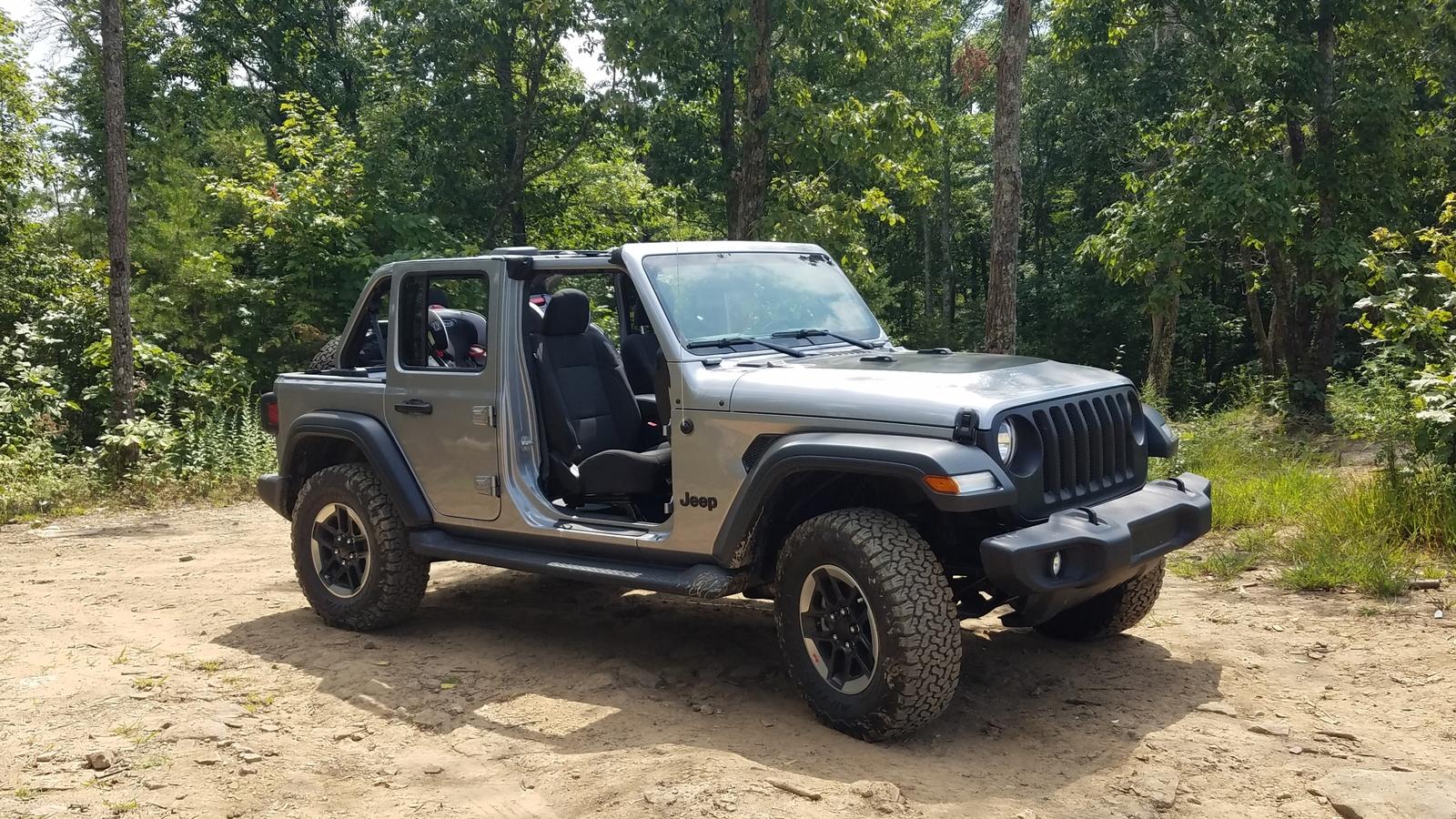

I have rubicon takeoff suspension/wheels/tires on my daily driver sport s and would like to go to 35's x 11.50 or 12.50 when these tires wear out. I offroad about once a month and want to preserve the on road ride quality as I drive about 25k miles/yr. I feel like adding 35's on current setup would be too stuffed. What would you recommend on a budget? Thanks!
Current setup with rubi takeoffs:
Jeep Wrangler JL Jlus going to 35's N6N3bm8

I have added rubicon takeoff suspension/wheels/tires on my daily driver sport s that gave me 1.5" suspension lift and would like to go to 35's x 11.50 or 12.50 without needing wheel spacers on my stock rubicon wheels if possible. I offroad about once a month and want to preserve the on road ride quality as I drive about 25k miles/yr. I feel like adding 35's on current setup would be too stuffed. What would you recommend on a budget? Thanks!

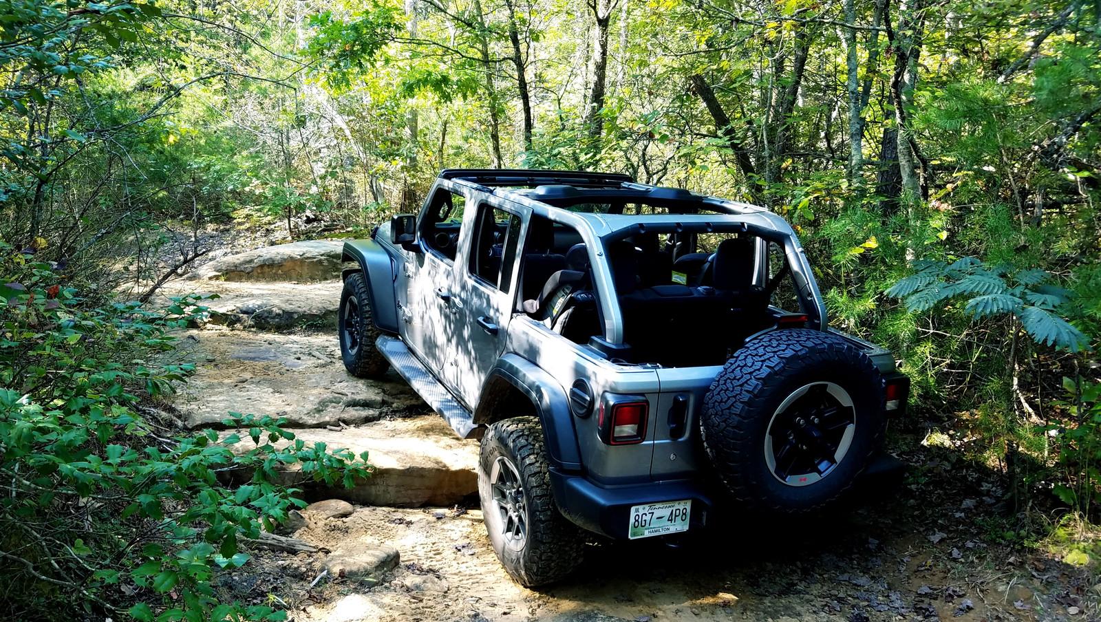

Considering going to ko2 315/70/17 class c or 285/75/17 ko2(34" ×11.50") adding 2" daystar or RC spacers with rancho 9000 adjustable shocks made for jlus 3.5" lift to soften ride on road. I light/moderate offroad once/twice a month and want to add clearance and for the tires/wheelwells to be well proportioned. Would the rancho shocks make a difference in ride quality with this setup?
Secondly, or would I be better off removing rubicon shocks/coils and buying new rancho coils/shocks/lca to add 2.5" lift? Thanks!

I would stay away from that particular 285/75r17 since it seems to only be available in an E Load rating. The Ridge Grapplers in that size appear to be available in a C-Rating. Having driven KO2's back to back in an E-Rating and a C-Rating the difference is night/day.
I think tire choice is one of the most underrated factors in ride quality. Sure properly valved shocks and spring rates are important, but throw on an E-Rated tire at 45+PSI(I see it all the time) and the ride will suffer.
The RS9000 shocks were always a nice/inexpensive choice on the JK. While I haven't had a chance to test the JL variants the ride was great on the JK especially when paired with a set of OME or EVO Springs. :like:
