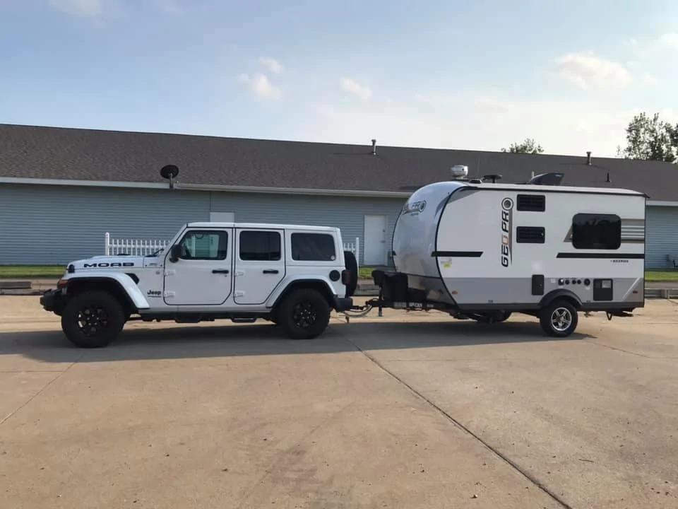

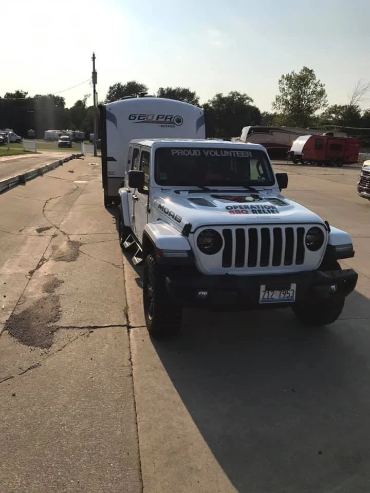

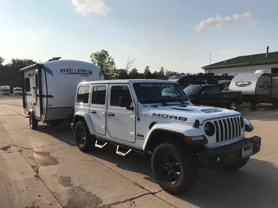

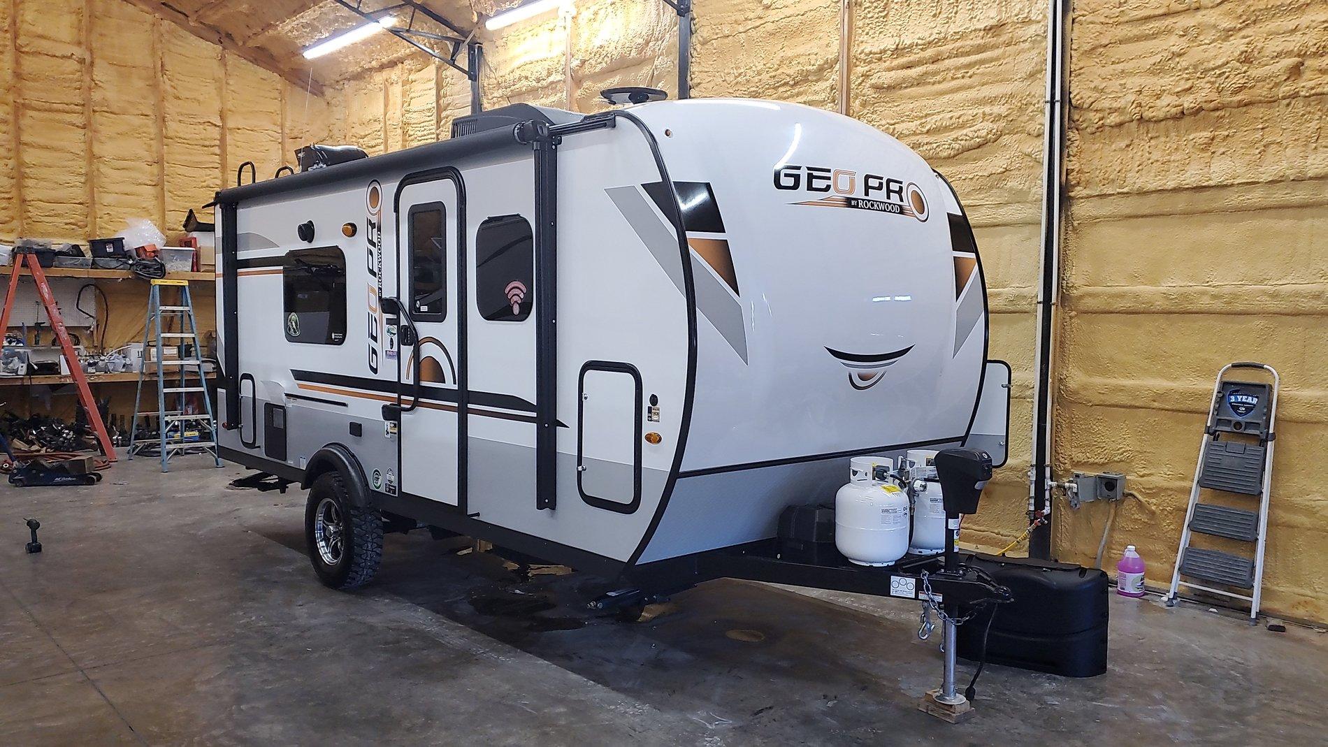

Hey, Y'all!
I just got a 2020 Forest River Geo-Pro G15TB to tow behind my 2019 JL MOAB. Dry weight - 2360 lbs.
I love the weight distribution system shown at the top of this thread...gonna check that out given that this rig will be towed all over the US.
Jeep Wrangler JL JLU pulling a travel trailer? No problem! MOAB+GeoPro3
Jeep Wrangler JL JLU pulling a travel trailer? No problem! MOAB+GeoPro2
Jeep Wrangler JL JLU pulling a travel trailer? No problem! MOAB+GeoPro1

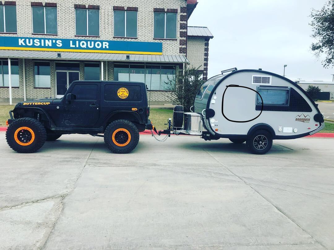

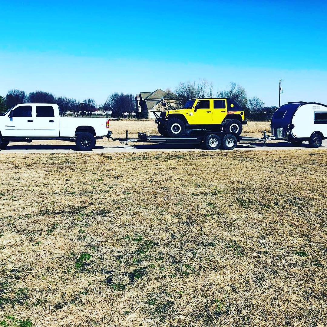

I would second the notion that you can definitely tow with a JL.
I bought this 17' Casita Spirit Deluxe back in January and have towed it from VA to PA, WV, and to Moab and back..(2000 miles each way). It is 2450 lbs dry weight with a hitch weight of 365 lbs. I use an Anderson weight distributing hitch to help with the weight which does sag the back end if you don't.
The JL has 3.5" Metalcloak lift with 37s. I regeared to 4:88 before I went to Moab last month. That definitely helped, though it did ok with the 4:10s before that. Gas mileage was about 13 mpg whilst towing.
On steep "hills" in auto it usually gets to about 3500 rpms to maintain 60-65 mph. It was definitely interesting going east back over the Rockies (not hills) where I had to hang in the right lane with the semis. Through all of it the transmission held up great and never had issues, always staying under 215 degrees.
If anyone wants a great little travel trailer, the Casita is awesome. Fiberglass top and bottom has fewer odds of leaks. They got better reviews than every other little trailer I researched.

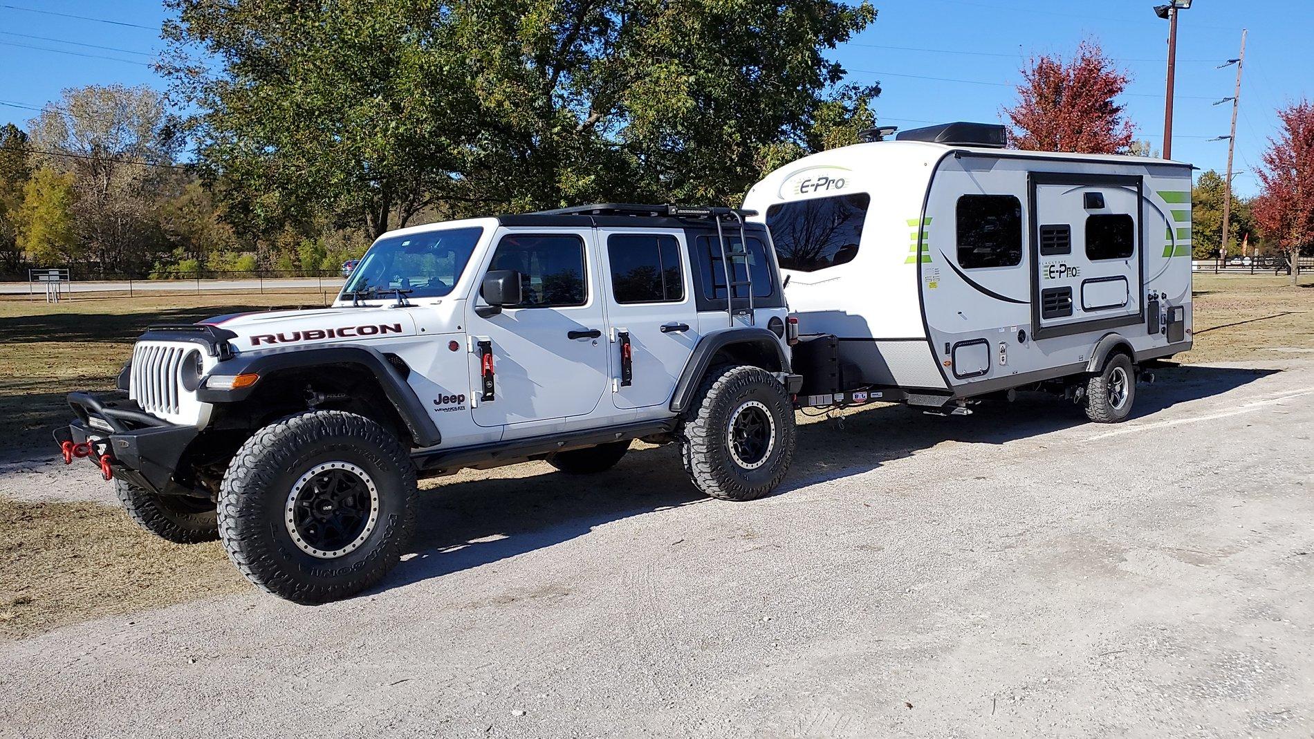

Here's a E-Pro 16BH. I did a test drive in. It pulled great. Ultimately I decided on a Geo Pro 19FD. It was so difficult to pick a floor plan. I wanted the largest dinette, largest bed, largest kitchen (which means you get 4cf fridge over 3 cf and oven), largest bathroom, most storage, no slide-out preferably (just soon not have to mess with them). Unfortunately there is no one floor plan that gives you it all.
My plan is to leave the cargo area of Jeep empty and maybe even take the spare tire off and toss all of that into the trailer for trips. It only takes 2 minutes to take tire off and 2 to put it back on, but saves over 100#.
Send me a PM if you have questions about the Geo-Pro/E-Pro line. I researched them to death.
Jeep Wrangler JL JLU pulling a travel trailer? No problem! PHOTO_20191102_152333
Jeep Wrangler JL JLU pulling a travel trailer? No problem! PHOTO_20191116_103226[1]
Jeep Wrangler JL JLU pulling a travel trailer? No problem! E16BH
Jeep Wrangler JL JLU pulling a travel trailer? No problem! R_G19FD_F_E19FD
