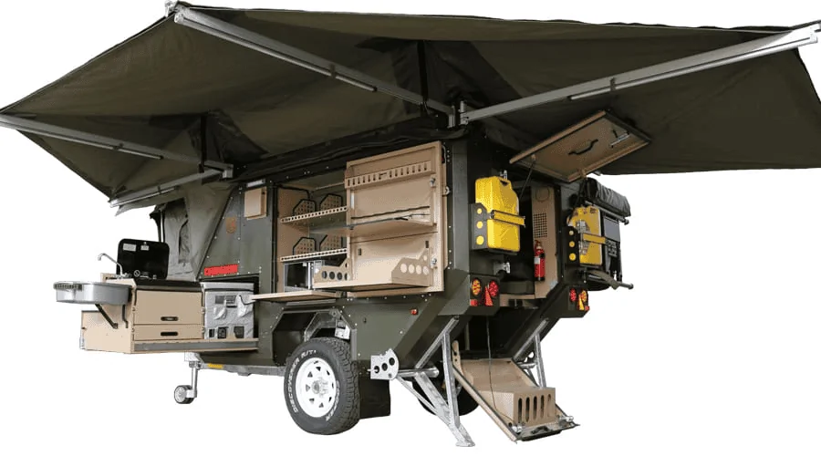

The wife and I made the trip to Denton, Texas this weekend to look at this. Wife decided (and I agree) this will be our first purchase once the house we are having built is finished (April-Mayish time frame). Bangs in at 2970lbs Dry.
https://conqueror4x4.com/product/uev-440/

Is that dry without any options (fridge, spare tire, water heater, maxxfan, batteries, etc)? Or is that with the base options? It is great that it is all metal with no wood or fiberglass if you take it over any rough terrain.

that is with ALL options...the camper comes fully loaded, only way to get it...Watch this...not a great video but, you'll get the idea.
And the slightly larger (and heavier 3300lbs) UEV-490

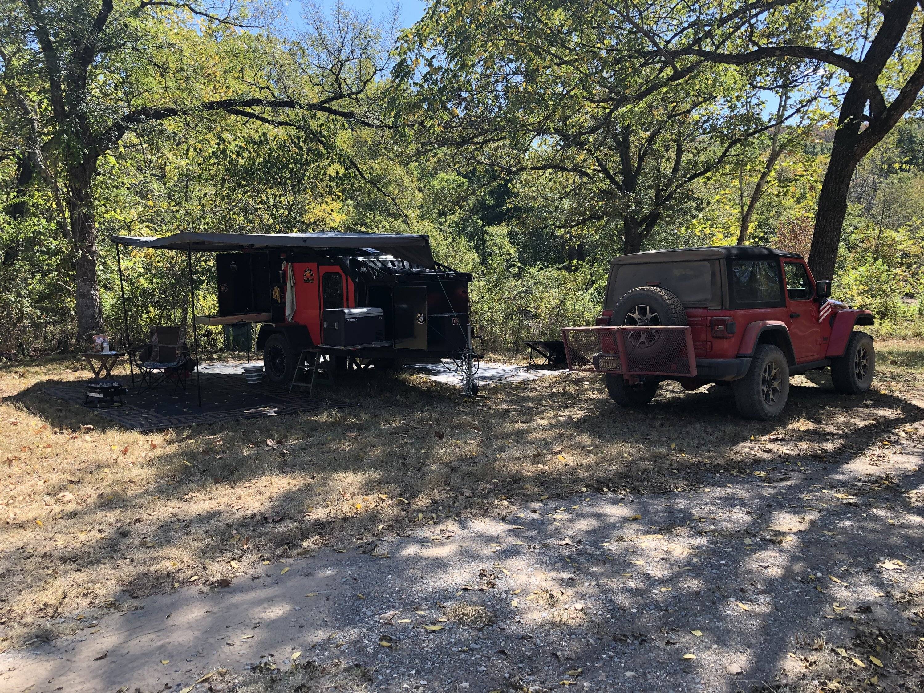

How does that trailer handle behind the 2 door? I’m about to pull the trigger on the same one but unfortunately don’t have the option to test it out before I buy. I know the drivetrain will handle the weight I’m just worried about the wheelbase
Handles great. I added air bags in springs and overload bump stops to keep level. Length of trailer just right for 2 door Rubicon. The max coupler hitch is the trick. Curt electronic brake control and app works great.

That’s all I needed to hear to pull the trigger!

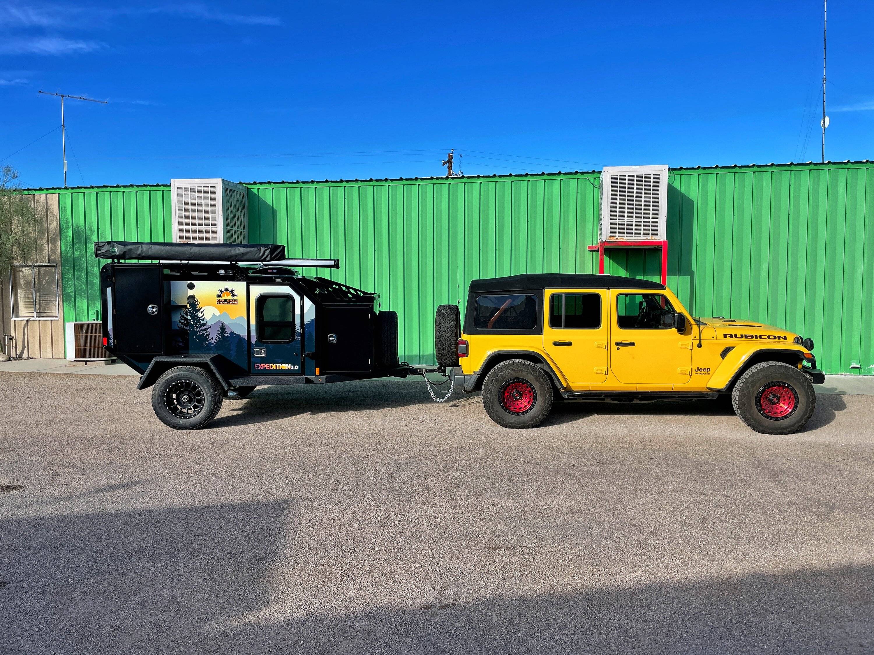

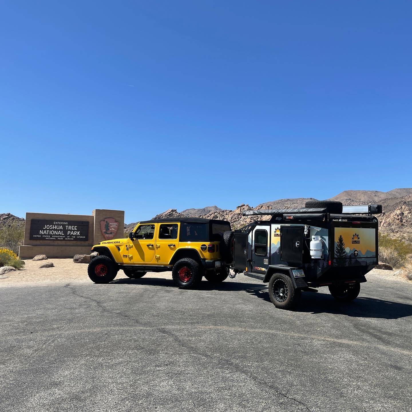

I installed the Rock Krawler XFactor No Limits 3.5" lift, but got 4.5" rear springs and the trailer is level when towing. I avoided air bags based on so many comments of them popping when articulating off-road. I keep the 31 gallon water tank filled and with my locking wheel chocks and other item in the rear storage I have no issues. I need to go to the CAT scales with the current setup, but know I am under 2,800 lbs (I have the 69 liter Truma and almost every option minus the roof top tent). I have the factory tow package, but mine is a 2019 so I added the Redarc Tow Pro Elite controller and it works great.

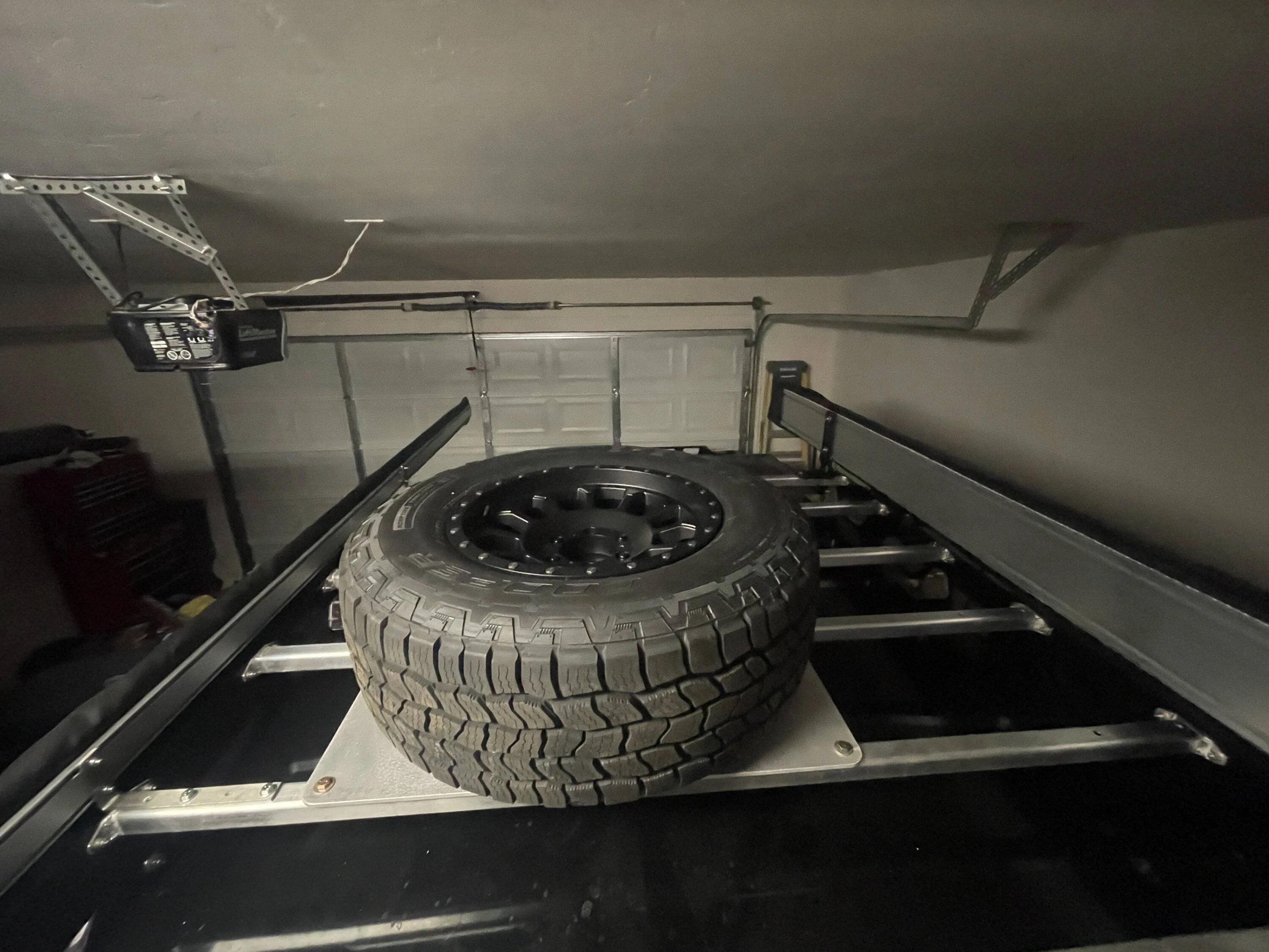

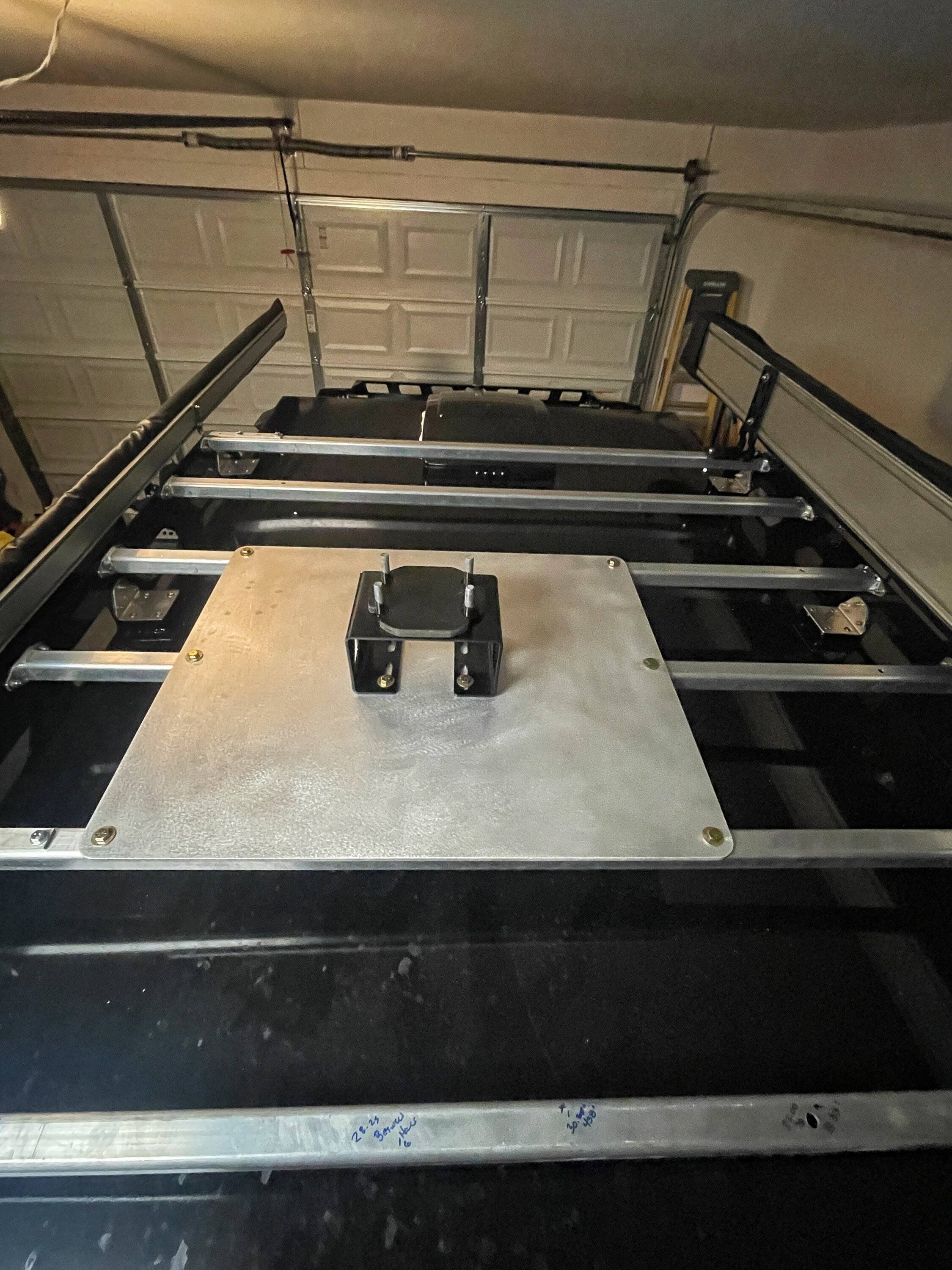

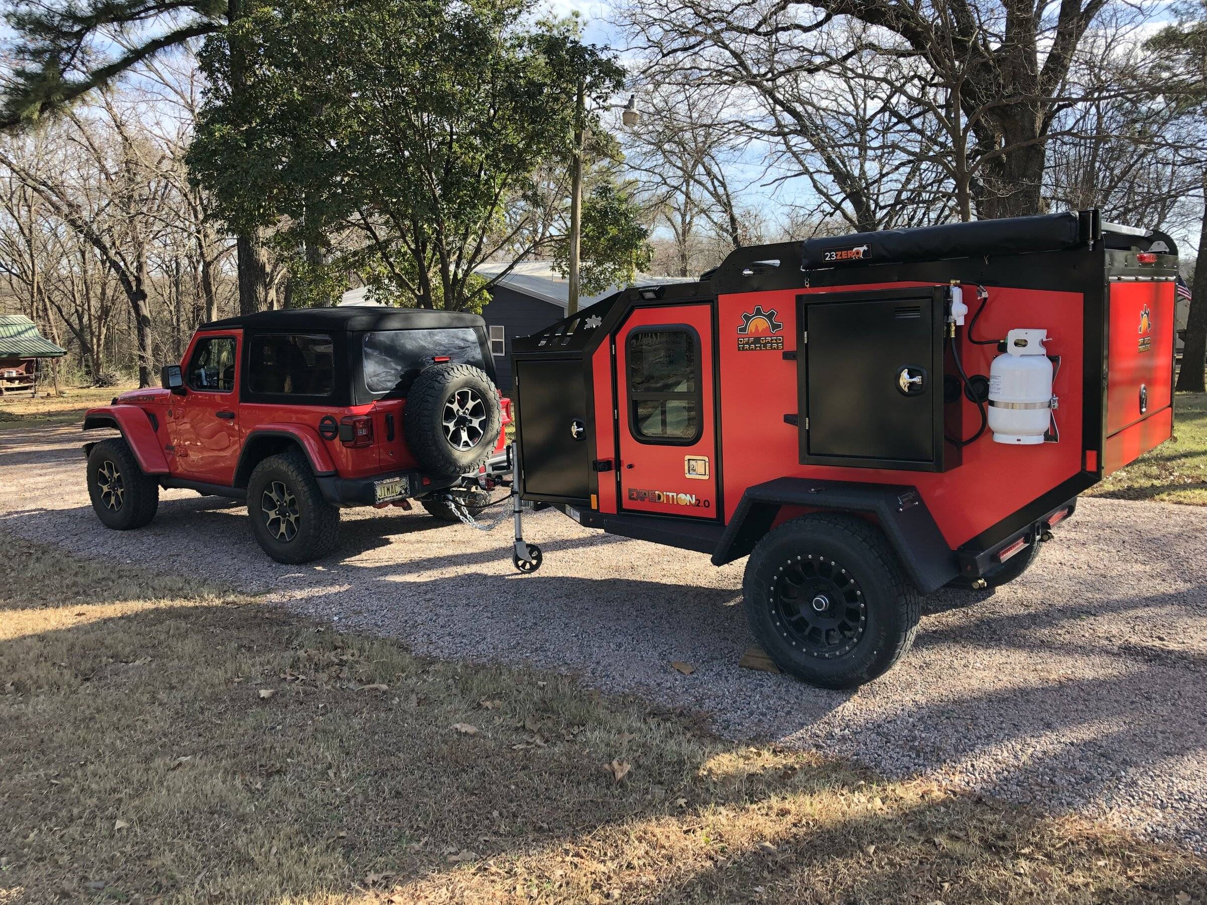

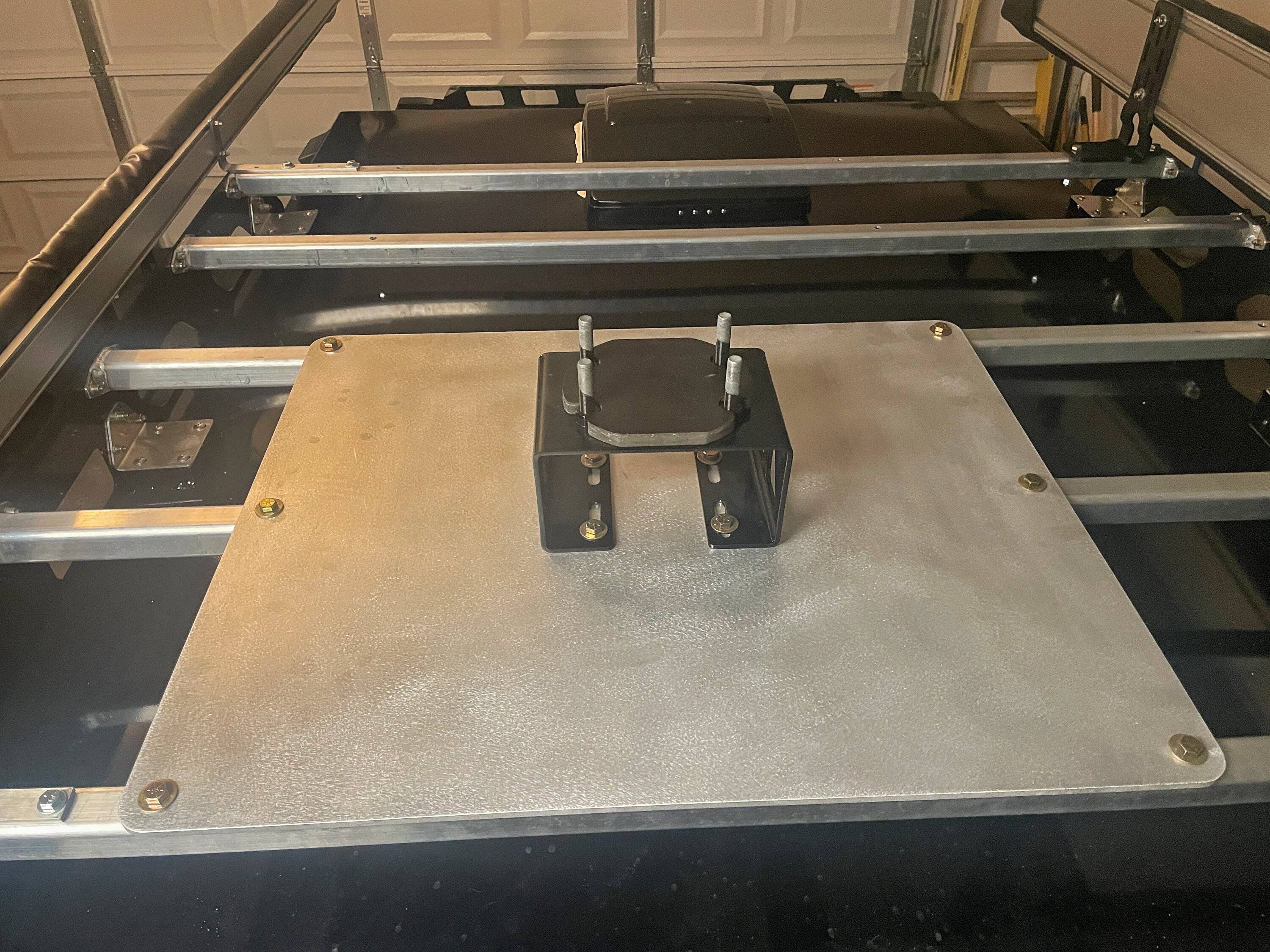

I doubt you will have any troubles. If you got the spare, I would relocate it to the roof with the center just rear of the axle centerline. The photo in front of the Joshua Tree sign is with the lift and 4.5" rear springs and the other is with stock suspension when we picked the trailer up in December 2021. The other three images are the plate I designed and had made out of 1/4" aluminum to mount the tire to the roof rack.

Please check what the loaded weight is. What I have found out with these types of trailers is that the dry weight is with no accessories. It is the chassis's weight before fridge/freezer, water in tanks, batteries, ventilation fans, awnings, roof top tent, propane tank, etc. My trailer is 1,700 lbs dry and with fridge/freezre, batteries, spare tire, all other accessories, water, and supplies for a week plus of camping I am at just under 2,800 lbs. Looking at the interwebs the weight comes in at 3,700+ lbs on RV sales sites and one site it is north of 4,800 lbs for the platinum version.

Be aware that most, if not all, campers WILL be heavier than the advertised “dry weight”. I have been fooling with campers for many years, and every single one I’ve had (or friends have had) was anywhere from 200 lbs UP from advertised weight. Frontal area is also a concern on our Jeeps. Good luck and have fun, but do your homework First.
