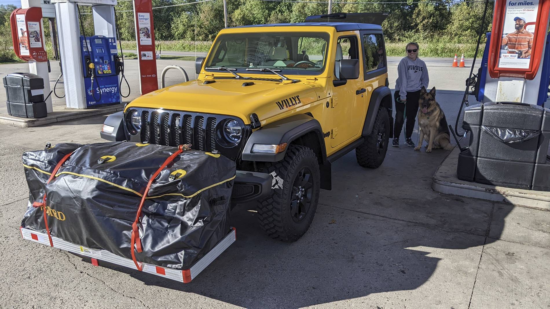

Beware the tongue weight of your TT and the limits of your potential front hitch.
I have a Curt front hitch installed on my JL as well for road trips with my girl, luggage, and 110 lb shepherd. Curt only lists the tongue weight at 350 Lbs. I suspect your TT is there, or close... FYI
Jeep Wrangler JL Parking a travel trailer question PXL_20231008_140956470
