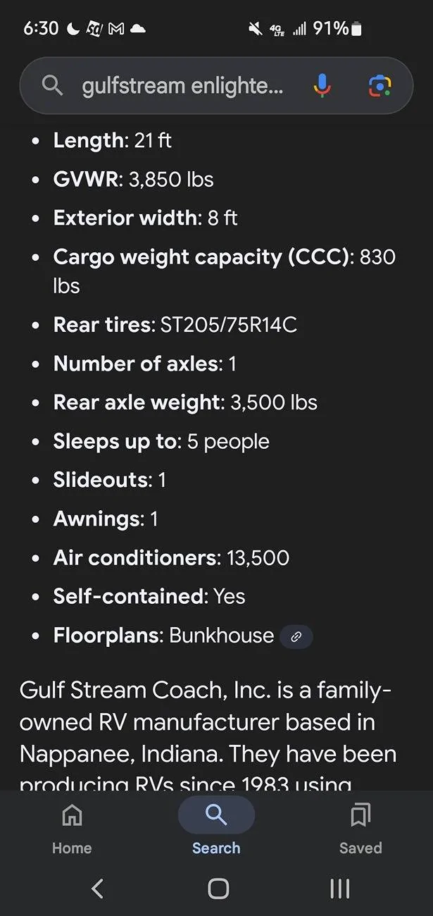

So I'm getting mixed reviews / answers.
What is the real max towing of a travel trailer
Looking at Gulfstream enlighten 17hb and told my 2018 Jlu can't haul it.
But the wife's 2024 grand cherokee l will be no issue.
So my pros of pros.....what do you all do?
Tia. :

Any folks willing to provide what kinda camping trailer, not custom build unfortunately, off the lot that they have experience with?
We as te looking at the 4 person with bunk beds as I have a 2 and 7 year old daughters.
Gulfstream enlighten 17bh

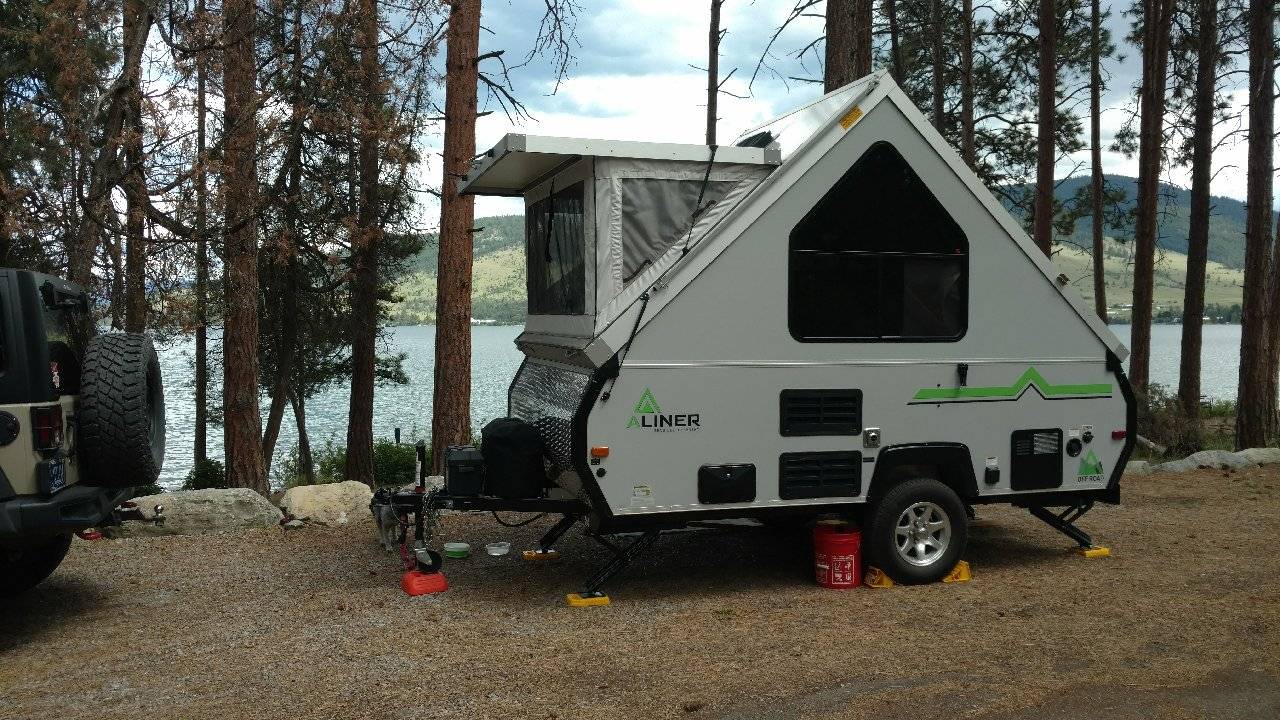

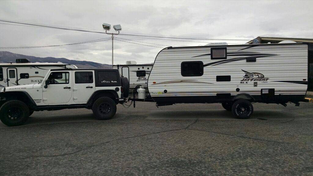

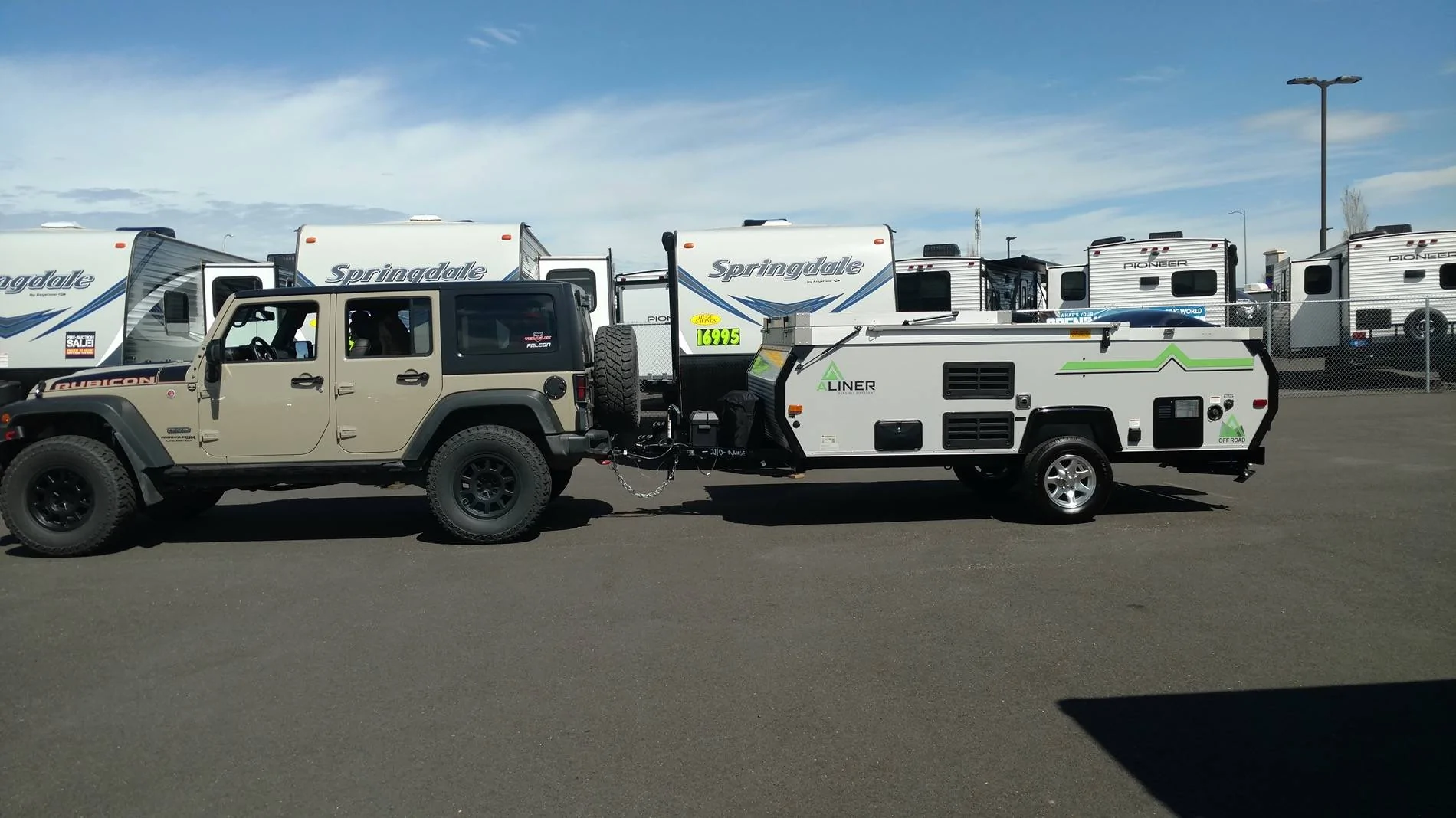

jadmt
jeff
May 19, 2020
79
5,324
10,292
montana
I have towed a fair amount with JKUR's those had tow ratings of 3500lbs . I live in Montana so either going up or down. My Jayco195 had a dry weight of close to 3000 lbs and in reality it takes nothing to get over 3500lbs. It did fine but I 100% liked towning my Aliner better. I could tow that 70 mph all day long without even knowing it was back there if it were loaded up. My JLUR has a tow rating of 5000lbs. I would tow the gulfstream enlighten as it looks like a dry weight of 3000lbs with mine but would be careful how I packed and not carry water while traveling.

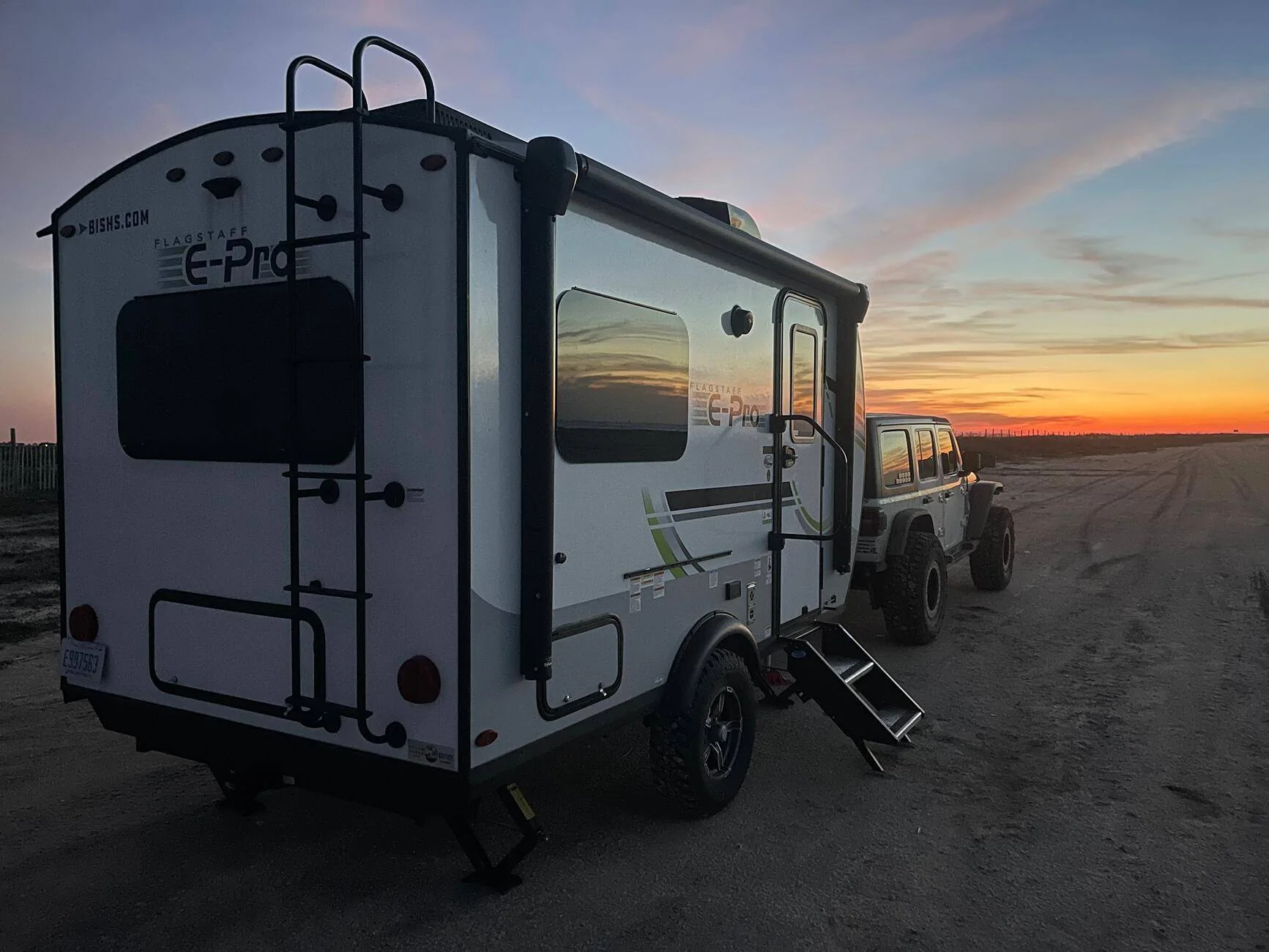

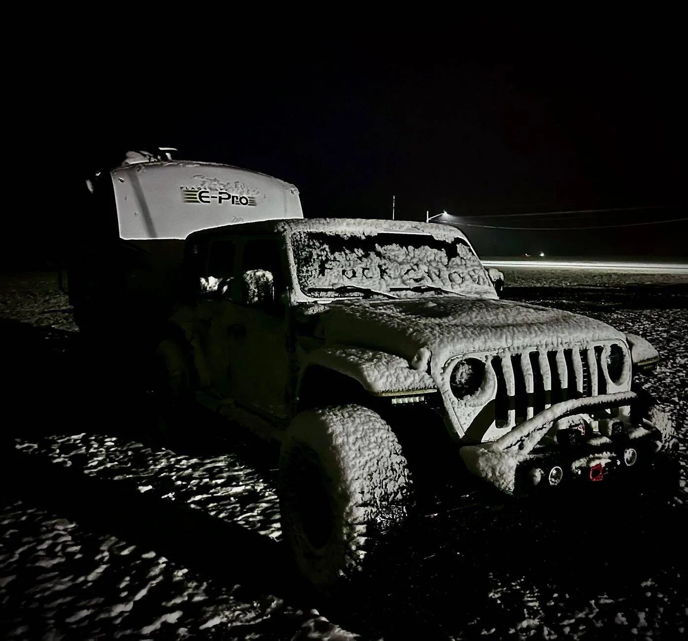

wibornz
Ted
Aug 3, 2018
194
14,790
71,898
lansing, Mi.
www.instagram.com
JL Unlimited Rubicon
I have towed a camper 74,000+ miles with my JLUR on 37s. I currently tow this set up. The camper is about 2600 empty and loaded, I am about 3200 to 3300. I have towed this camper approximately 22,000 miles this year. Over many mountain passes and into big head winds and all kinds of weather conditions. I would not want to go any heavier than I am. The Jeep handles it well, I keep the speed between 62 and 67 mph. I can tow it faster, but man will you pay at the pump. Mountain pass, I can tow it at 60, I prefer 50. The Jeep is in 4 gear and about 4000 or so RPMs. My temps stay normal and does not generate a bunch of extra heat.
Jeep Wrangler JL Small travel trailer 1734268167909-0h
Jeep Wrangler JL Small travel trailer 1734268266477-q0
Jeep Wrangler JL Small travel trailer 1734268322415-u3
With that said, I don't want to pull more weight. Could I, yes, Could I safely maybe. Do I want to no.
It should be noted, I am on 37s, and I am running 5.13 gears. There are now four of us in my group that pull this camper. So between us, we have about 35,000 miles of a JLUR towing this set up with out issues.

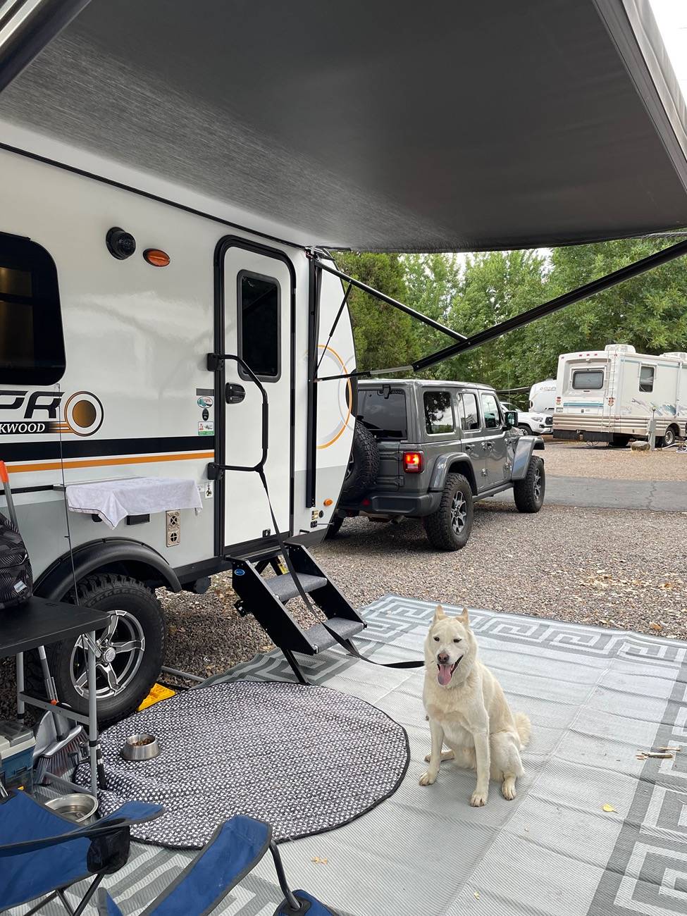

Lonniew09
Lonnie
Mar 1, 2022
Pine Valley, Ca
Jeep Wrangler JL Small travel trailer IMG_7331
Geo Pro FTB15
Tow it all over SoCal. We carry a lot of stuff and have had no issues. I would not recommend any bigger/ more weight. I am on 35s now, same gears.
