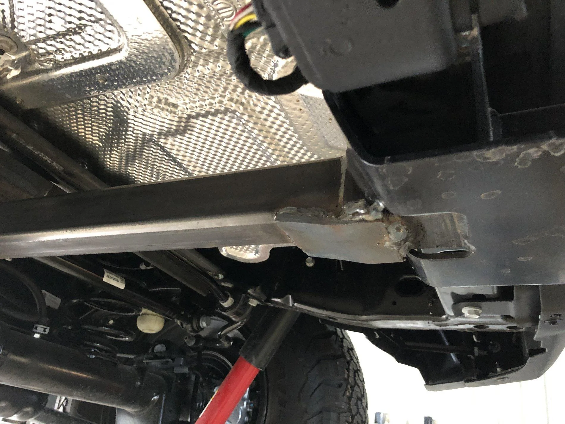

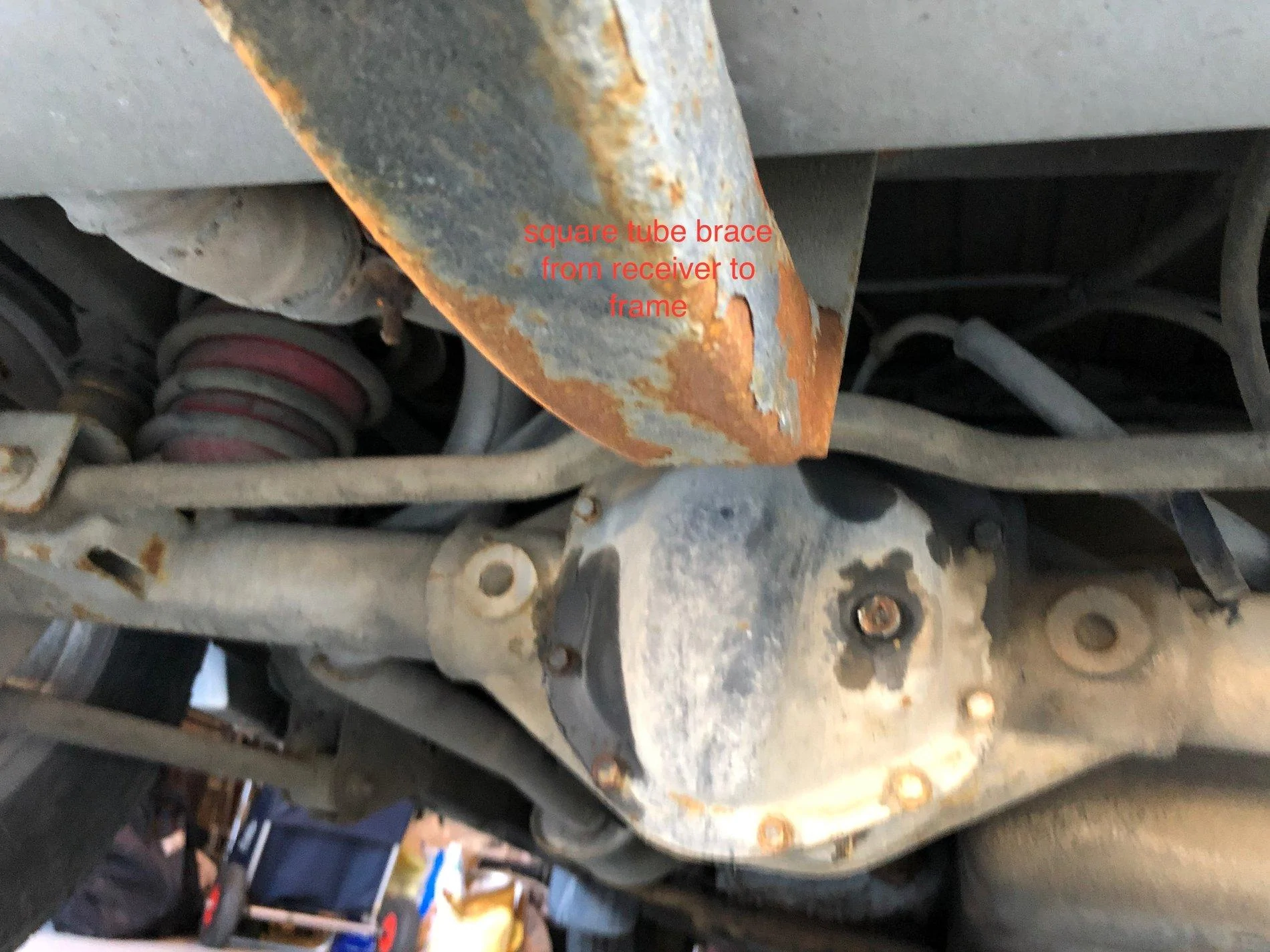

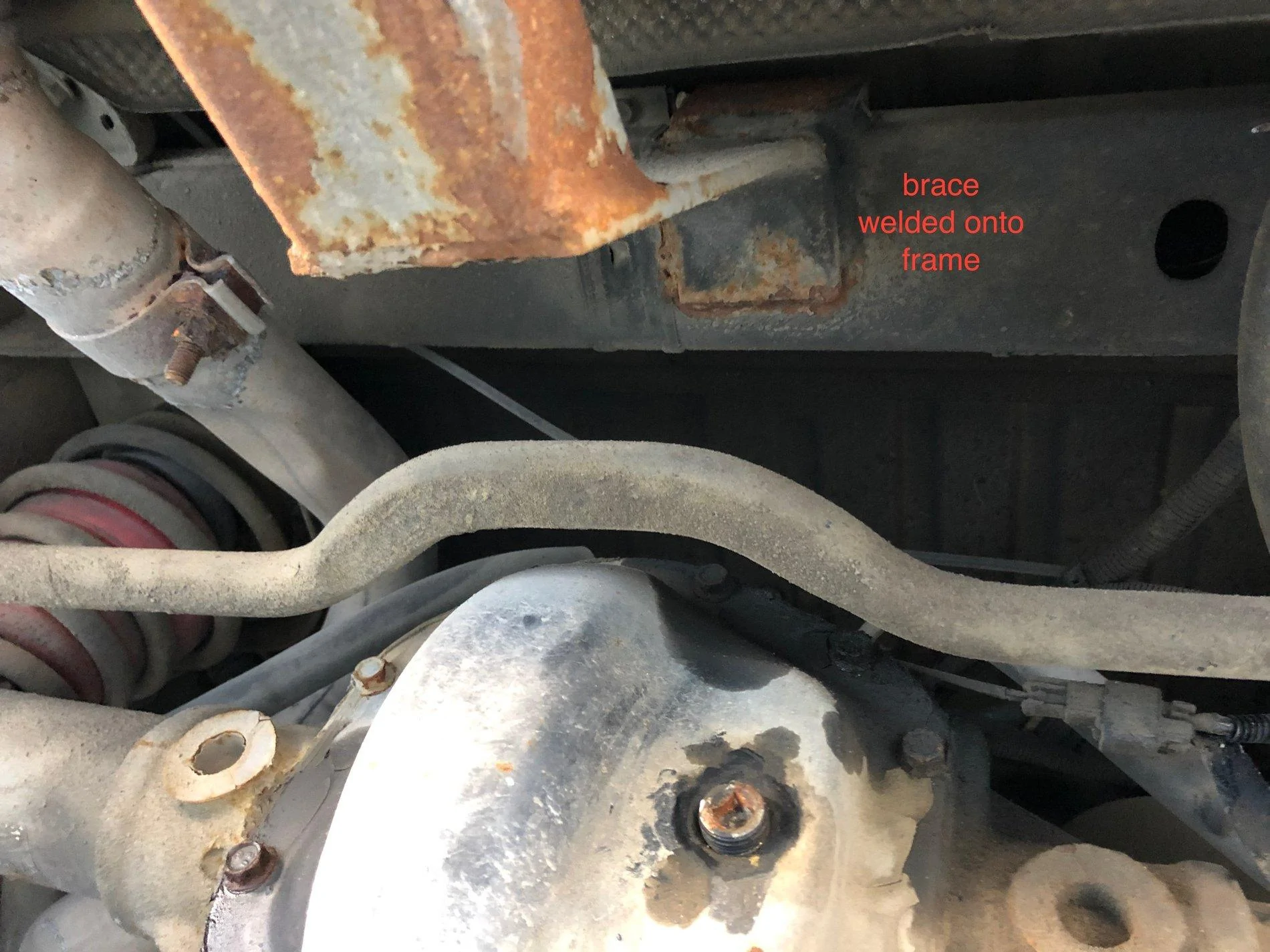

Here are some photos of the hitch work that was done on my JKU. I am taking my new JLU in this week for hitch upgrade work. I have installed a Magnaflow American Thunder axle back exhaust pipe (817837) muffler delete to make the hitch work easier than on the JKU.

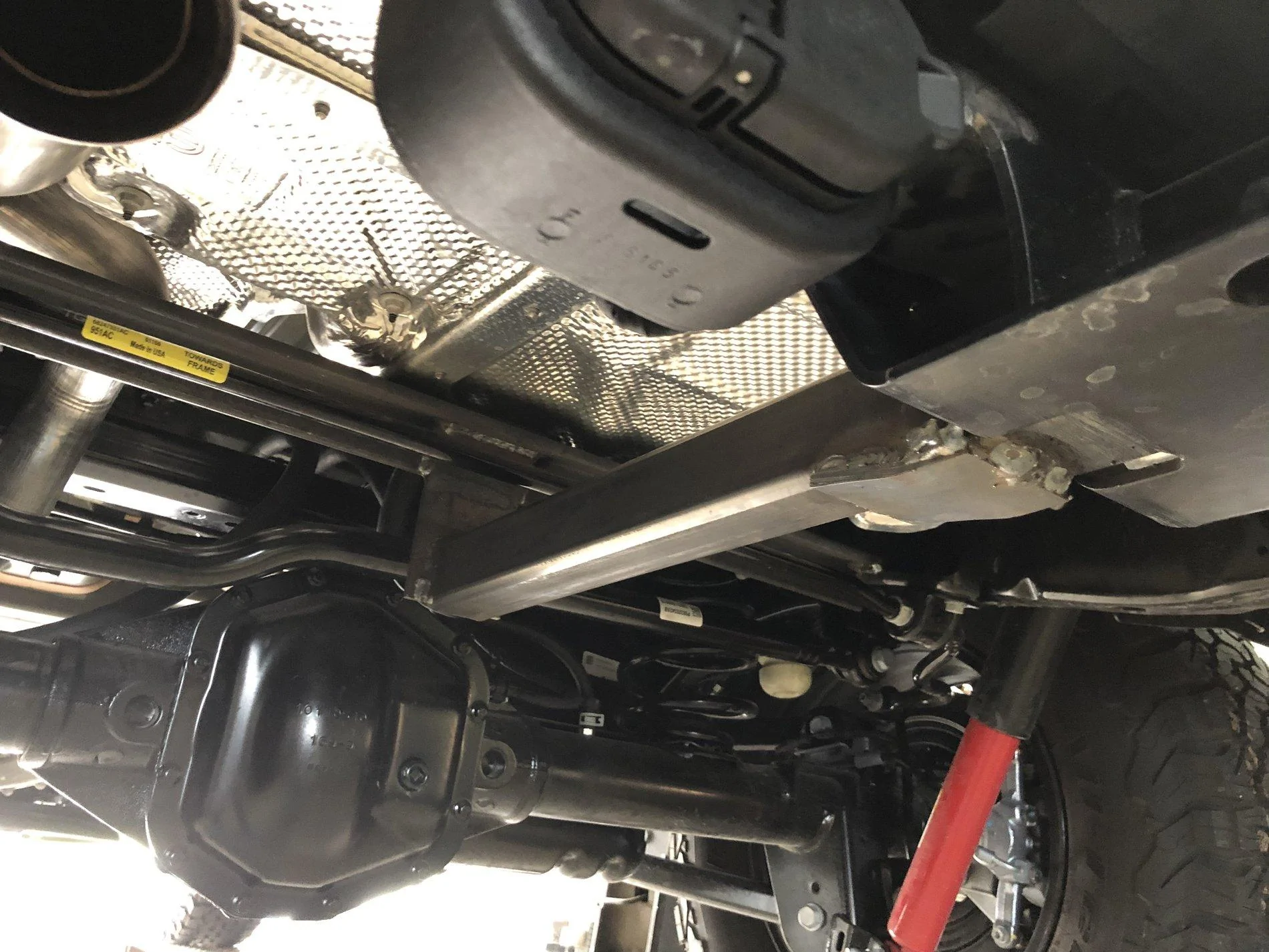

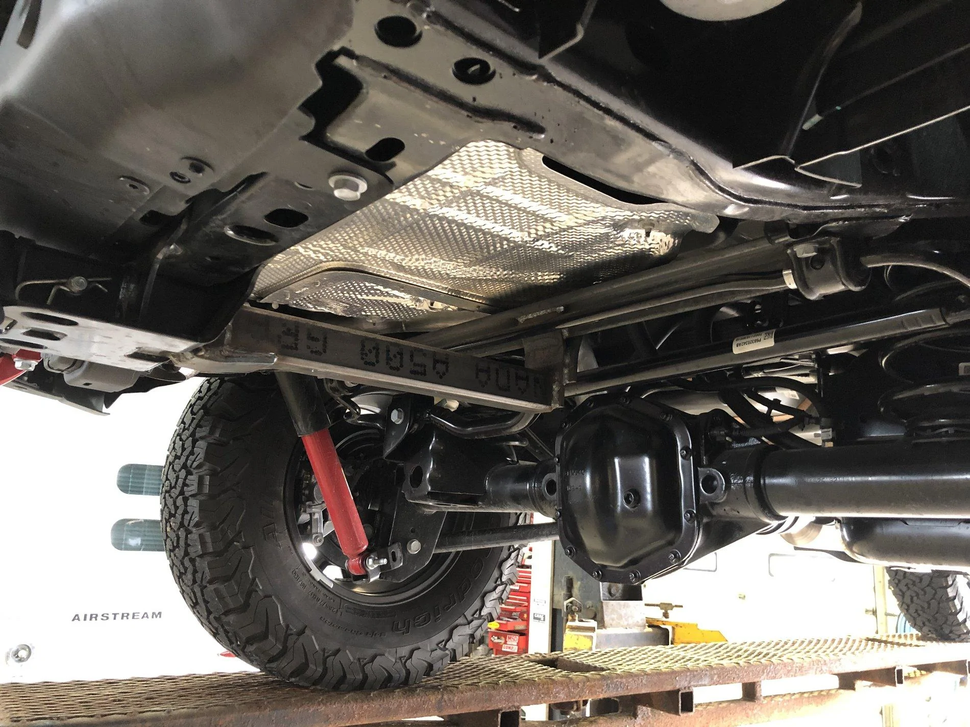

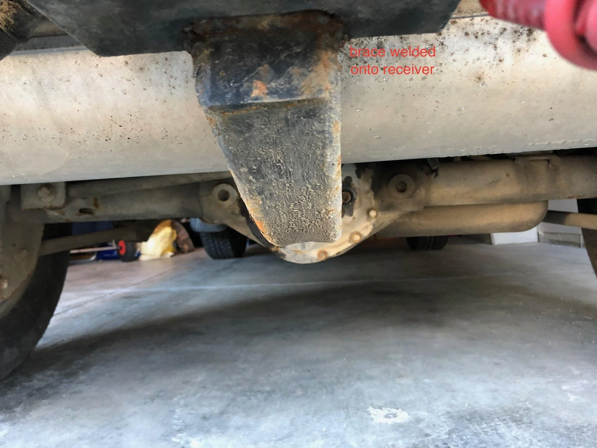

As you requested.
Jeep Wrangler JL JLU pulling a travel trailer? No problem! Rubicon Hitch 1
Jeep Wrangler JL JLU pulling a travel trailer? No problem! Rubicon Hitch 2
Jeep Wrangler JL JLU pulling a travel trailer? No problem! Rubicon Hitch 3
An piece of angle iron was welded between the frame members and then the square tubing was welded between the receiver and the angle iron.
The new steel has been painted and undercoated after the photos.

Making it "class 4" then is just additional welded support? It's not a whole new hitch assembly? Is the frame member towards the axle that sturdy? Looks a little anemic to me.
Thanks for the pictures.
They added 1/4" steel angle iron between the frame rails. The fore/aft square tubing is welded to the angle iron and to the receiver. There is an additional brace (hard to see in the photos) from the angle iron to a Jeep cross member. The strengthening is to prevent twisting of the receiver when used with weight distribution bars. The receiver is now strong enough to carry a larger tongue weight and the WD system is now able to transfer some of the tongue weight to the front axle and some back to the trailer axles.
