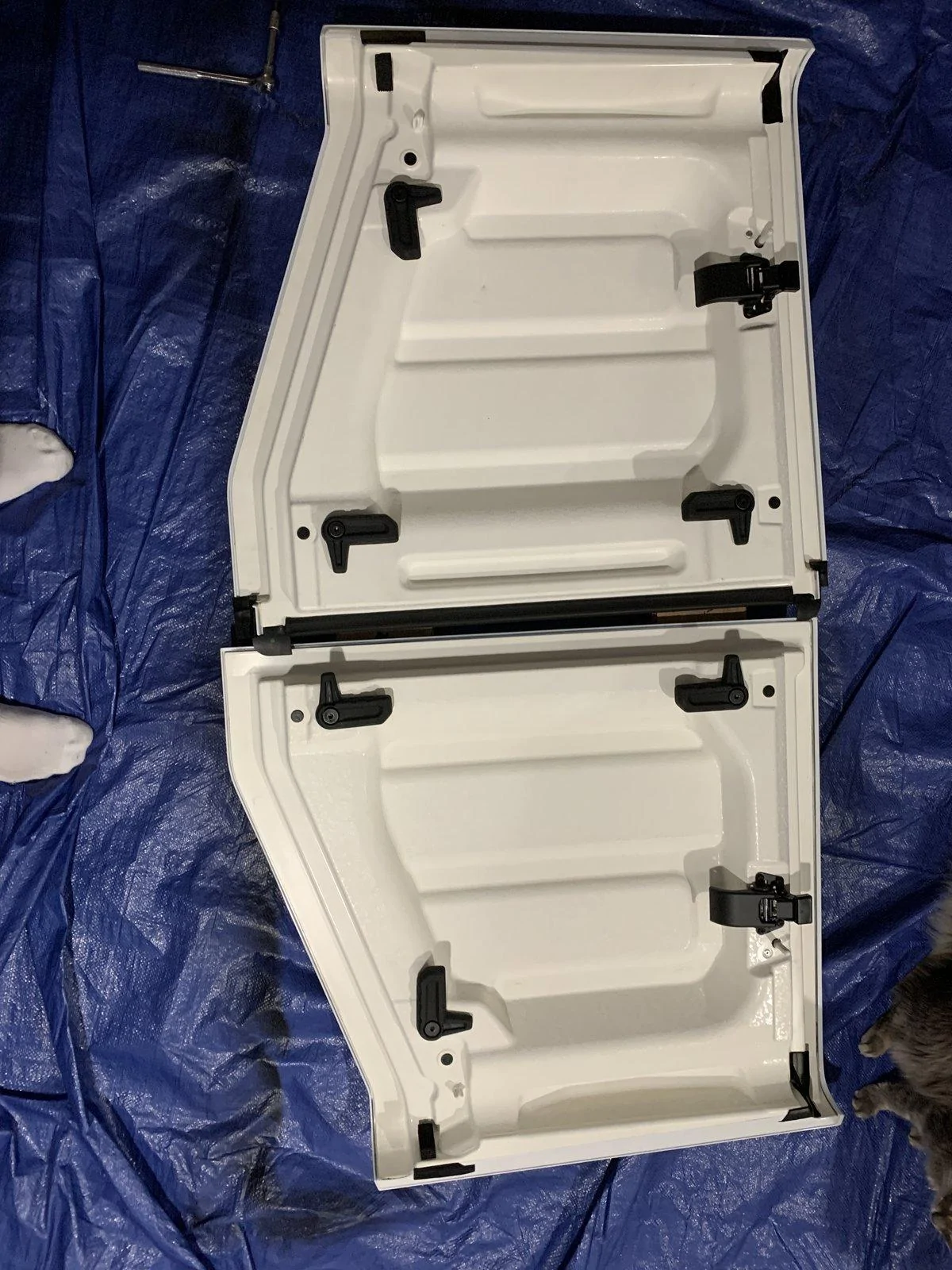

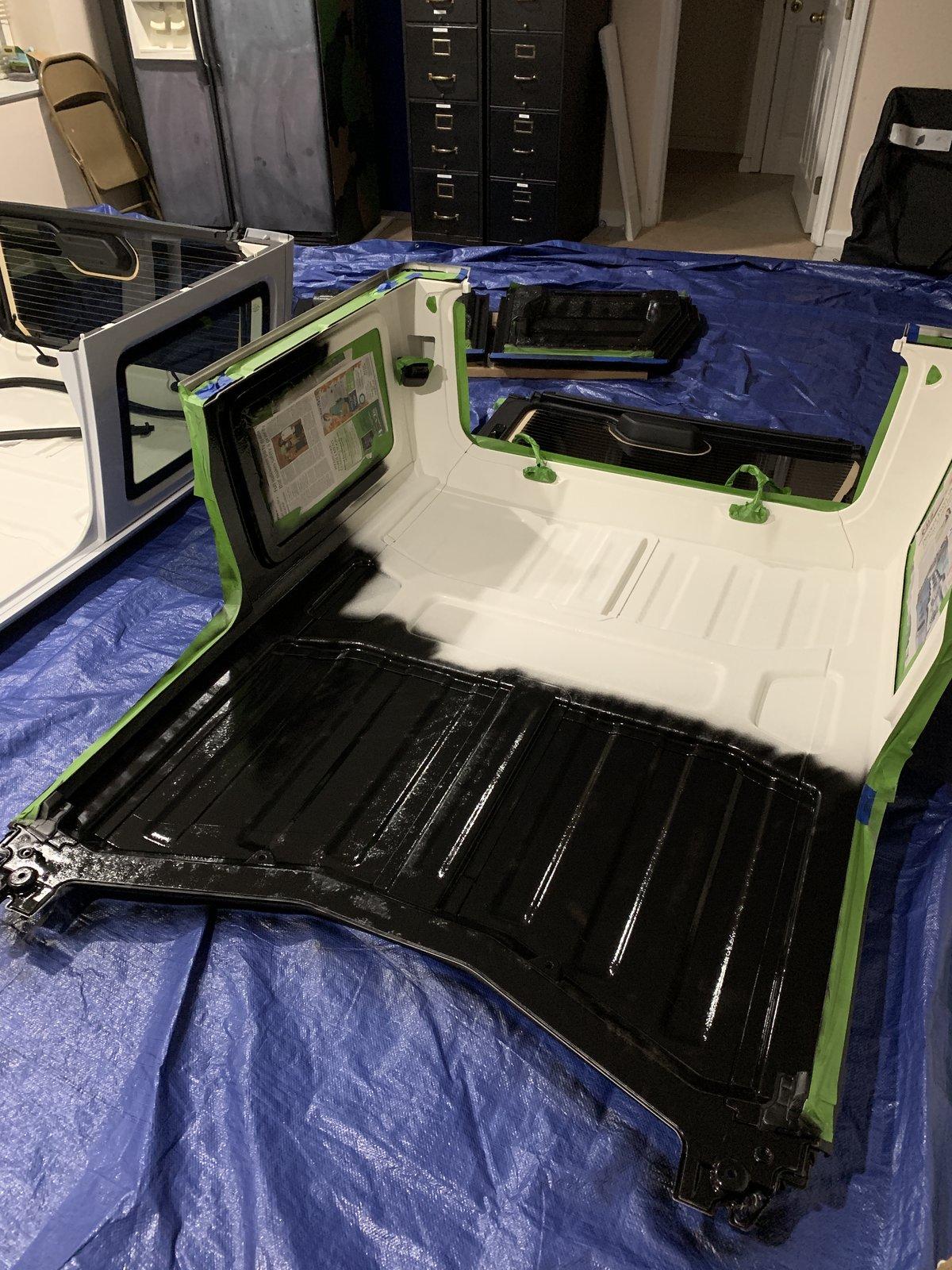

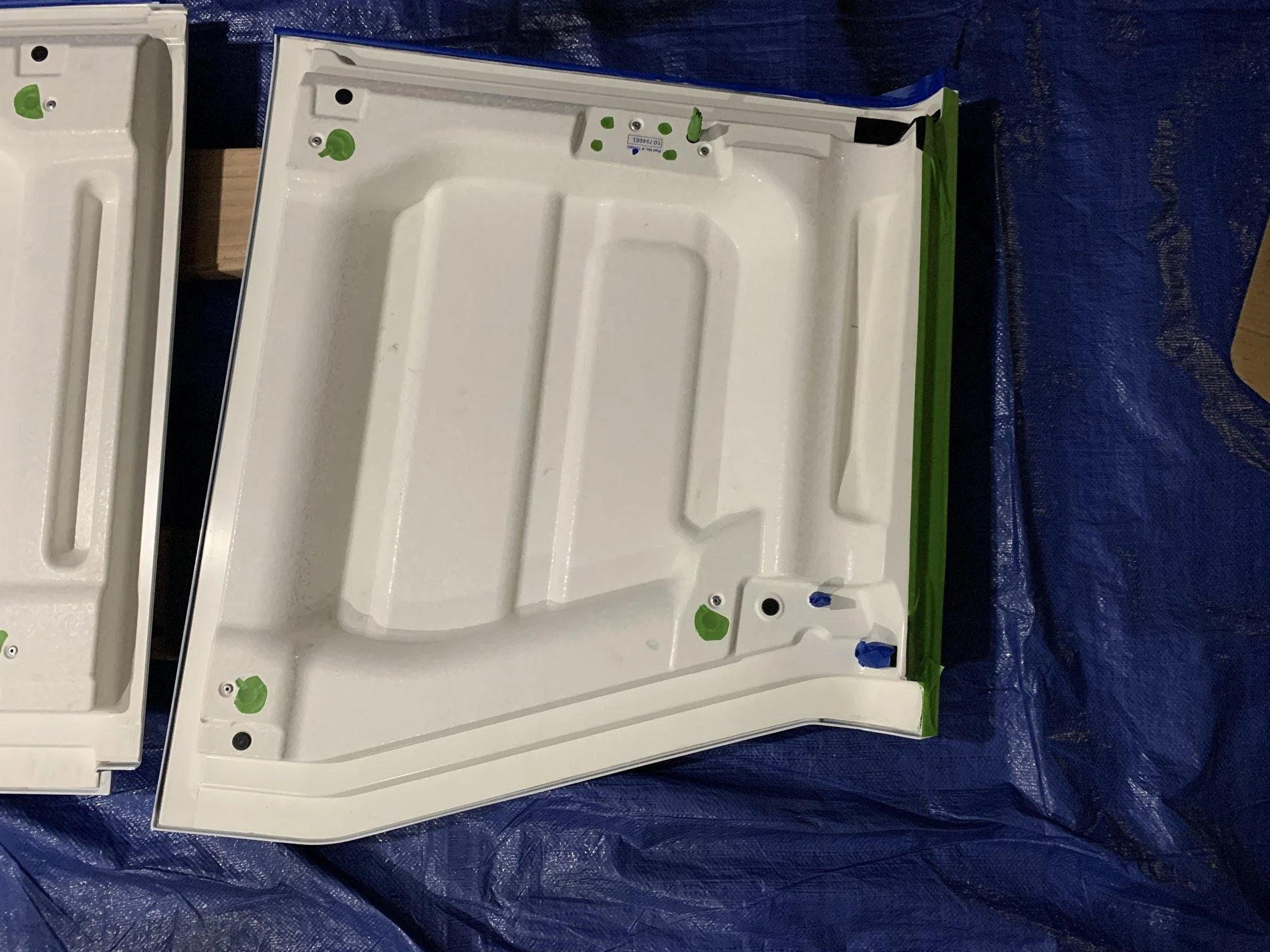

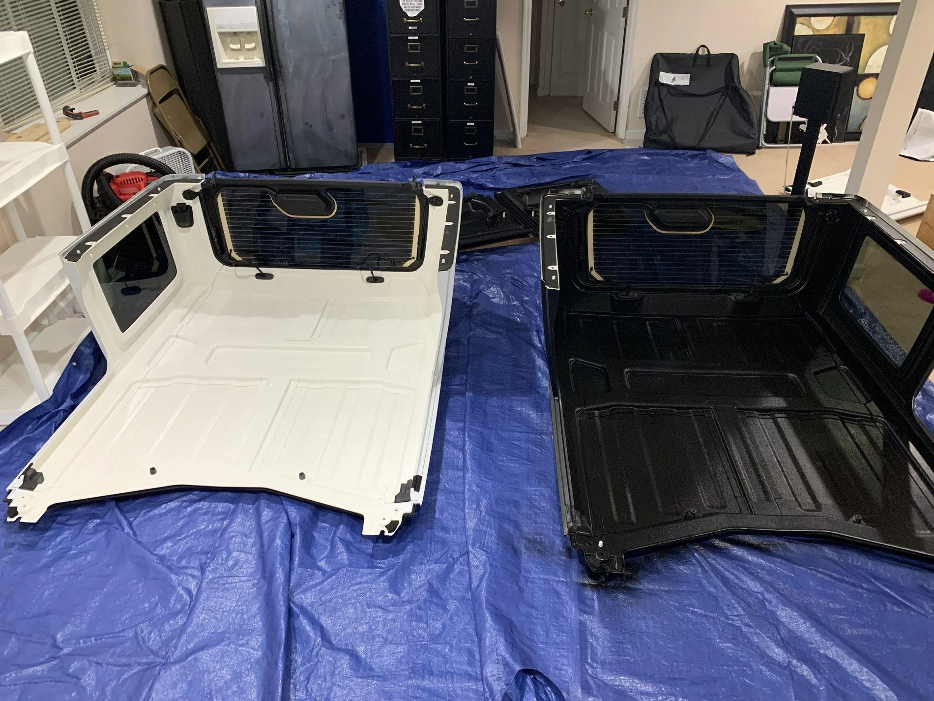

Cold weather time! Hard tops go back on! Saw a few others paint the inside of the hard top, so did that as well. We decided to do it with Plasti-Dip and not truck bed or other paint. We like the idea of being able to remove if wanted, even though it would be a pain in the @$$. Since it was cold, i painted it in my basement. If you do this, be warned that it's not preferred - LOL. We all had headaches, even though i tried to ventilate as much as possible. I will consider it worth it, but it sucked for that day/night.
Panels before:
Jeep Wrangler JL JL's JLs Builds IMG_2766

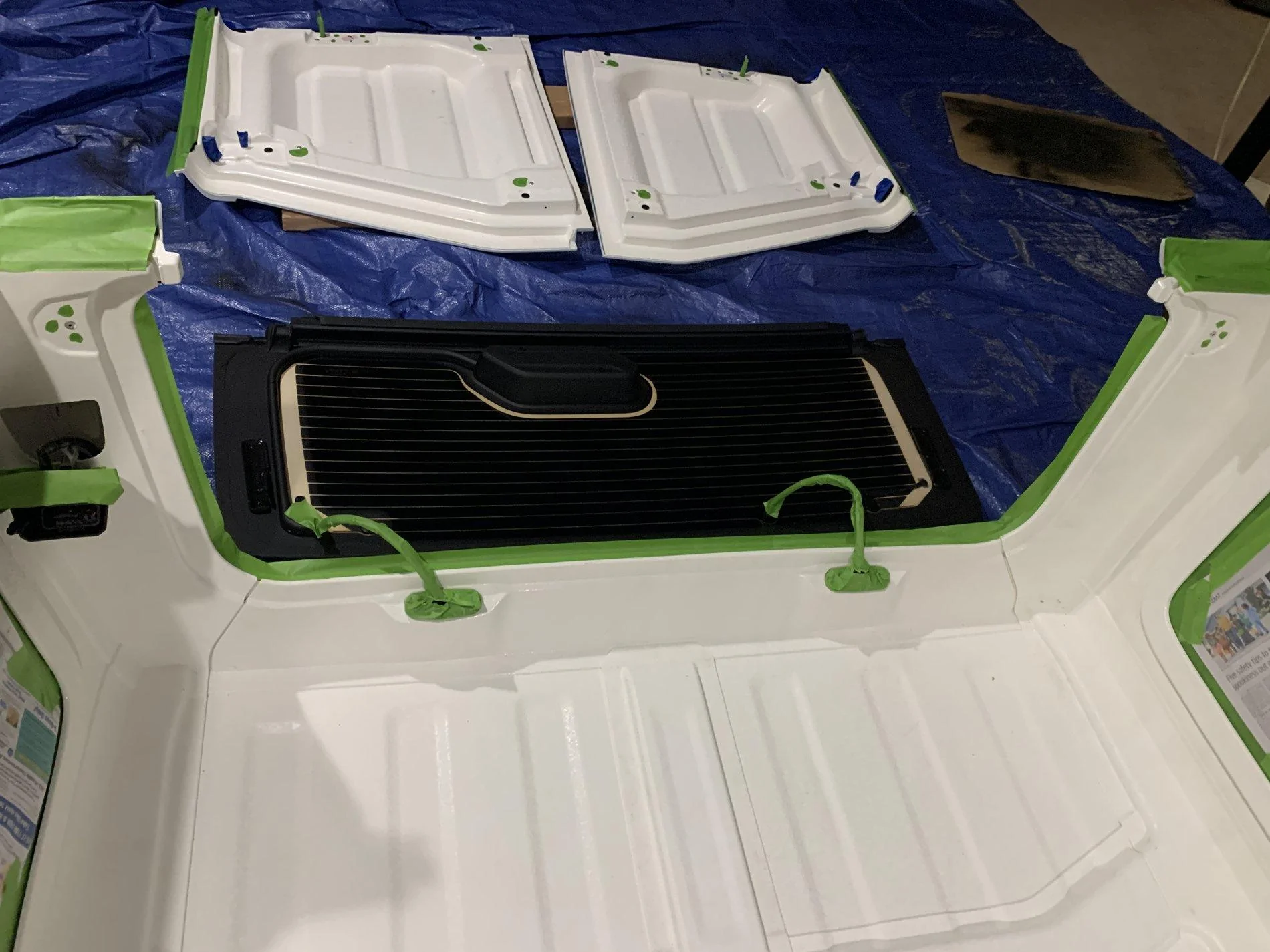

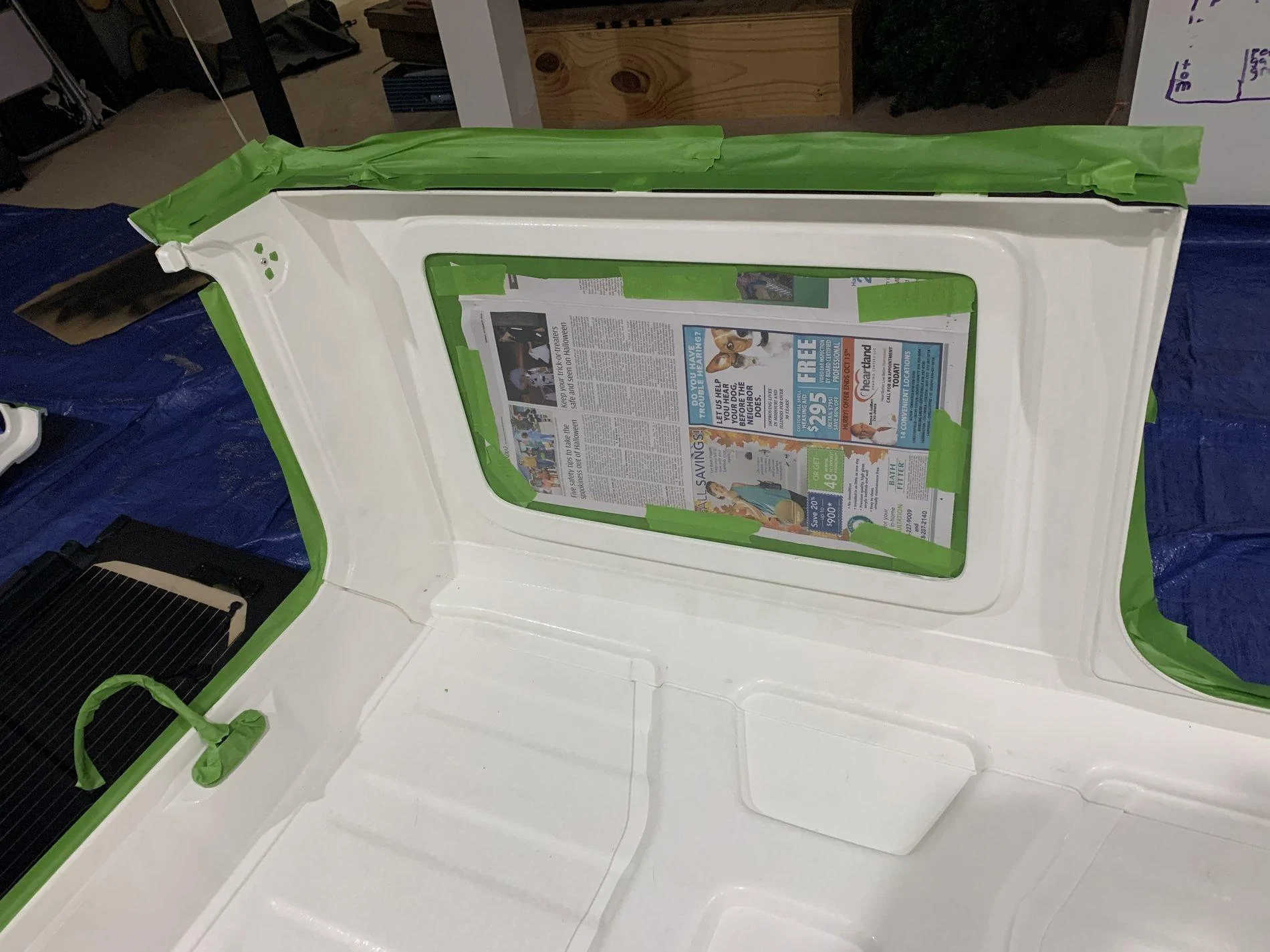

Remove the weather-strip and hardware and taped. I used an exacto-knife to cut the circles. This pattern can be visible when you're done, so think about if/how you want to do this:
Jeep Wrangler JL JL's JLs Builds IMG_0797
Jeep Wrangler JL JL's JLs Builds IMG_8290

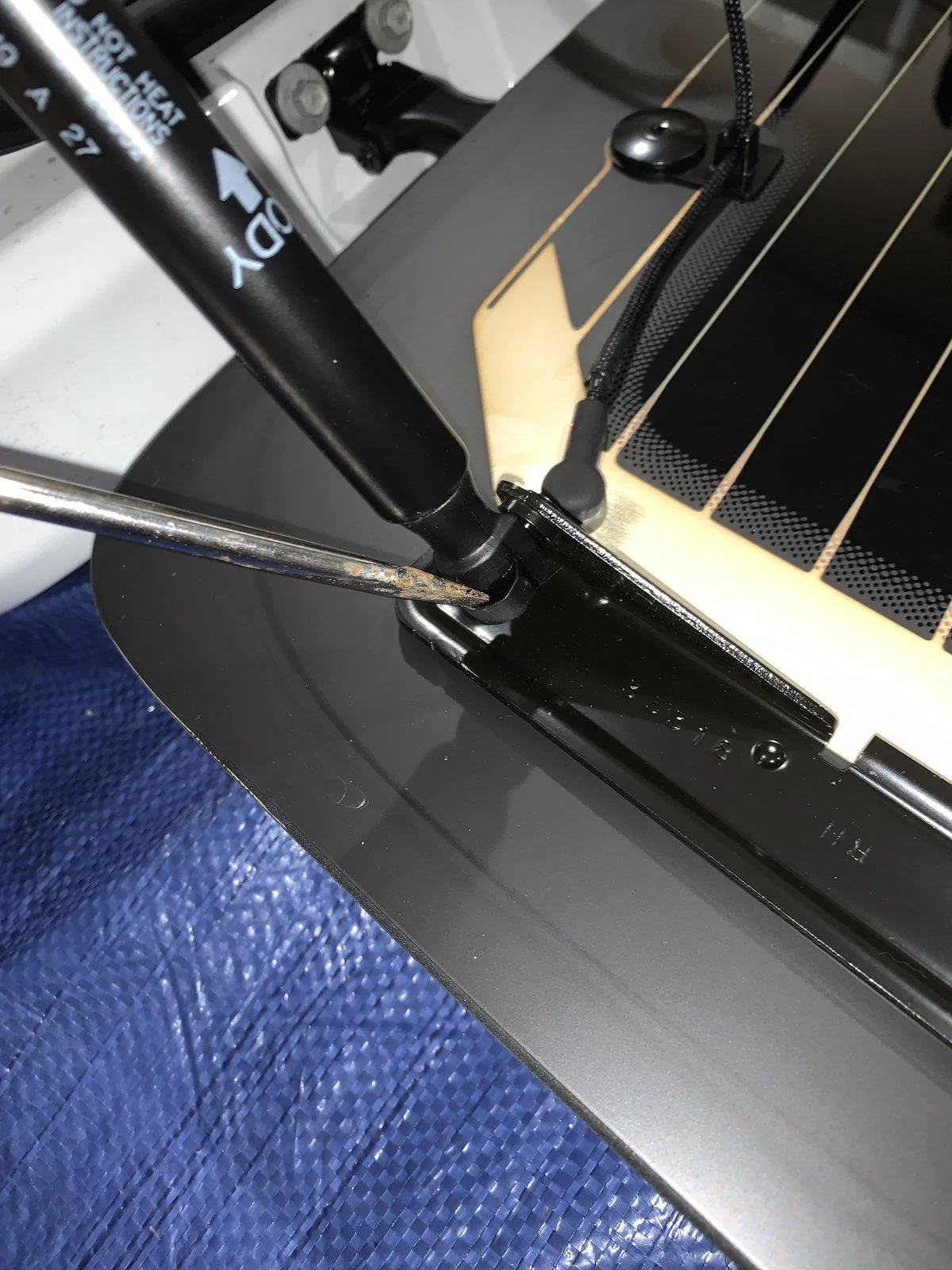

On the hard top, i removed the glass-struts, hardware and taped. For the struts, use a flat-head to pry the c-clamp out, compress and pull off:
Jeep Wrangler JL JL's JLs Builds IMG_1146
Jeep Wrangler JL JL's JLs Builds IMG_0643
Jeep Wrangler JL JL's JLs Builds IMG_2703
I used 4-6 cans of Plasti-Dip per coat. I did 2 LIBERAL coats, so each coat costed $25-$40, depending on how much you use.
Mid-coat:

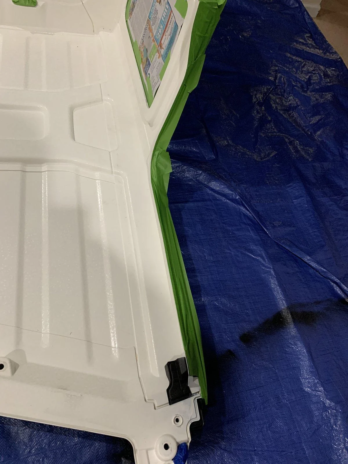

Done - side by side:
Jeep Wrangler JL JL's JLs Builds IMG_9430

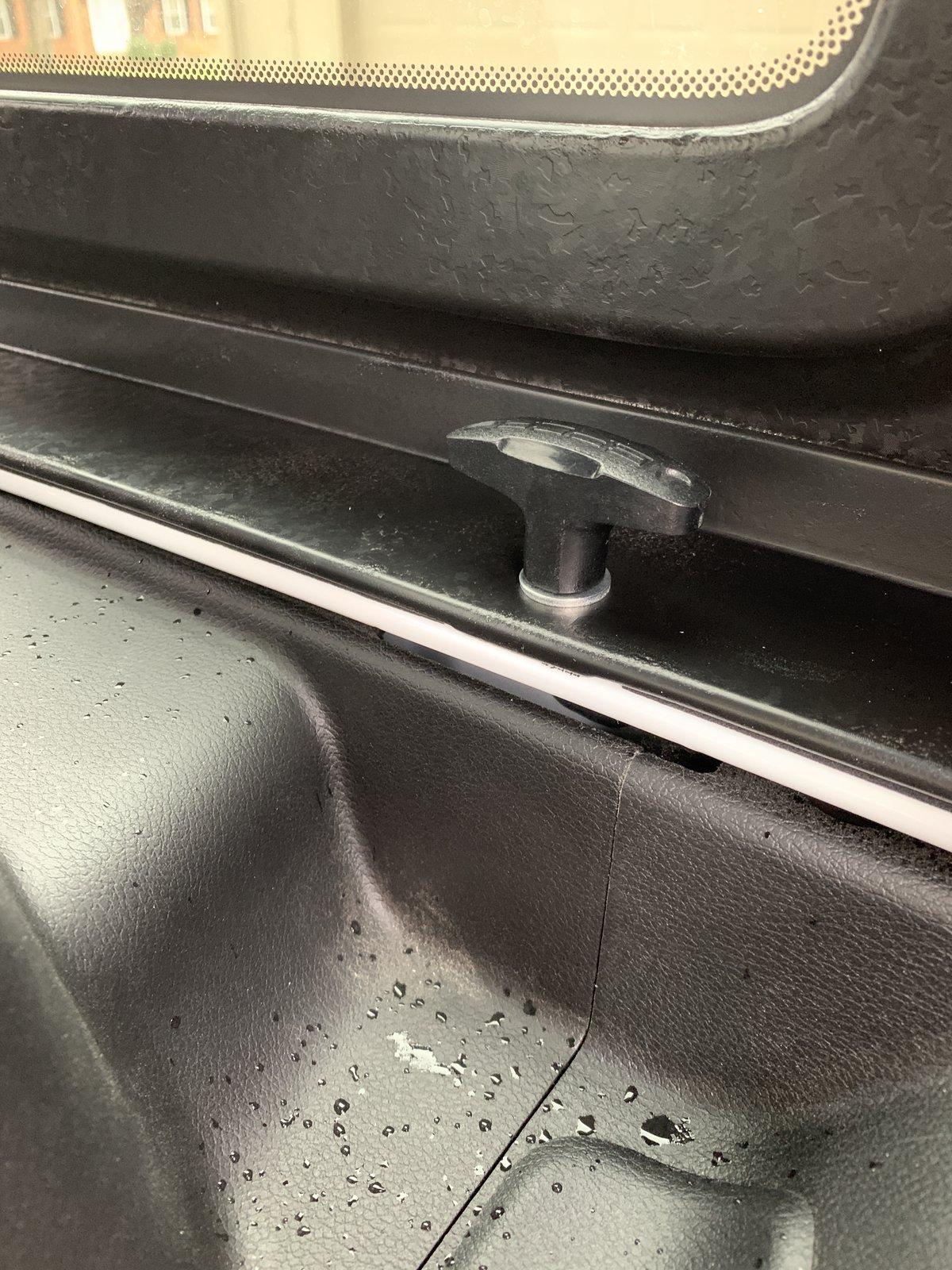

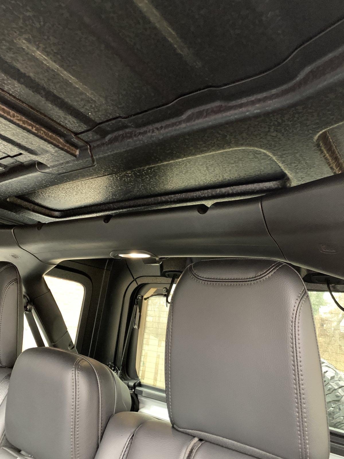

Love how it turned out. When you re-install, there MAY be some plastic "creaking", but my wife's didnt have it.
We also re-mounted the top with T-handles - https://www.amazon.com/gp/product/B07BFH6119/ref=ppx_yo_dt_b_asin_title_o09_s00?ie=UTF8&psc=1
We like these - nice and big and have optional tie-down hardware. The end result looks great and can touch-up very easy:

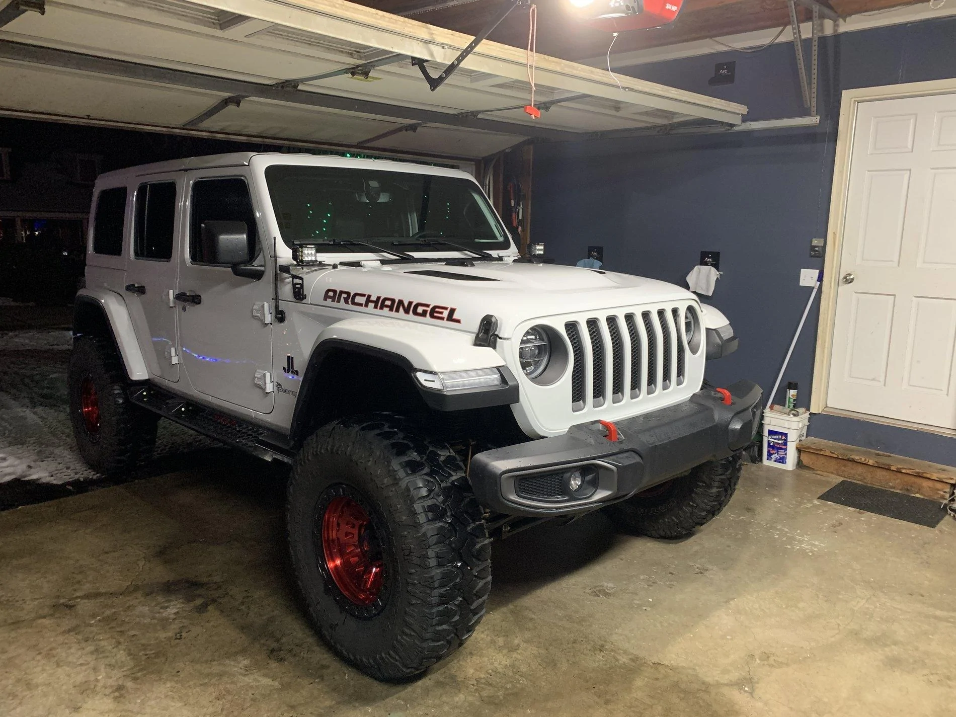

Similar to the wife's Archangel, i did all the same mods on mine. We did get a few different things: i got a manual and different seat covers. I do love these seat covers (code CBS), but they came at an unknown cost.

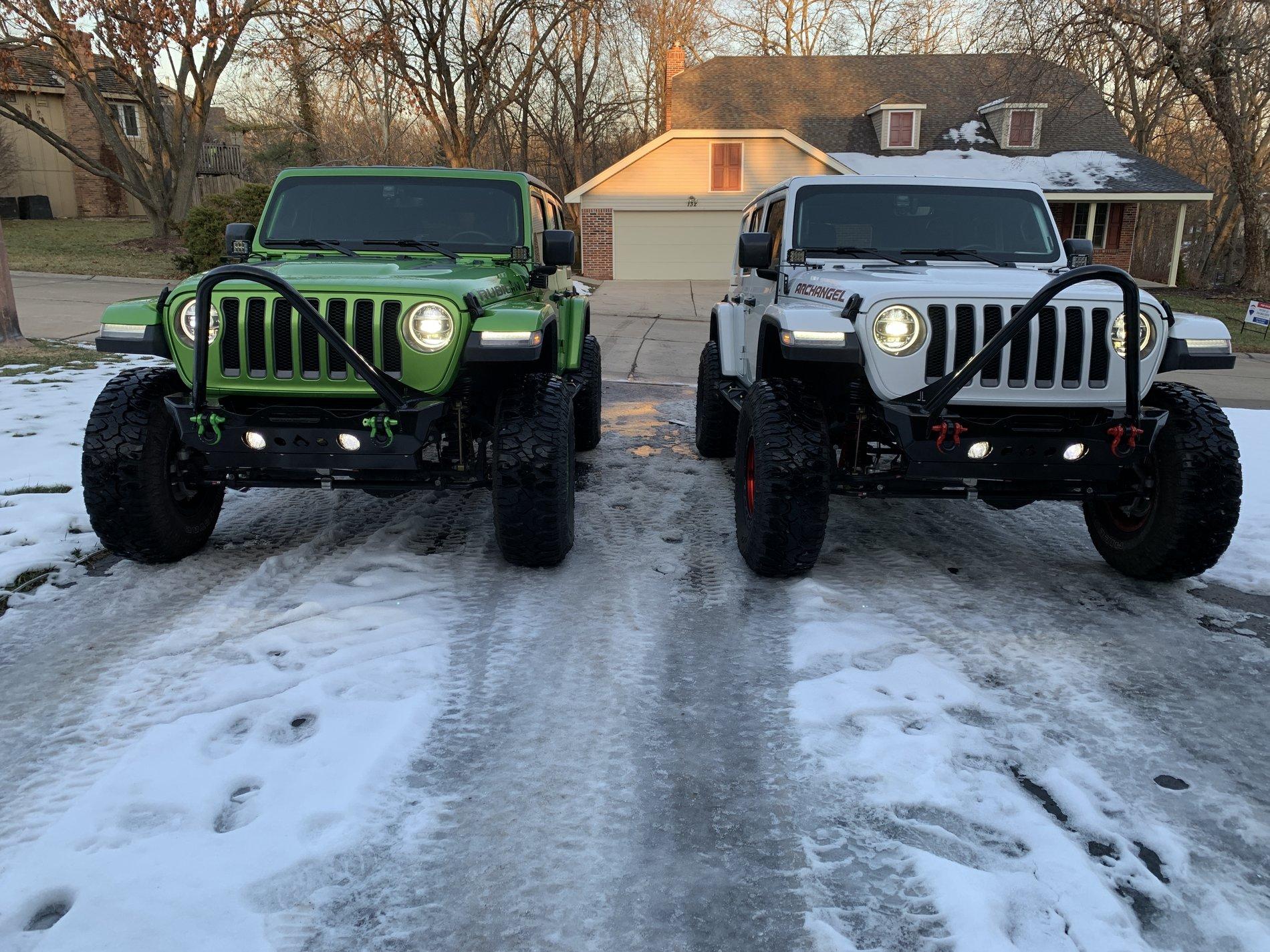

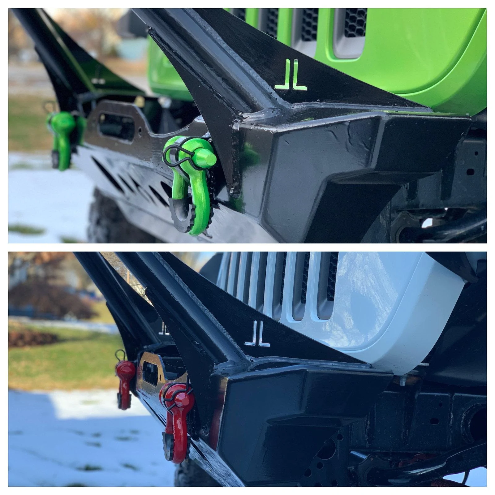

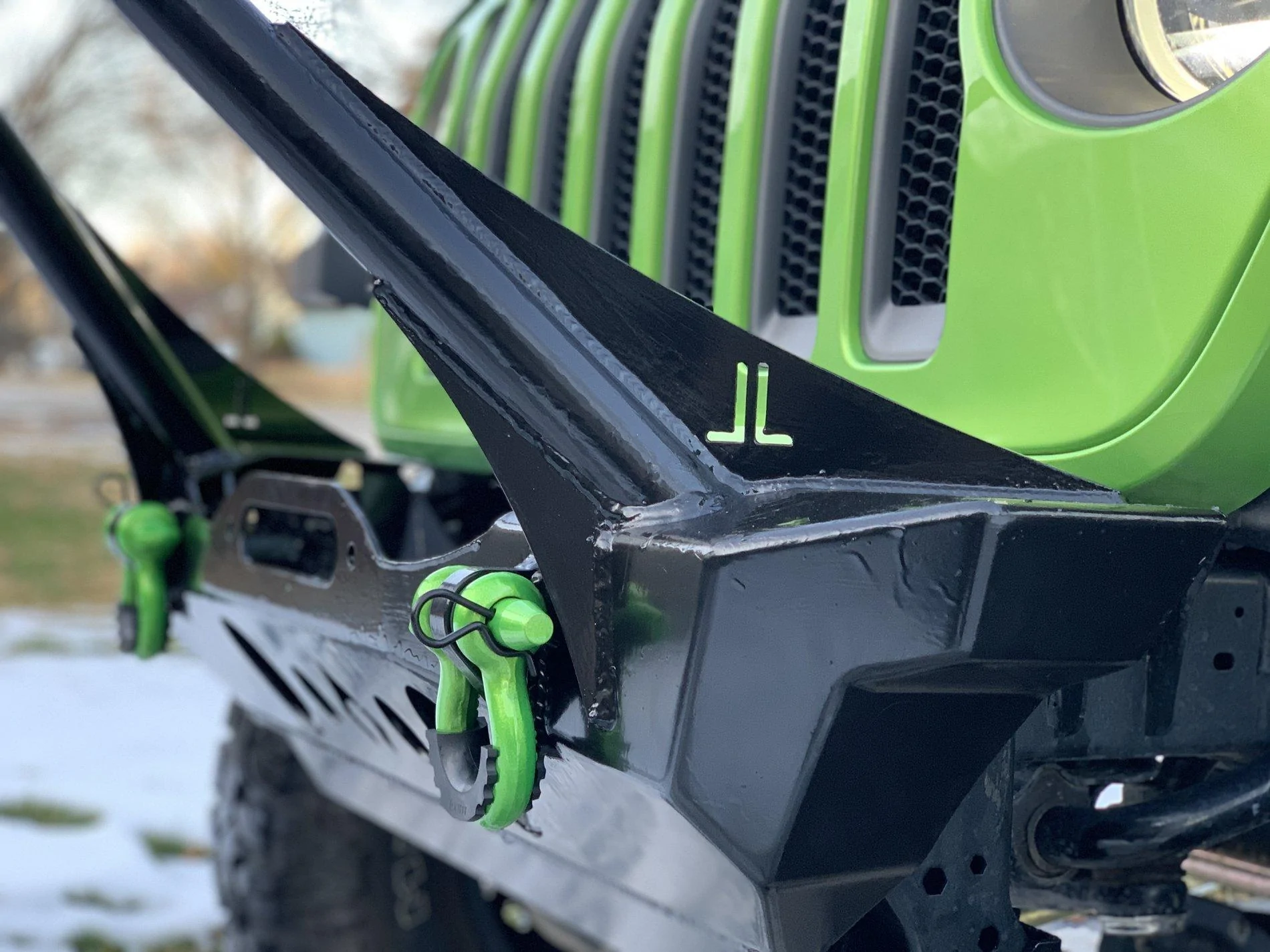

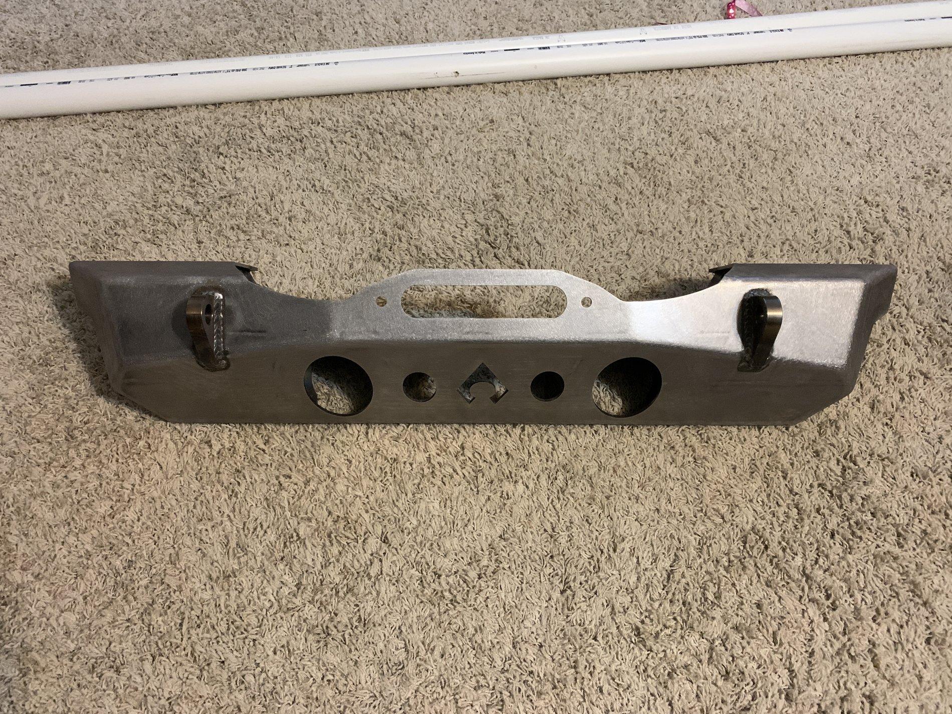

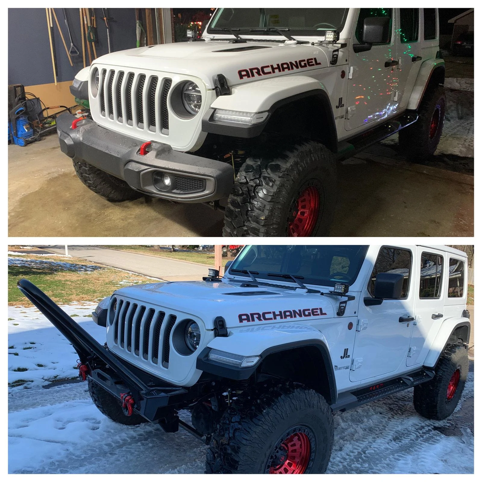

The day has come - FRONT BUMPERS! A little "amuse bouche" for XMAS :) We both are "of stinger people" and had a few requirements, so here's what we decided on: Artec Nighthawk (no stinger) with custom stinger. We wanted: tabs for d-rings, factory fogs, stubby and a recessed winch.
https://www.artecindustries.com/JL_NightHawk_Bumper_Front

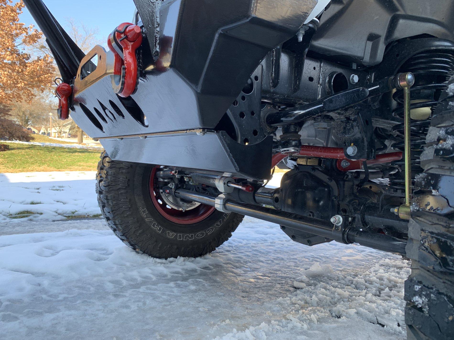

We also ordered the sway disco skid:
https://www.artecindustries.com/JL_NightHawk_Swaybar_Skid
Unbox:
Jeep Wrangler JL JL's JLs Builds IMG_5235

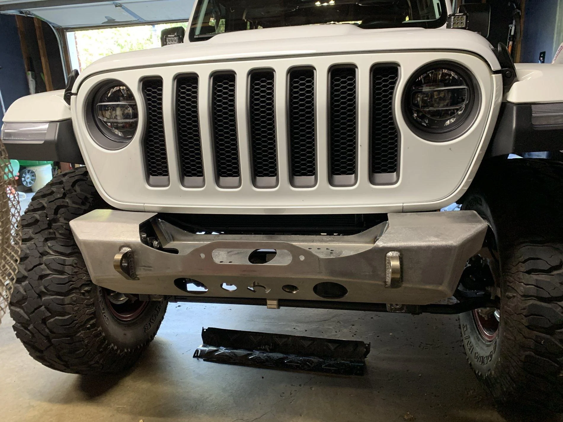

A little test fit:
Jeep Wrangler JL JL's JLs Builds IMG_5237

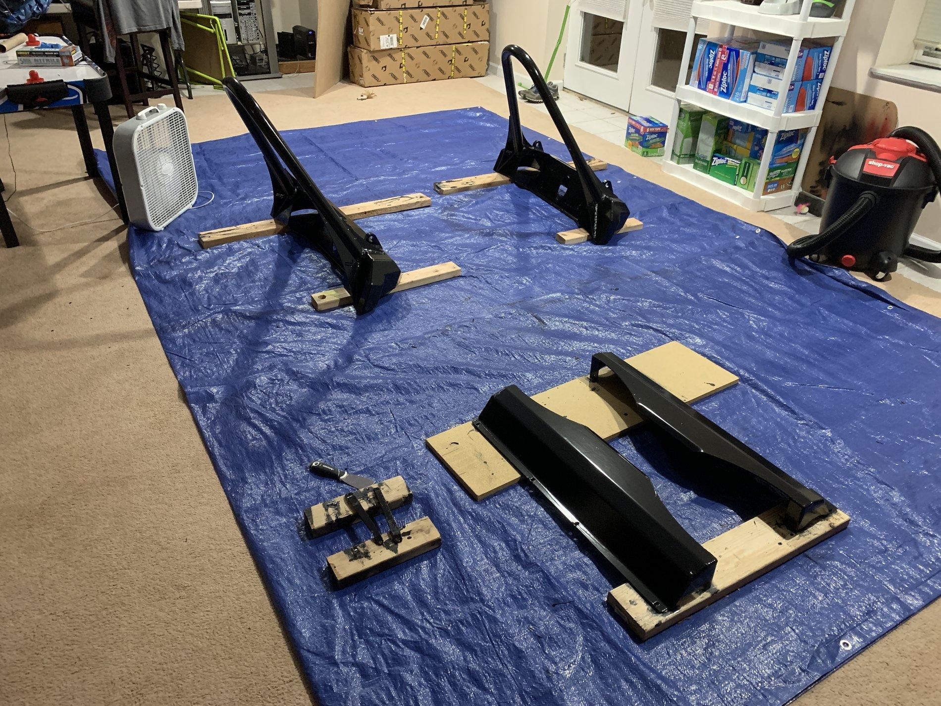

We like the older stinger, so bought some 2" .120 DOM and had it bent and welded. We also asked for support gussets....added a small touch of "JL" to it, since it's our initials ;) LOVE how it turned out :rock:

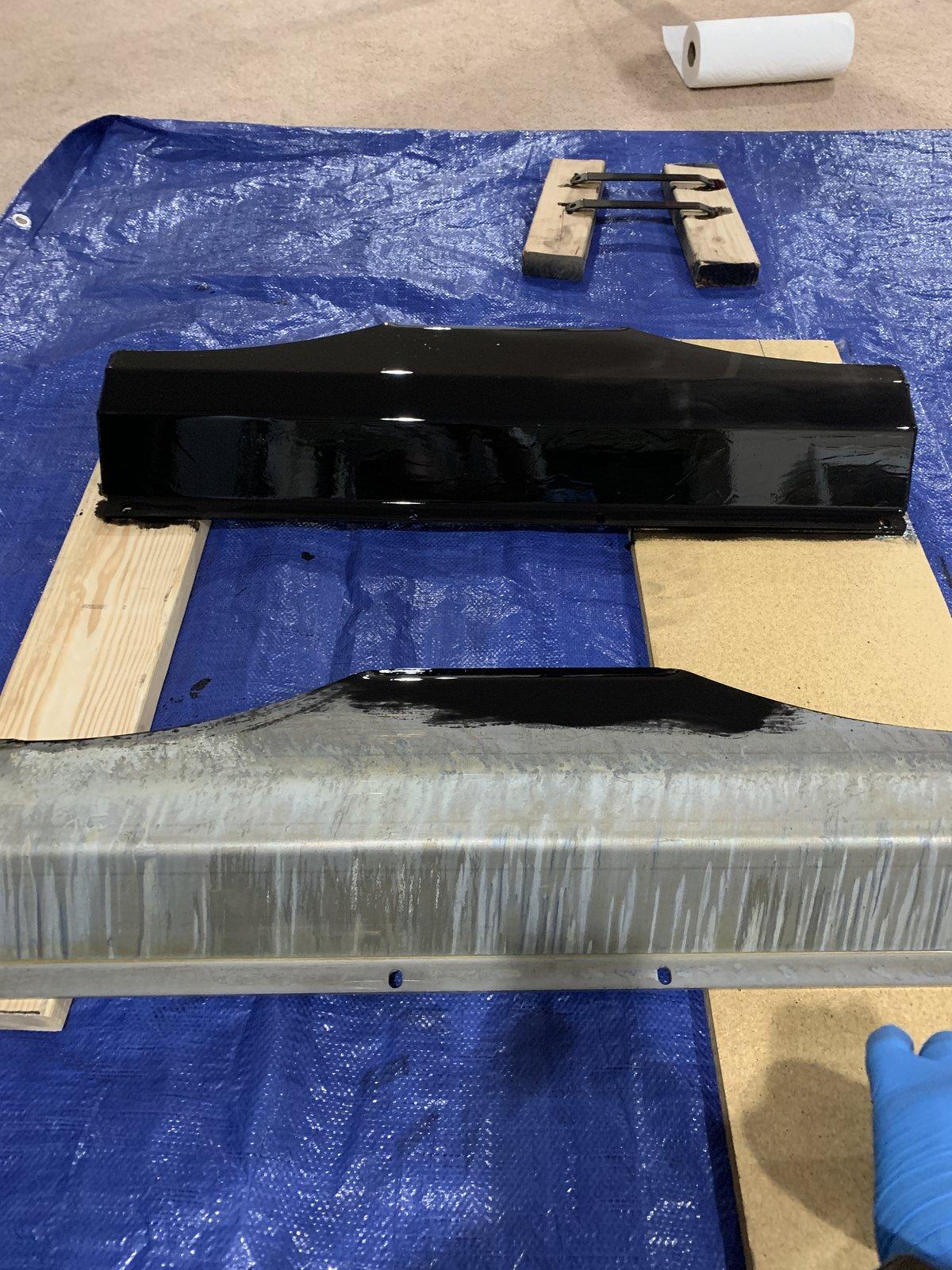

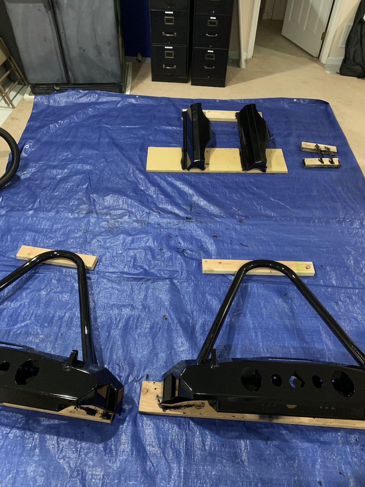

I painted these with the same stuff that i did the underneath and side rails - POR15. Prep process was to hose/remove debris from welding place, degrease and use a metal-prep product.
For painting, i used the same paint process: 2 base coats and 1 top coat. The first 2 coats went on smooth.....the 3rd, not so much. You can see drips and it's not perfectly, smooth, but we dont care. We plan to use and bash.
INSTALL TIME!
Removing the old bumper is not that bad. Disconnect the fog harness on the passenger side, take out the 2 push-tabs on the top of the bumper (next to the grille) and remove the 8 bolts from the back. They are 3/4. I used a deep socket and a 3" extension. Was pretty easy. We were able to move our factory fogs over to the new bumpers, which was nice. Apparently only the plastic bumper fogs will transfer at this time. Removing the fogs was easy, BUT NOT FUN! For those of you who are wanting to replace/swap fogs, here you go:
With bumper removed, pull all the push-tabs out:

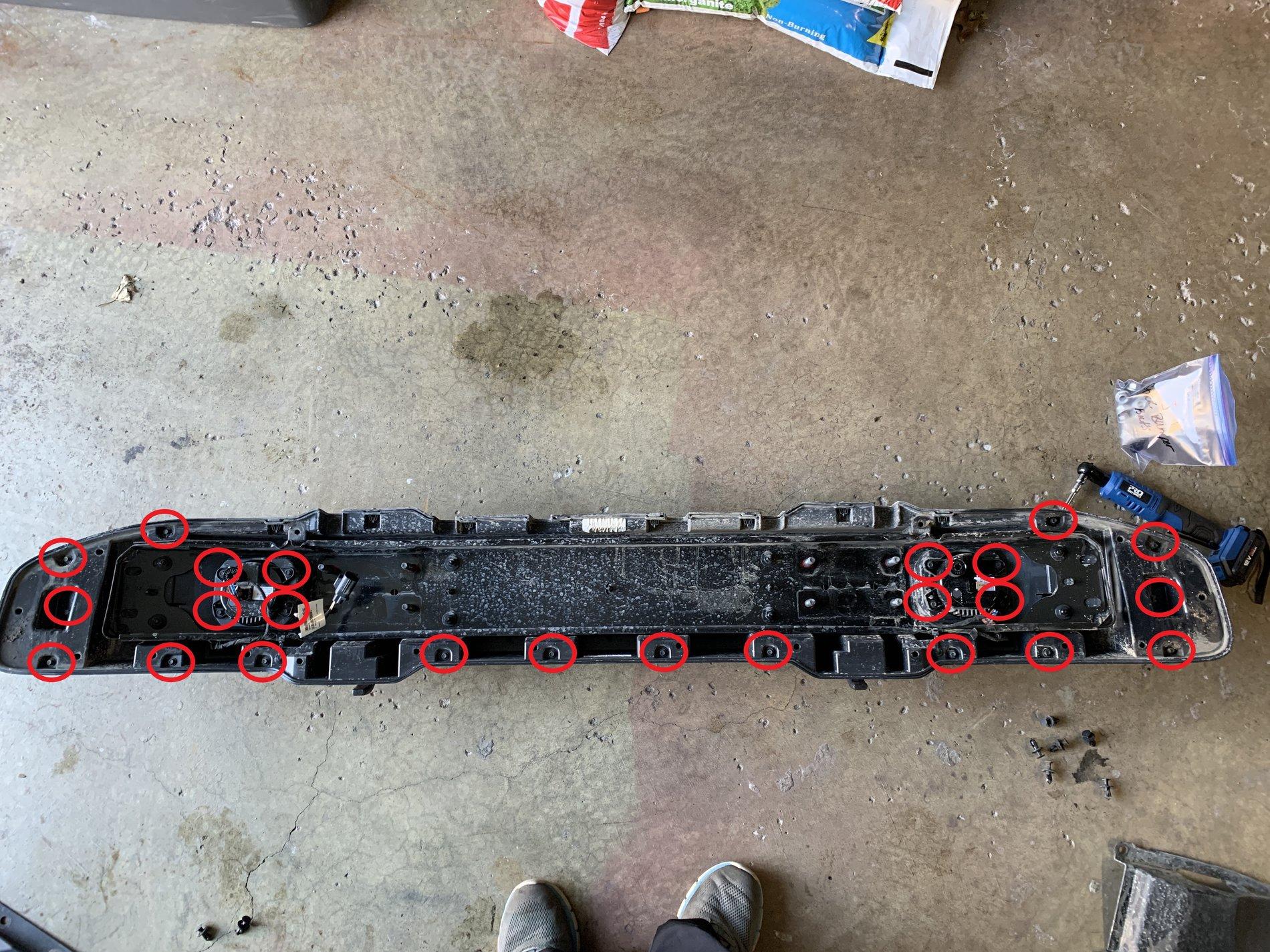

After removing all the push-tabs above, remove the two inside end panels and the center section. This will expose a bunch of 7mm bolts. Have fun - i would suggest an electric ratchet. Removing all of the bolts will allow you to remove each foglight and the inner shell, so that the plastic and metal can be separated, to them be able to remove the fog wires.

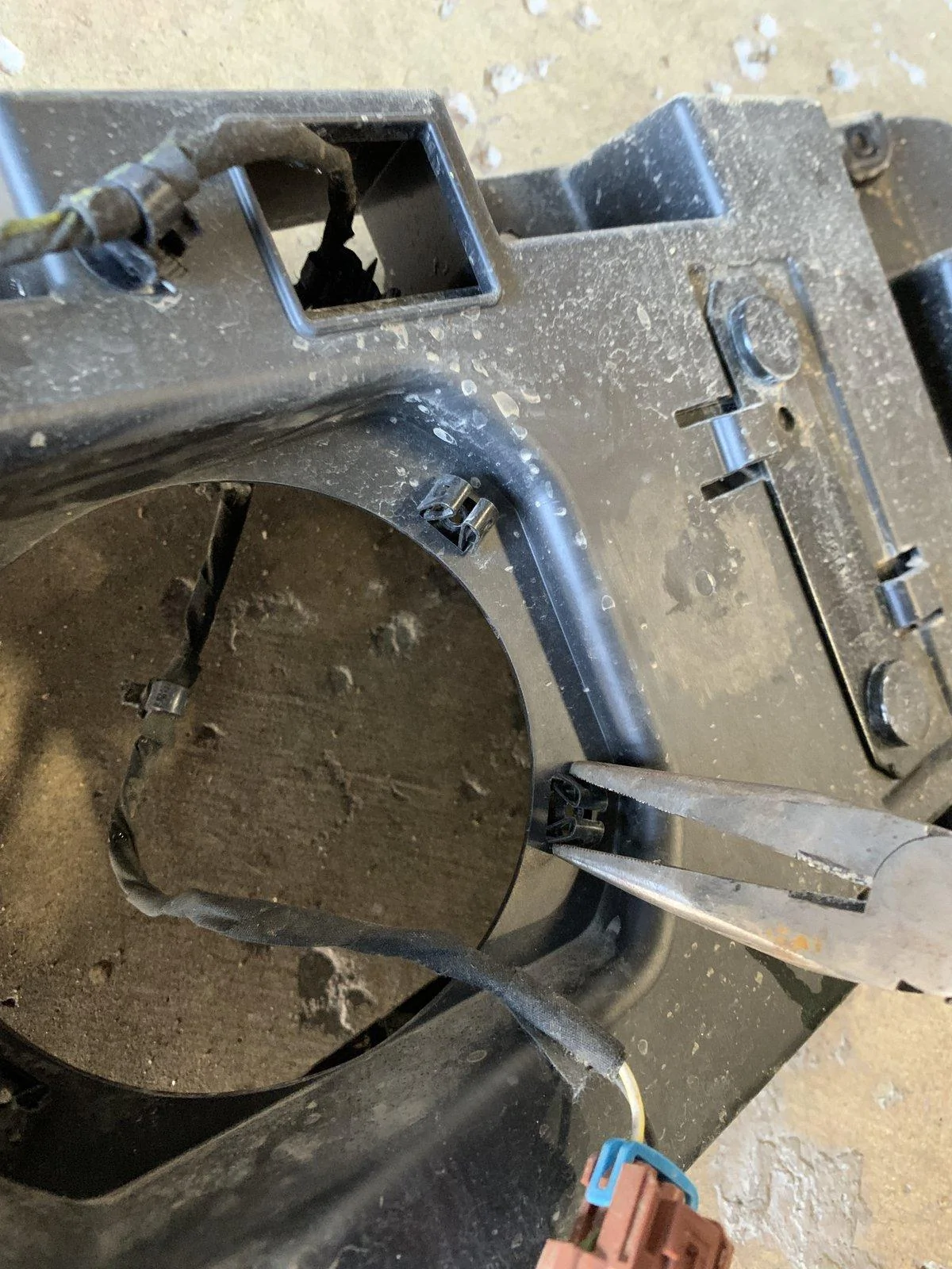

Remove the tabs (used a trim tool) and this will allow you to remove the wire:
If transplanting the fogs, remove the light mounting hardware by using a needle-nose to pinch and remove:
Jeep Wrangler JL JL's JLs Builds IMG_4066

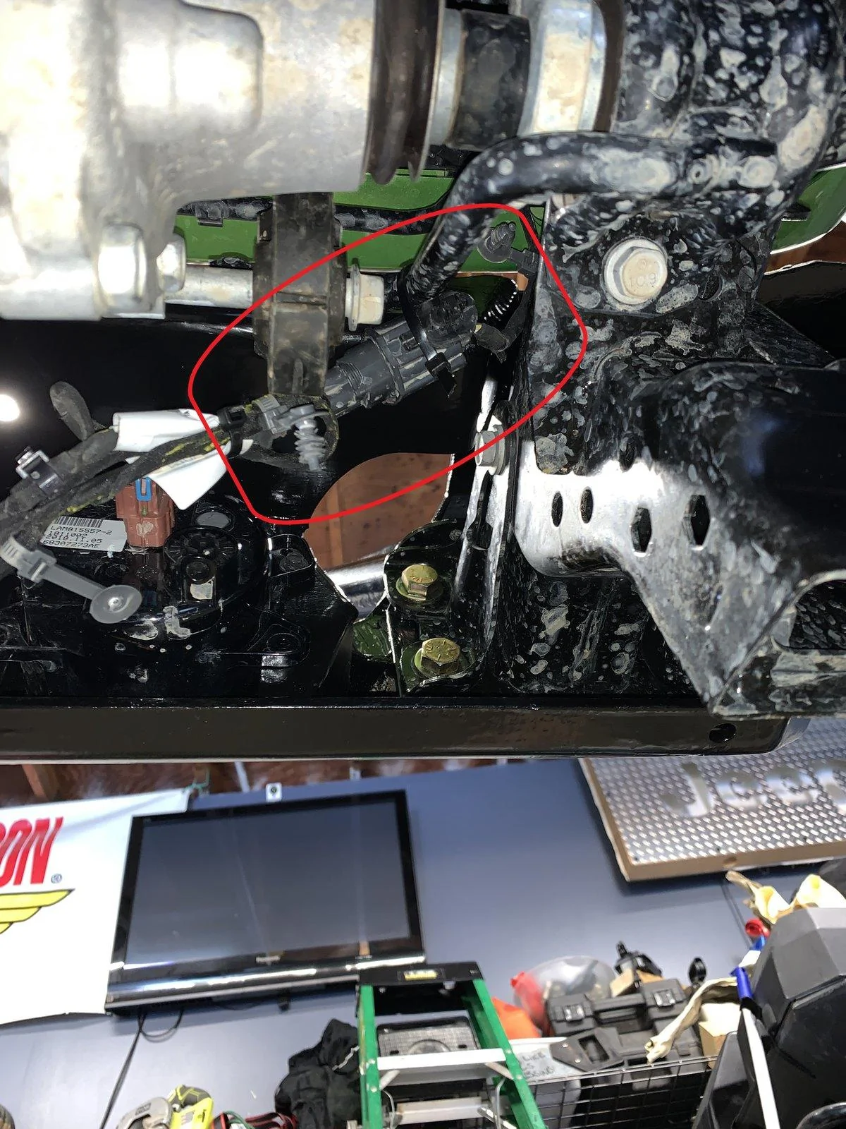

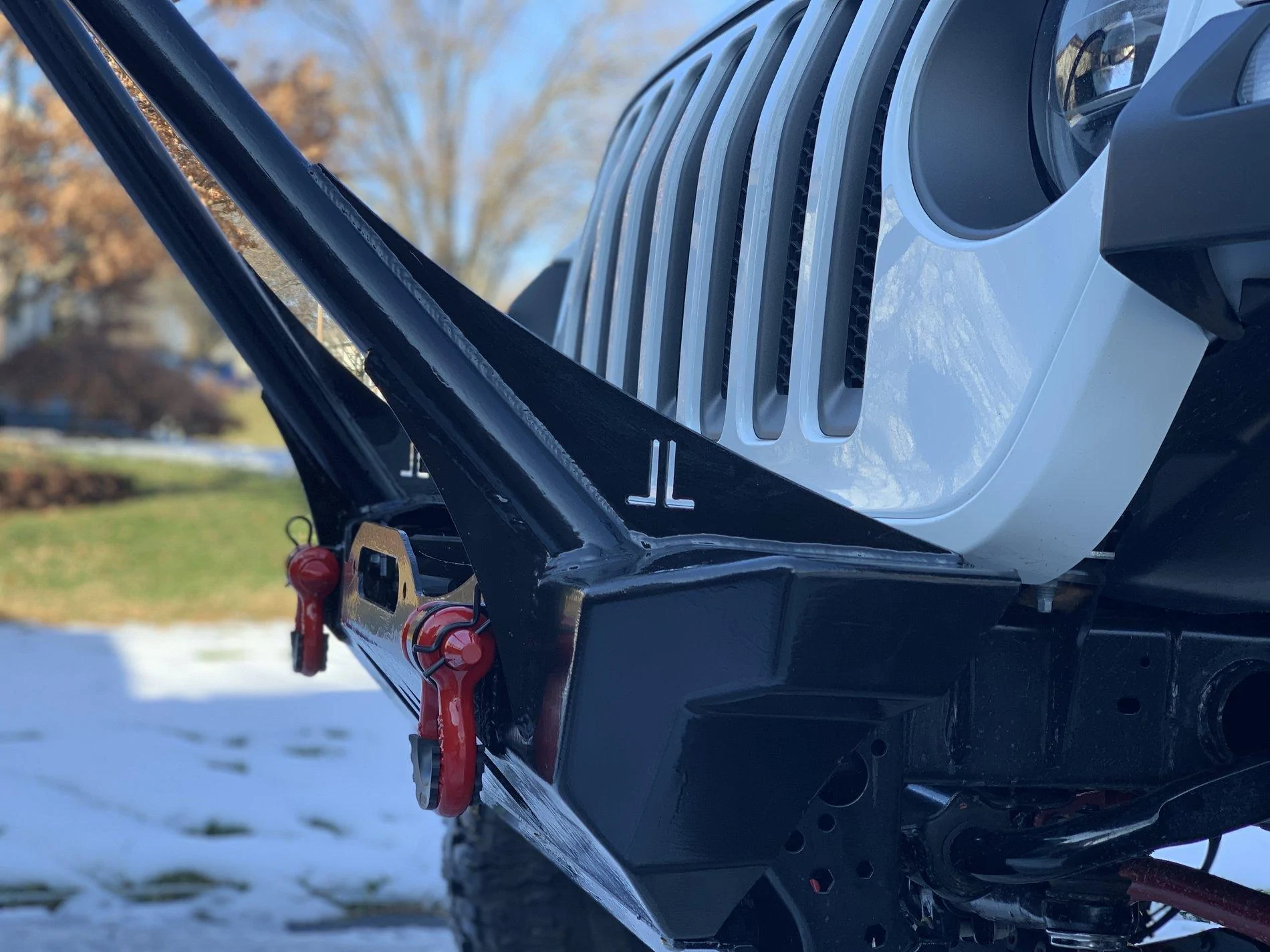

Install the new bumpers. For anyone replacing a factory bumper, consider moving the factory foglight connector. Remove the 2 tabs holding the connector. This allowed me to drop it down the other side of the front bumper mount:
Showing fog connector with zipties:
Jeep Wrangler JL JL's JLs Builds IMG_8094
Some before pics:
Jeep Wrangler JL JL's JLs Builds IMG_6466

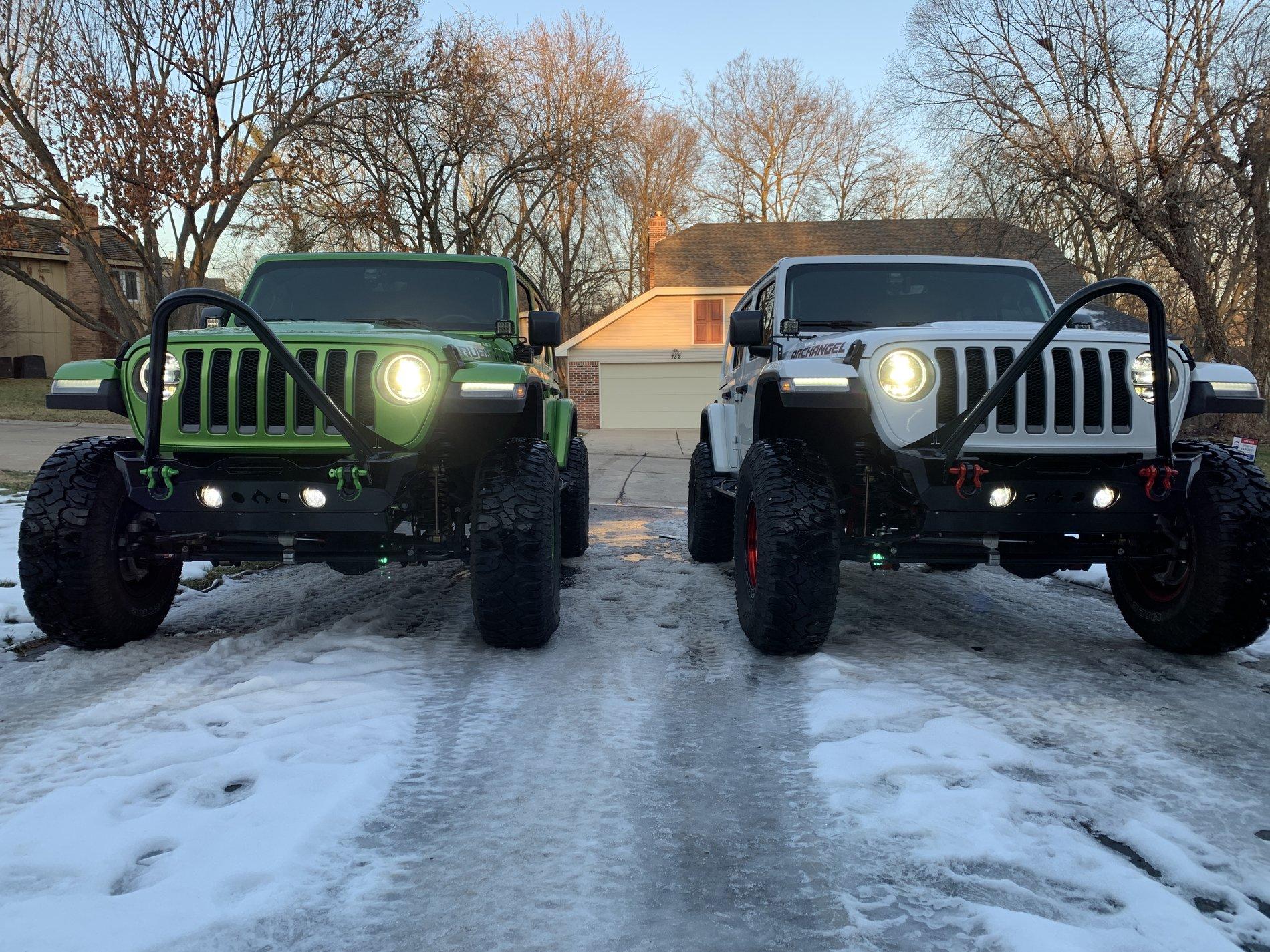

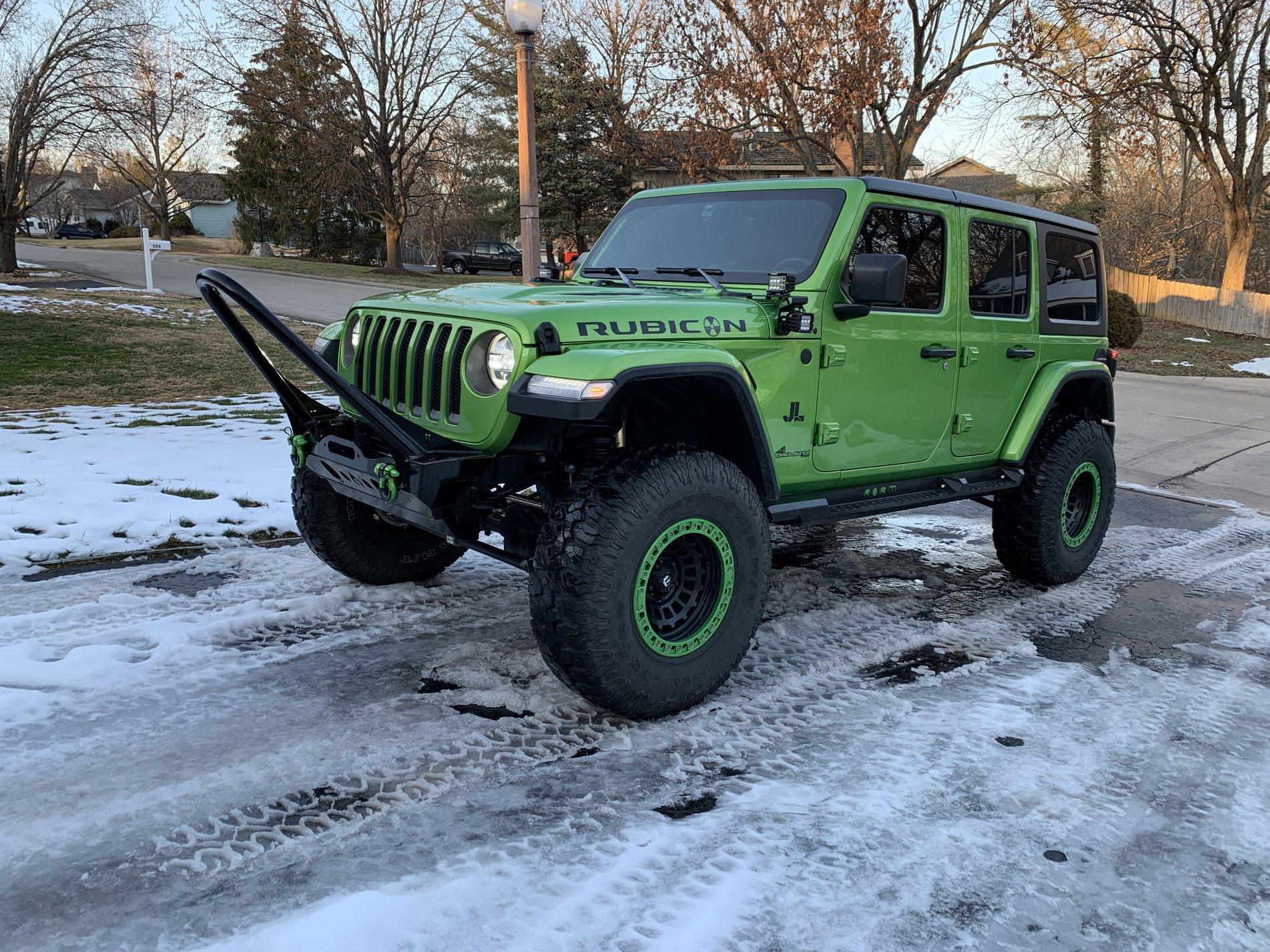

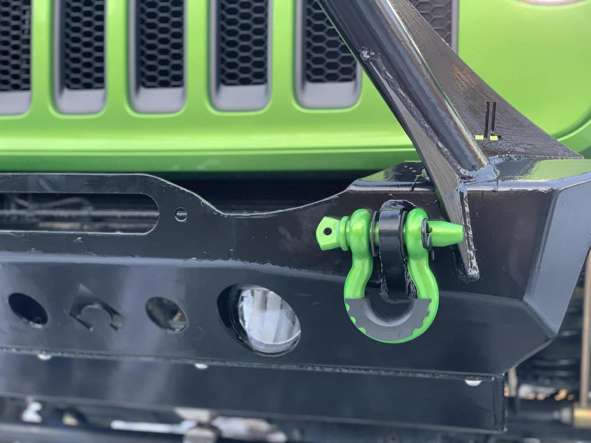

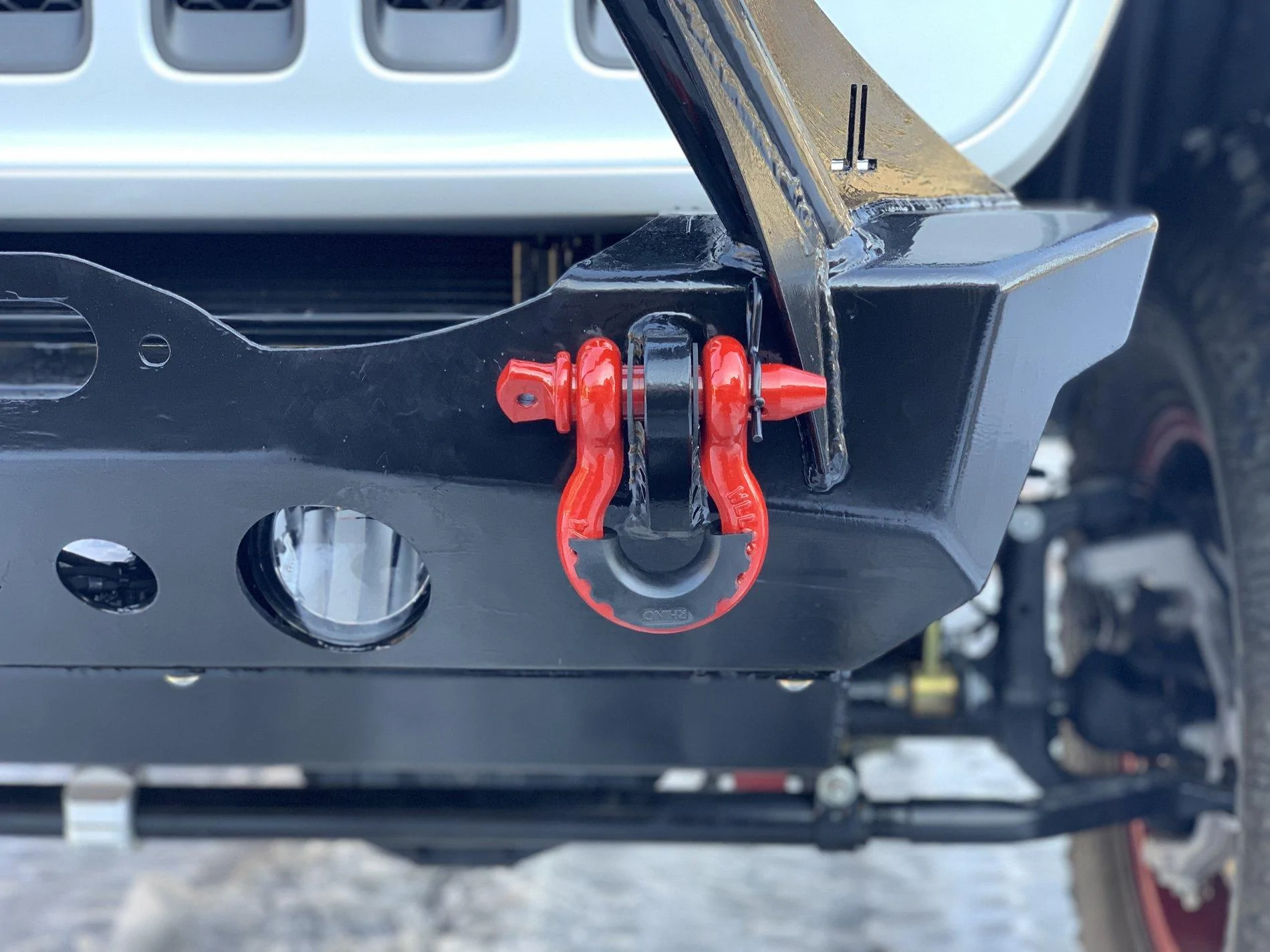

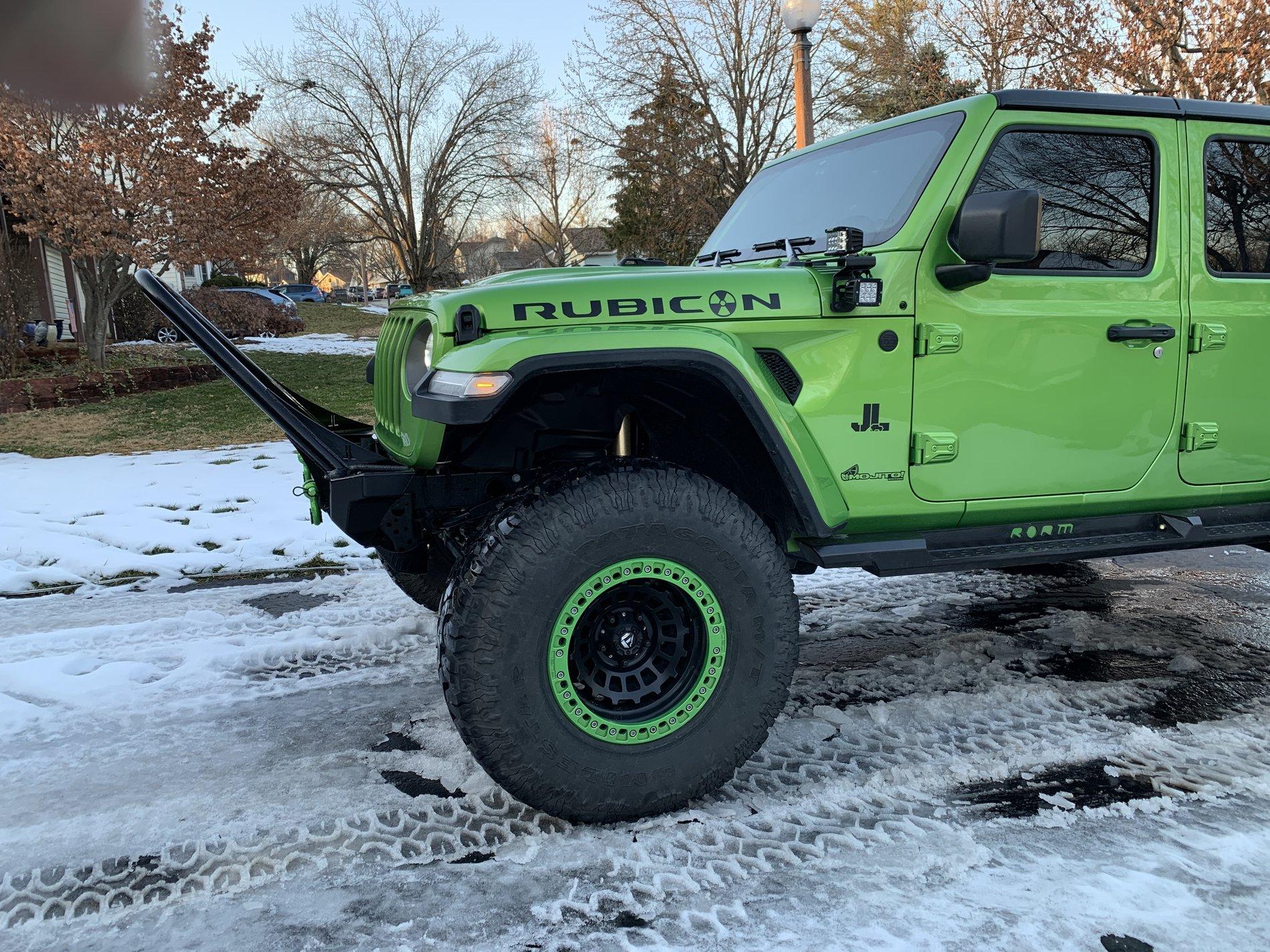

AFTER! We added Smittybuilt D-Rings, powdercoated and isolators:
D-Rings - https://www.amazon.com/gp/product/B00AQFEBSG/ref=ppx_yo_dt_b_search_asin_title?ie=UTF8&psc=1
Isolators - https://www.amazon.com/dp/B07DGH7QJH?ref=ppx_pop_mob_ap_share
Jeep Wrangler JL JL's JLs Builds IMG_5383
Jeep Wrangler JL JL's JLs Builds IMG_5389
Jeep Wrangler JL JL's JLs Builds IMG_5403
Jeep Wrangler JL JL's JLs Builds IMG_5404
Jeep Wrangler JL JL's JLs Builds IMG_5409
Jeep Wrangler JL JL's JLs Builds IMG_5411

Looking amazing! Congrats and keep on enjoying the journey.... now let’s see them on the trail. Those builds look ready and asking for it!
Thanks! We were just talking last night, how we need to get some trail time. New driveshafts going on tonight and tomorrow, then we’ll look for an outing soon. Appreciate the feedback! :fist bump:
