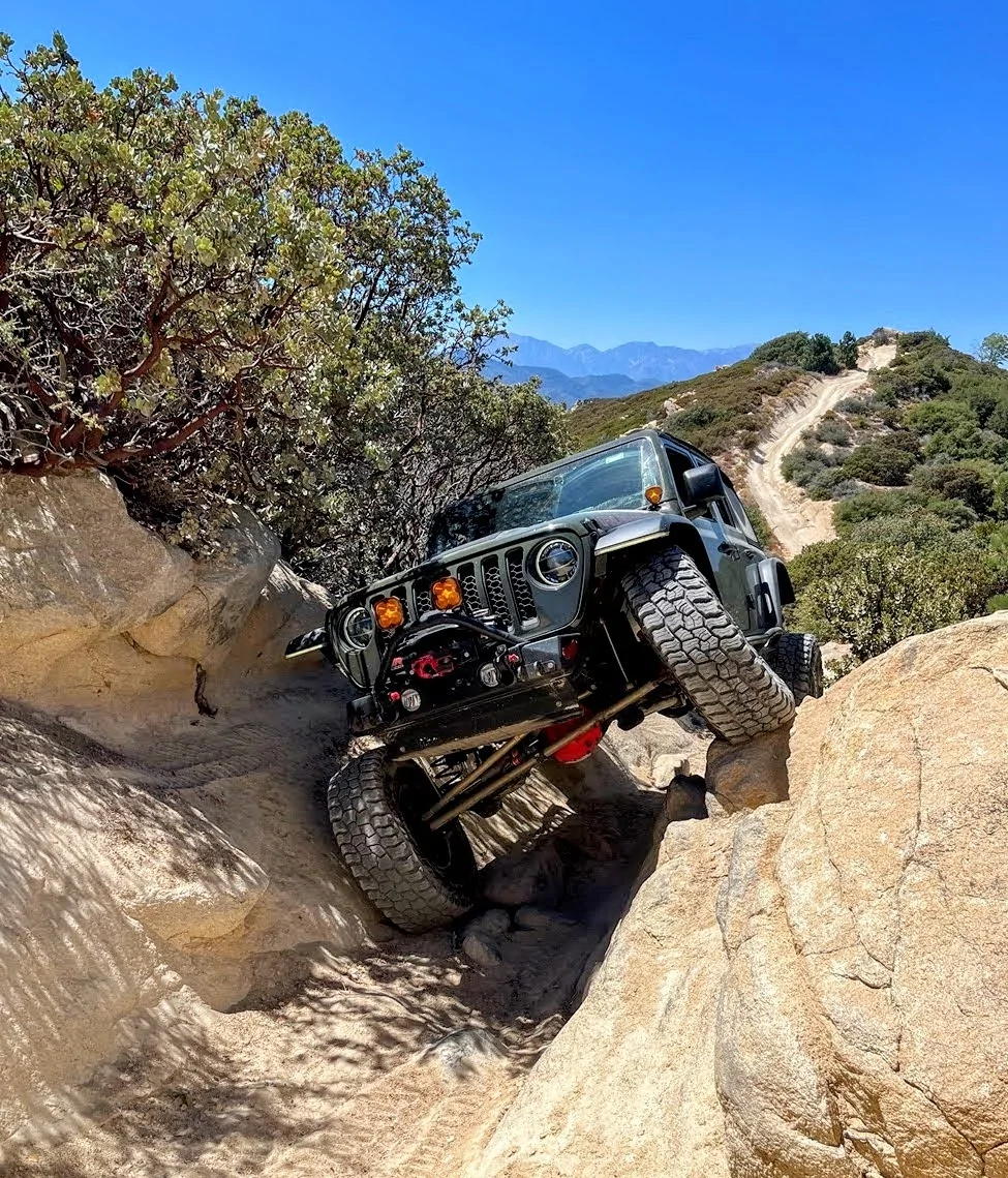

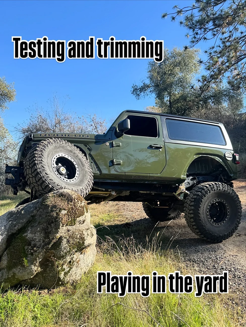

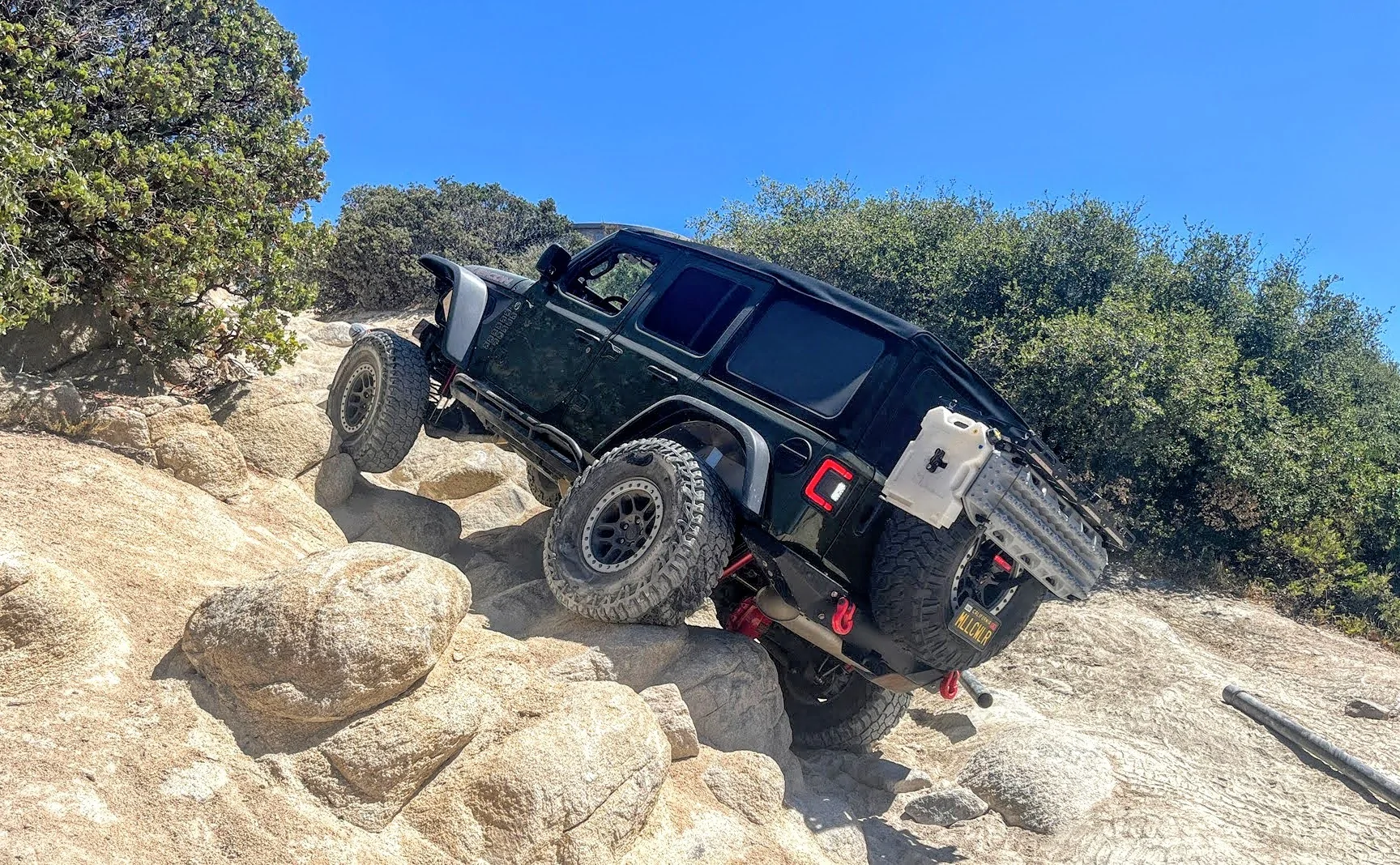

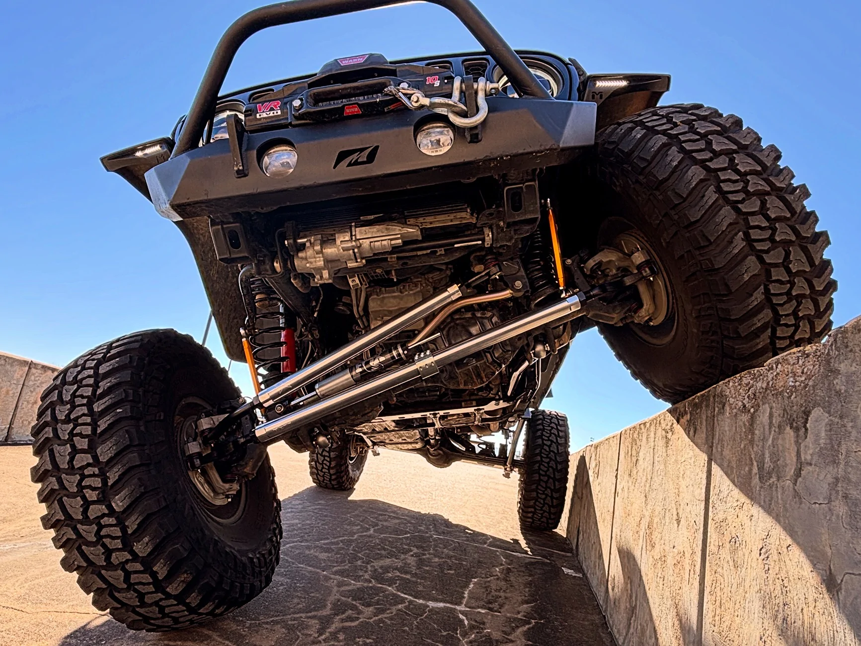

I have the Metalcloack lock-n-load with the rear long-arms.
If I had to do it again, I'd go with the 4-link long arms. Articulation is just as good and you don't have to mess with tightening and loosening the radius-arm lock-n-load shock every time.
Also, don't go with the DB3 drop brackets. They catch on everything. Just bite the bullet and do the long arms.
Overall very happy with the performance - articulation is definitely not my limiting factor these days.

The low hanging rear brackets on the MC long arm are what got me looking for a design that had more clearance. I saw an Evo long arm that had the brackets along the side of the frame. But it was a weld-on kit. I ended up ordering the Artec bolt-on, but the tech said it should be welded as well.

Yup - valid concern. Long arm brackets don't hang as low as the DB3 but still stick out. Easier to manage since it's closer to the center of the Jeep and as long as you can get the obstacle on the lower control arm you can slide along that.

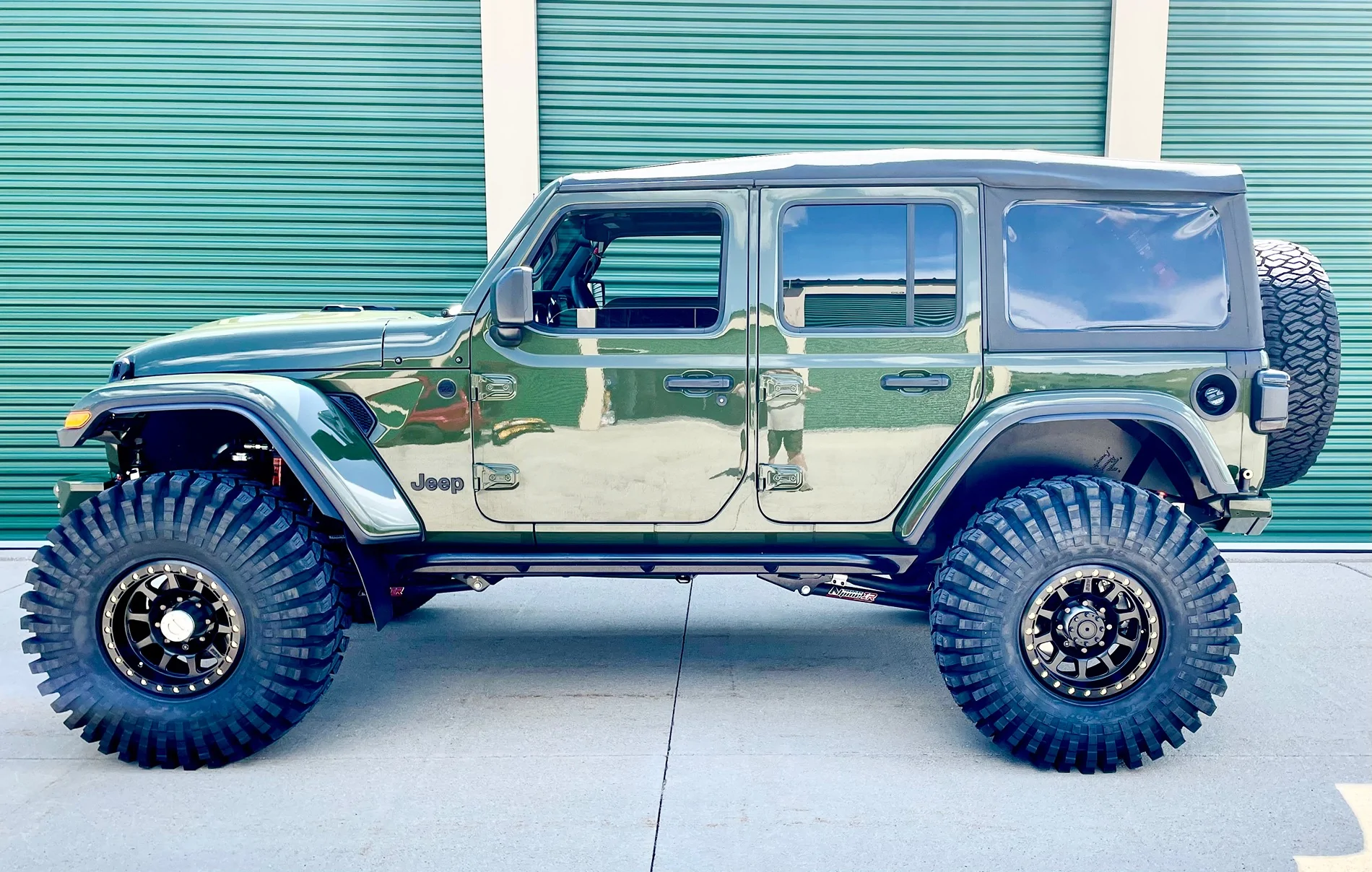

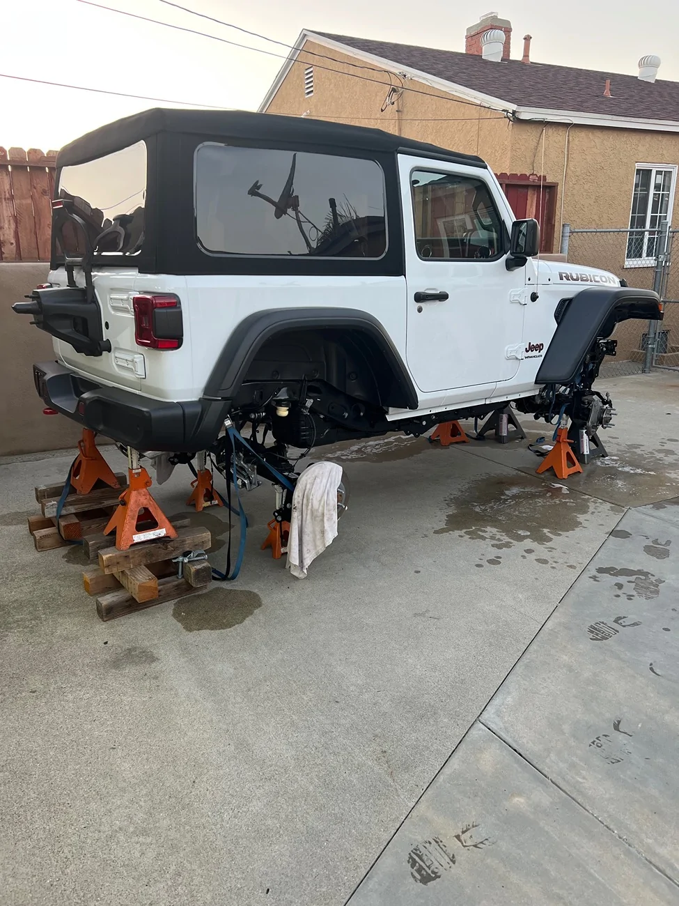

I’m running the Rock Krawler X Factor X2 long arm kit with my MetalCloak springs and track bars. Love the high clearance bent control arms. I’d much rather miss the hang up altogether than slid on low hanging arms and brackets.

Such a cool picture! Nothing is better than the look of shiny new parts!
