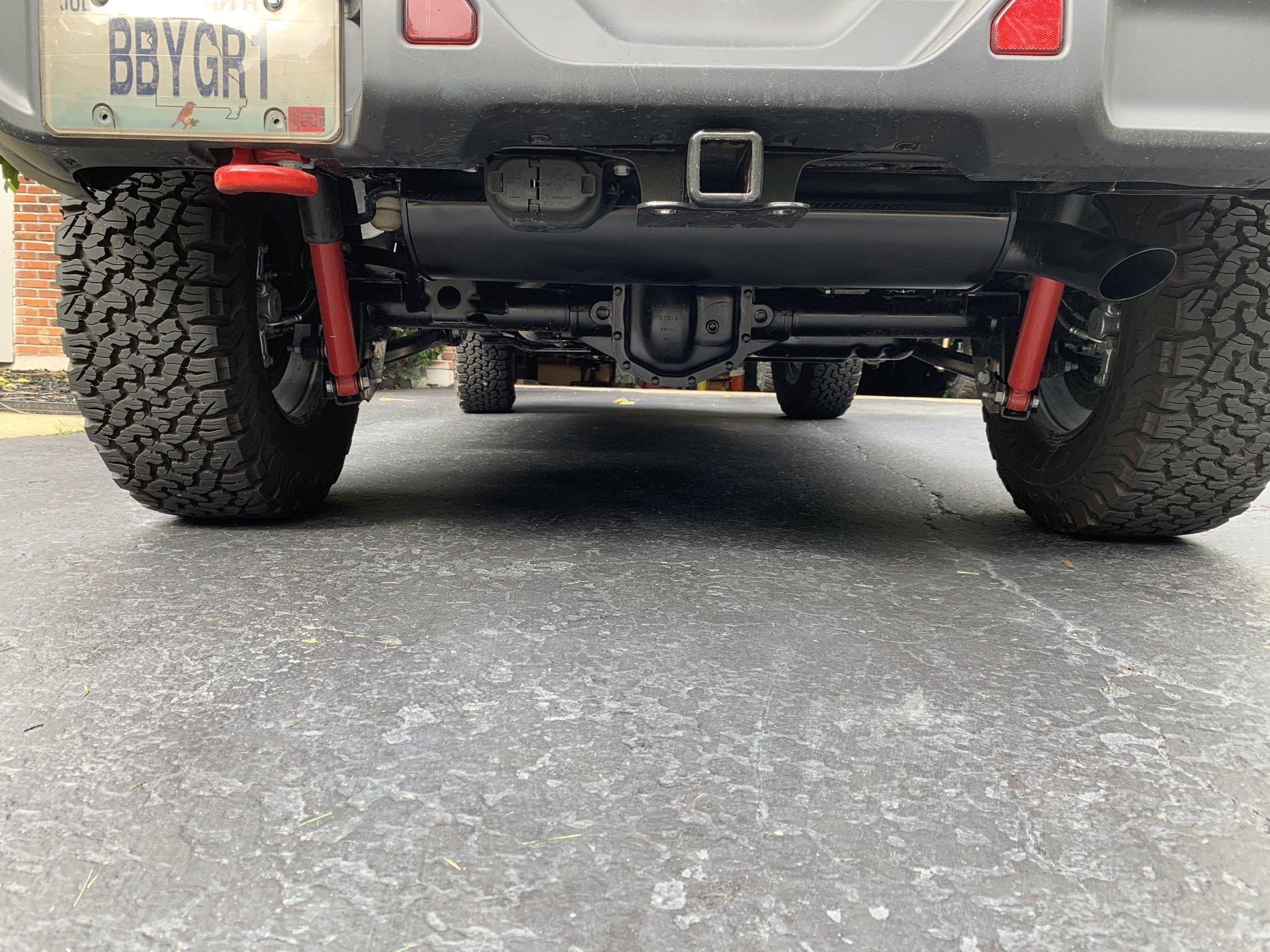

OK Folks - ANOTHER good weekend! Lifted @BbyGrlJJ's Jeep, so that's 2 lifts under my belt - which is awesome, but i feel like i just climbed everest - LOL.
First - she wanted to paint the MC arms and track bars, so we did that. Here's some pics of how i did it.
Before:
Wiped the outside rims clean:
Used some fat Frog Tape:
Applied the tape in a plus sign pattern:
Pinched it in (like a nipple) :) to create some slack:
Push down the edges and used an exacto knife to trim around the outside (doesnt have to be perfect):
Used some blue paint tape to cover the exposed threads:
All prepped:
Used Rustoleum "Rebel Red", which dried nice - just like the factory Rubi red - https://www.homedepot.com/p/Rust-Ol...oss-Sunrise-Red-Spray-Paint-7762830/100167186
Forgot to take a pic of all dry, so here's a couple. I did get some wrinkling - not sure why. Thought i cleaned enough during prep. Oh well. It's all underneath and will get beat up. Easy to touch up though!
Parts on and lifted! :) :rock::like: I also did Steersmarts draglink, with RED Griffin, SS Tie Drod & Nexus 2.2. If you catch my "forgetfulness", i forgot to do the endlinks. Will do all when we get it back from alignment.
The Archangel cam out real nice! BOTH are looking great, in our opinion :) :rock:
Also - i "think" her's might sit a 1/2" higher....i assume it's due to less engine weight? 2.0 vs 3.6. HERS IS BIGGER! :punch::involve:

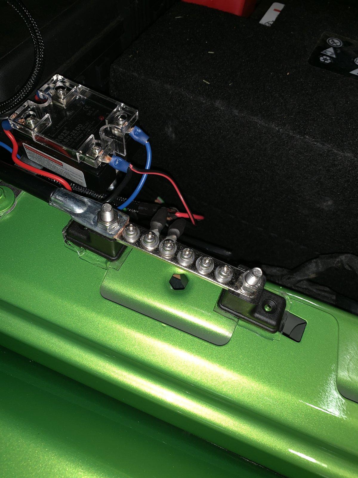

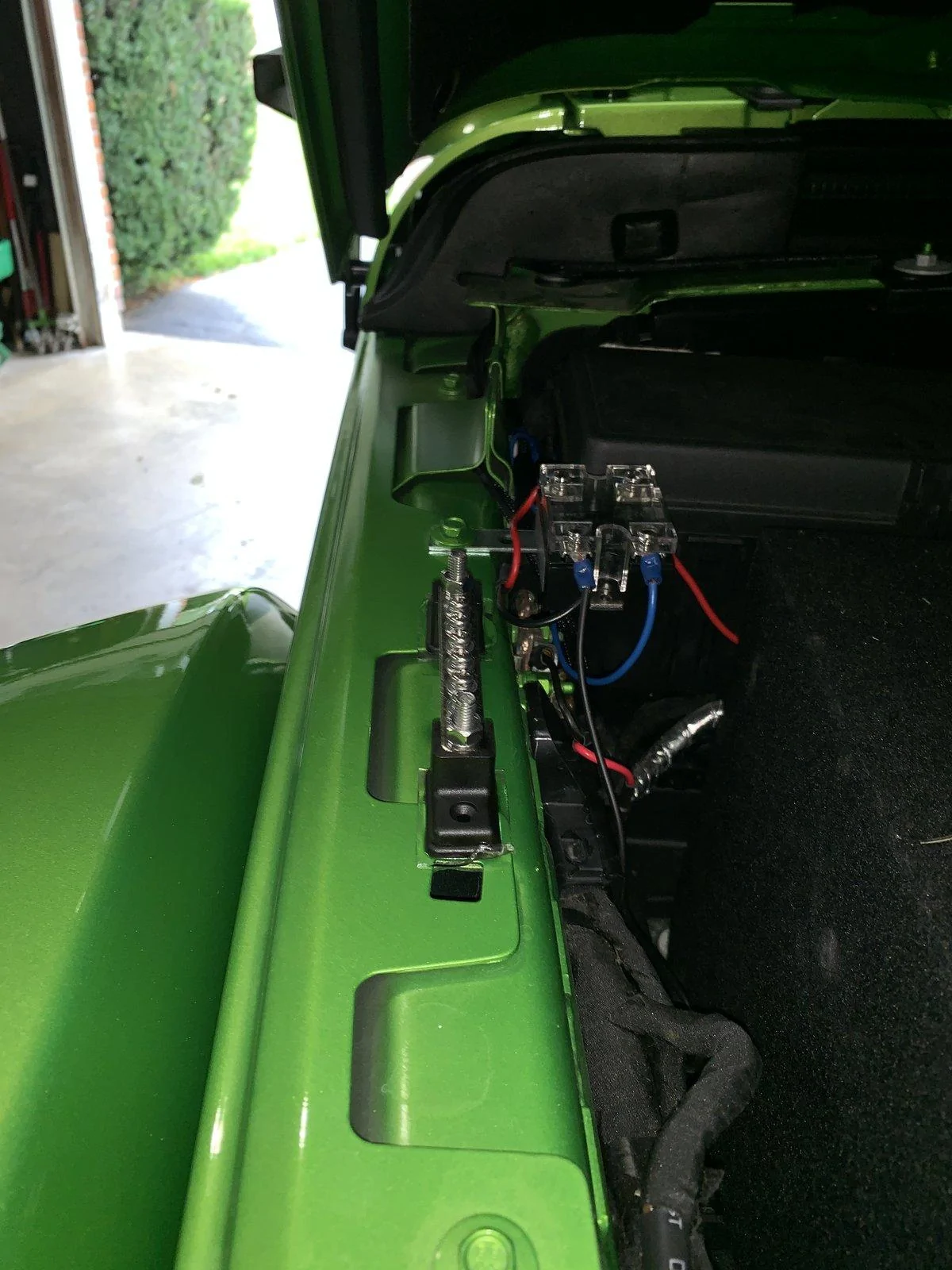

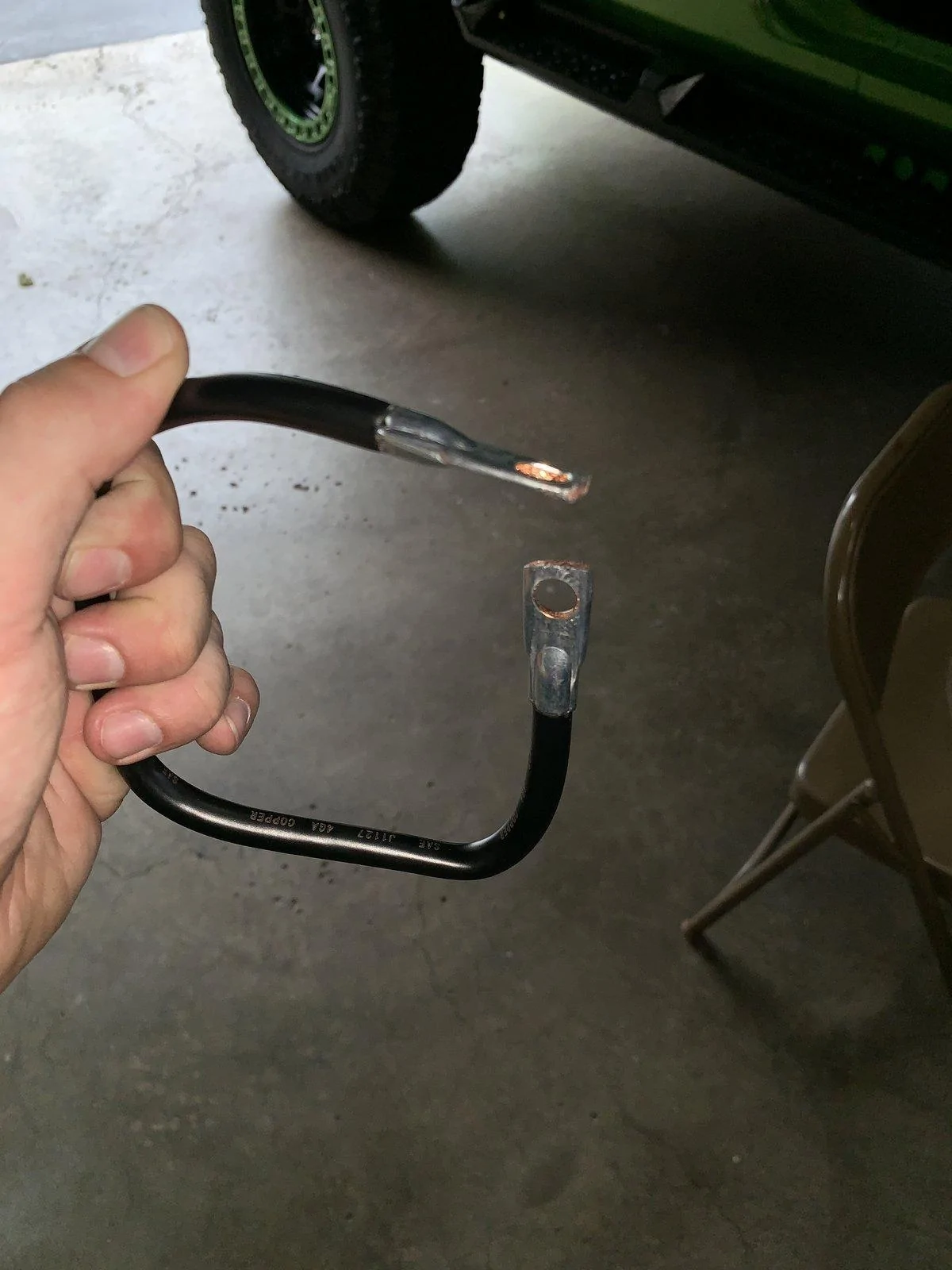

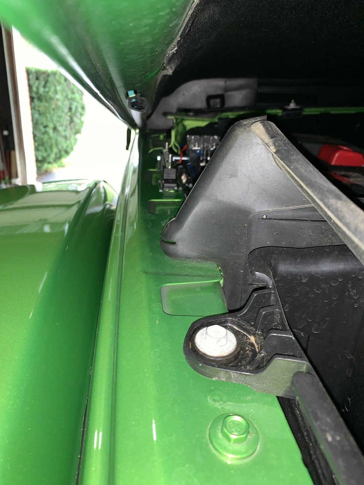

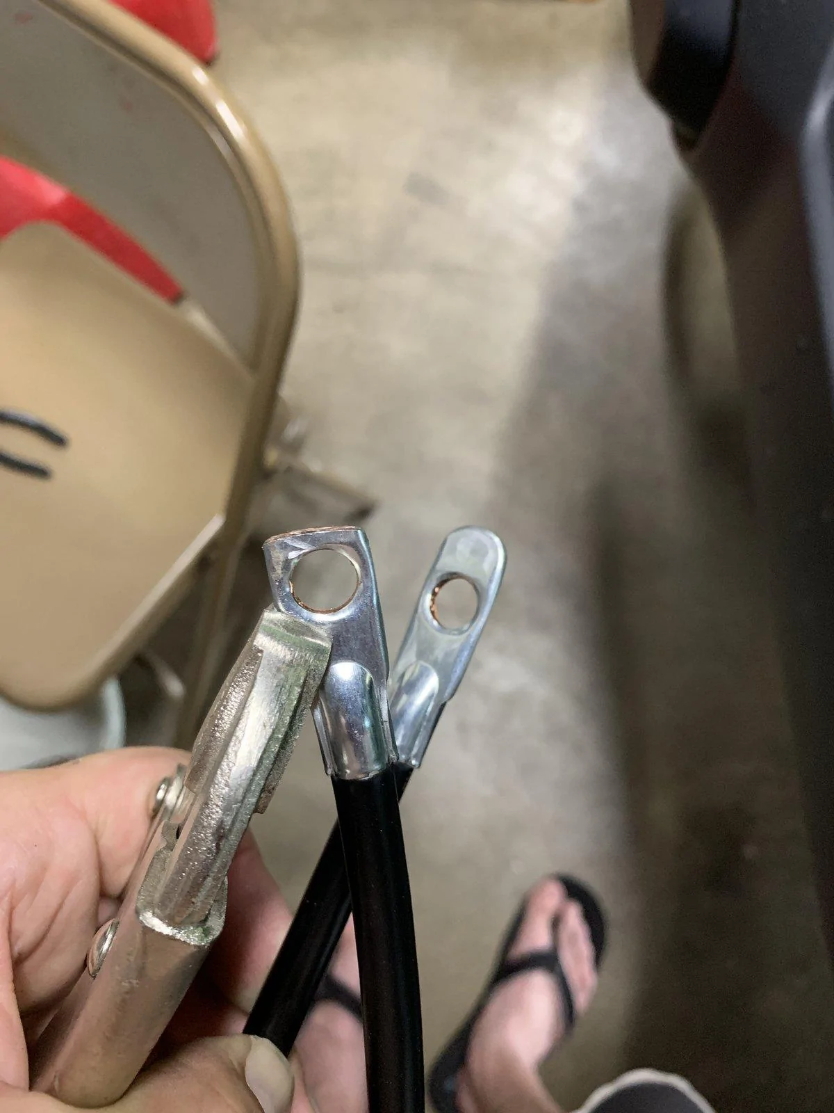

Got some MOAR LYTES coming folks, but 1st we'll need MOAR GROUNDS :) :rock:
Here's what i did:
New ground cable extension - https://www.amazon.com/gp/product/B01K68YC2W/ref=ppx_yo_dt_b_asin_title_o03_s00?ie=UTF8&psc=1
Grounding terminal - https://www.amazon.com/gp/product/B07S2F26X3/ref=ppx_yo_dt_b_asin_title_o04_s00?ie=UTF8&psc=1
Double sided tape - https://www.amazon.com/Gorilla-Tough-Double-Mounting-Inches/dp/B00OXVG9FW

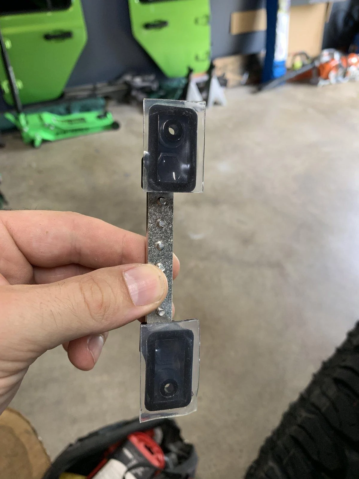

First - started by applying the double sided tape to the bottom side of the mounts. I did NOT use the screws provided. I have not used this tape before, but it seems BEEFY, but able to remove if needed. It holds WELL! I would not trim it too close, as you'll need a small portion of the corner to peel the clear tape cover from the 1 side:
EDIT - I noticed that the ground wire side was being lifted up, due to the cable bend applying pressure upward. I added 2 MOAR strips of double-sided and that seemed to fix! :like:
I chose the body area next to the battery, where i mounted the relay for the ROAM rails. I like this location, because i could terminate the positive wires to the factory AUX power leads AND it's right next to a piece of weather-stripping on the hood, so protected and all wires in the same spot - NOICE :like: The hood does NOT hit it at all.

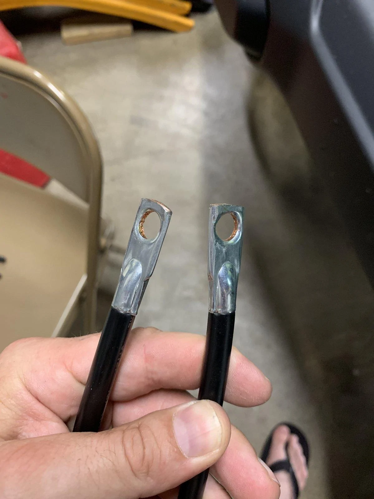

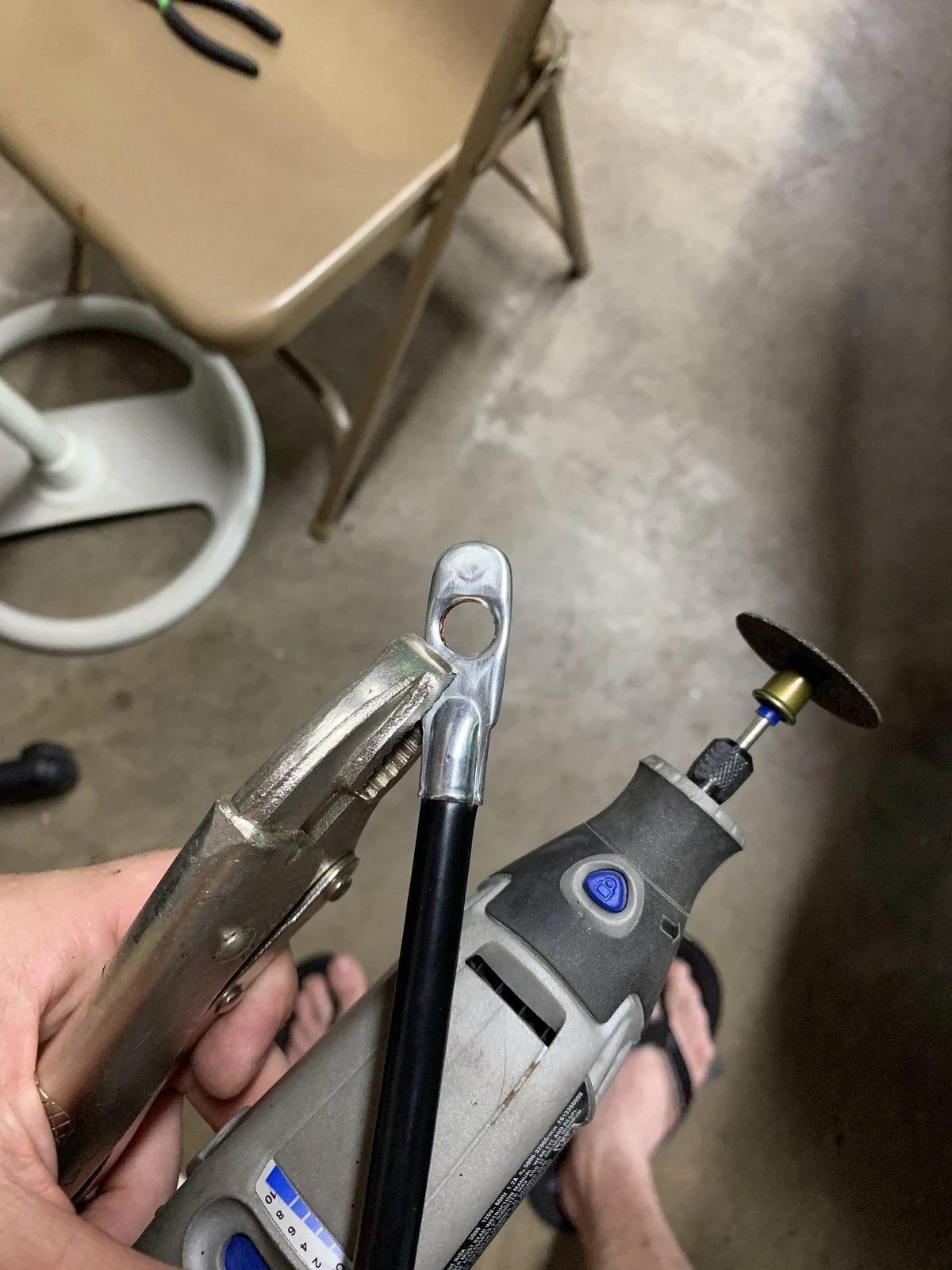

Next - i decided to trim the new ground cable so that it can fit the factory grounding location and the new terminal. Used a dremel:
I decided to use the middle factory grounding as it's not painted. I came up from the bottom and went BEHIND the factory cable. All mounts flush.
The new ground wire mounts a little weird, but here's a pic of how i "wound" it. I slithered under the factory ground that closest to the firewall and up into the mount bolt.
Here are a few pics of the wire on the ground bolt:
Using some circle connectors, i moved my grounds for my pod lights and ROAM rails:
Circle connectors - https://www.homedepot.com/p/Gardner...ng-Terminals-in-Blue-15-Pack-15-104/202522492
Very soon, i think i see MOAR LYTES in my future :rock:
Also - copied all of this into a "How To" thread - https://www.jlwranglerforums.com/forum/threads/how-to-add-a-grounding-terminal.32757/

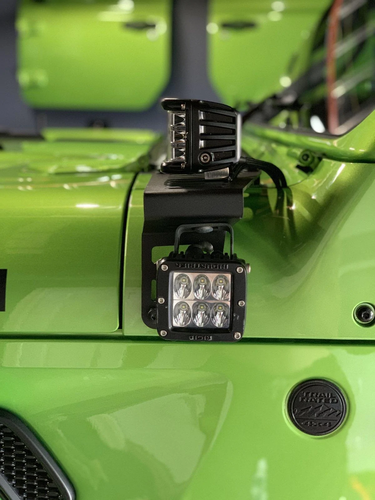

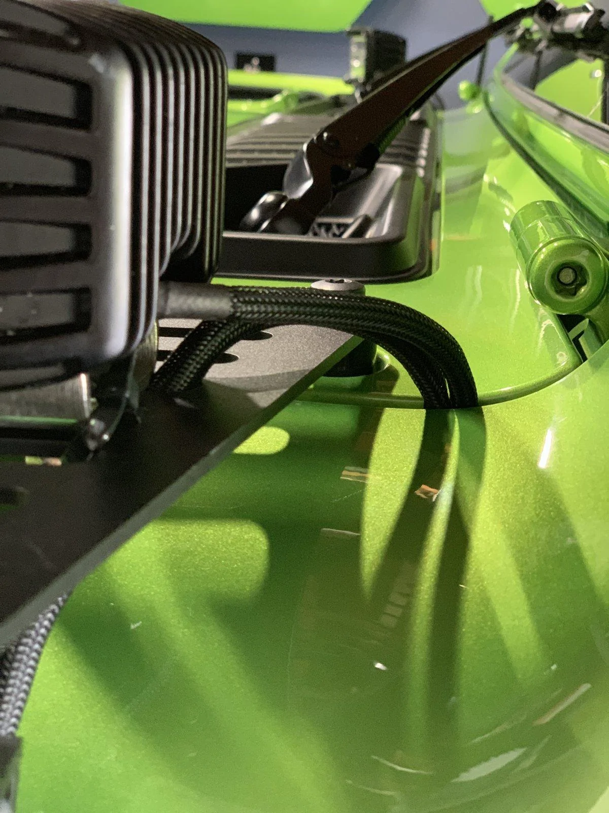

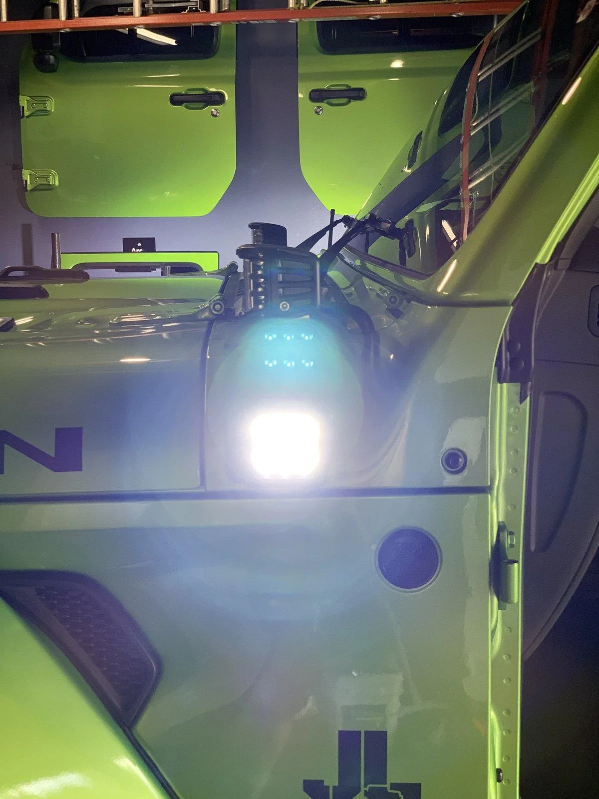

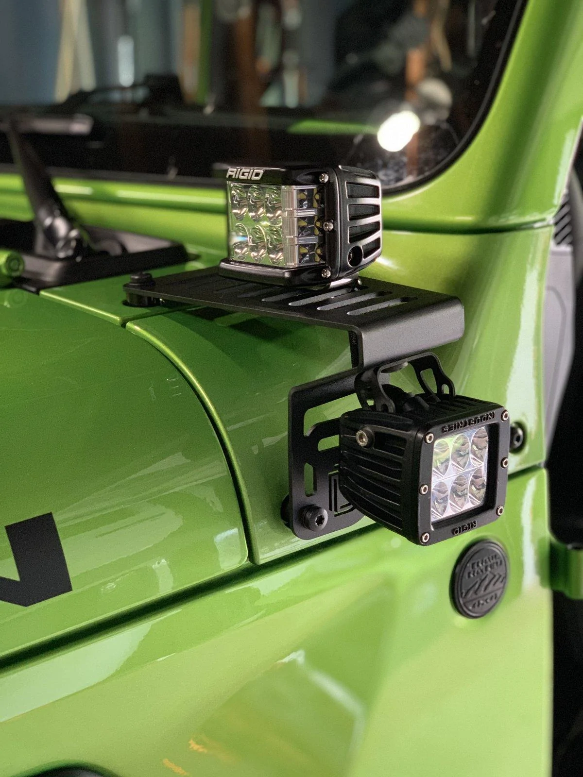

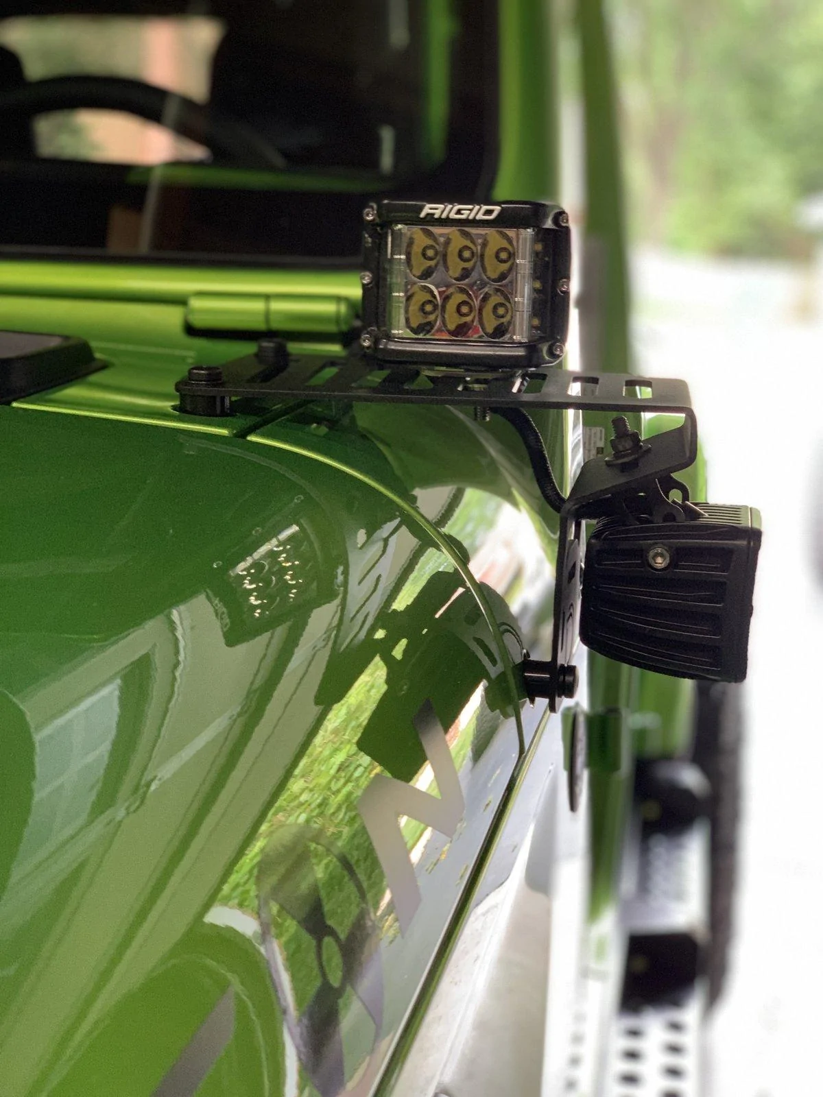

MOAR LYTES - SYDE LYTES!!!
This is why i chose this bracket from @Diode Dynamics. They offer a perfect dual-pod/dual-purpose! :like:
I used my Rigid D2's that were my old rear LYTES. Wired these up just like the first set and tied into my new grounding terminal - easy peasy (to AUX4). Cant wait to use at NYTE and to quiet those A-HOLES next to me in traffic - LOL (They are pointed straight out)

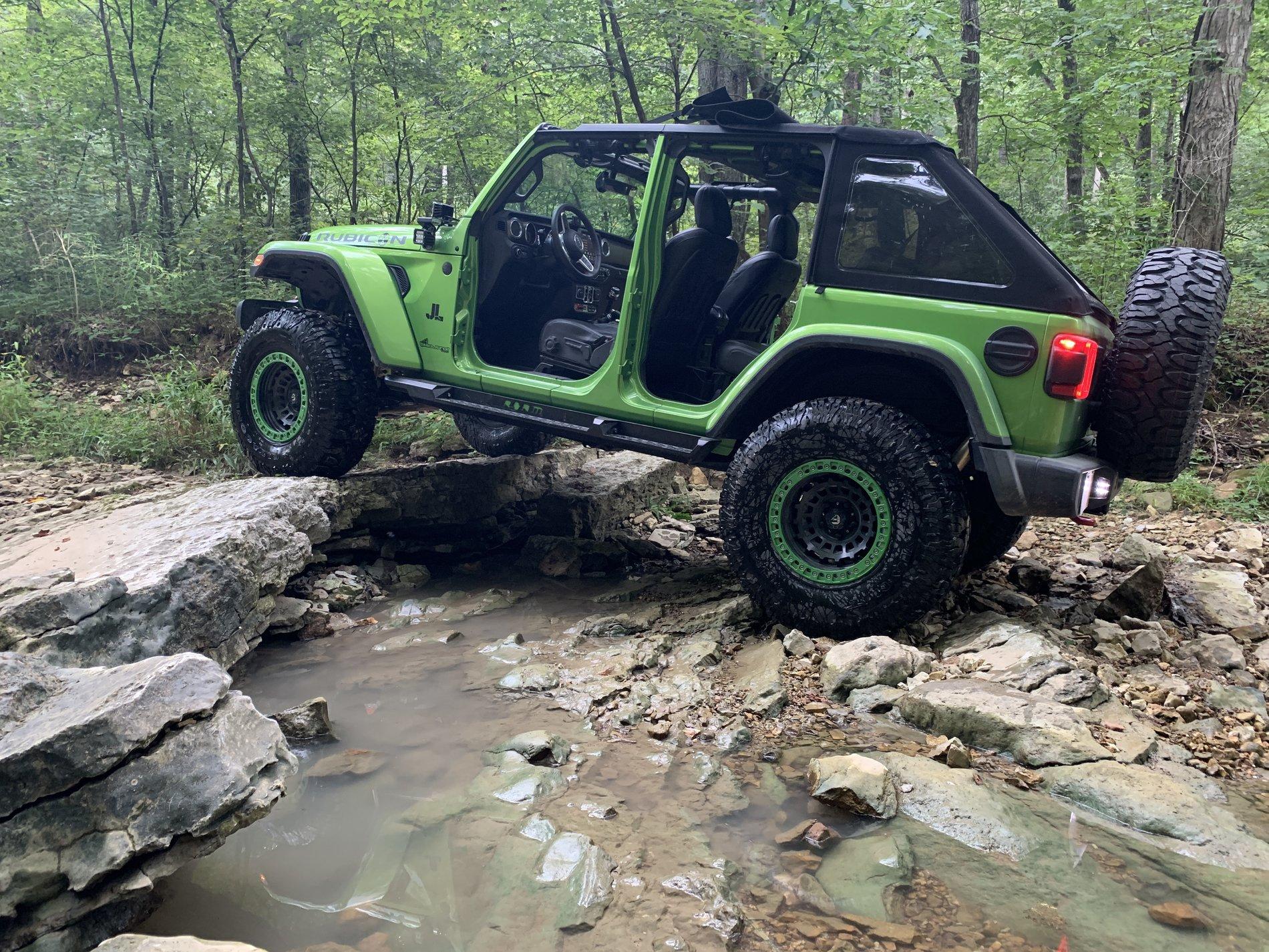

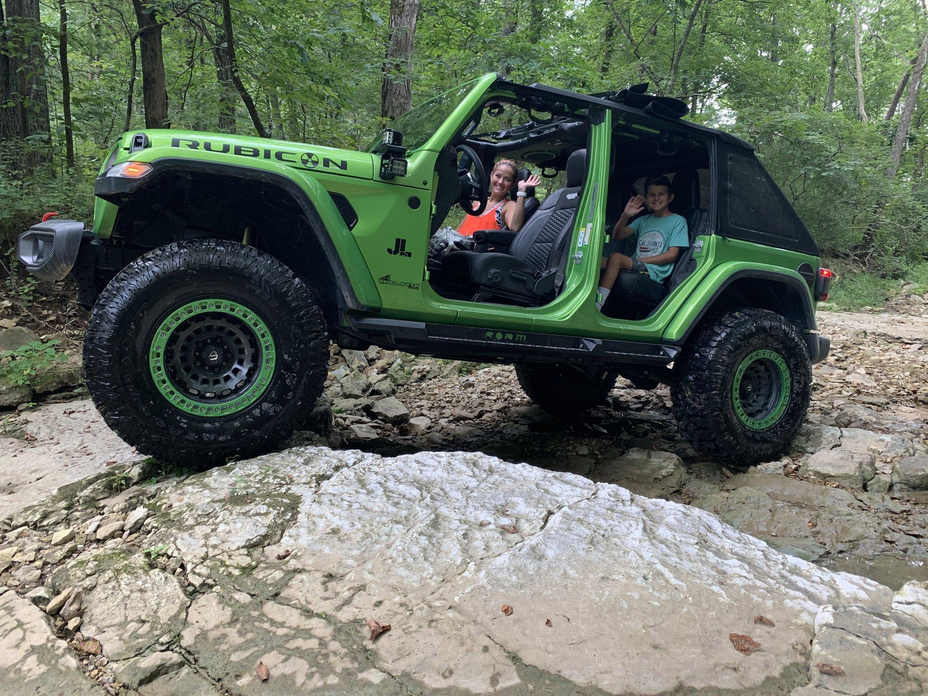

We both did the MetalCloak 3.5 GameChanger. We havent been able to get on trails much yet, but i did some small dry creek runs over the weekend and it worked great. No issues, no noises. Love it so far. Here's a few pics. Wanted to share these anyway :)
