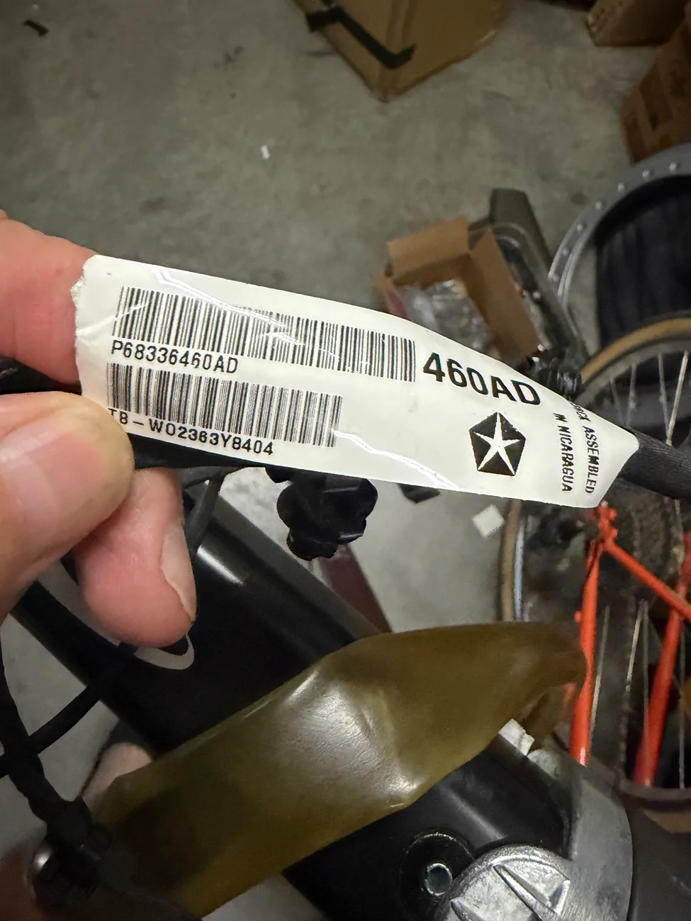

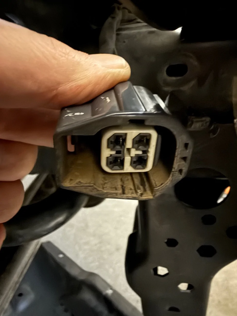

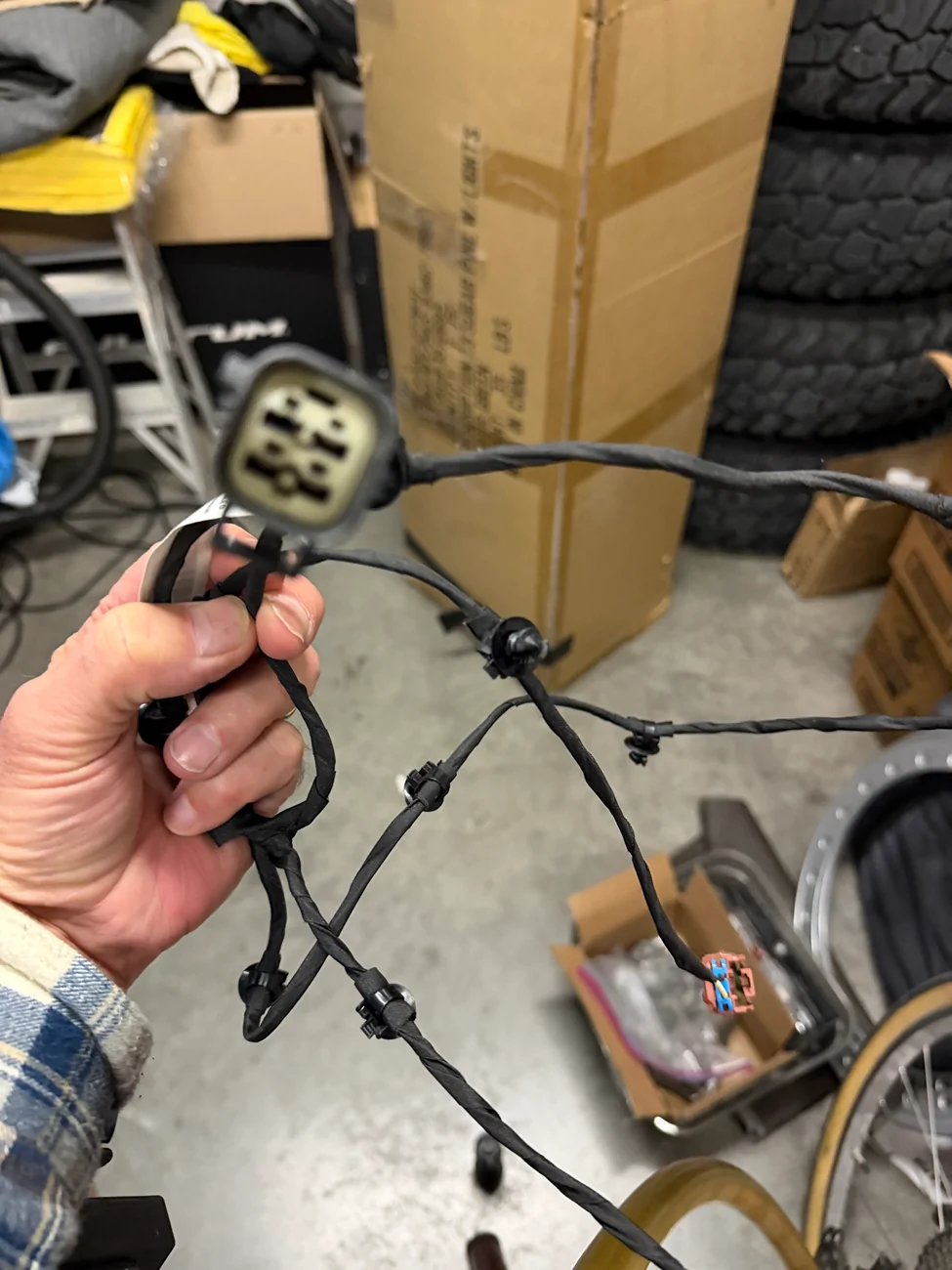

I have a 21 Rubicon and bought a stubby steel bumper off a 392 and the fog light male/female don’t match. Is there an adapter to make it work? Thanks.

I ran into this when I changed mine. Easy fix, just cut the pigtail off of your original bumper harness and splice it to the new bumper harness. If memory serves me correctly, the wire colors are all the same, easy fix. Mine works perfectly after doing this.

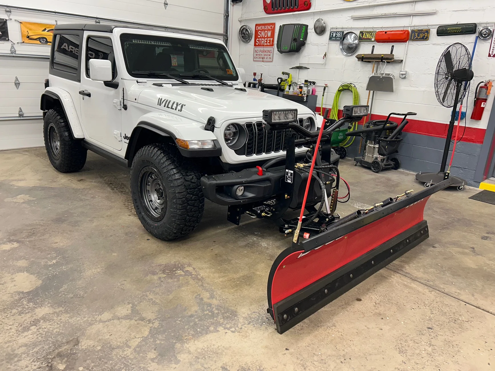

Thank you!!! GREAT looking rig with the snow plow!!!

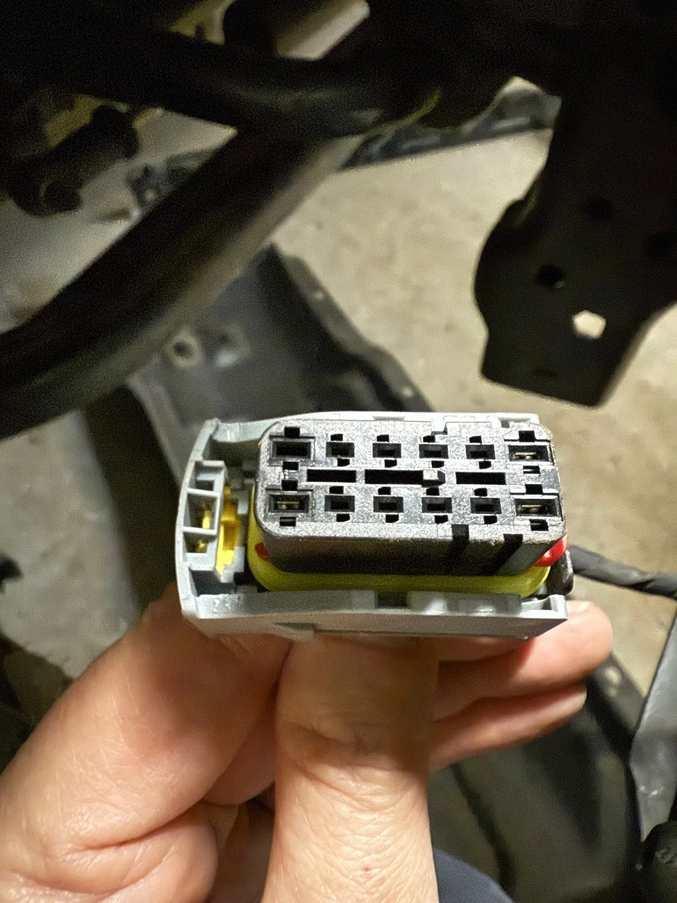

you can but the complete harness for fairly reasonable..I have one as I bought a bumper that had the early style and I have a 2024. easy swap over. you can also just take the one out of your old bumper and swap into the new bumper...
