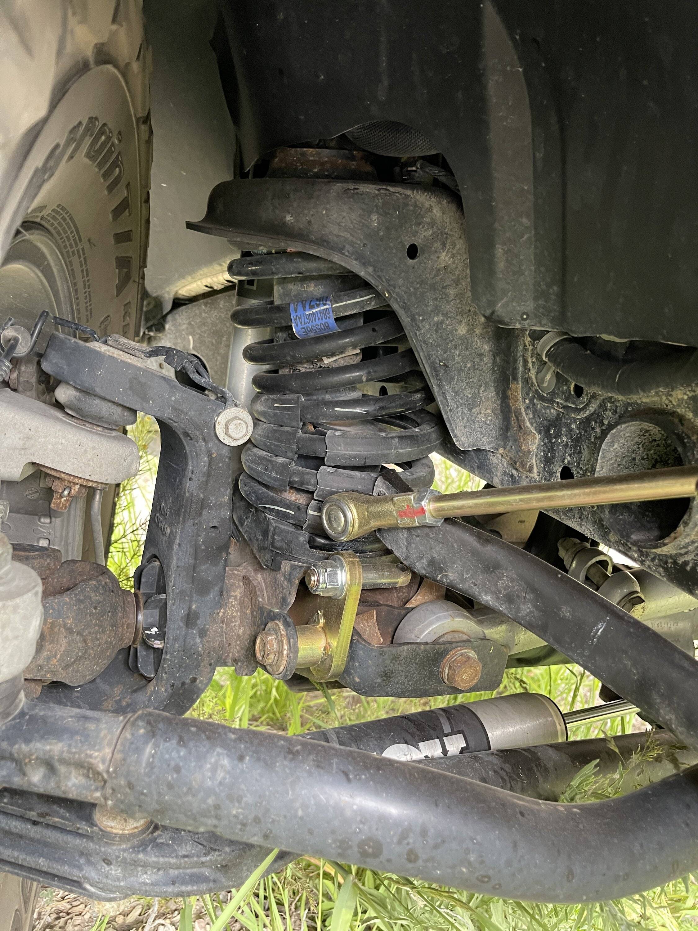

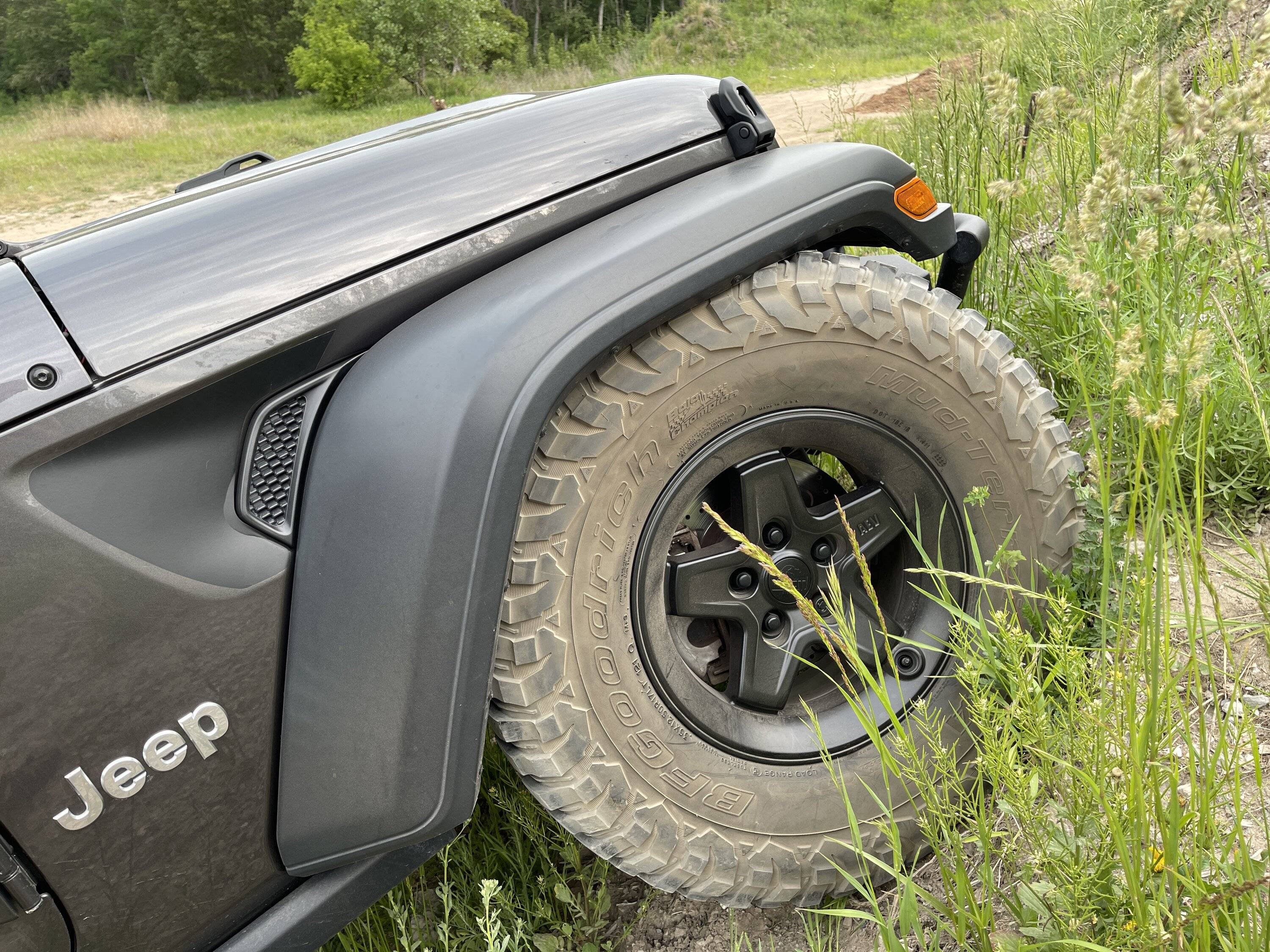

A bit. I added a 3/4” spacer up front knowing the bumper/ winch would sag it eventually. I haven’t measured recently, and added 35’s so measuring now is moot. But I’d bet it settled about 1” front and rear, with the spacer still keeping it level. In the end I got exactly what I wanted with the spacers, and LCAs. I’ll probably keep the same lift when I swap axles too, and probably stick with 35’s. They stuff just about perfect, only rubbing under full stuff/ droop with steering input on the fenders, but Rubi front fenders will fix that.
