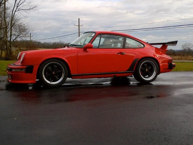

Too soft for what? Rubber would be perfect as it is obviously very pliable. The pic is of my 84' Carrera. See where the side mirror is attached to the door? There is a rubber gasket there. Worked perfectly well. It was for keeping water out but the mirror housing was aluminum so without it there could have been galvanic corrosion also.
With all that being said if this starts with my Willys I'm taking it back to the dealer the second I see a single friggin bubble. They'll take the hinges off and paint behind them like they should have in Toledo's paint shop.
