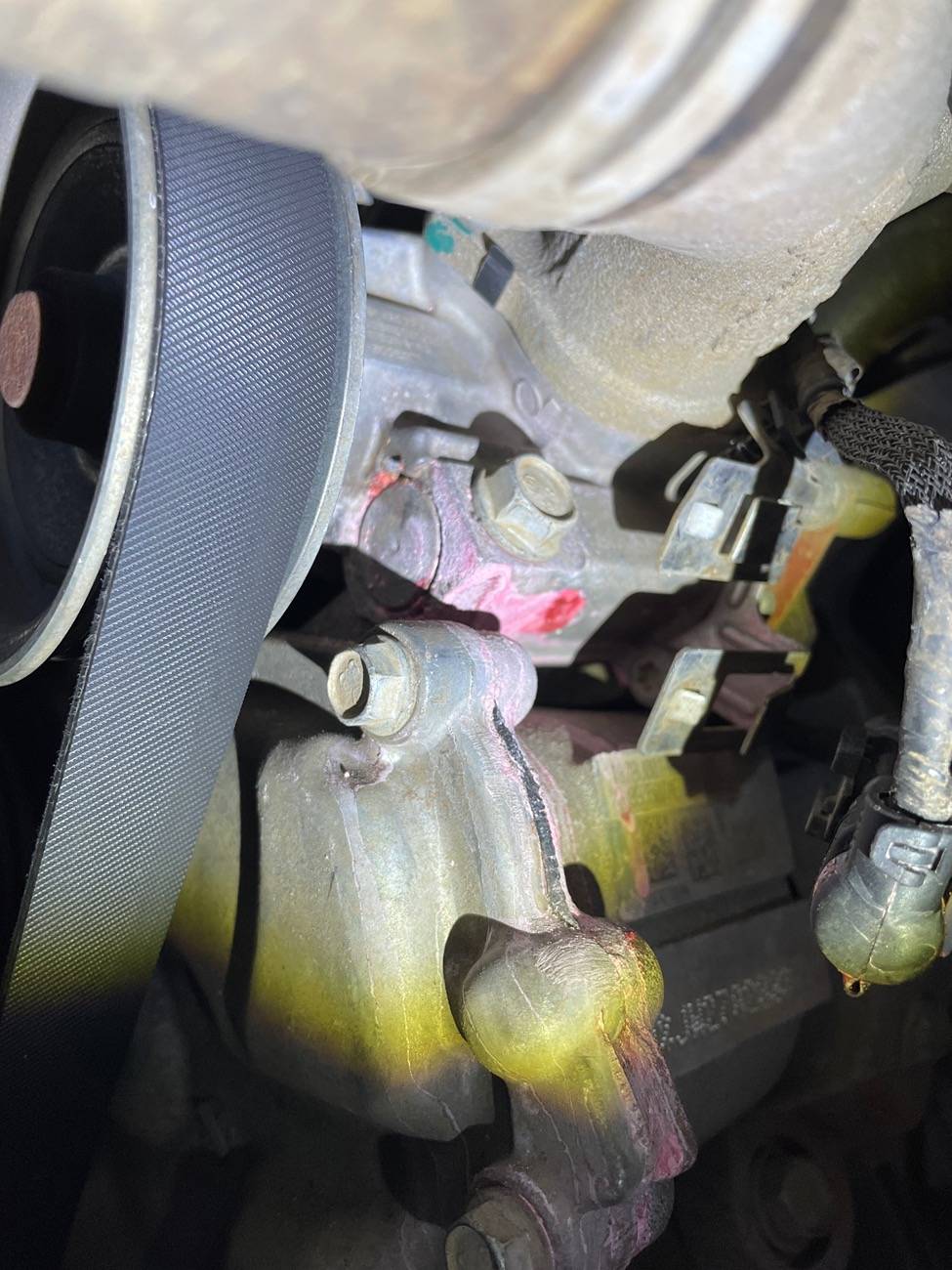

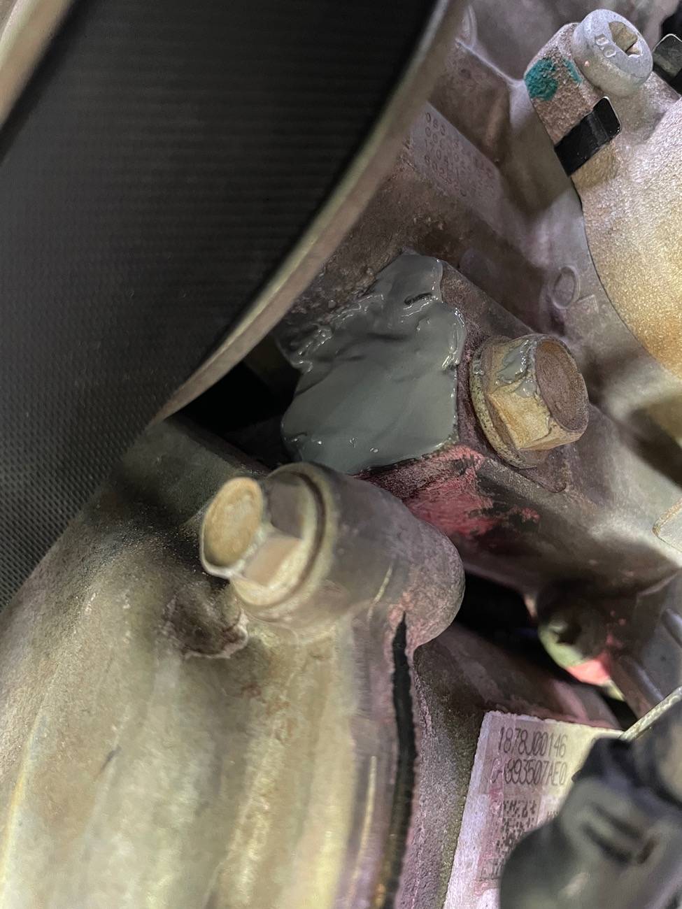

There's a leak in the water pump where water often leaks, but it's minimal. I plugged it with Nural.

did you plug the weep hole? that’s there by design. If it’s leaking coolant that’s an indicator that the internal water pump seal is wearing out.
This is dead on. Not a very good idea to seal that unless you want more major issues.

Do not plug the weep hole, that can lead to bearing failure and catastrophic failure of the pump. Weep holes work with the vent hole, or may be the only vent hole, depending on the pump design. If it’s dripping on your driveway, replace the pump. If not, the. Probably not a big deal yet but should be monitored.
Source: I work for a company that makes water pump seals
