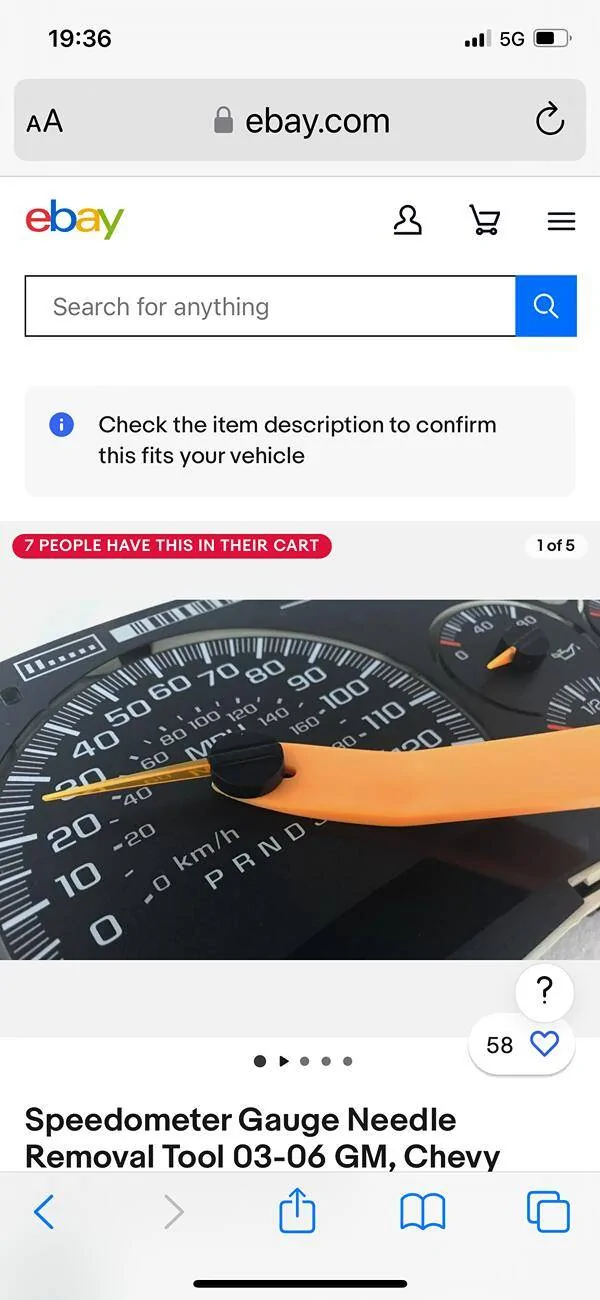

Just make note of their position and pull them up from the center, then just line them up in the proper position and press down on the center. There is a tool to remove them but you could use a trim tool from Harbor Freight.
