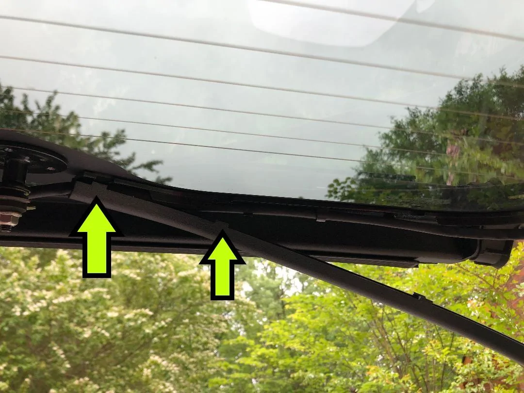

This was easier than I thought. I got the idea from another owner and I'd like to give him credit, but I can't remember his name. It may have been on one of the Brawlee cargo light threads.
I ran the wire for the light inside the cover... pry it off gently with a panel-tool thingy. Don't He-Man it off... you can snap the tabs. No exposed wire.

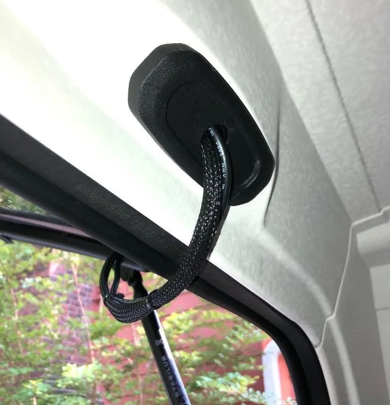

I used a fish tape starting from here... it slides in & up and pulls the wire through fairly smoothly...there's a little bit of resistance on the way back down, but don't yank it. I wouldn't recommend a wire hanger... it's too rigid & certainly not flexible when you push upwards.

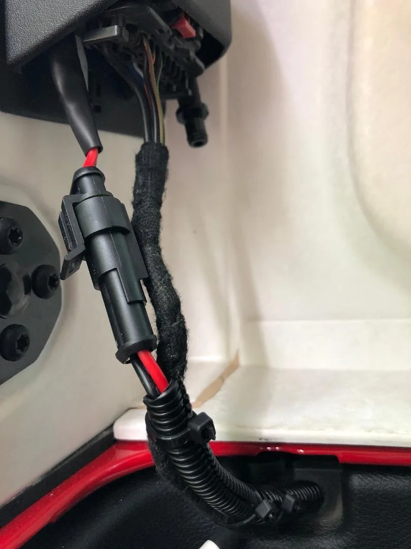

Secured to the existing harness

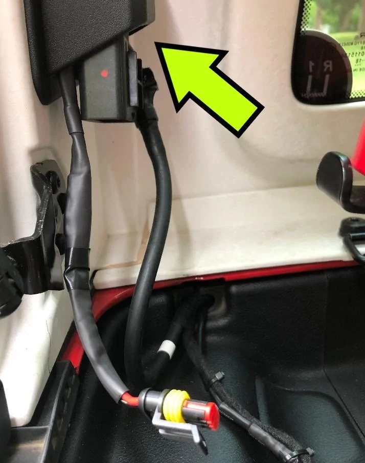

Plenty of room for the additional wire
