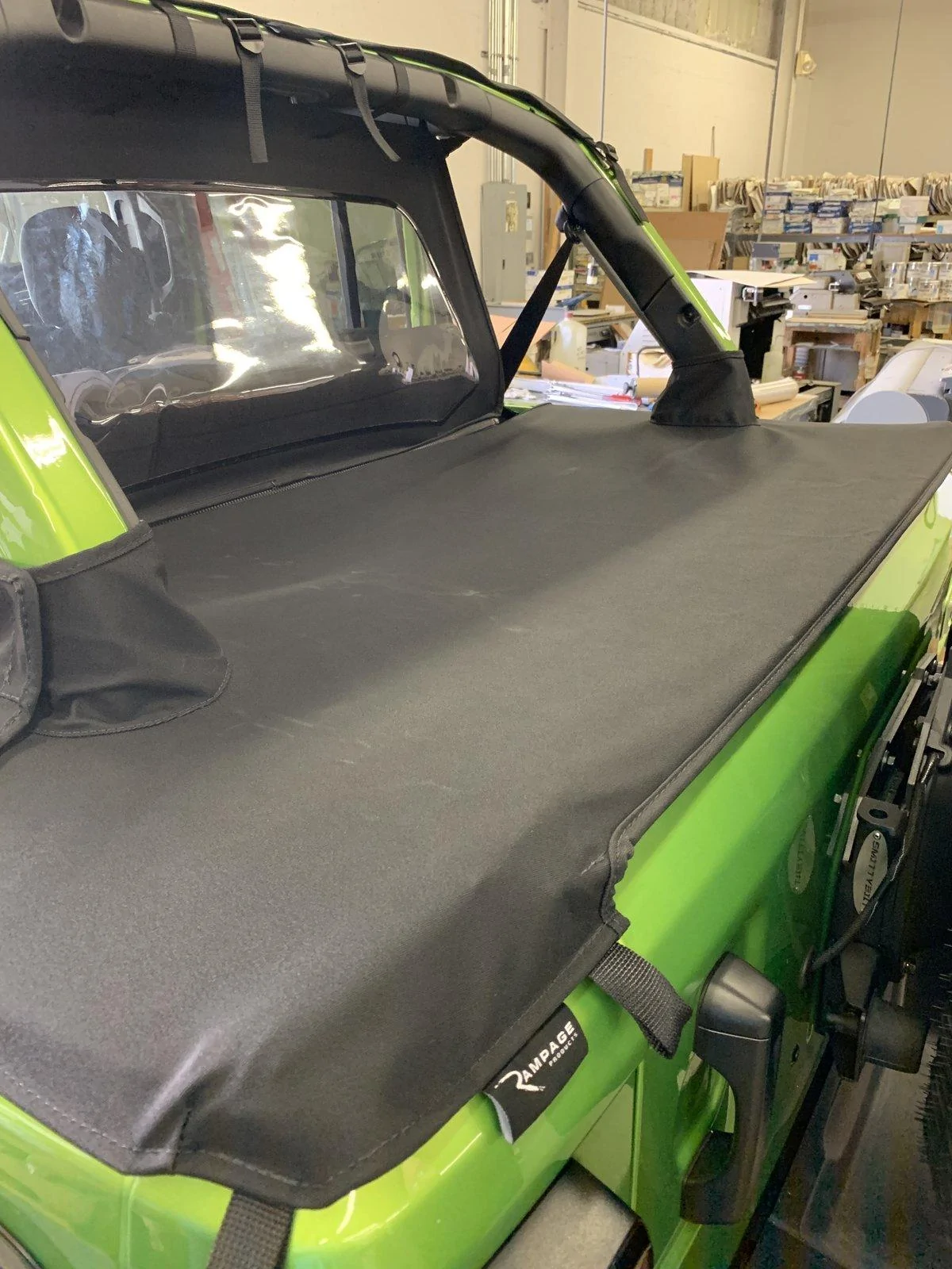

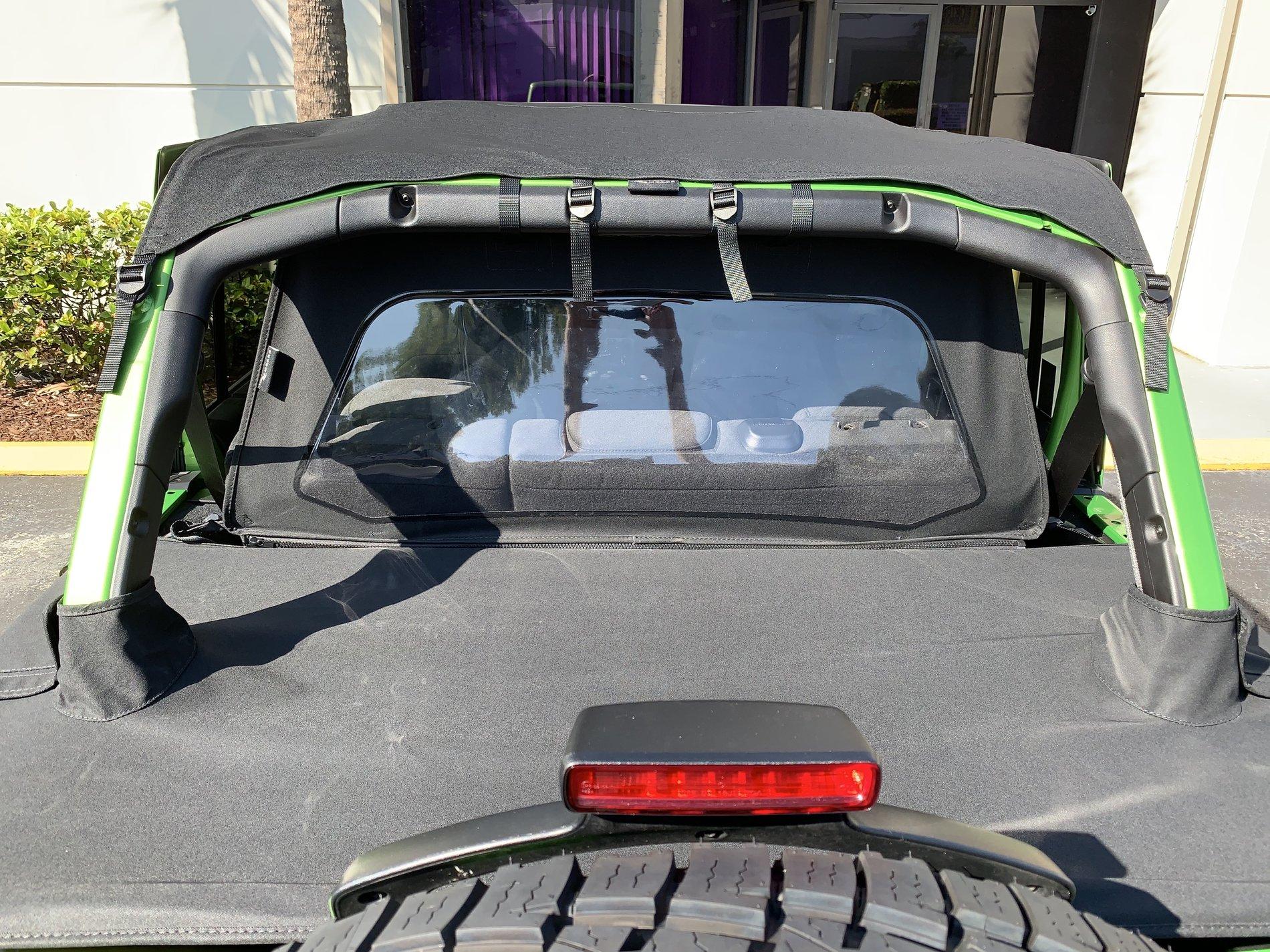

Okay, so the JK rear retainer bar (Smittybuilt 91205) did work - just you need to have the two mopar left and right corner pieces that fit the JL ($13 each at Quadratec). You will just use the BAR and not the two corner pieces as they are for the JK. Very happy - I ordered a full denim waterproof cover to keep in the tonneau area since I live in south florida for that random rainstorm. BOTTOM SHOT has the RETAINER BAR INSTALLED.
I was coming on here to say I just received the Rampage tonneau and I’d does not come with everything like I was told by Rampage. Your post gives me hope now so thank you. I have seen the tailgate bar corners on Quadratec but wasn’t sure they would work with a Smittybilt JK bar. I got a JL Smittybilt bar for Xmas tho it’s apparently backordered so who knows when that will arrive. Been over a month since it was ordered and still in “processing” from 4WP. I shall order the JK bar and bar corners for my tonneau. Thanks again for the post!

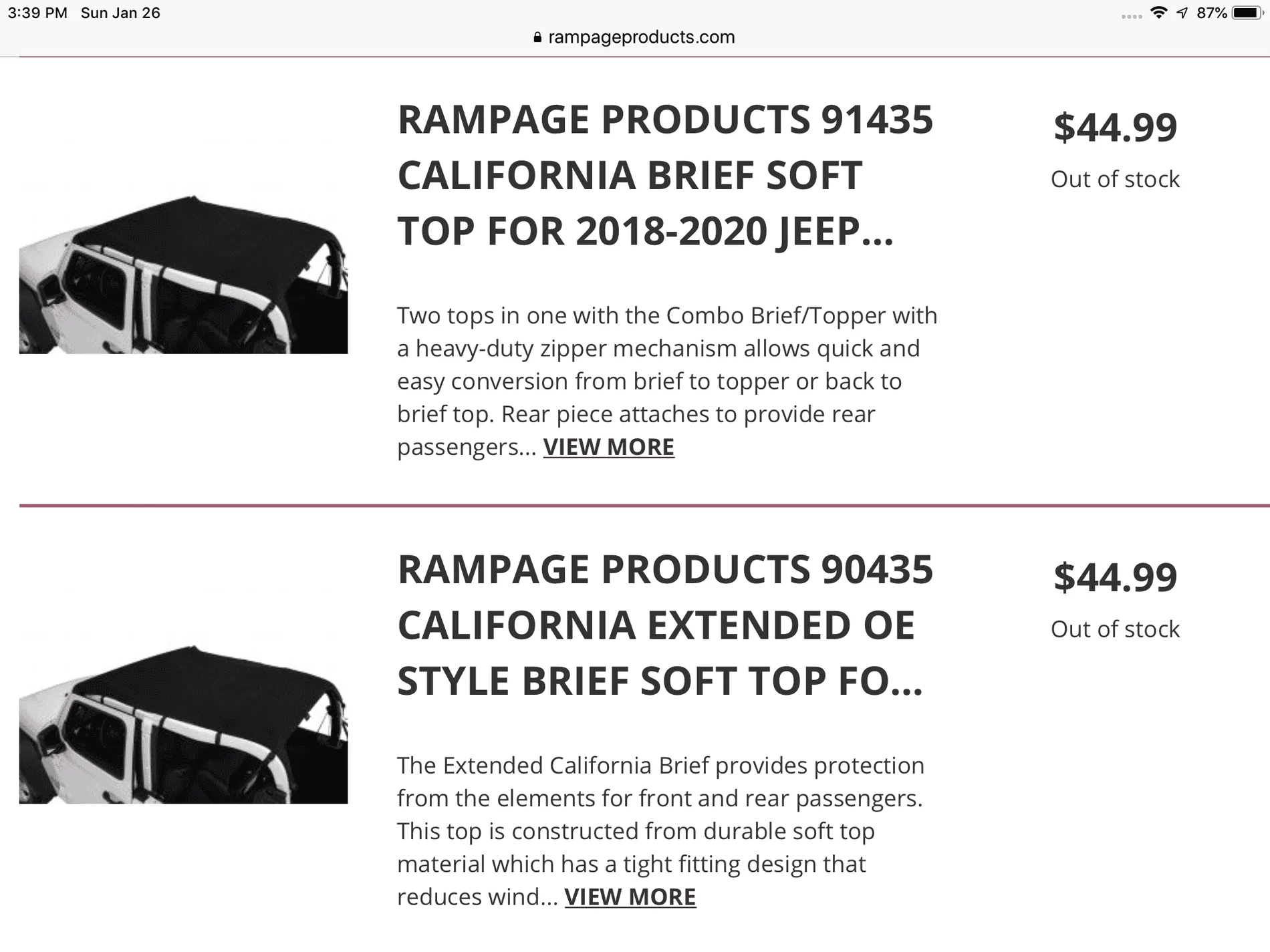

Was going to order but Rampage is out of stock now.
