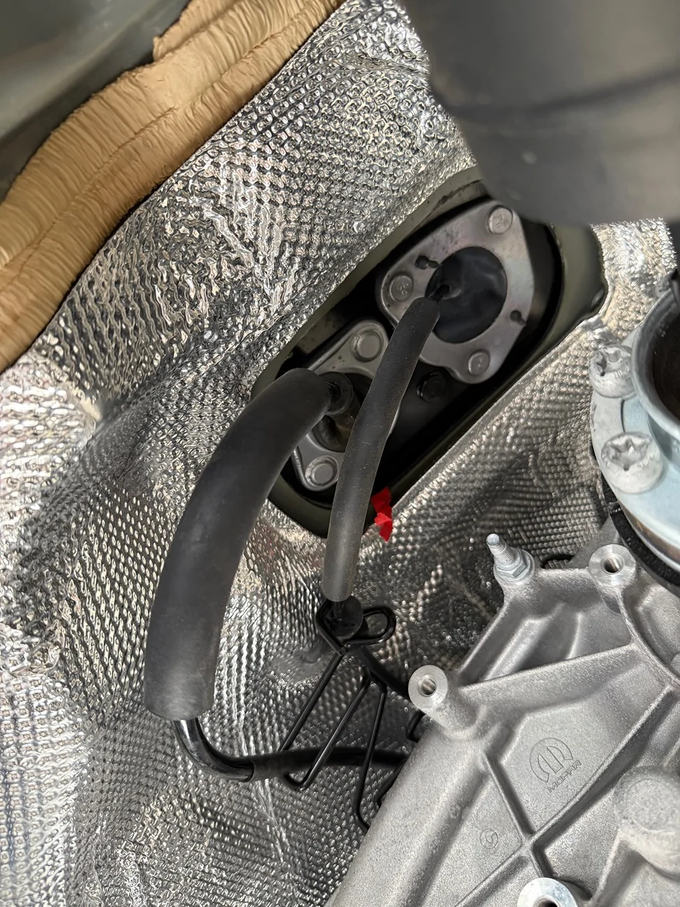

So I saw on another thread and the help from a fellow forum member to checkout the shifter cable I think tis called. There is 2 cables coming out from around the underneath middle of the Jeep. They are braced by metal clamps and rubber insulation stoppers. Please see pic below as I circled the part that was causing the rattle. I ended tugging on those cables and it sounded like the rattler I was hearing. So I ended up up pulling the that rubber stopper out some from the brace and tried tugging or flicking it again and noise stopped. Took it for a test drive and rattle was gone. So hopefully it stays gone and I hope this will help anyone with a similar rattler. For reference, I also posted a link below to the video I made with the rattle..
