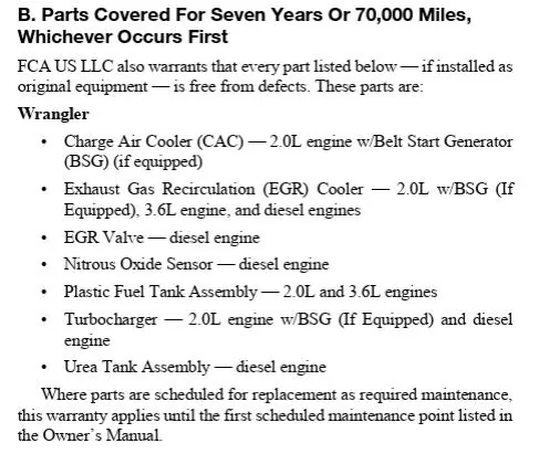

I cleared the codes, and it'll drive different once cleared, but engine light and warning lights come back on within minutes, turbo doesn't work when engine light is on.
Taking it to jeep tomorrow, I hope my 5 year warranty is still in place, got a 2020.
Being in California, it appears you have more than that. It states the EGR is covered for 7 years and 70k miles for California vehicles in the link below. You may want to print that and take it in with you.
https://vehicleinfo.mopar.com/asset...1*1mr1py7*_gcl_au*NTkwNDg3NTk0LjE3NTAxODk5NTI.
