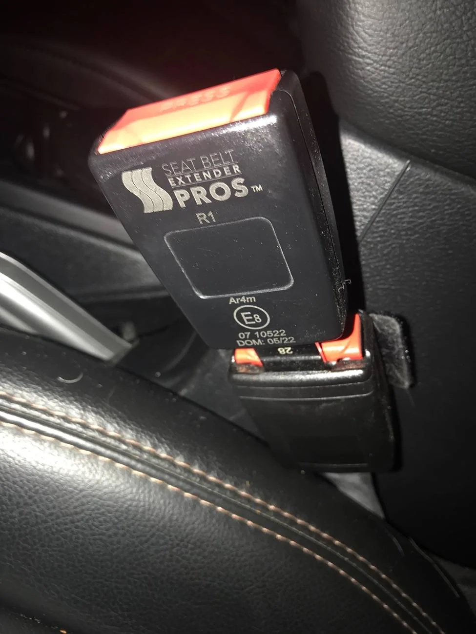

Auto Park disable ~ $20
Jeep Wrangler JL Jeep Auto Park F640ED49-F460-4BE7-8C0D-BE361AE6F171
Yours shouldn’t have with the belt latched, but hopefully eliminate it from further glitches for ~Twenty bucks
