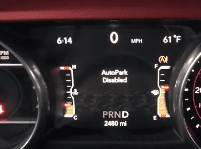

Ok, so this has happened a few times now. I get in, put the car in reverse, the Jeep slams on the brakes and can't drive. It gives me a message about putting the car back in park. Then when I do it, I usually can't go forward without doing this a few times. I then get a message saying AUTO PARK is disabled (I am not even sure what that is) and the auto show off light comes on telling me that has been disabled?
Is this normal? If not, what am I doing wrong? Is it because the door maybe wasn't shut all the way?

@ps2baseball; so when the doors are on your Jeep, the AutoPark system detects whether the door is shut and the seatbelt is buckled. If BOTH of these are not done, the system puts the transmission back in park. So if you either close the door all the way OR buckle your seatbelt, it won’t AutoPark. When the doors are off, the system checks for weight in the drivers seat and if the sealbelt is buckled. Again, if BOTH of these are not done, the system puts the transmission in park. With the doors off, you either have to be sitting in the driver seat OR have the seatbelt buckled to avoid AutoPark. Also, if you buy a programmer such as a TazerJL, you can disable AutoPark and you won’t have to worry about it. Hope this helps! :like::jk:

Ah... So you bagged me not wearing my seat belt. Thanks. This makes sense now!
