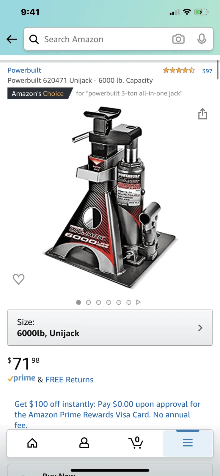

It's a mopar part. Part number 82215637AB
Wow $72 for a glorified bunch of wood blocks.......Thank you, but I'll likely cut a 2 x 10 in the garage and pile a few pieces up.
