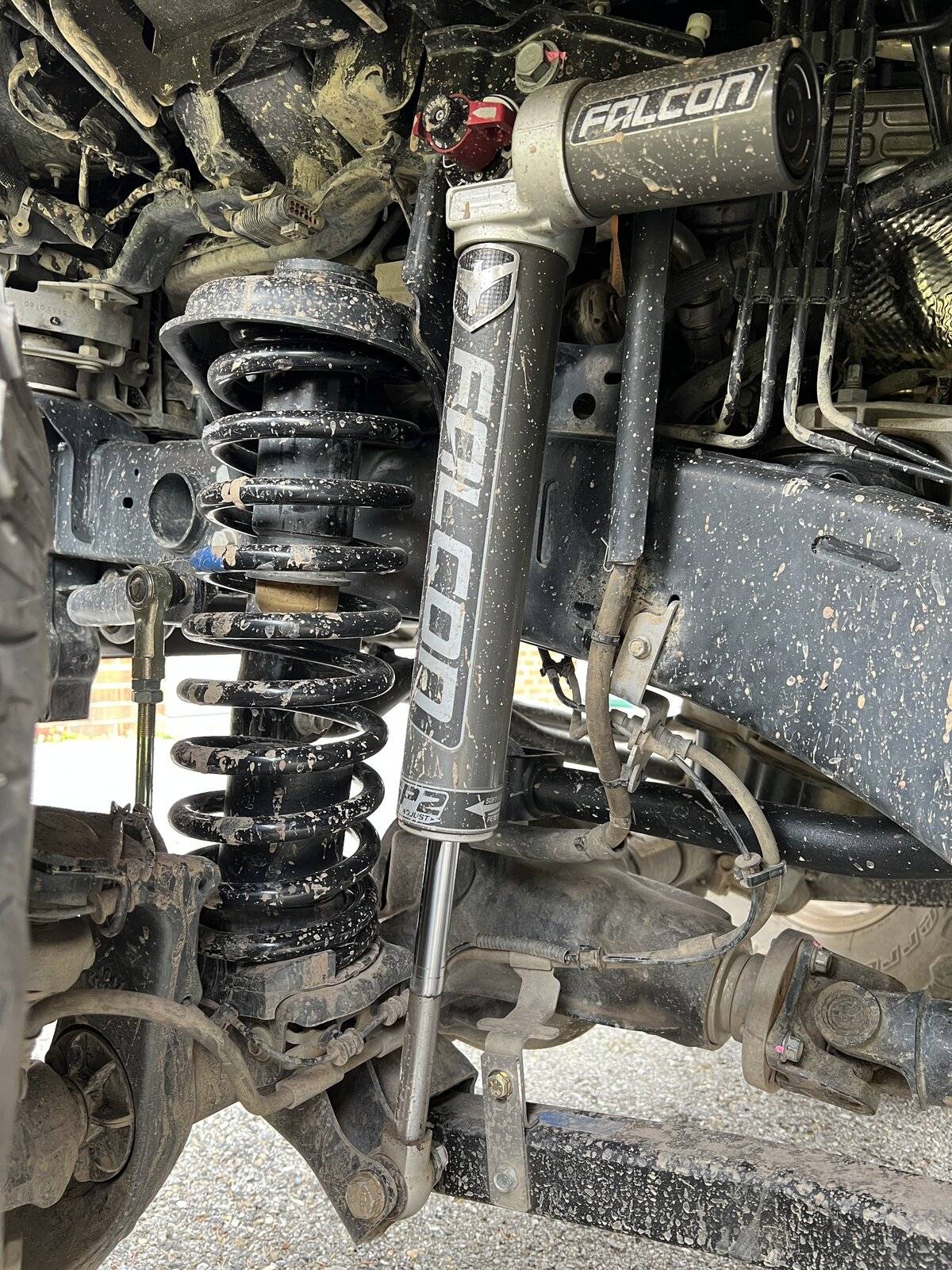

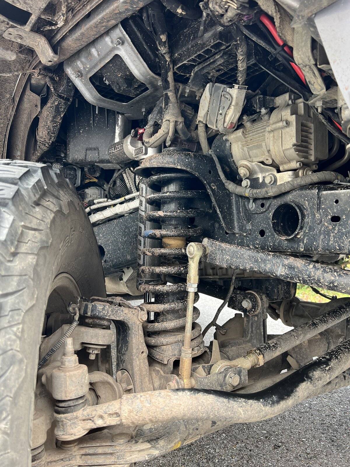

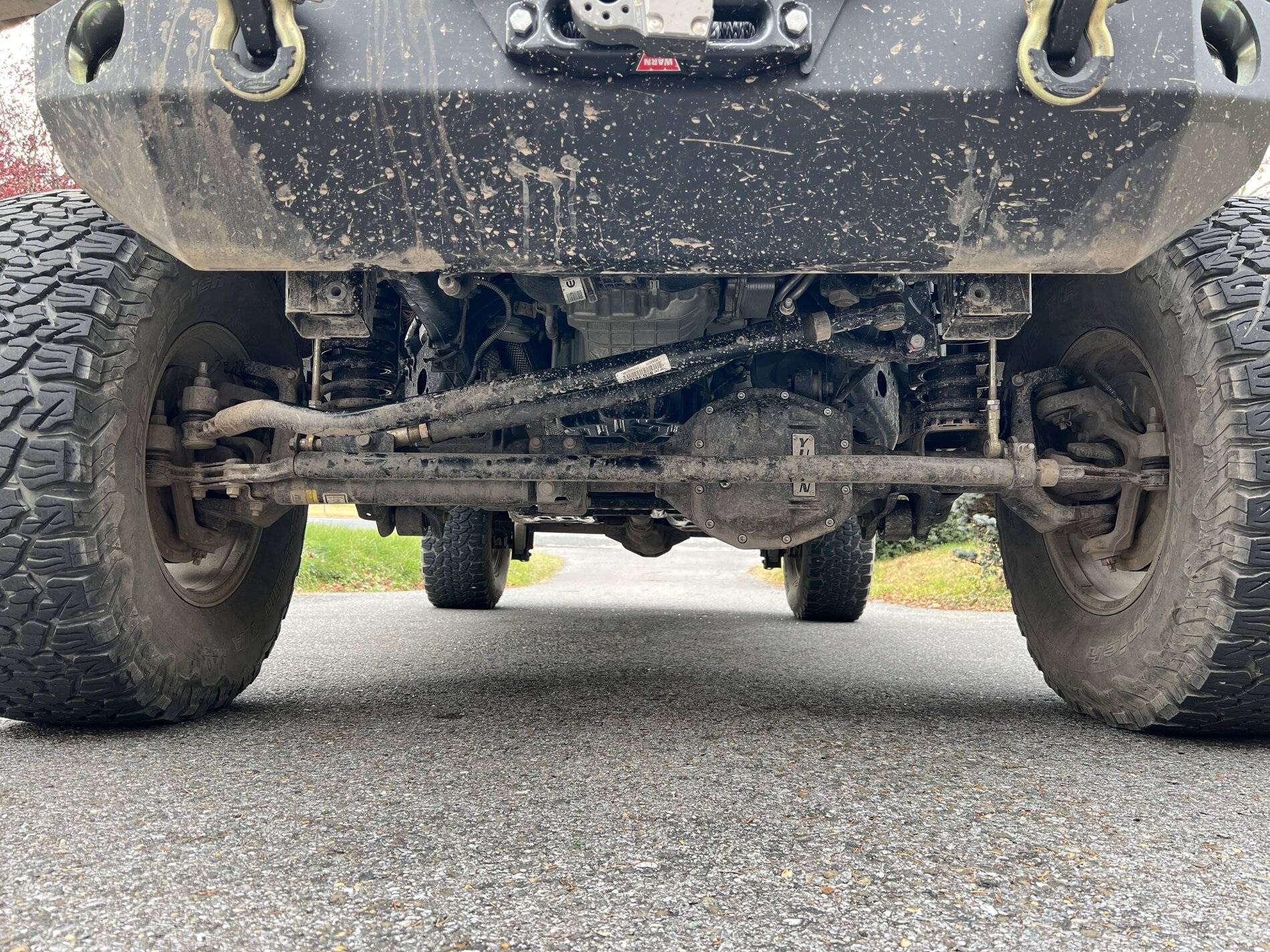

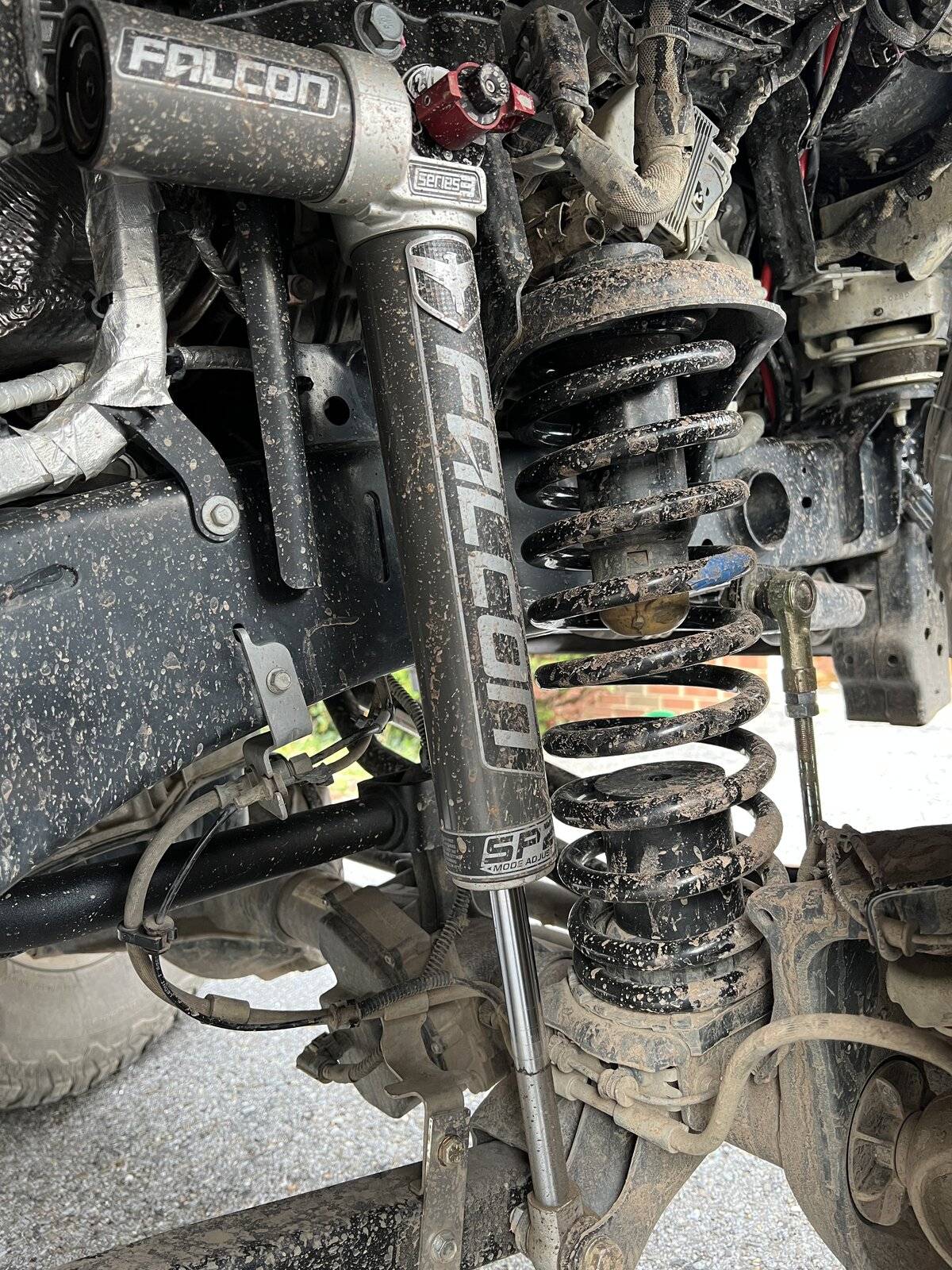

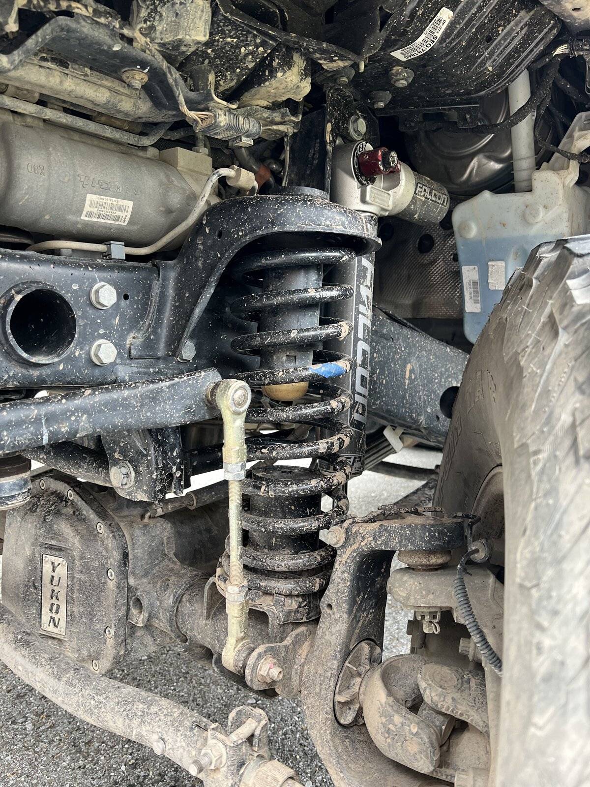

You got 5” of lift not including tire size or 5” including tire difference ? I need some pics, from the side and from the front including a shot of front springs

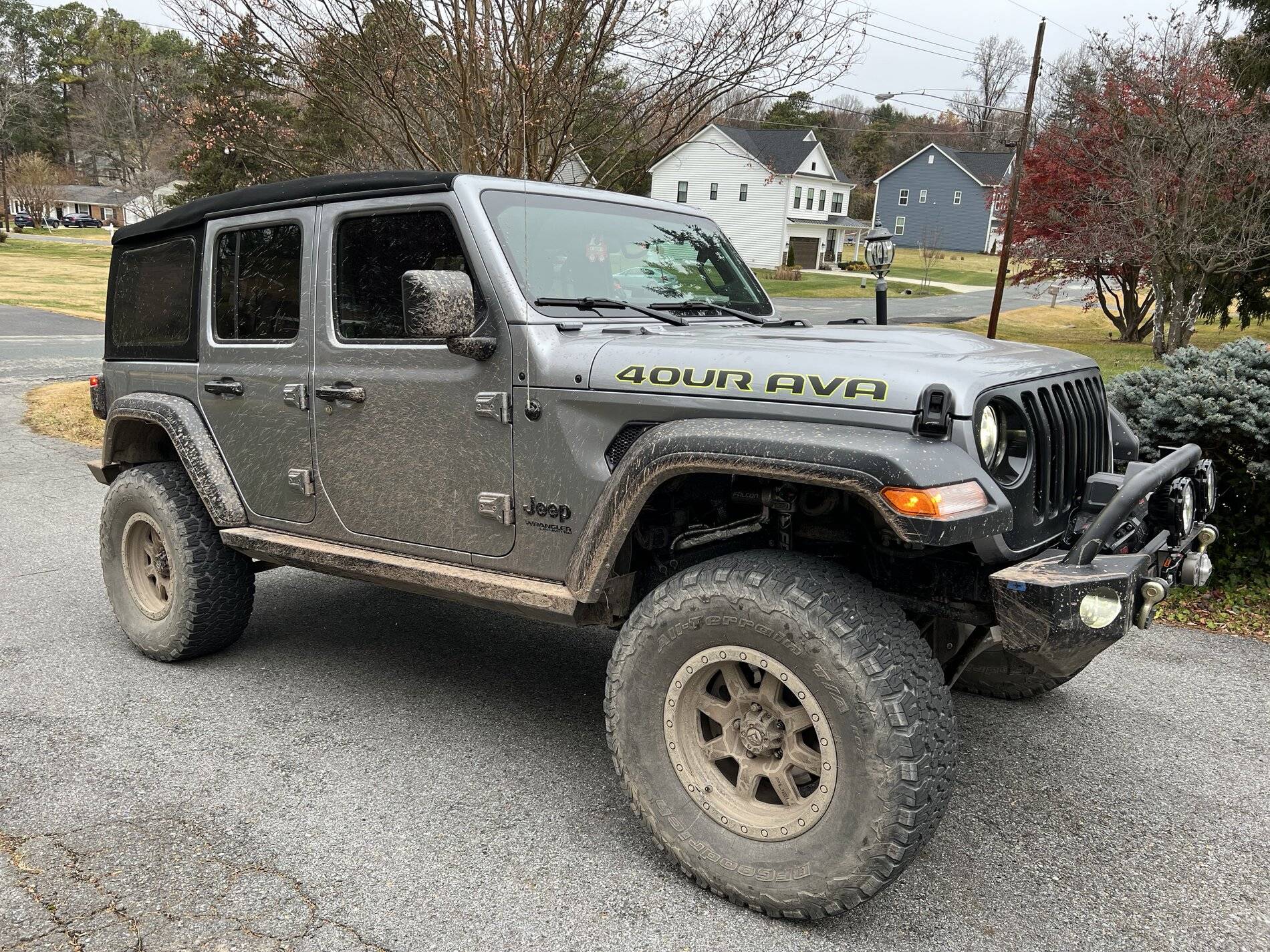

Hope these are ok. Sorry for the mess. Haven’t had a chance to clean anything from the weekend yet. Tires are the same 315/70/17 BFG KO2s from before the lift. I got about 5” of lift in the front.

Is the jam nut on the track bar tight? Hard to tell in the pics, but looks like it may be backed off.

No need to apologize for dirty Jeep, it’s as it should be…….so you went from 3 ish to 6.9 ish on caster, I’d still like to see it around 6, maybe 6.1-2 ish. Also not root cause, but ain’t helping, I’d replace the stabilizer with a thru shaft, and get it up on the tie rod. That’s where I’d start, this assuming your ball joints are not bad. And there’s no wear in the tie rod and drag link. The fact that tightening the track bar helped but came back , I’d look at that a little closer. You should lay under the Jeep and have your wife/girlfriend/significant other turn the steering wheel back and forth and watch for any unusual movement in track bar, tie rod, drag link . Also watch the steering box to see if it’s deflecting more than a tiny bit…etc. etc…

Without a closeup, it’s hard to tell. It just sort of looks loose there.
