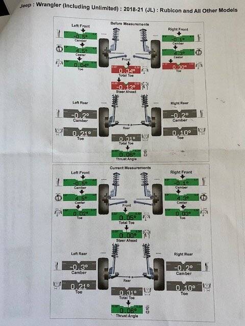

I have a 19' JLUR all stock with 35,000 miles and it had been pulling to the left a lot. The first dealer in Michigan said they rotated the tires as they had bad wear pattern and that fixed it. It did not and I did not go back and I have since moved to Ohio. This dealer did an alignment and showed me the specs on before and after. It is much better, but the wheel is a hair off. It still has some pull to the right. I am not sure what to do other than go back and have a tech ride with me. It really seems to do the pull at higher speeds, 65-75 mph. Thoughts??
