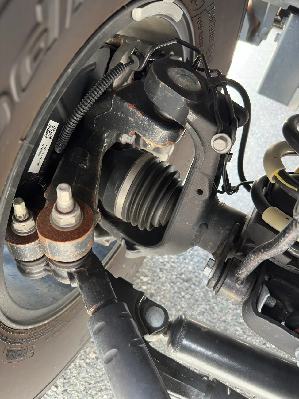

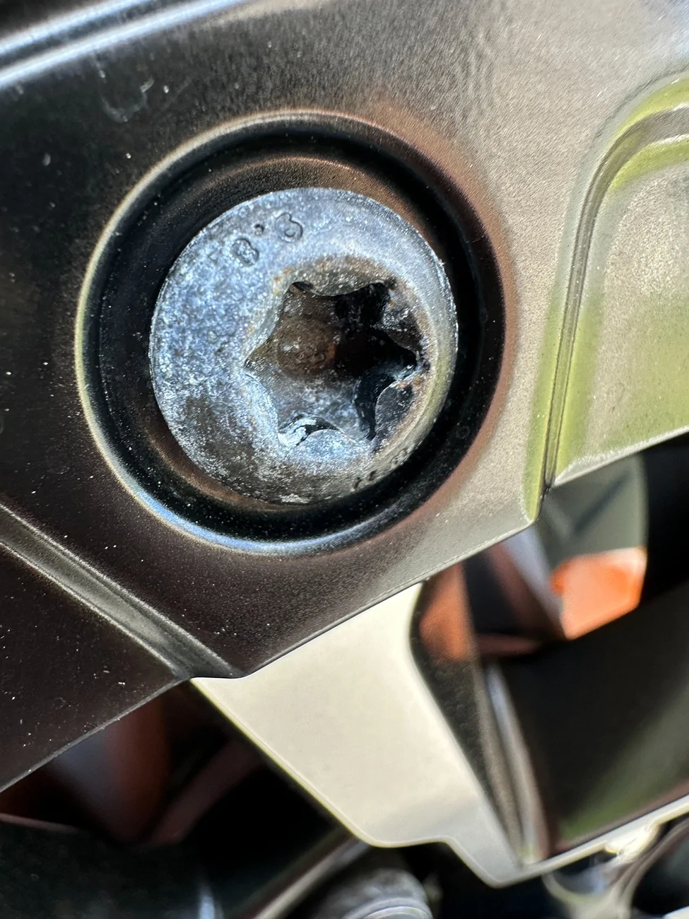

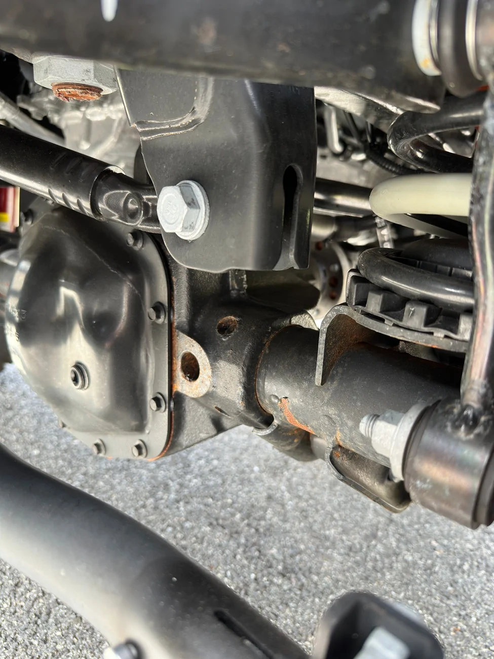

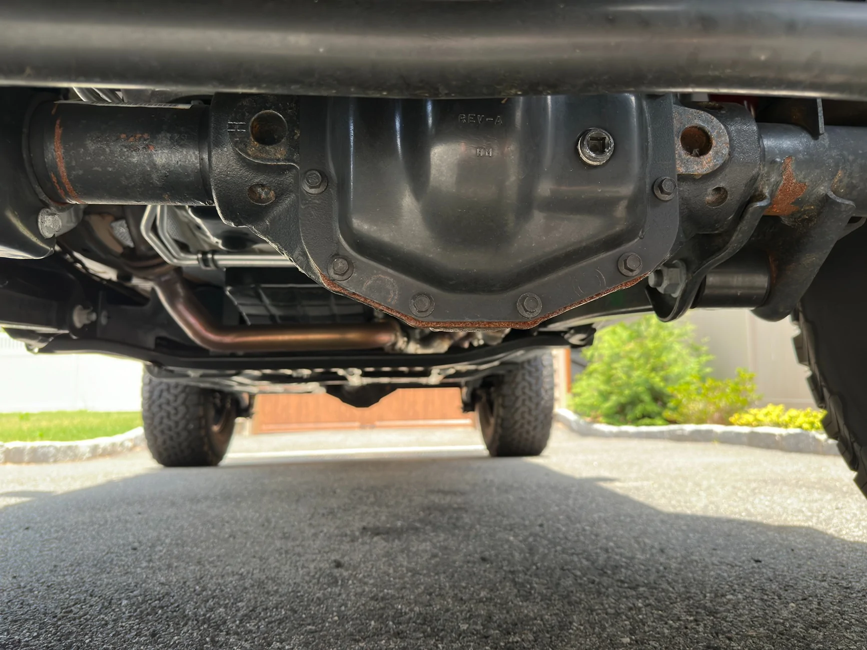

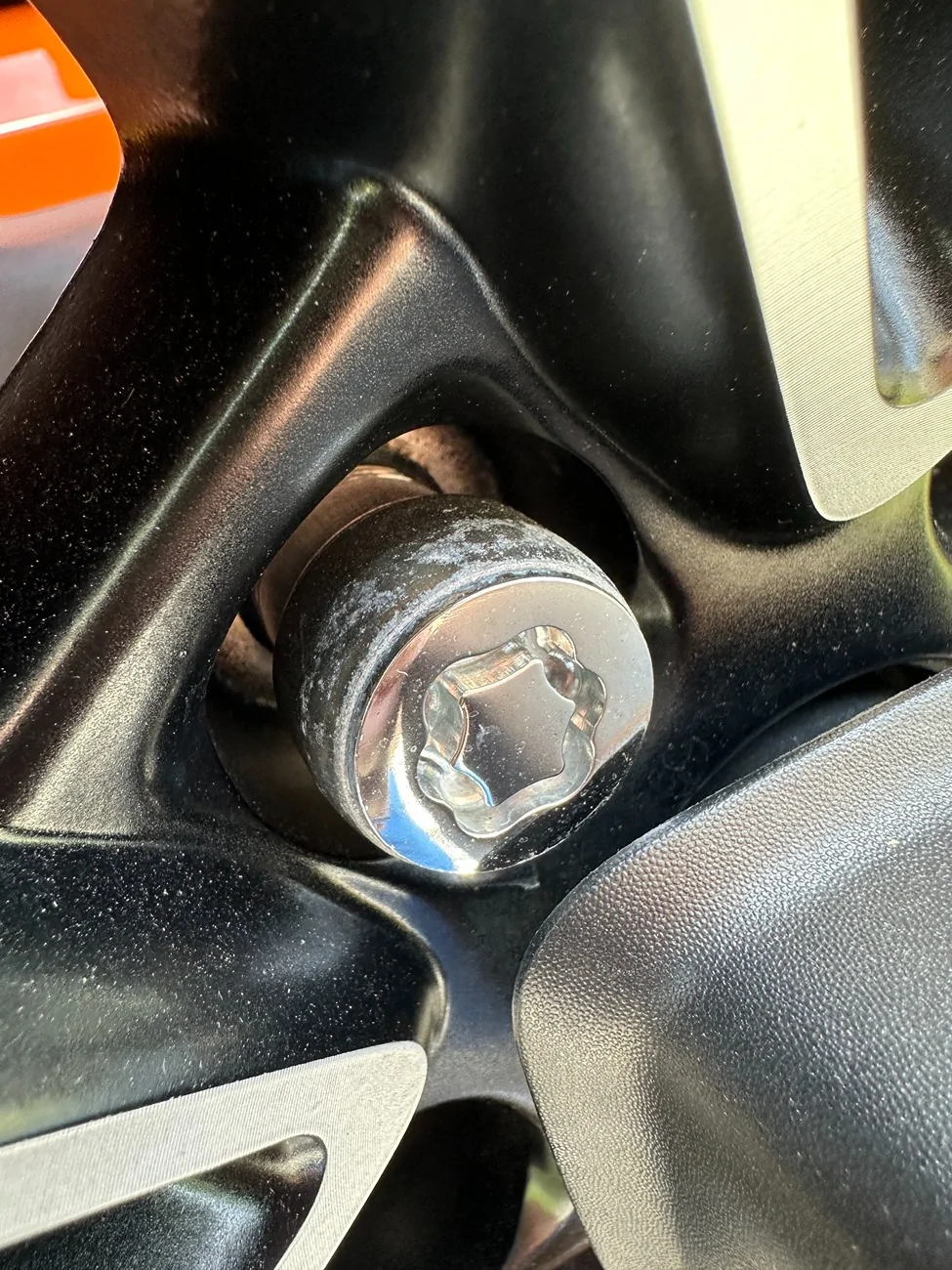

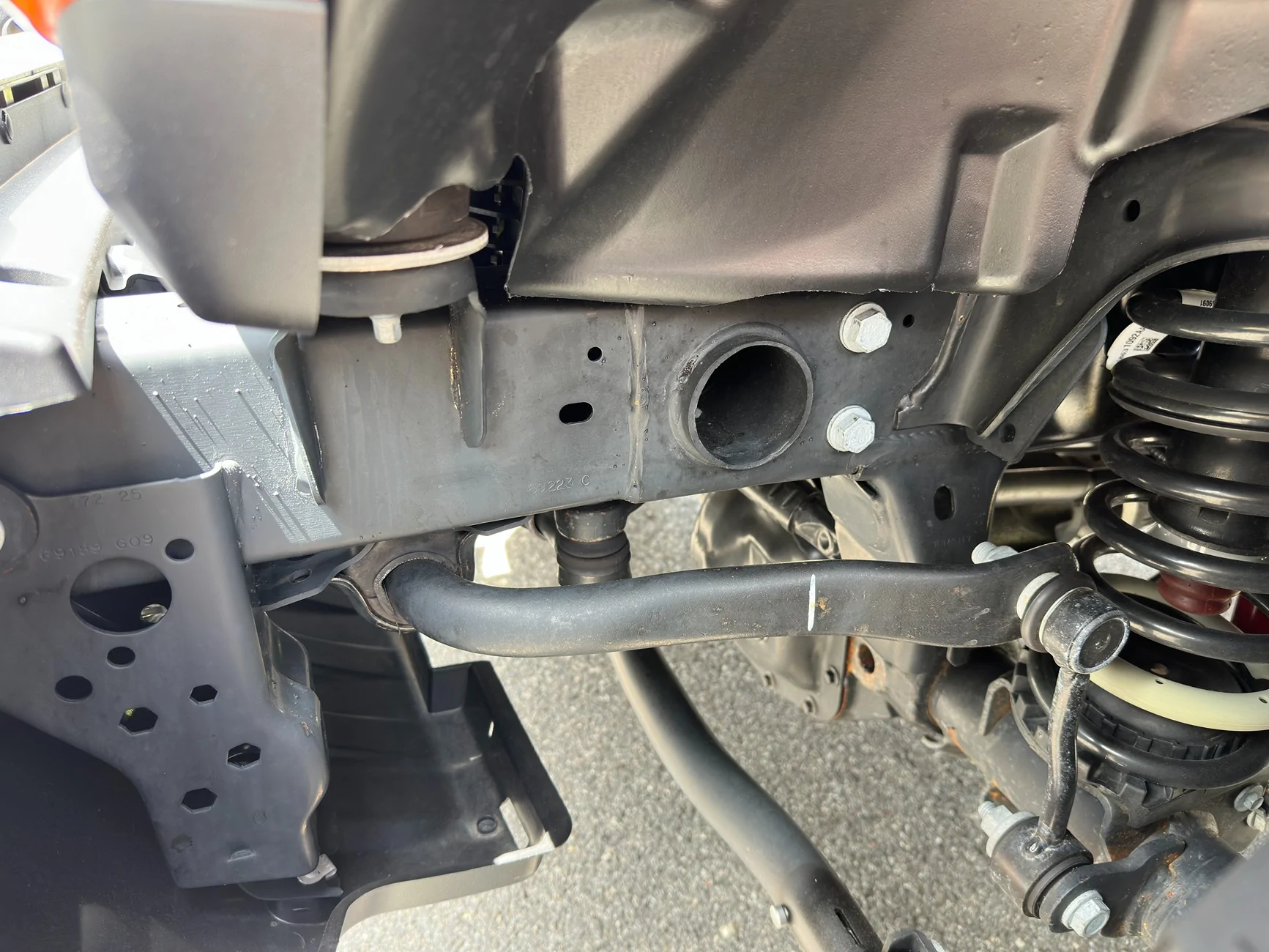

I've had my New 2025 JLU Willys XR for about 9 months now, and after looking underneath recently, I discovered some rust starting to form mostly on the axles. I also noticed some corrosion on both the locking lug nuts and the protection ring screws on the Wheels. I can also see that the frame and suspension components are starting to look grey and slightly chalky.
Should I be concerned about any of this? if it's not anything to worry about than that's fine. If you have any tips to "fix" some of these issues, I would appreciate it. I have attached pictures of everything I mentioned. Thanks.

Completely normal. If in the northern or salt belt have it oil sprayed and you're good to go.

Not yet. Unfortunately, they're just going to keep growing and spreading.
Start spraying Surface Shield or Fluid Film every year. Properly done, that'll prevent new rust from forming and stop the existing ones from spreading. You'll need about 8 cans for the initial application to be thorough. After that you can cut it down to about 6 cans for subsequent applications.

Not at all a problem, or out of the ordinary, on those heavy components. You can spray some rust converter on it, then wire brush it. It doesn’t have to be clean bare metal, just the powder and flakes need to be gone.
Then dilute gloss black Rustoleum, from a can, with 10% acetone. The acetone will make it dry quicker and give it a satin finish. Use a small brush to apply it. Spray paint is messy, and causes ugly overspray when used for touch up work.

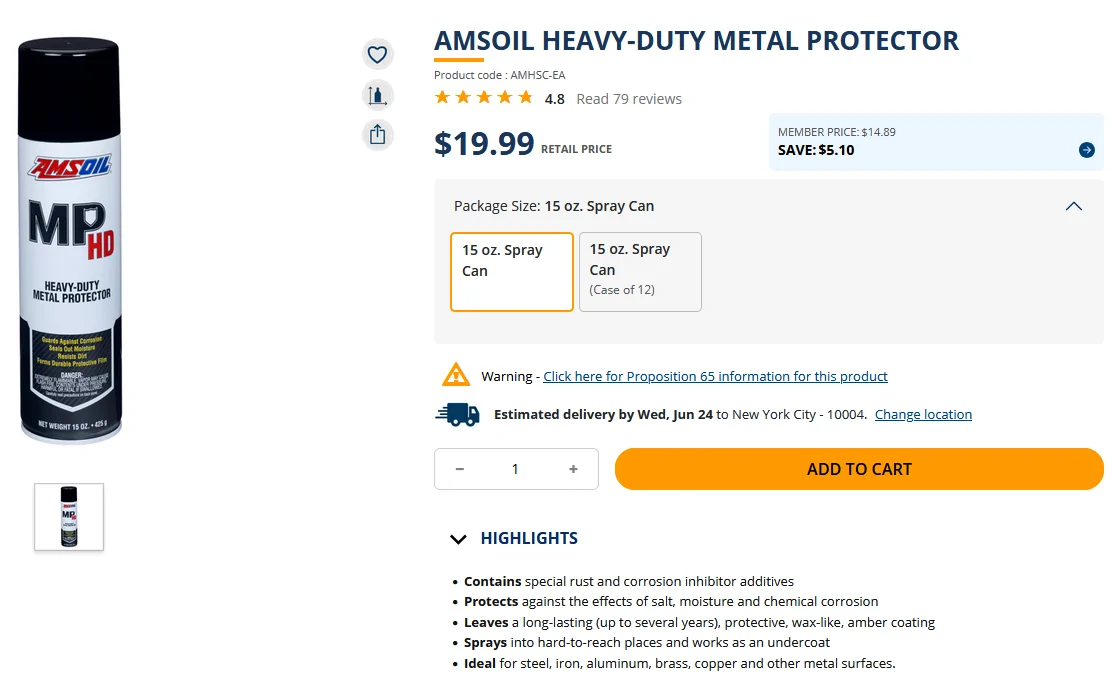

I only use AMSOIL products, do they make a similar product?

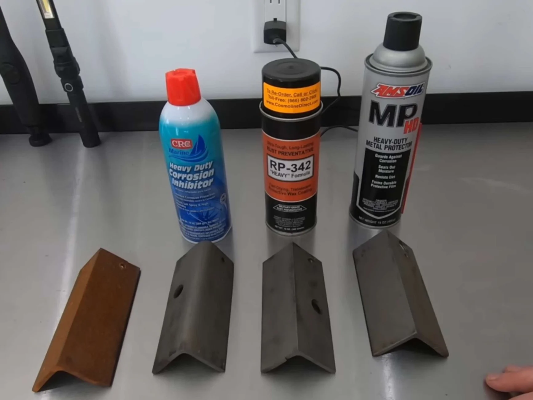

Apparently they do. It's called the HD Metal Protector. They also have the regular Metal Protector, which is more of a penetrating oil than undercoating, so you want the HD if you want to try it out.
Jeep Wrangler JL Is this Rust Concerning? 1781905321205-n
I never used it so I can't say how well it performs. But this guy did a comparison test of various undercoating:
But, ultimately, after he had the chance to try to Surface Shield once it released, he went with Surface Shield over the others:

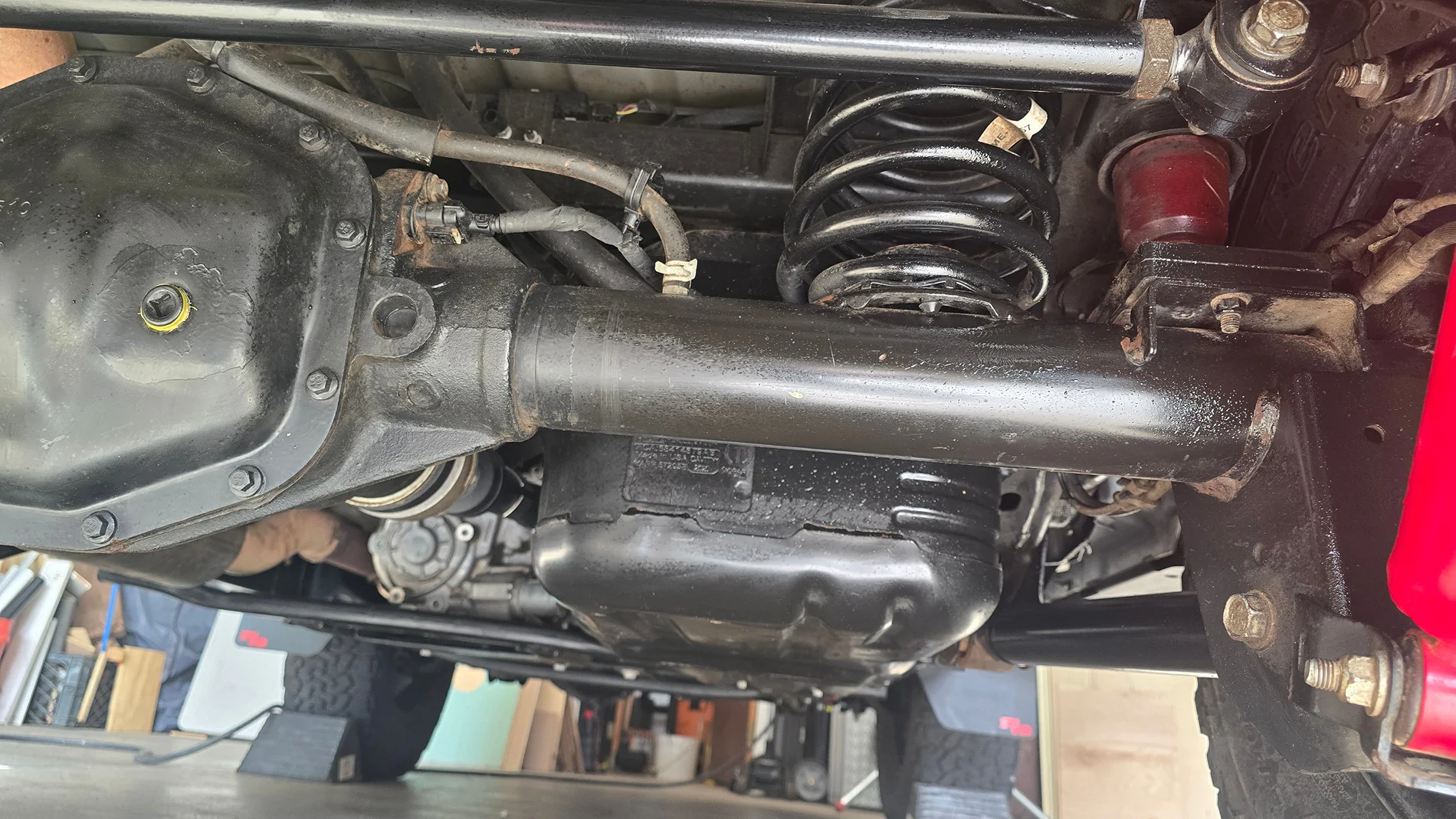

You have minimal rust. Just remove what rust you have and spray protect with CRC Marine. Our 2018 JLUR is used primarily to go to ski resort roads sprayed with brine. The only areas that need touch-ups are areas where rocks and road debris have removed the product. This product is awesome and requires almost zero maintenance over 8 years.
https://www.jlwranglerforums.com/forum/threads/jeep-jl-underbody-rust-prevention.81479/
Jeep Wrangler JL Is this Rust Concerning? IMG_7557

This sounds great! Will the CRC Marine give it any like new appearance aswell?
