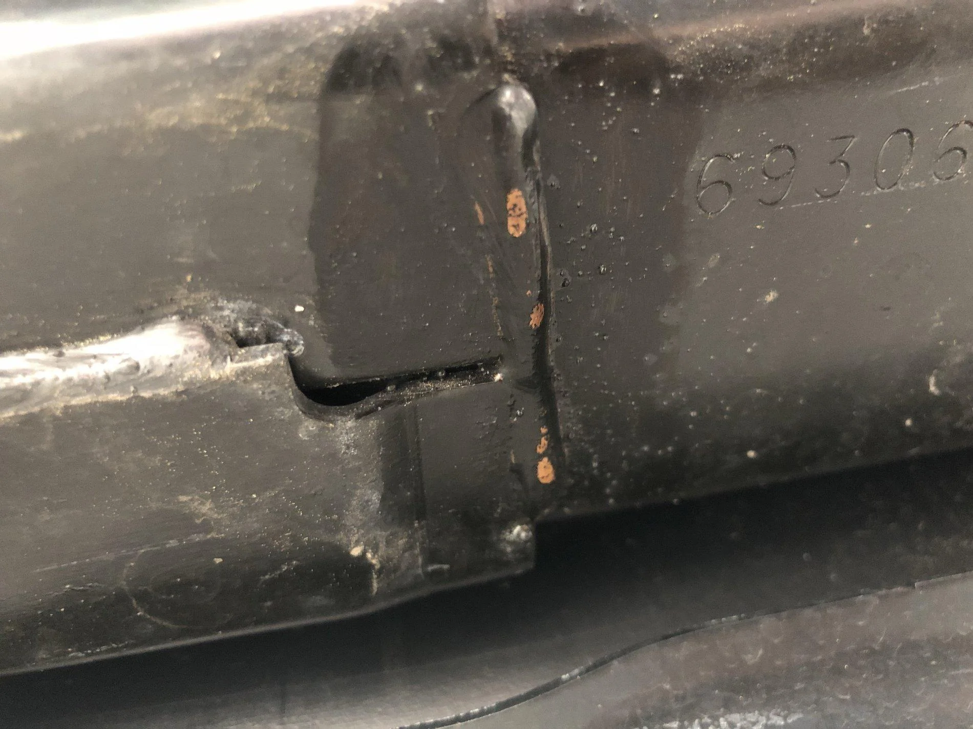

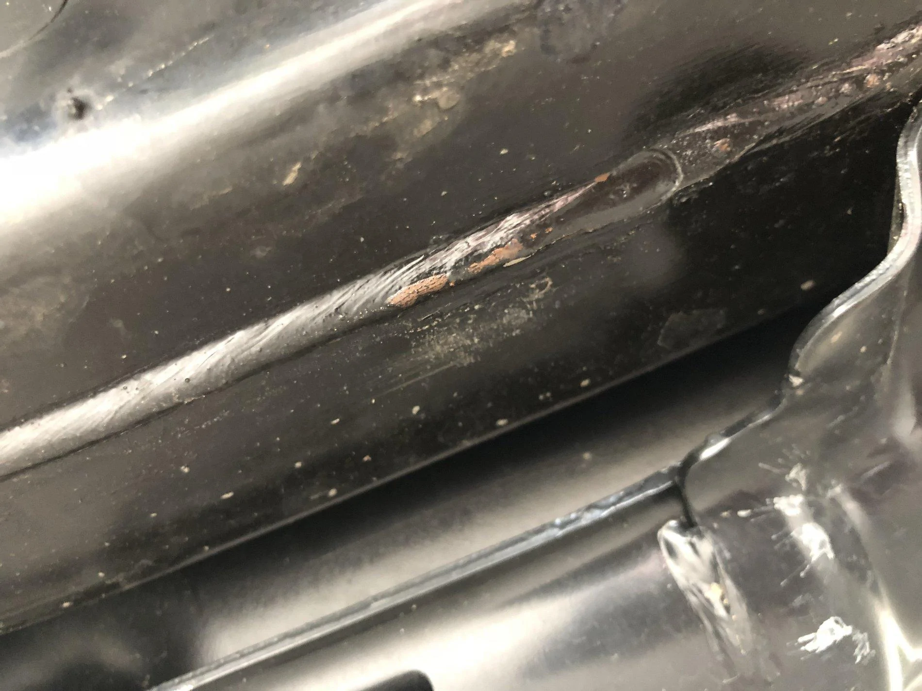

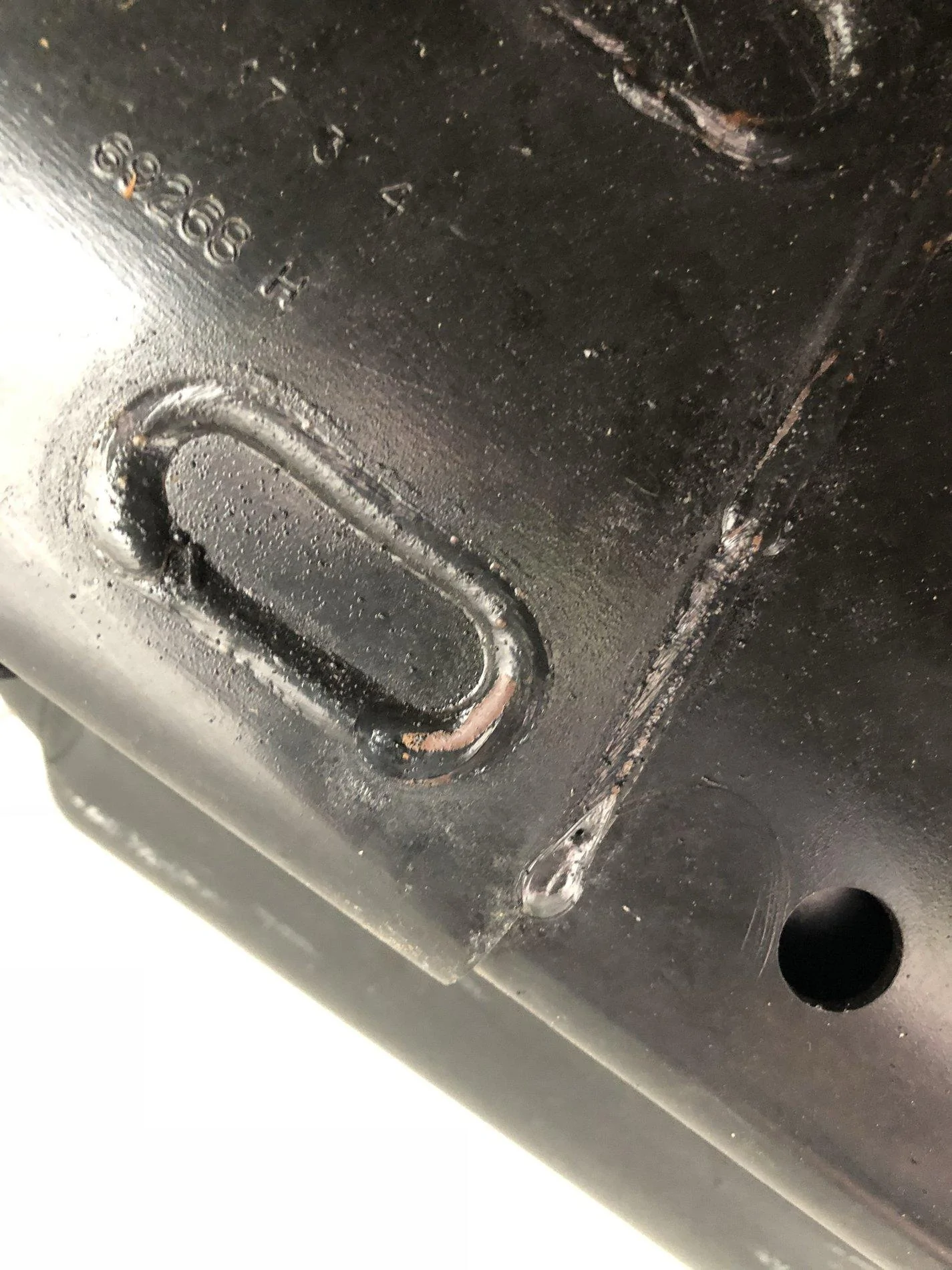

GMAW doesn't produce slag. That's kind of the whole point of it. And yes OP, your welds are oxidizing (rusting) like all the rest of us.
So no flux is used for the frame welds to cause slag?GMAW doesn't produce slag. That's kind of the whole point of it. And yes OP, your welds are oxidizing (rusting) like all the rest of us.
No flux is used with gas shielding. Rusting welds seems to be "normal" on JLs, but I wouldn't call it normal in the car industry as a whole.So no flux is used for the frame welds to cause slag?
Is this rusting normal and nothing to worry about?
Looks like a buildup of silicon slag, normal in GMAW process, even with shielding gas. is it a reason to be concerned, no. Could you touch up with a rust preventive paint, sure you could.
You keep saying "silicon slag". I've never heard of that in GMAW. I'm no journyman welder so please post me some links where I can read about this phenomenon in GMAW.Looks like a buildup of silicon slag, normal in GMAW process, even with shielding gas. is it a reason to be concerned, no. Could you touch up with a rust preventive paint, sure you could.
Here’s a link that discusses silicon content in the base metal and wire.You keep saying "silicon slag". I've never heard of that in GMAW. I'm no journyman welder so please post me some links where I can read about this phenomenon in GMAW.
