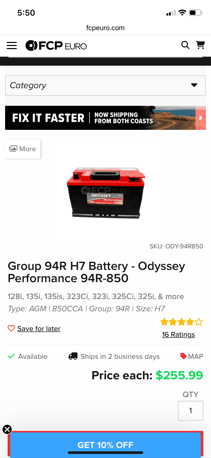

Napa sells Odyssey and is currently 20% off, H7 should be around $270.

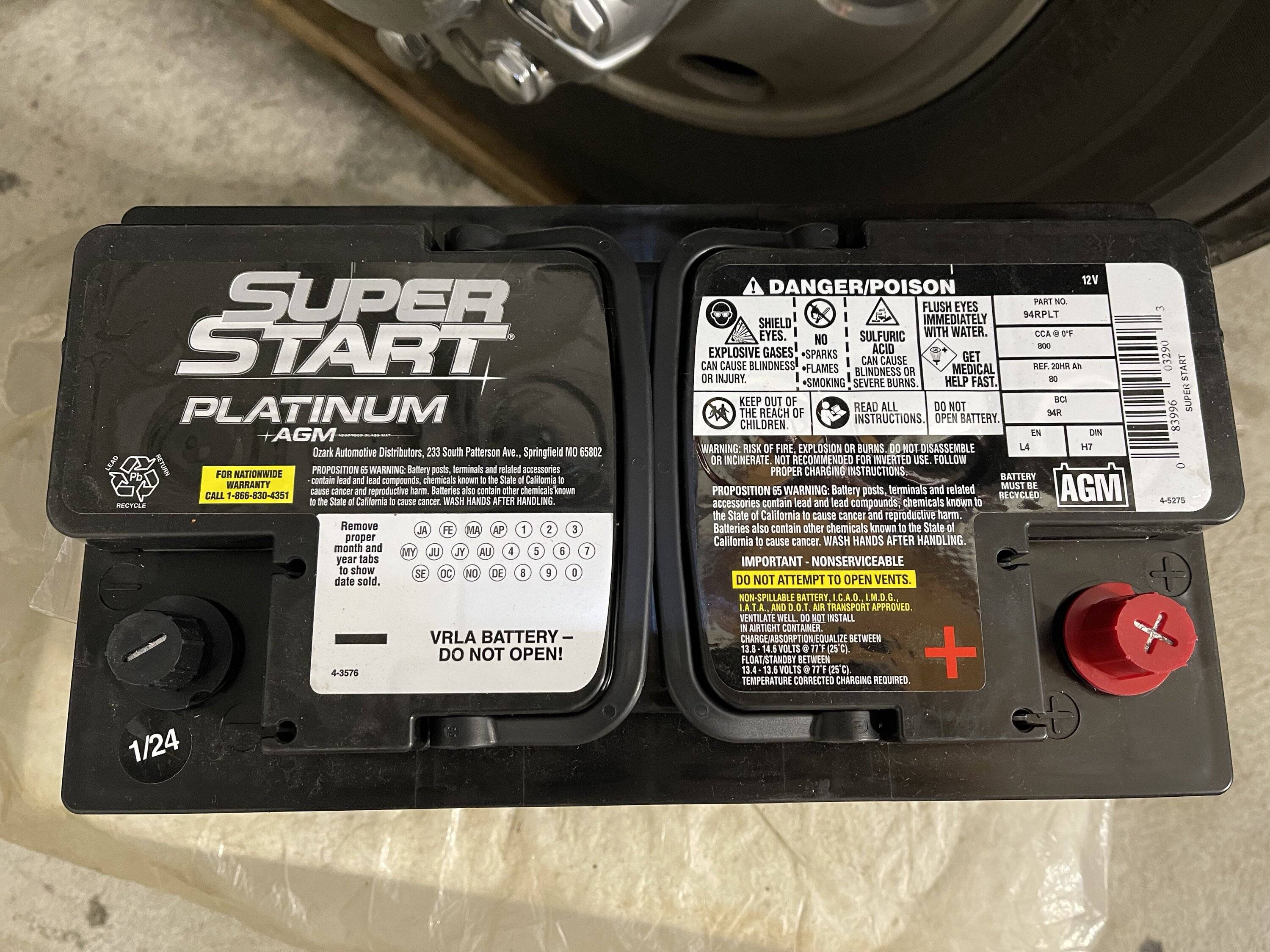

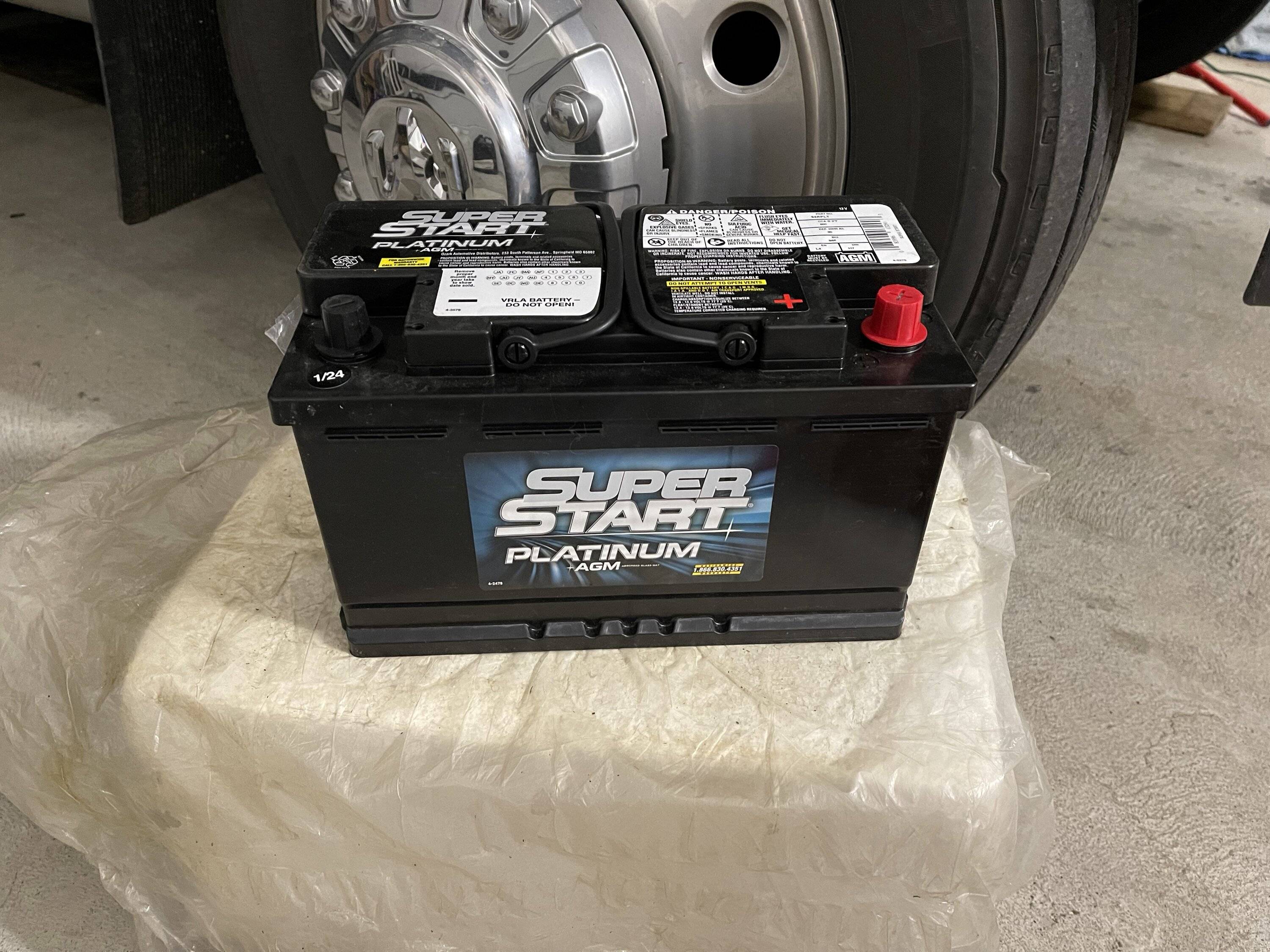

If you want another Deka that will last 5 years or more, go to O'Rielly's and get a Super Start (made by Deka) to replace it with.
Super Starts are my go-to battery choice for most all my vehicles, especially my past and current RAM / Cummins equipped trucks.
Just recently bought two for my 2022 RAM 5500 Cab & Chassis.
Gotta love buying’em two at a time.
Lots of O’Reilly Auto Parts stores around if an issue does arise.
