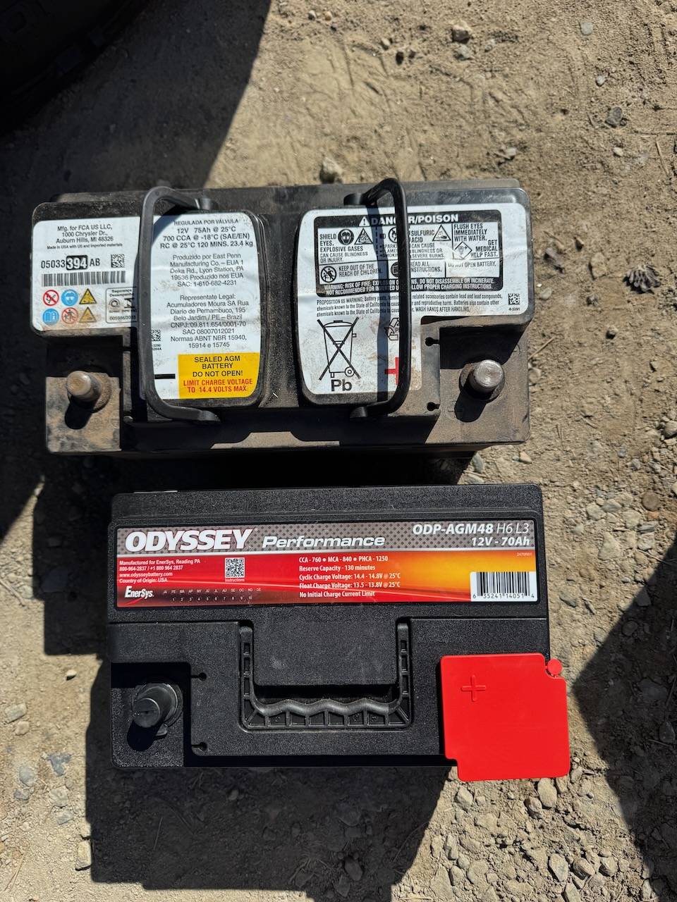

I'm going to go out on a limb here and say that this thread may be focusing on the wrong problem.
Yes, no argument, your vehicle came with a slightly larger than H6 size H7 battery, and by all means I'd recommend that anyone, when replacing their JL battery, H6 or H7 originally, acquire an H7 size one, especially a JL owner who's packages found them outfitted with an H7 originally, including those JLs that run with one or two AGM batteries.
Often this slightly larger battery is not any more expensive and why not have the extra oomph.
That said, replacing it with an H6 battery, rather than an H7, IMHO pails in severity to something that I think has been overlooked here given everyone's being incensed about where to buy a battery and the idea of (gasp) buying a slightly smaller battery than that you had. It is as follows.
It is entirely possible, not knowing the details of what inspired your new and recent battery purchase, that your Aux battery is on its way out. Connecting your new battery, H6, H7, or whatever, in parallel, as is the case in dual AGM battery JLs, to a potentially used up Aux battery can be a recipe for that new battery getting irrevocably cannibalized by that Aux battery.
I am happy to point you in the direction, permanently or temporarily, of how to bypass that Aux battery, but if you want to operate with both batteries you would be wise to, at the very least have that Aux battery load tested before hooking it up to the new main battery.
I'm also happy to guide you in where to hook up a load (not multimeter) tester to test only that Aux battery, not both batteries in composite: which can hide deficiencies in one battery alone.
If you haven't already, refrain from introducing that new battery until potential issues with your Aux have been addressed.

I see, I think I will just also replace the aux battery as well. Thank you for pointing this out.

Well I bought an AUX14 battery from Napa, removed the battery again, and disassembled the power distribution center to find.... there was no aux battery. smh.
Upon further research, eTorch models do not have an aux battery but, instead, a 48V battery located somewhere else under the car. From what I can tell that is completely separate from the main battery system and therefore is most likely not related to this whole problem.
At least I know how to disassemble the power distribution now... i guess...
I found a ODP-AGM94RH7L4 at local store a few hours away so I just bit the bullet and went to get it. So now I have an H7 installed and I've learned a few lessons.

I used the Odyssey web site to order a new battery for my 2023 JL Rubicon and I ordered the one that the site said matches my vehicle. I installed it yesterday and it's smaller than the stock battery -- shorter in length. Was this the wrong battery? It seemed to be ok but I'm wondering if it being smaller will cause problems with it moving around in the designated space?
Yep, you got the wrong battery, send it back!
