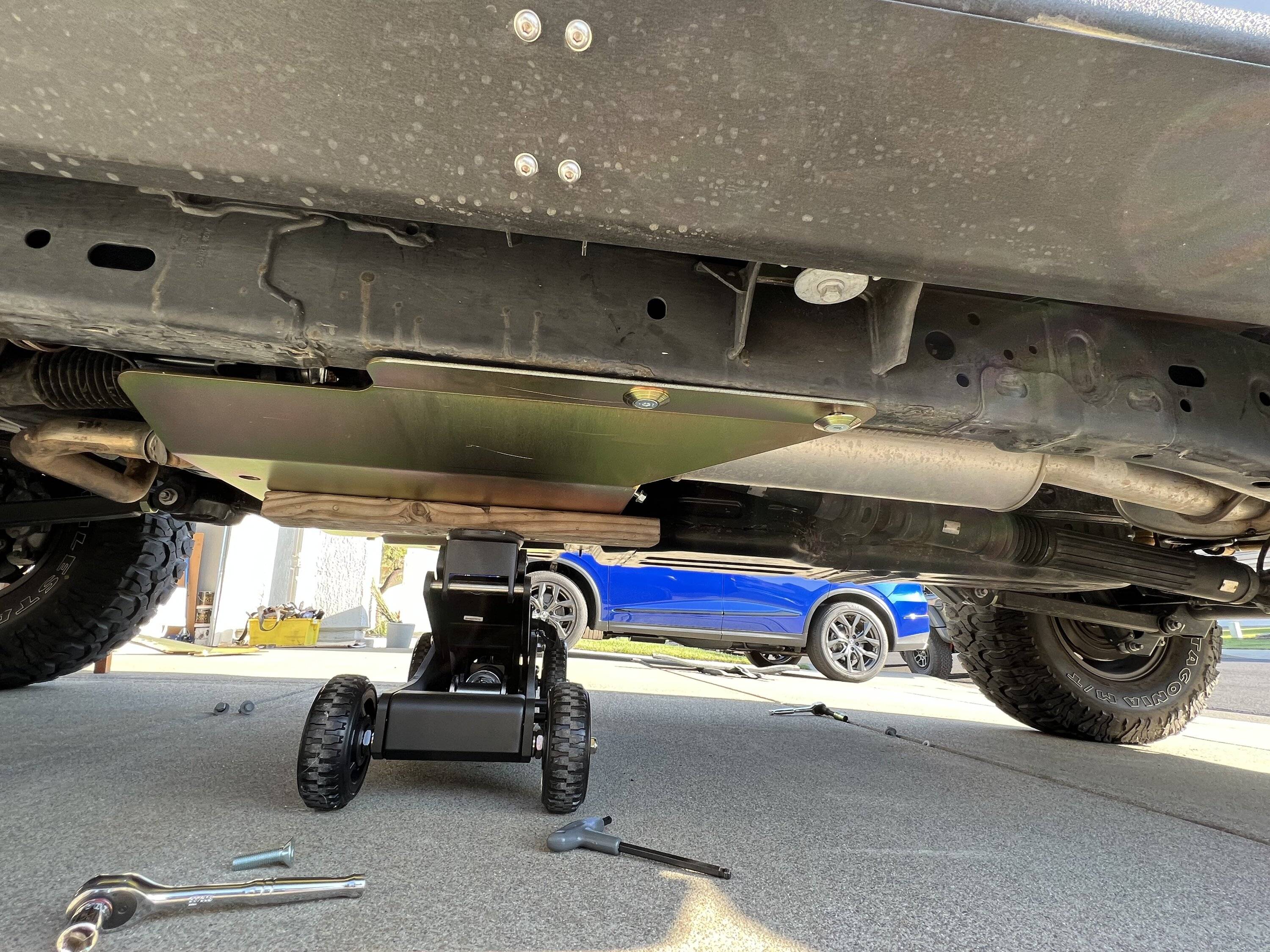

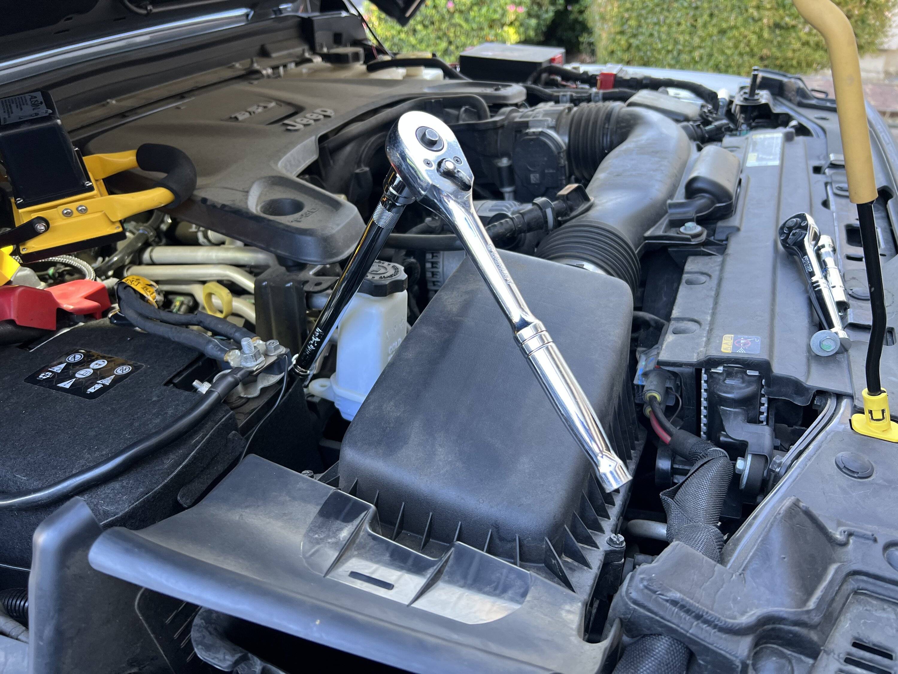

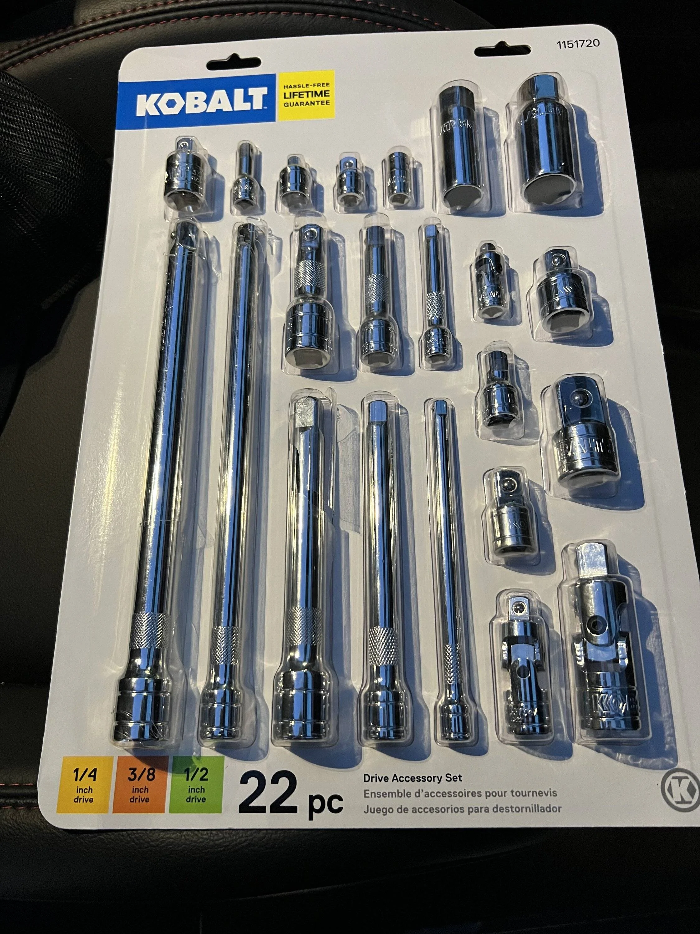

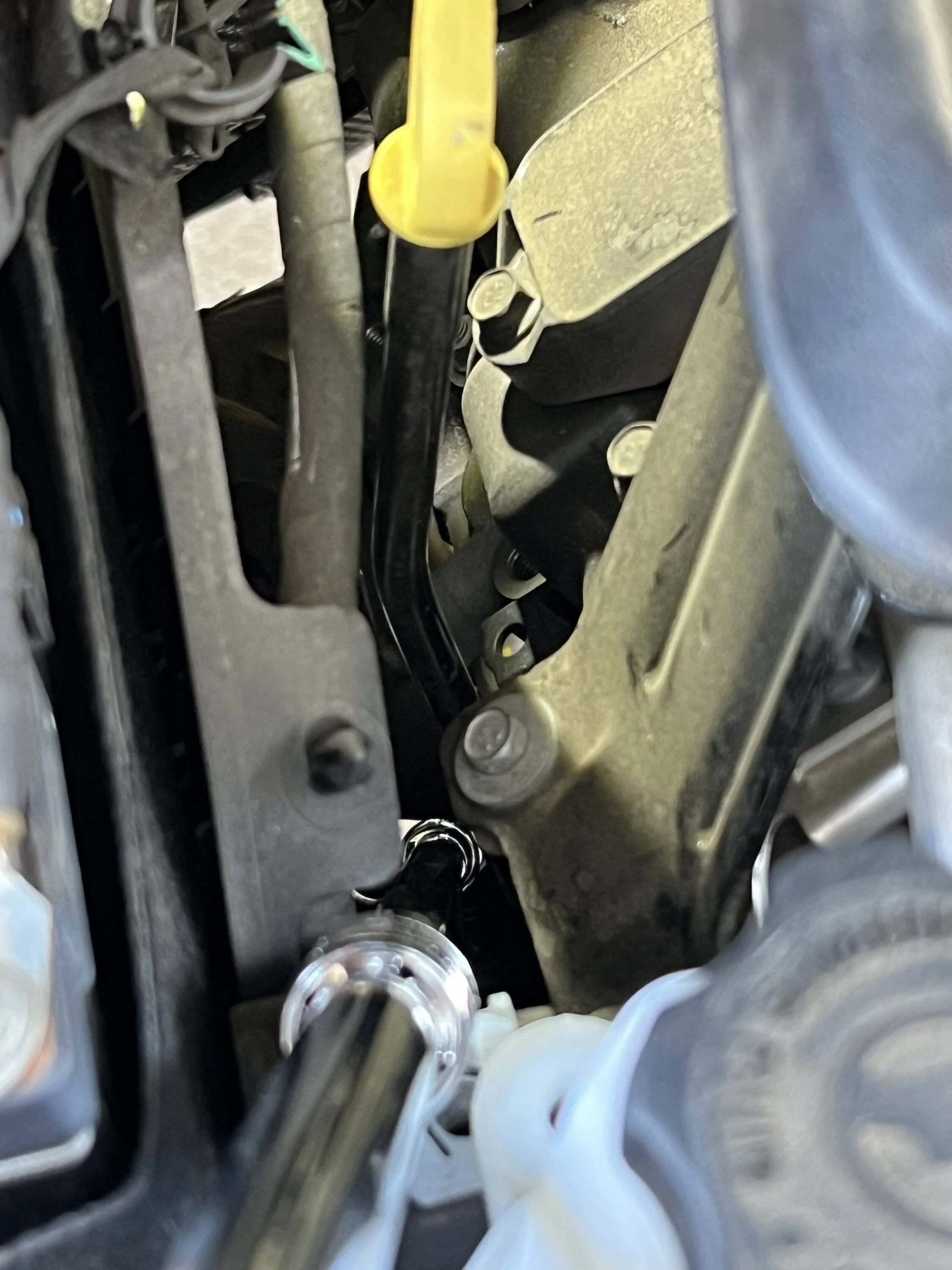

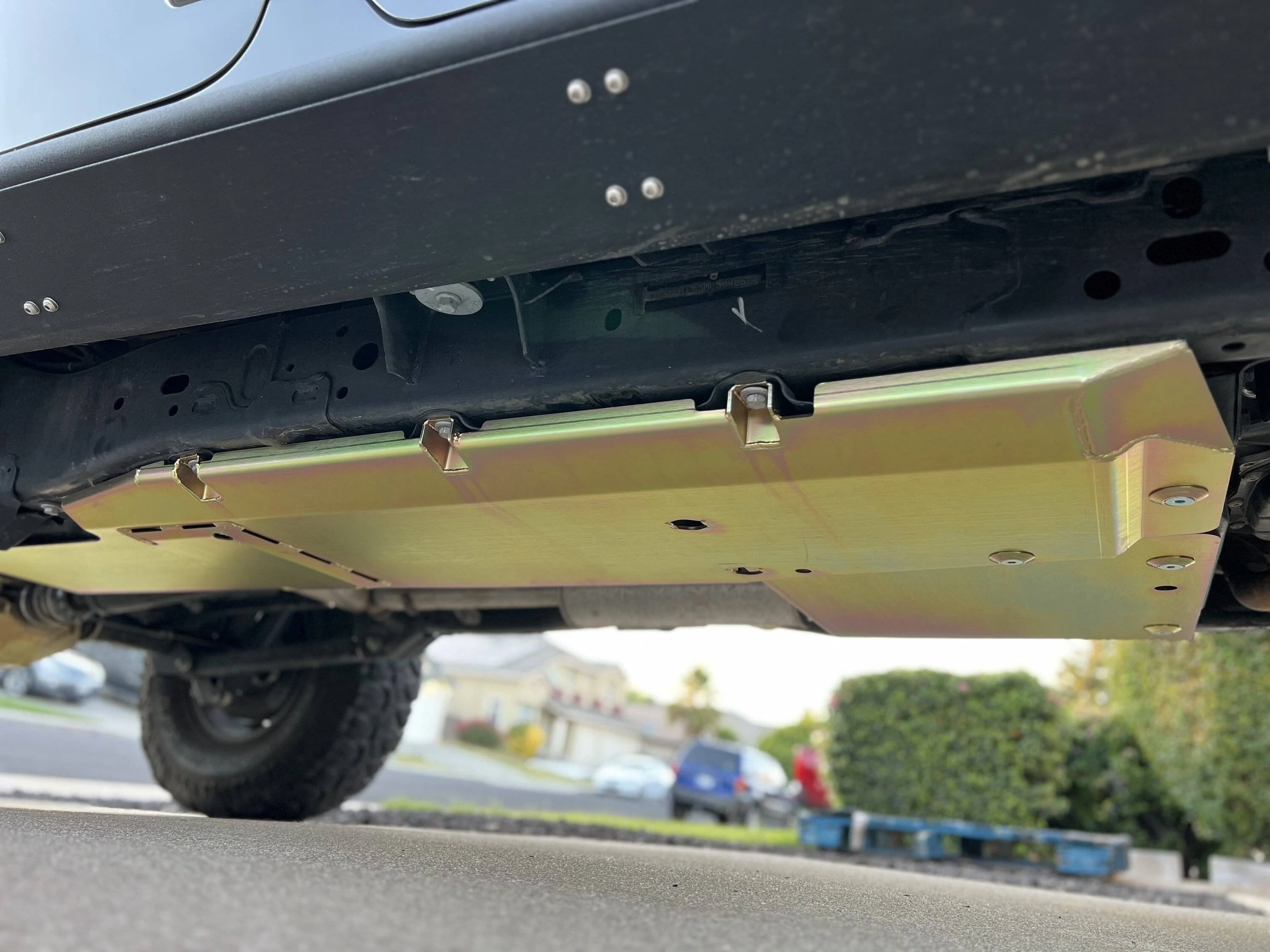

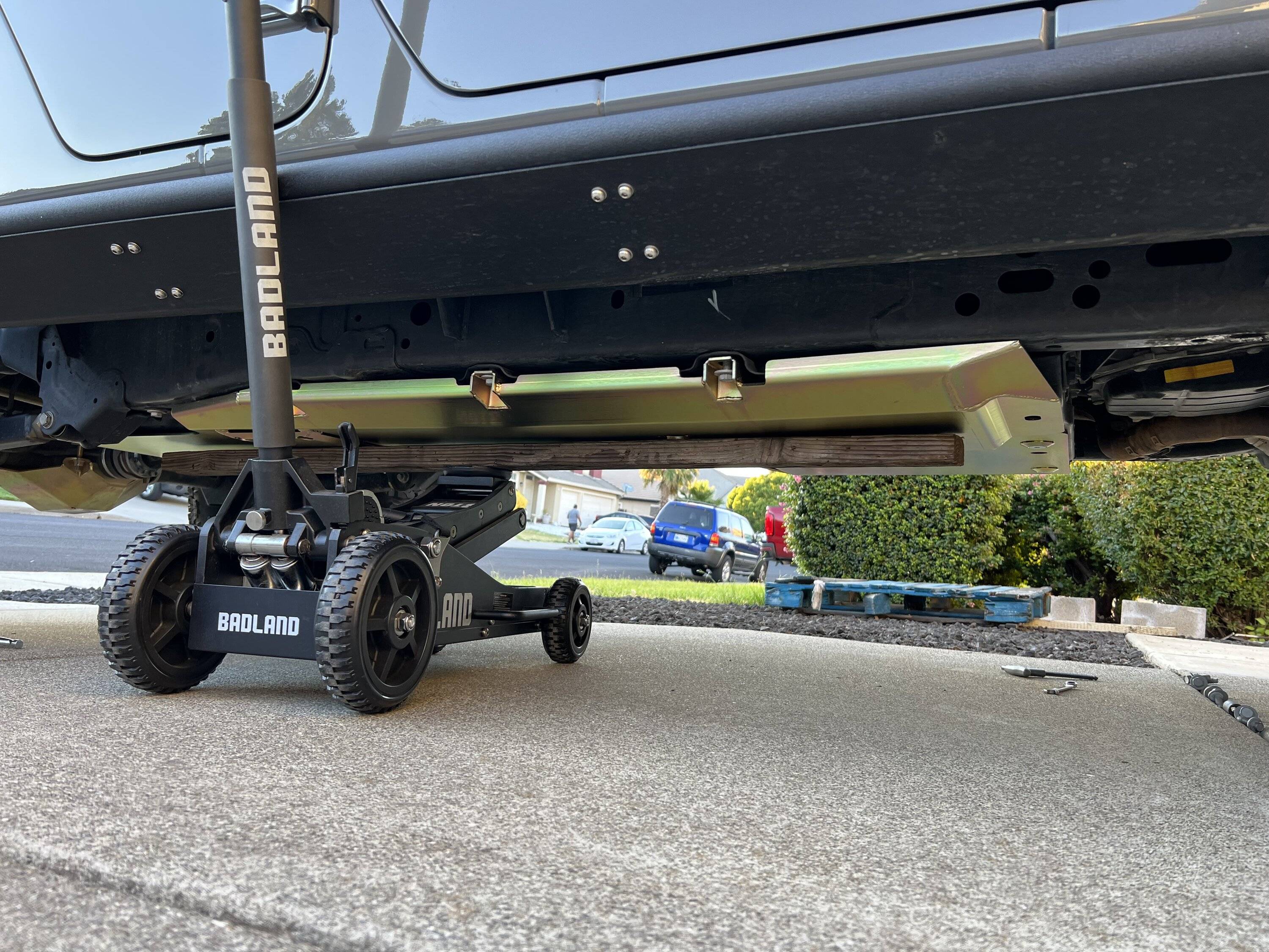

Installing the @Metalcloak skids on my Gladiator (will be adding these to the JL too for sure now). I didn’t have to drill the frame as mentioned in the instructions for the driver’s side. But I’m running Nemesis inner front liners so I’m having to wrestle at the motor mount bolts for the oil pan skid plate. I needed more extensions lol so I decided to just proceed on with the rear and getting most of the bolts secured but not tight. Went to Lowe’s and got a whole set of extensions for only $22 dollars!!!
My suggestion is just use some 2x4 wood and a jack to lift and line up the plates. There’s no sense in trying to balance the plates above you with your knees and elbows. It’s so easy to lift slowly and adjust then all the bolts go in with ease. Why do people post videos struggling to say “I did it myself without a jack. Could’ve used an extra hand”
But anyways I’ll continue in the morning.

I'm looking into these as well as other skid plates for my JL. How long did it take to receive the set?
RARCAR12
Robert
Jan 10, 2023
2020JLUR
I always wonder that too use tools and the job goes easy did it myself used the same method took a couple hours at best. Delivery time was my only complaint as it took about 5-5 weeks but we’ll worth the money IMO
If I had plastic liners it would’ve gone so much faster that’s for sure! If any one is remotely thinking of liners in the future, spend $5.00 and get the longer bolts now. If you ever have your liners off you’ll be ready for just about any brand of skids

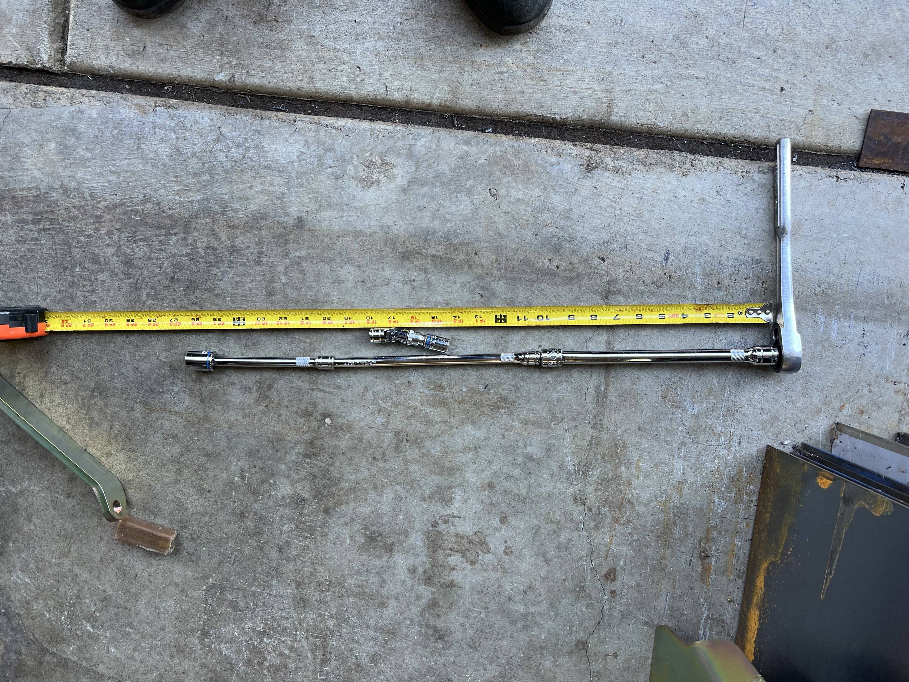

26” of extensions. And couple swivels for the passenger side. I finished the driver’s, lots of clearance from the top. Passenger side tricky, one more bolt to go but swivels joints have that one section that’s binds by nature and it causes the assembly to jump off. This is where a another hand under holding the socket will come in

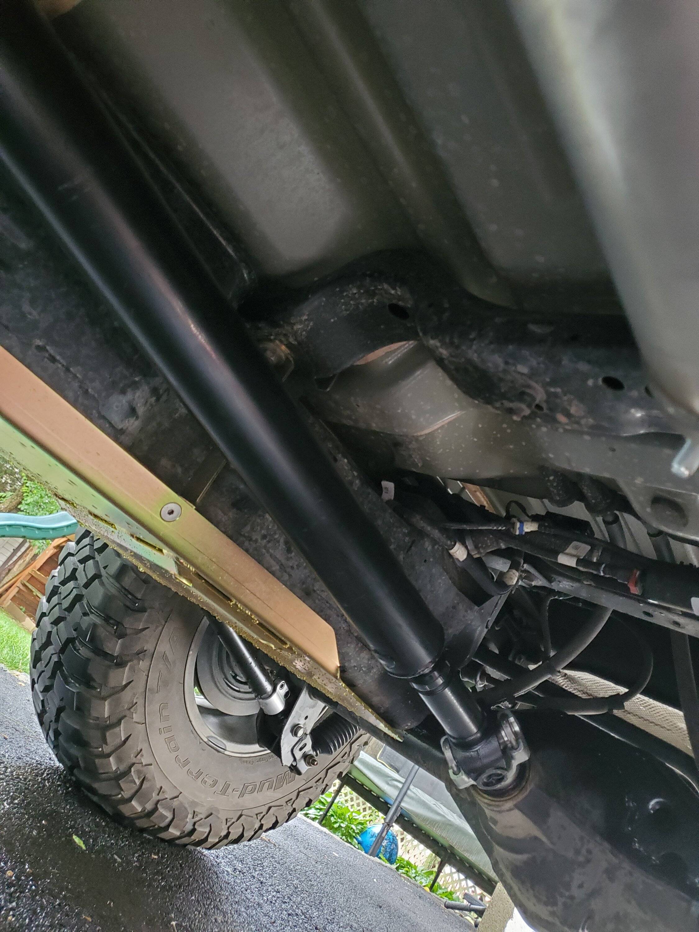

Sanity check: This does not remove the factory gas skid plate, just puts the new one over (below) the old one? I noticed the (pricey) Al kits replace the stock gas skid to gain a little more clearance; how much does this one cost in ground clearance?
Rubi6mt
Feb 14, 2021
745
1,443
Nj
2021 JLUR 6mt
Practically nothing in real world use
