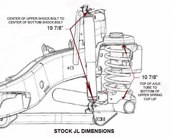

Hi all,
I just purchased a 2018 JL with upgraded suspension and tire/wheel combo already installed. How do I figure out the height of the lift kit? The suspension is JKS/Jspec and the tires are 315/70/17 if that helps.

Measure and compare to this picture
Jeep Wrangler JL Installed Suspension Height? IMG_2719

my 2024 jlur was 11.5 and 20.5.

My 2020 Jeep rubicon wrangler recon is plus 2” on both from jl reference post.
21 7/8” and. 12 7/8” as best my eyes can tell. Plus 2” probably from mopar spring lift, stickers still on the springs. I am not sure if that was factory with recon package. I bought the vehicle used a few months ago.
