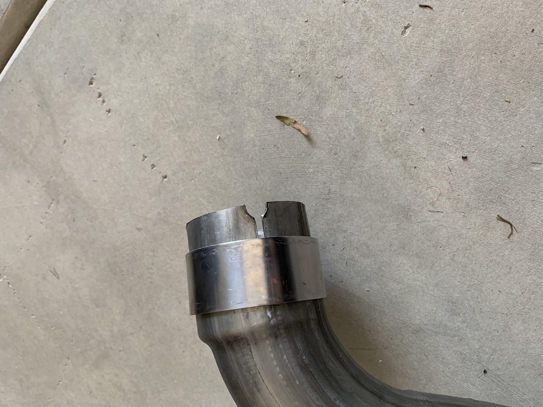

I think the pipe will help because right now the sound is reverberating off the rear. with the pipe the sound will be forced down.
It will refine the sound somewhat, due to the exit point and the extra pipe travel. I would highly recommend cutting that notch out where the pipe slips on, that location stud doesn't allow a full tight fit there, it will leak and sound a bit tinny due to that.

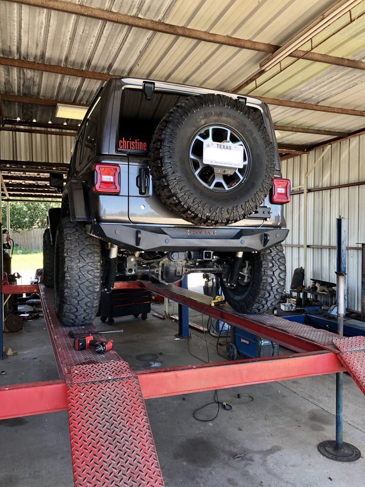

Finally got my delete pipe installed. I previously had problems installing mine after buying used. I took it in to the muffler shop, they completely cut off the small tab, expanded the delete pipe, installed it, then threw some tack welds on it to maximize the clearance on it and keep it from moving around. The drone and excessive sound is almost about gone even when mashing the pedal with the HikeIt. Definitely digging it and happy with the outcome.

Glad you are happy now. I Probably should notch mine, I probably have the small leak everyone talked about.
On a side note, how do you like that bumper? Does it seeM like it will protect better than the stock steel one?

I like it. Far superior in ground clearance and material thickness. I was a little surprised how thick the stock steel bumper was. I could see how it could land on an obstacle and tweak enough to damage the tub.
