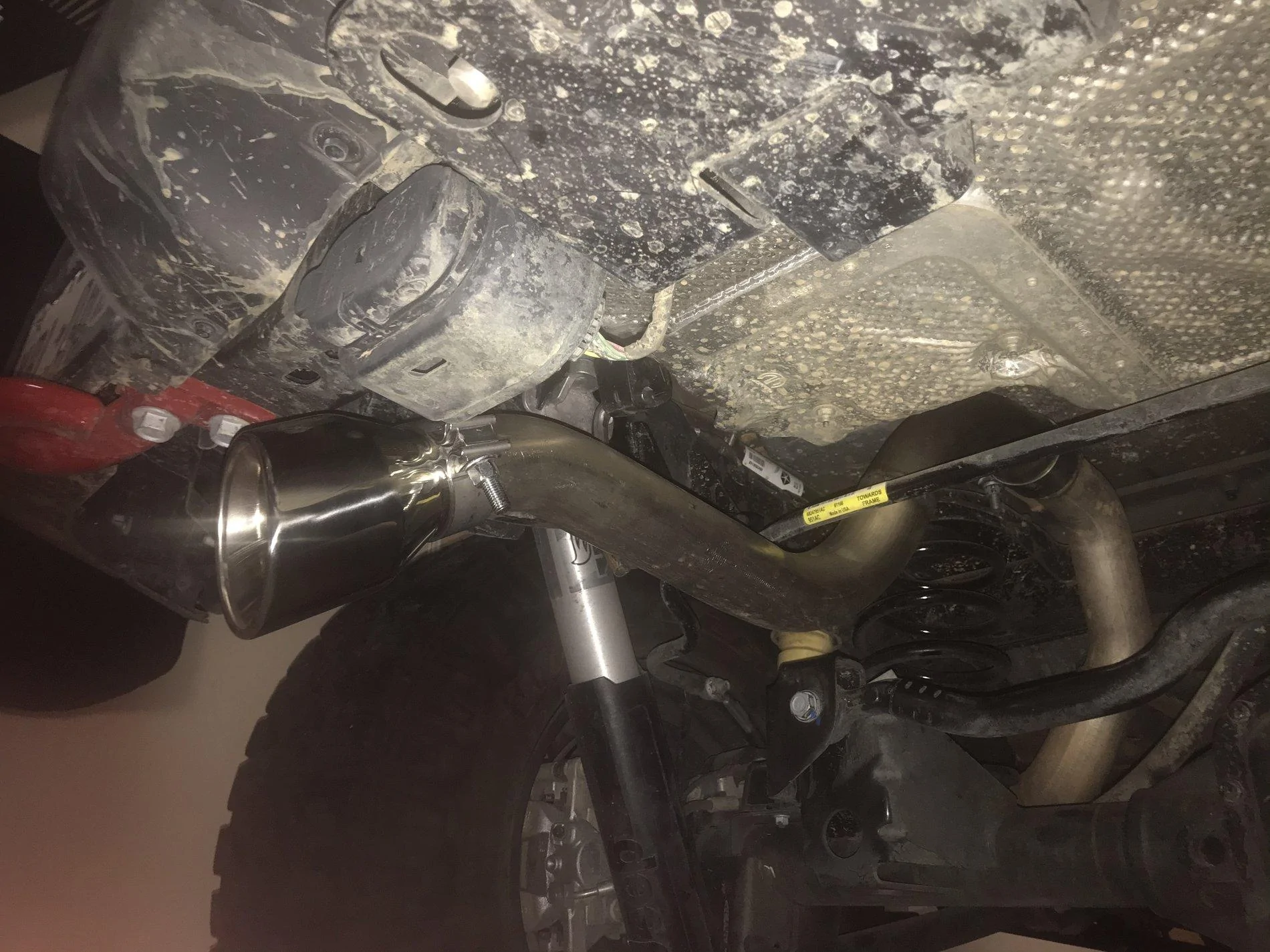

I have the Pypes version and added a resonator tip. It quieted it down somewhat and got rid of the drone. The tip has a perforated liner.

Just me or the tip installed upside down?
It is, but I figured it directed the exhaust back instead of down. I intend on painting it. Bought the cheapest one I could find as I didn’t know if it would be enough reduction of the drone for me to Keep it and the delete.
