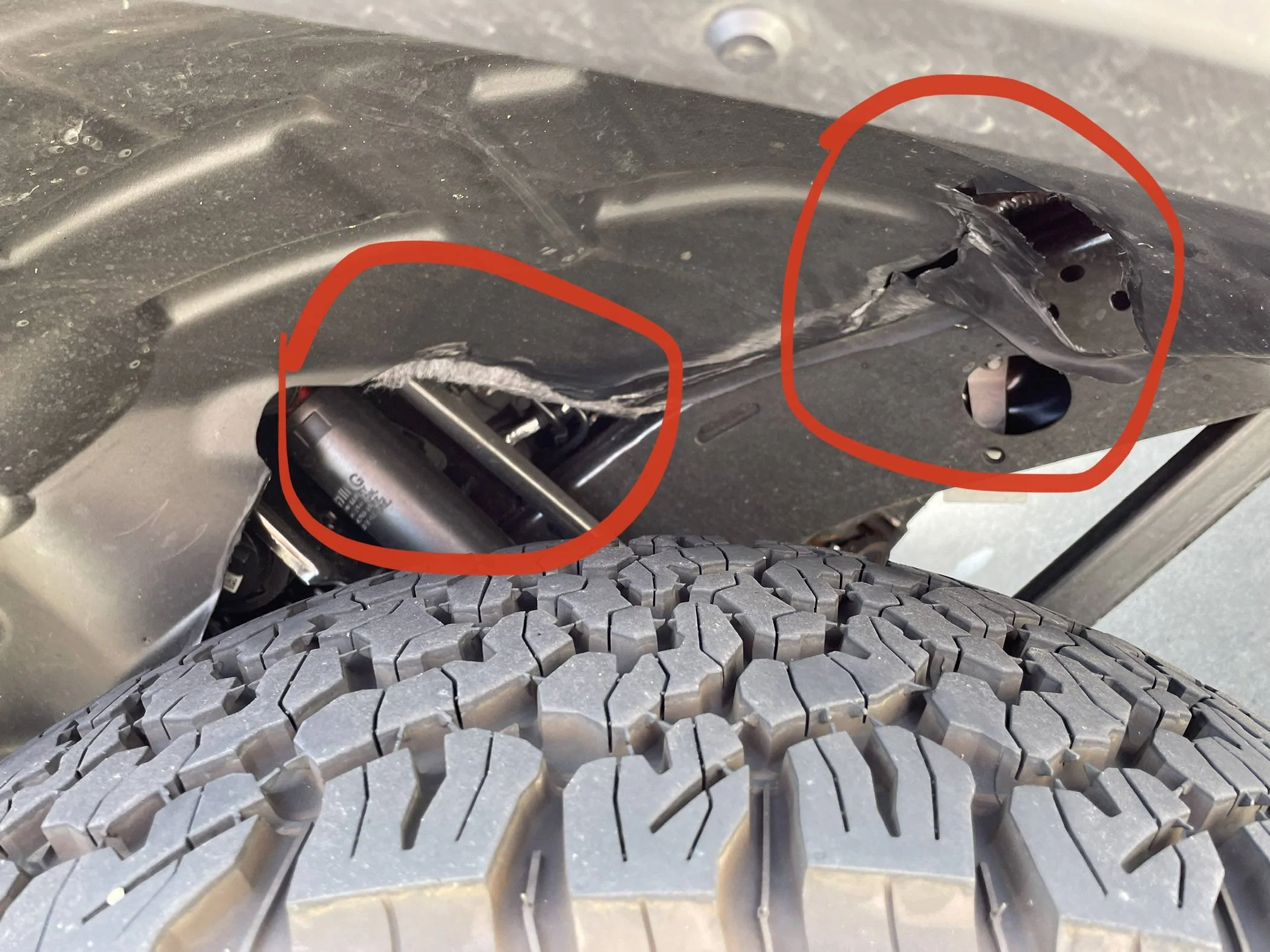

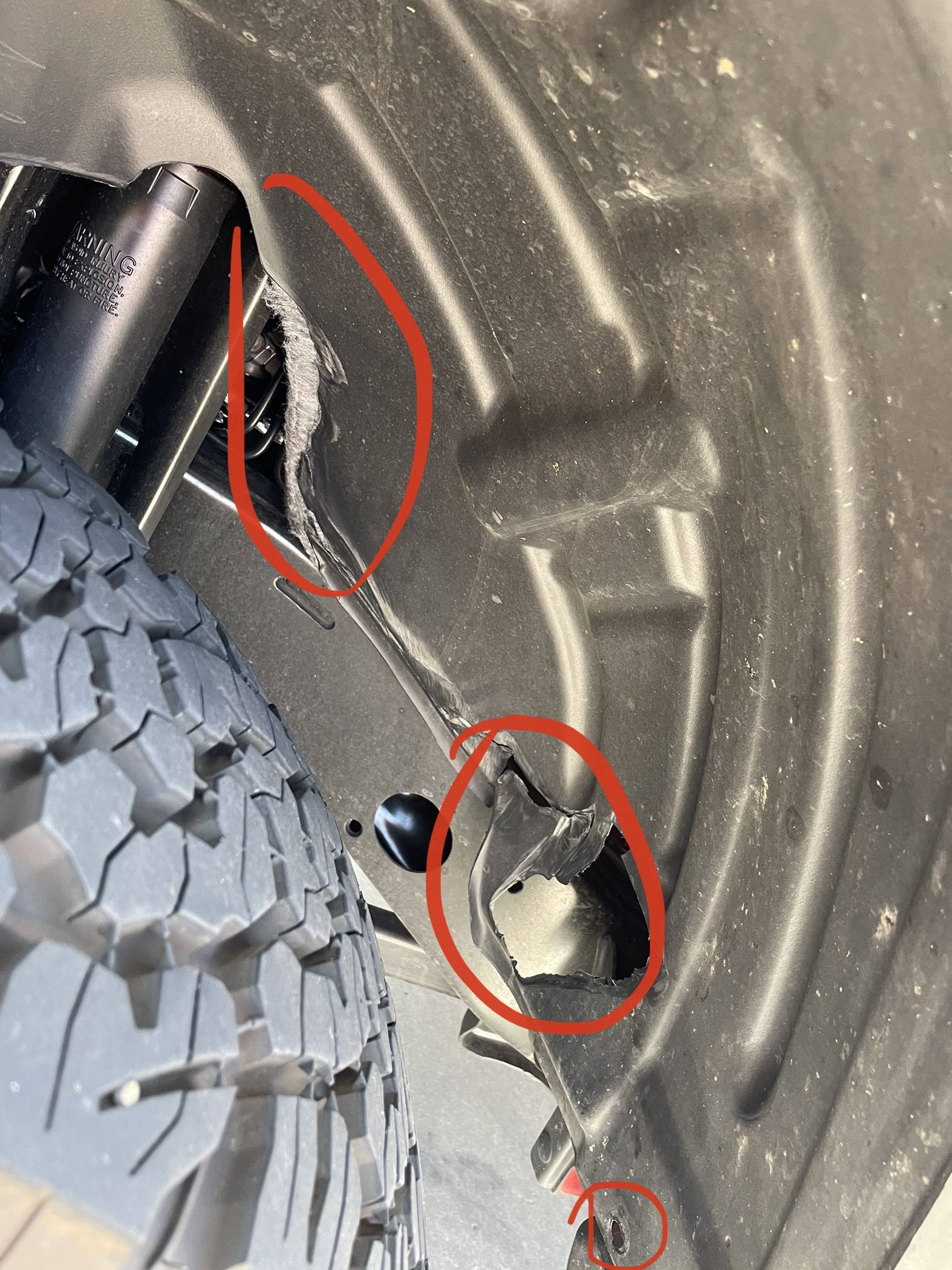

This happened to my stock 2022 JL with less than 7k miles today when driving from Dallas TX to Roswell NM, when passing the infamous wind farm, was driving around 70-75 mph, I guess it’s because the inner retainers in the lower back failed (small circle on the lower right in the 2nd pic) then allowed the liner to be blown up to contact the wheel, a big chunk was entirely rubbed off and created a big hole, the middle section was also damaged, this is frustrating because I’m on a 2-week road trip vacation from the east coast to the west coast then going back and this is only the 4th day, still have a lot ground to cover, I guess I’ll have to use some zip ties for now and go back to the dealer when the trip finishes, it’s only the driver side right now, let’s hope the passenger side survives, @JeepCares may need your help when I go to my local dealer.
I can't believe they (Jeep) haven't fixed this yet. Wait, yes I can.
Was it hot outside where you were driving? Heat will soften the plastic making them easier to be sucked out at the speeds you were driving. Same thing happened to me when driving through desert heat. I simply pulled out my knife and cut away sections until it couldn't rub any more. That plastic cuts like warm butter.
There is a video somewhere out there that shows these liners being sucked down when driving even with all the fasteners intact.
Yea, it was definitely hot like 100 degrees, I wonder if Mojave (do they have the same design?) has this issue, I mean it’s designed for high speed desert over landing right? Anyways, I’ll be pissed if the dealer says it’s not covered under warranty
I'd say the heat was definitely a factor. They are made from polypropylene which has one of the lowest melting temps of all plastics.
I didn't even bother with warranty. Drove it for months before installing aluminum inners. I don't get any rain and I avoid mud so I wasn't too worried. I kept the upper parts of the plastic fenders that shield the underside of the fenders though. After installing the aluminum fenders, I reinstalled what was left of the original and sliced away what wasn't needed any more.

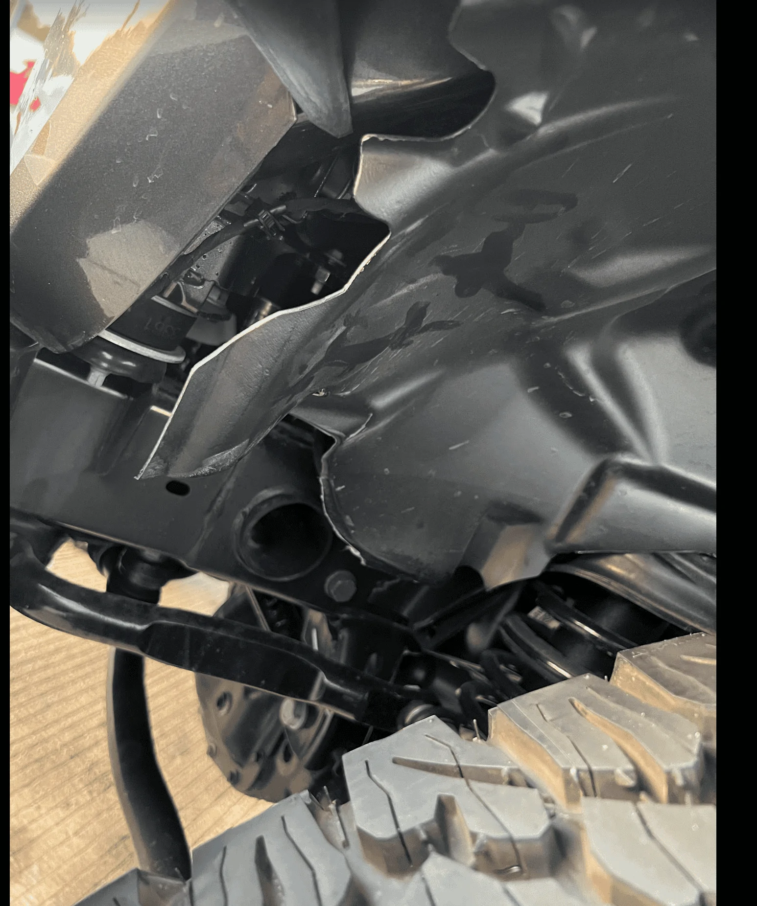

This happened to me this weekend when I picked up my brand new 2022 JLUXR driving from dealer in TN to Dallas. It started to make noise at 50 miles mark in the trip. When I got home (730 miles), a piece of it is gone. It was very annoying noise. @JeepCares is it under warranty?
