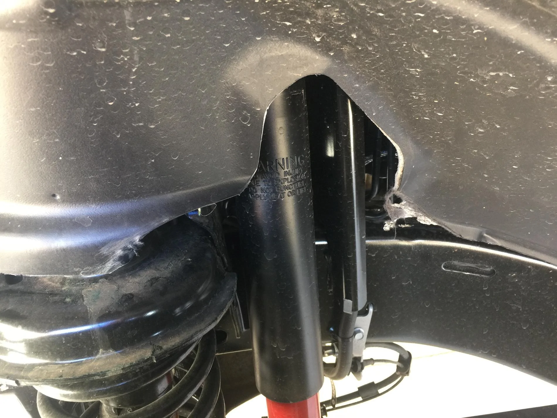

I just can't figure this one out. My Rubicon 2-door only has about 1,500 miles of moderate use. Lots of miles off pavement but nothing extreme at all. Stock suspension, tires and wheels and no big flex events. How in the world did my right fender liner get ripped up? It looks like tire rubbing did it, but I can't see how that could have happened.

You are 100% correct.. The tire rubbed through the fender liner.. Probably was not secured properly? Would have thought that you would have heard the tire rubbing....
Good luck at the dealer, should probably warranty it for you though.

A couple of weeks ago I had the same thing happen to mine, both front fender liners are ripped very similarly. Did you have any luck getting the dealer to warranty it? Mine happened on the highway at 70 into a headwind.

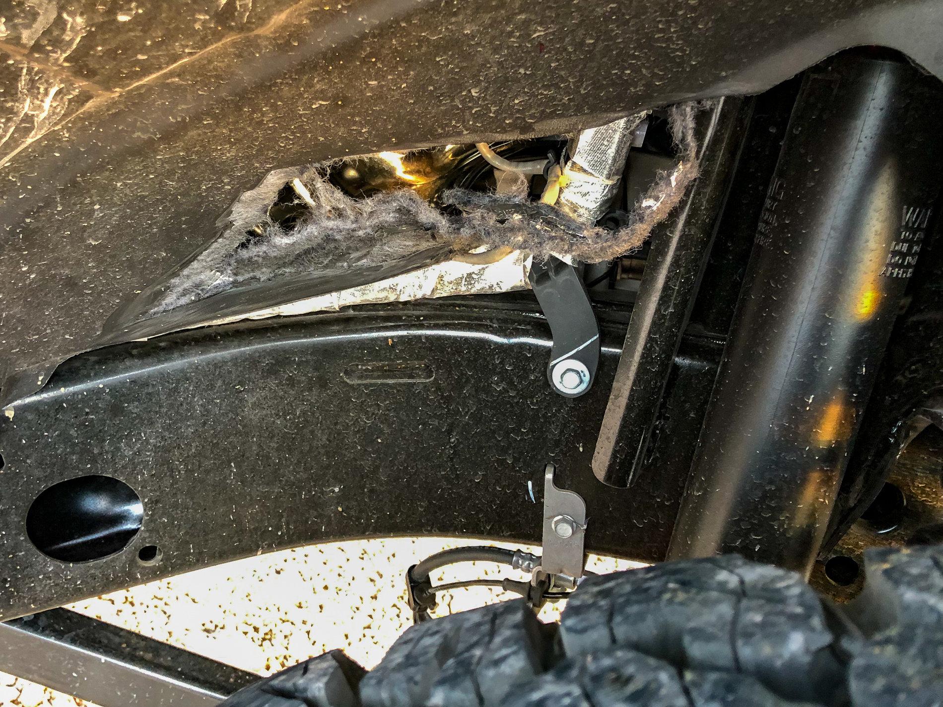

Posted in retrospect: My front left fender liner was torn by day 2 of ownership on our 2020 Rubicon. After a lot of thought, the only plausible guess was that a strong wind encountered while driving on the highway, lifted the liner into the tire.
It bothered me for a couple of days, and then I forgot to noitce it when I walked by, but it still bothers me when I am cleaning the Jeep and look into the wheel well.
Just wanted to add an experience in case anyone who can improve the design sees a trend.

Same thing happened on my Sport. Best I can tell is enough airflow causes one of the bottom retainers to come free and once free the liner "blows" into the tire at higher speeds. I could definitely hear it rubbing at freeway speeds. I drilled a hole in the (now smaller) liner and zip tied it back in place.
Edit: I strongly suspect my issue is a side affect of removing the air dam.

My right one was totally shredded after only 500 miles (JLURR new in July). I did encounter VERY heavy winds for over 100 miles. Left one is slightly frayed. Dealer said they'd never seen it, and cut it back for me. I think aftermarket is the only solution today. I am concerned about debris and water into the engine compartment.
