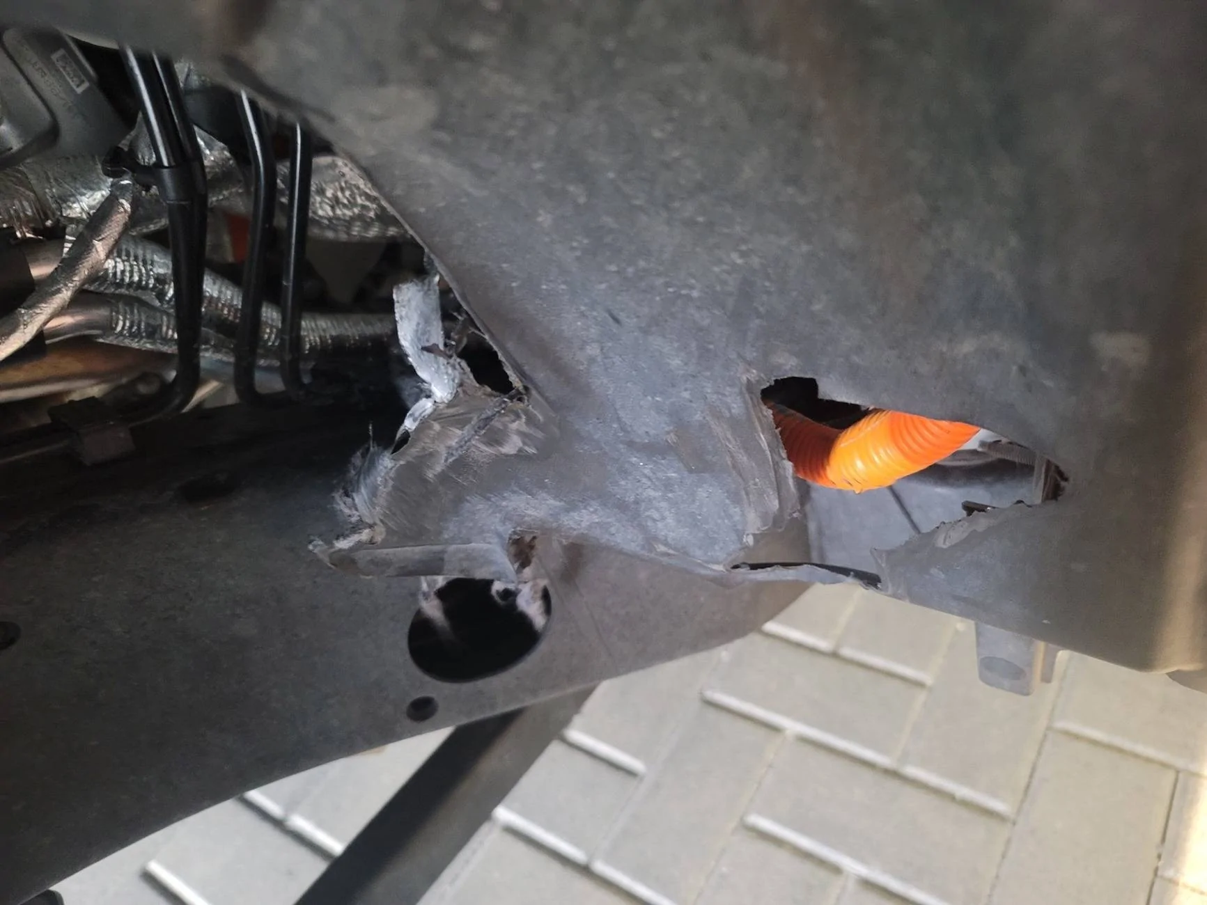

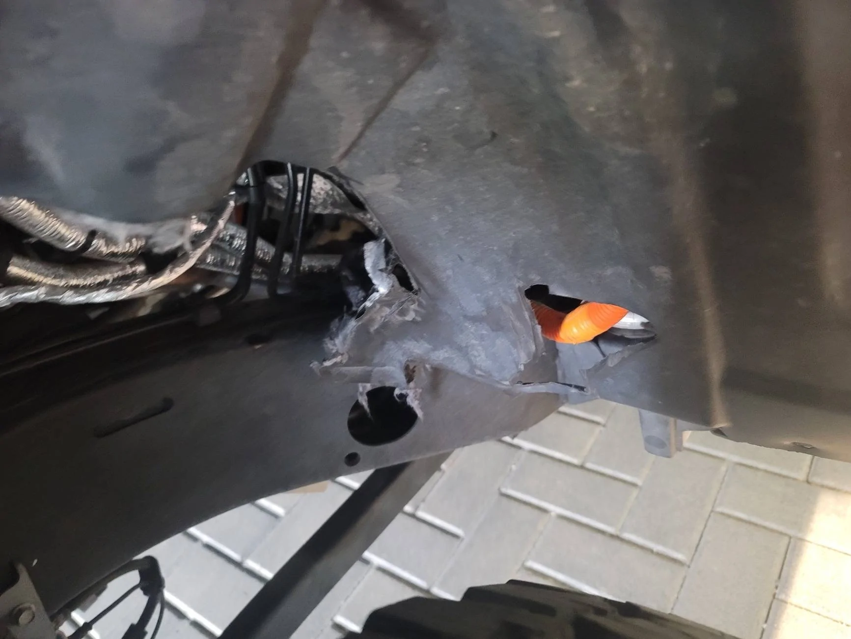

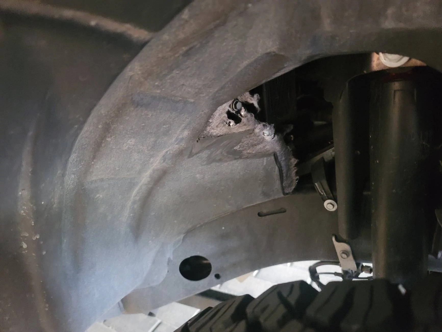

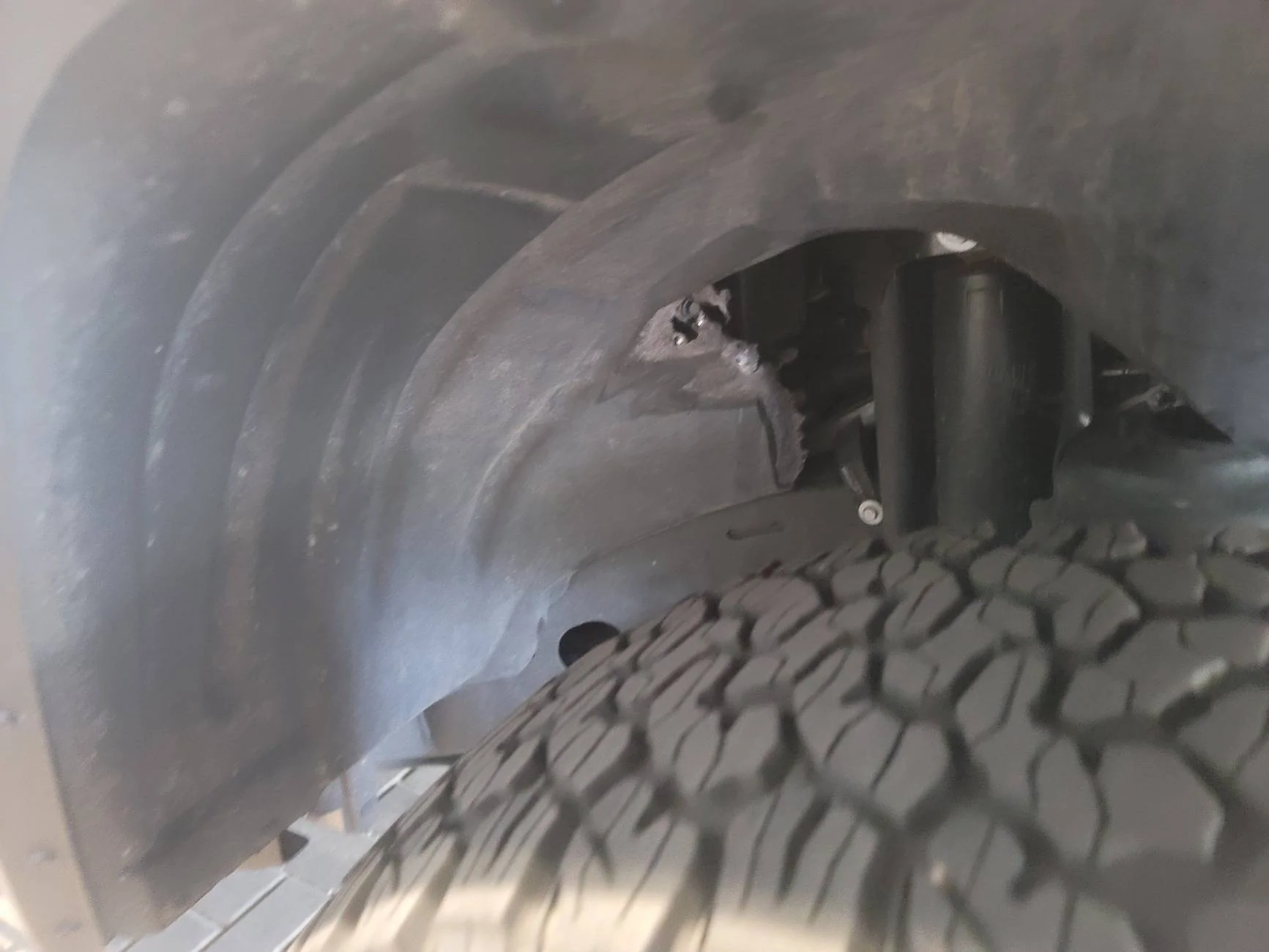

@JeepCares, my 2021 wrangler 4xe recently encountered the same problem after a road trip from Vegas to LA. Dealership checked and said its non-warrantable. The estimate fix cost is $720. Its a bit strange that this happened right after the recall remedy was done. Please advise, thanks!

Update~~~~~~~
I visited Chapman CDJR to address the damaged fender liner on my vehicle, but the dealership determined that the damage wasn't covered under warranty. Since Jeep doesn't control dealership decisions, they couldn't intervene directly. However, my case manager, Mike, advised me to try a different dealership, as he believed the issue should be covered. Following his suggestion, I went to Jim Marsh CDJR in Las Vegas, and they repaired it under warranty without any problems. After some back and forth, the issue was finally resolved, and I'm grateful for the assistance.
Shout out to Jim Marsh CDJR and thanks @JeepCares !
