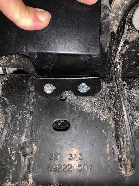

Have the same issue with factory fender liners. Both sides got ripped up by my factory tires driving down the highway. Jeep needs to recall this part. I've been through 2 sets of factory paper thin fender liners on my JL Diesel. Got tired of dealing with it and spent $550 on a pair of Poison Spyder front fender liners but they have been a fail as well. The drivers side front tore at the 90 degree bend where it mounts to the frame. (Picture insert) Not sure why PS thought they could span a gap between fender and frame with 16 gauge aluminum and have it last. Mine broke after 4 weeks and zero off road trips. The passenger side lower rear does not fit because a fluid bottle is in the way. Had to zip tie it in to get it to stay in place. Please, FCA, recall this poorly engineered fender liner and stop forcing people to the after market.
Update to my post above. I recently installed a new pair of American Adventure Lab fender liners and took them on a wheeling trip. They installed very easily and I've had no issues at all with them. Bonus...they look great and were specifically designed for the diesel so they're is no washer fluid bottle interference. Thanks to the folks on this forum for pointing me in the right direction!
