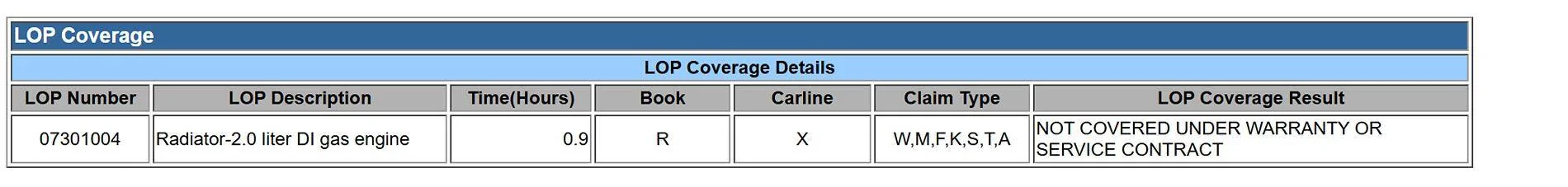

Son of a bitch, you're right. That's insane to me. I swear these used to be covered when I was doing grand cherokee radiators daily.
This is a 21 with 45k on it, so under powertrain but not basic.
I know, it’s crazy. Mine went out when I was working on a weekend, pulled up to an auction site and steam rolled out from under hood. Barely 50k on the odometer, 3 years and a few months into ownership. Good thing they’re cheap.
