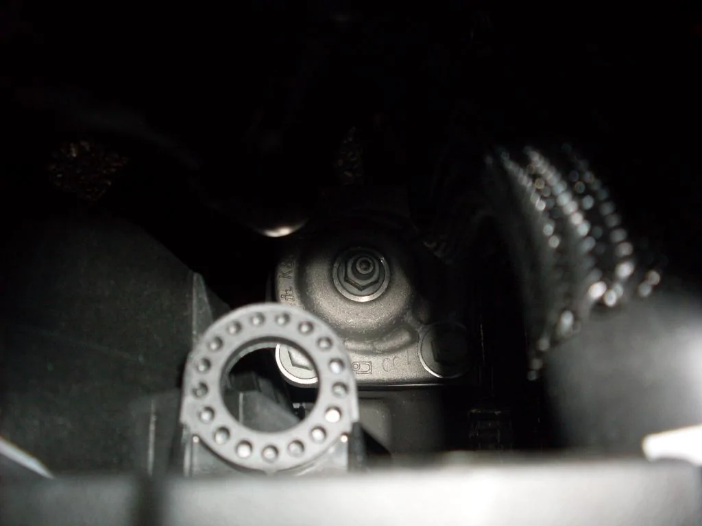

It's not your imagination, I finally got around to adjusting my steering box today and that solved the problem. My jeep now drives like a new vehicle should.It's true you should have a little play, if you don't and over adjust the steering box your wheel will not return to center and wear out your steering box. People on here don't realize how much steering play we have. And it is also true that my tires where over inflated from the factory, but that was the 1st thing I changed.There are some good videos on youtube explaining how to adjust a steering box. I was able to do it using socket extensions and did not have to remove anything to access it. It was not easy but doable.

Do you have any details on where the adjustment screw is at on the steering box - is it accessible without removing anything? And any details on how it should be adjusted? This sounds promising.
From the front of your Jeep look down beside your right driver side radiator hose.You will then see the steering box.The allen screw in the middle of the center nut is where you adjust it.If you over adjust, your steering wheel will not return to center and wear out the box. There are videos on youtube explaining how to adjust a steering box.I accessed mine using socket extensions without having to remove anything.
Thanks! I watched the videos before (they are for the JK, but same adjustment of course). How did you hold the allen wrench in place if you used a socket? The video shows to use an open ended wrench so you can use an allen wrench to hold it in place, then adjust 1/8 of a turn, then re-tighten the the nut while holding the allen wrench at the 1/8 turn point.
