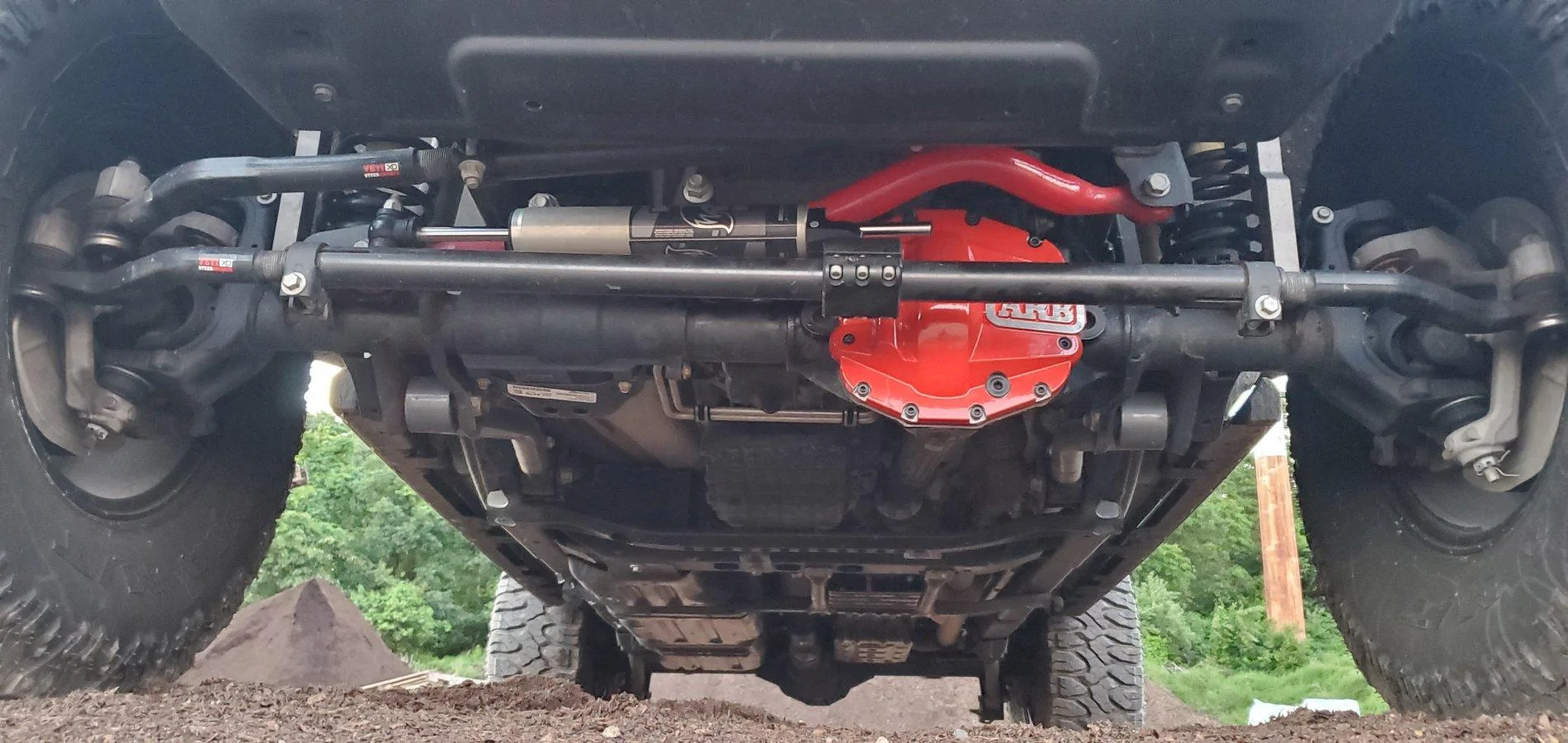

Hey, Mike.... what relocation kit do you have there? I'd like to keep my Fox ATS & the mounting you have on the tie rod is the setup I'm looking for.

All Steersmarts parts were used to relocate my fox ts stabilizer. The tie rod clamp i chose, is double drilled and threaded. Its meant to mount a non through shift stabilizer on one side and a hydraulic ram opposing it. First pic is what I have, second is a newer aluminum clamp that is for just a stabilizer, third is the low profile bolt that doesn't interfere with the through shift passing above it, and forth is the double sheer axle side mount.
