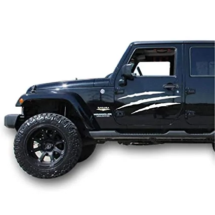

Did it look anything like this? If so this will buff right out or you can just Rhinoline the whole car.
Jeep Wrangler JL how to remove scratch on JL? 60DCE9D5-E72F-47FD-B2FF-C74C8F62EA95
